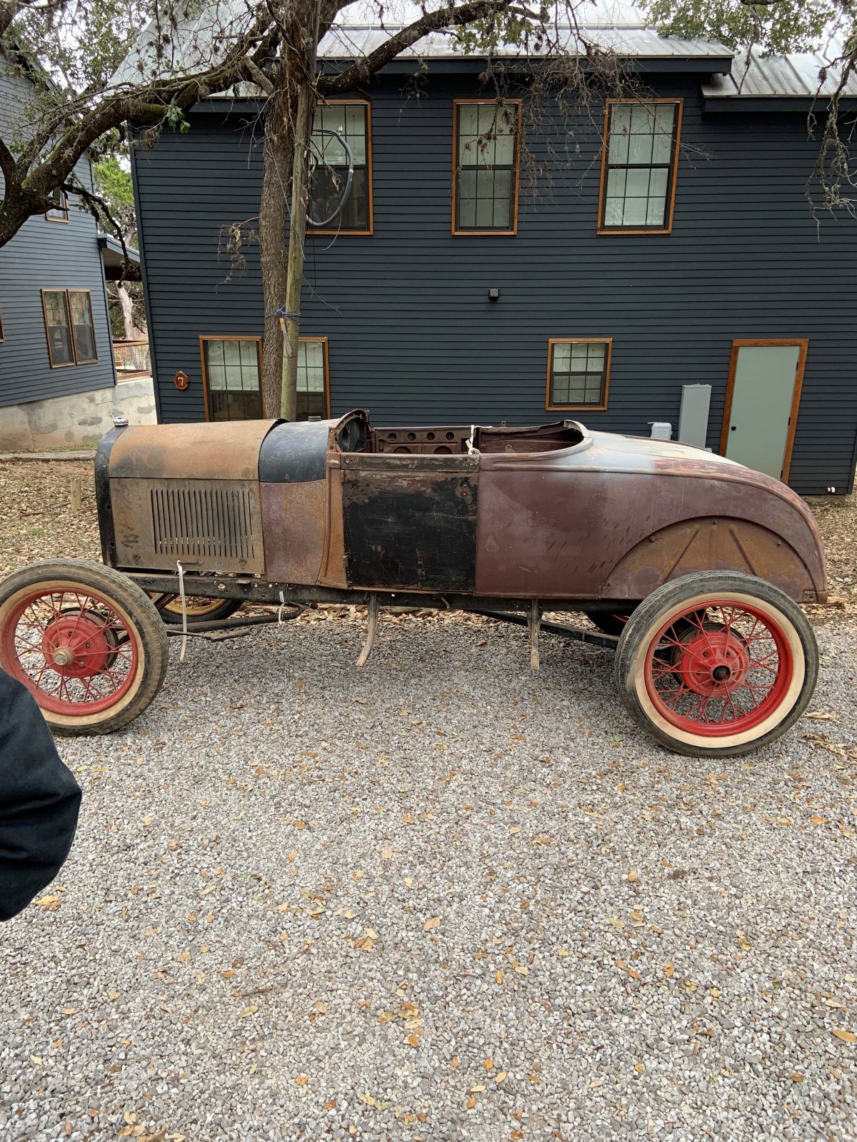

    Fast forward to February of 2022 and we were finally picking the car up, and man, this car is clean. Like needs no patch panels what-so-ever clean. Once belonging to a man who bought the car in the 60s with high hopes to build it had disassembled the car and put it in storage, and there in storage had sat until James dug it out nearly 60 years later.

    My plan was to build a banger powered “TROG style” racer using as many model a parts as possible. I was always way into the prewar style cars and wanted one of my own. I love my late 40s style flathead v8 T, but theres something about driving a slow banger car fast that looks like so much fun.

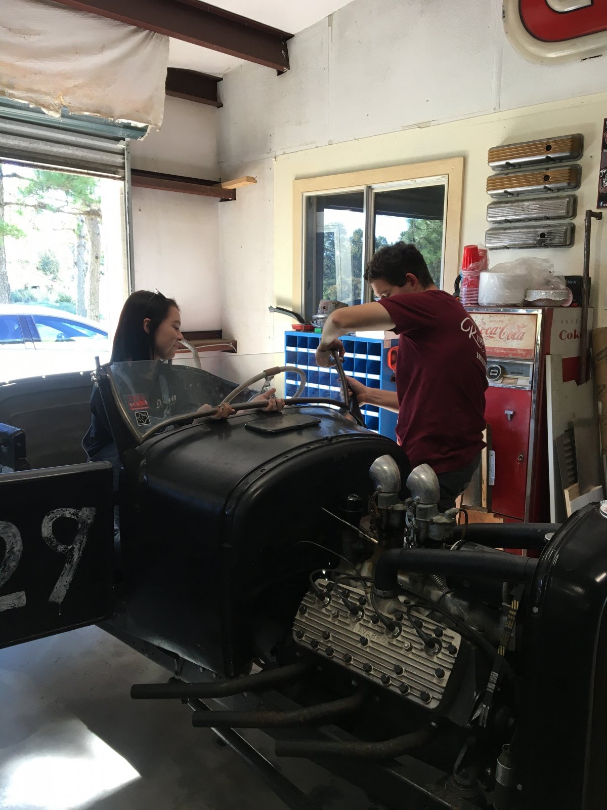

    That brings us to Juliet. Juliet is my extremely supportive girlfriend that has always been eager to help me with my Roadster, be my co-pilot in that loud windy car, or even jump the fence to get a better shot of me flying down the beach.

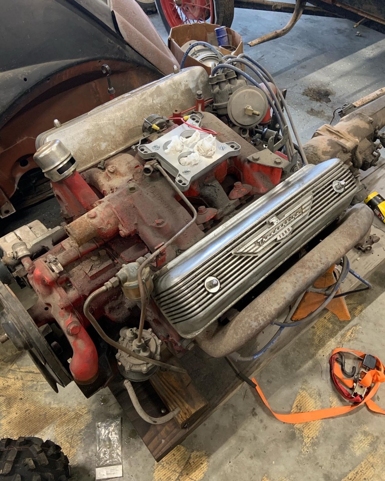

    In 1955 Ford introduced the 292 Y-block as part of their shiny new answer to the Chevy Corvette; the T-bird, and I knew where a complete freshly pulled drive train was and wouldn’t cost me an arm and a leg to obtain it. So this past weekend with the help of my dad we went and grabbed the motor, the 3 speed (with overdrive), and the dana 44 rear end.
    That brings us to now. The current plan is to use the stock frame. We will probably have to stretch it a couple inches at least in order to fit the motor in without cutting the firewall up too much but we will know better how much when we do the mock up. We will need to be careful not to mess up the proportions so It’ll most likely still end up being a shoehorn fit but that’s hotrodding for ya.

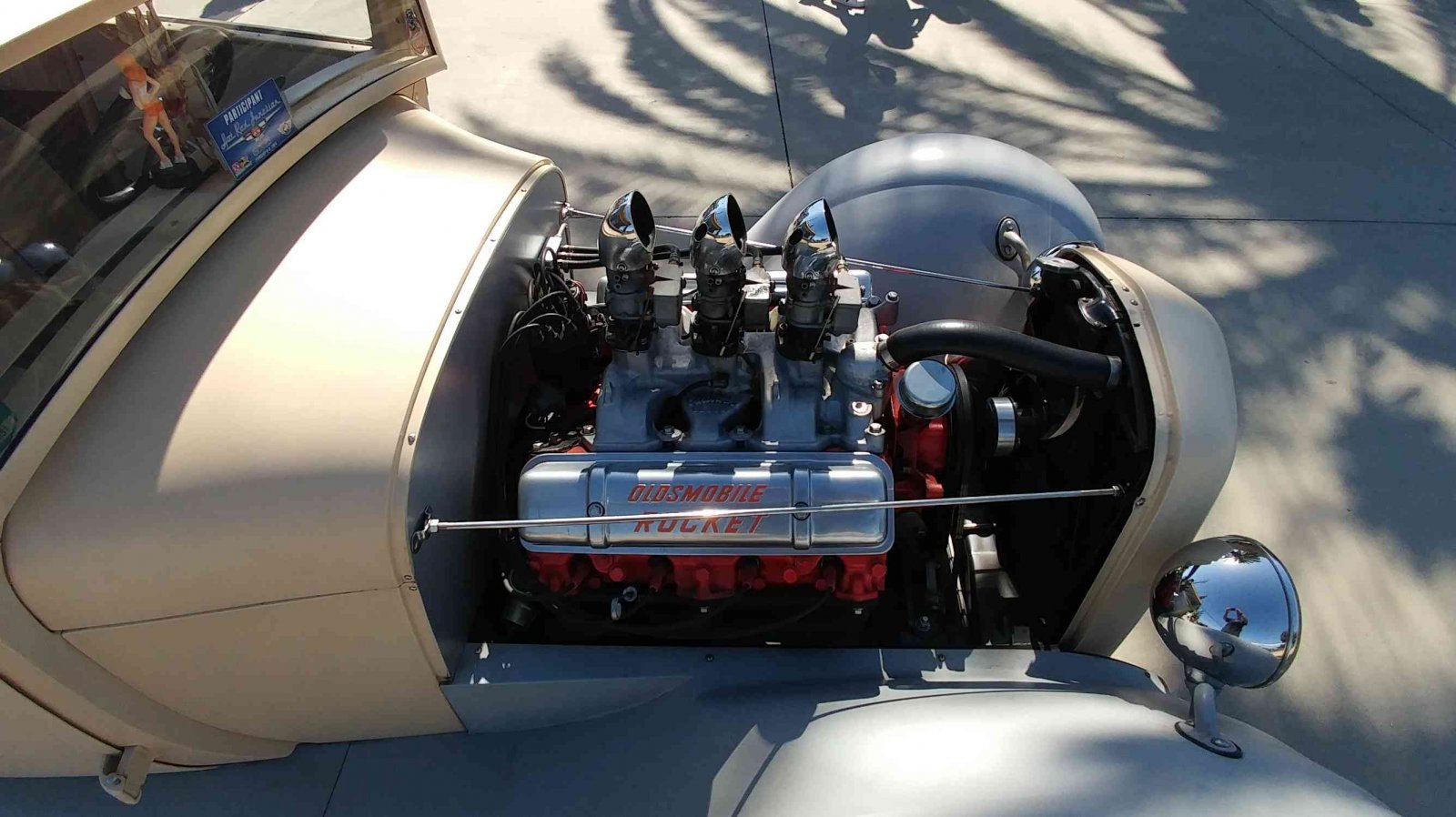

    Ive been drooling over my buddy @TexasSpeed killer roadster the past few days. This car has been one of my favorites since I first saw it in person at Austin Speed shop. I ran it by my Fiance and she really digs it too. I think this will be roughly the same "vibe" we will go for. Check his threads out here and here . Its well worth a read or two... or three... 14663bae683588135daf9ef478120925.jpg

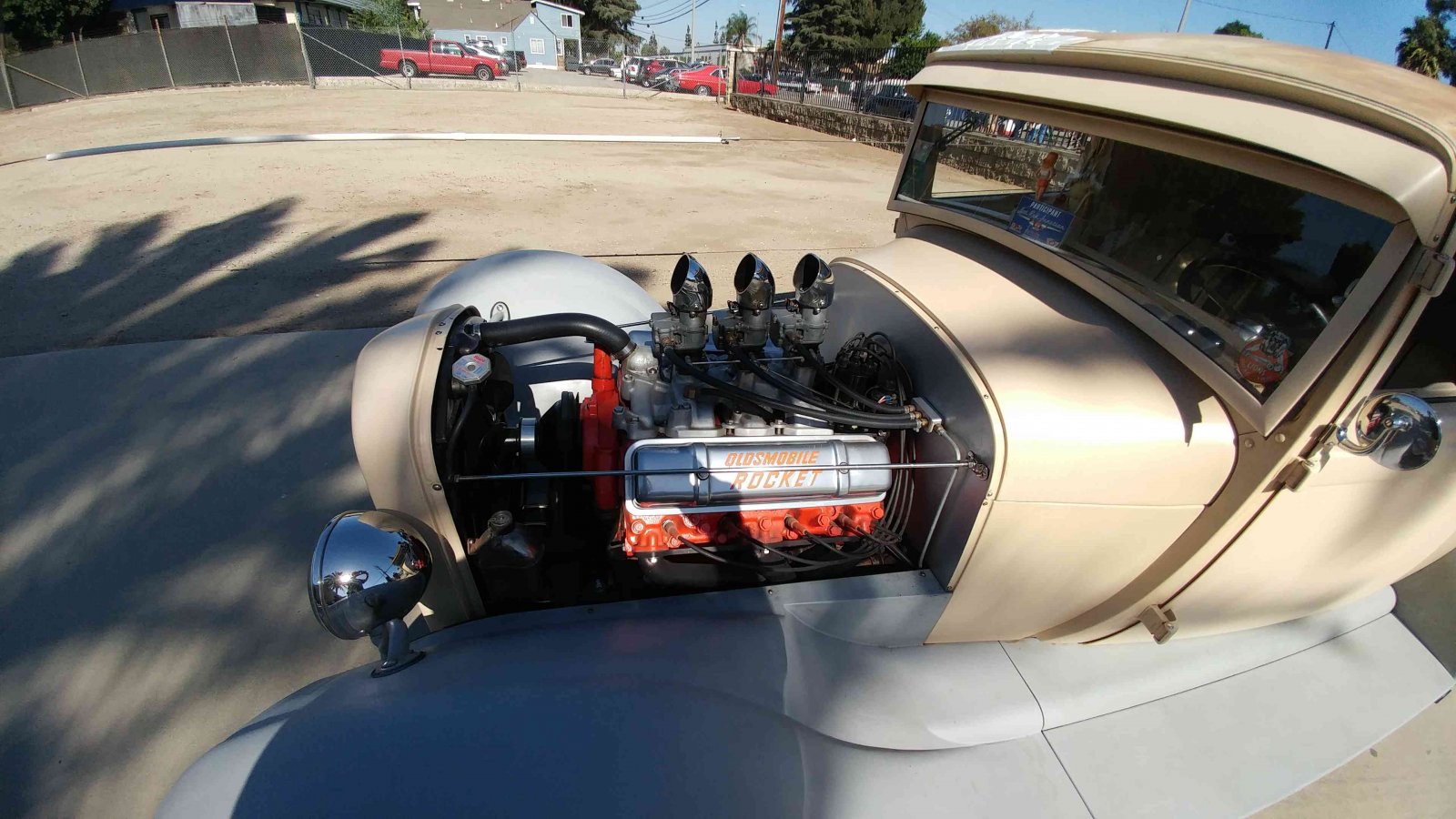

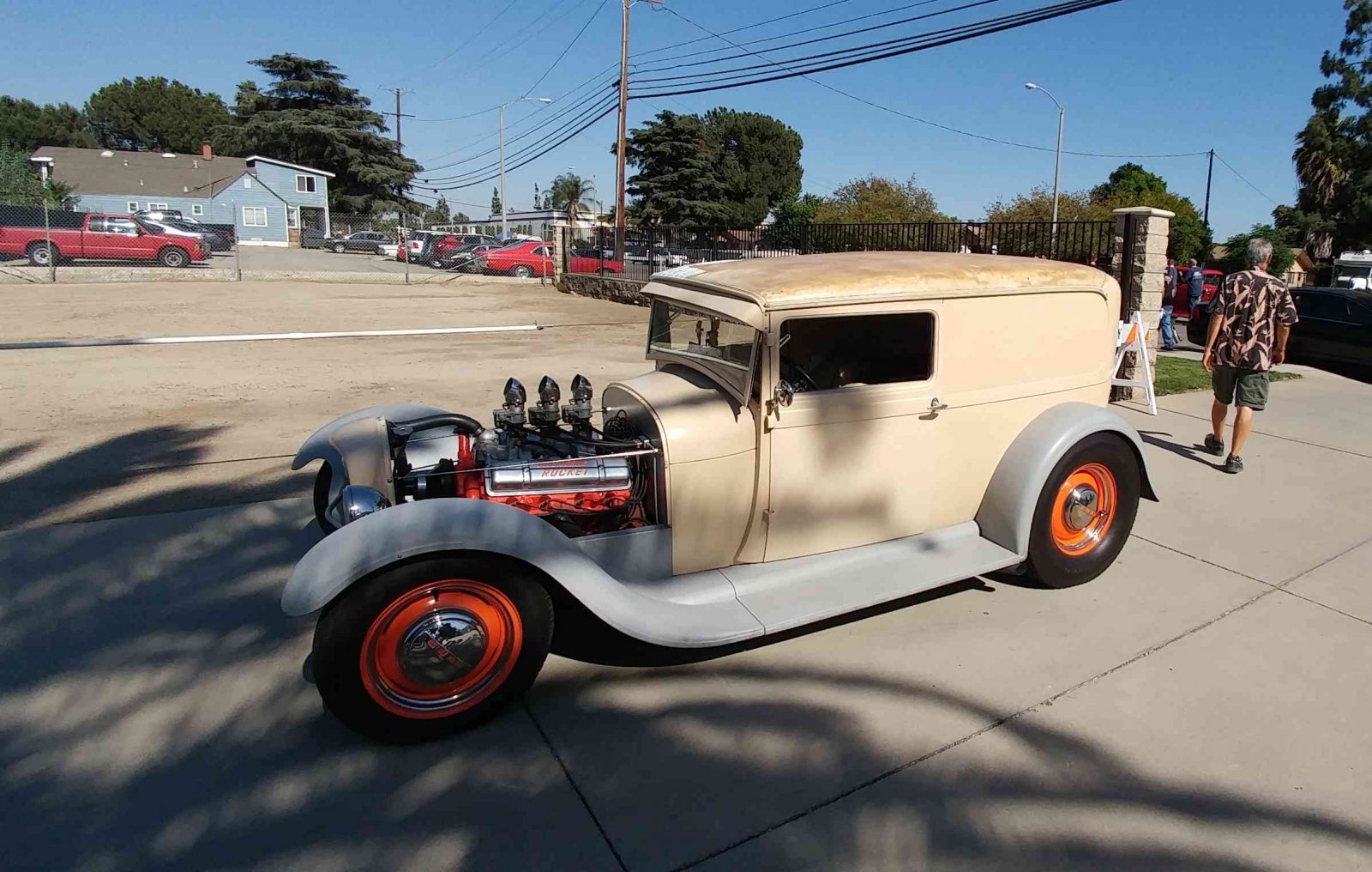

    Congrats on both new projects! I am glad you have internalized the proportion thing. You CAN stretch the frame to move the front suspension forward - it actually looks better that way on a highboy. But you CANNOT move the radiator forward to get engine clearance and maintain good proportions. If the stock hood won't fit the original proportions are gone. This is one of the reasons Ford motors aren't a really good choice for a Model A. Your only option with a Y-block is to move the engine back by modifying the firewall. A lot of guys will tell you that 2" isn't noticeable. Perhaps to them it isn't, but to us "seasoned" hot rodders it is the difference between a successful build and a not-so-successful attempt. Good luck!
    Here is a project of mine from years ago. Two-inch stretched frame with radiator in the stock location. Stock hood would still fit. The stretched wheelbase improves the look of the car in my humble opinion.
