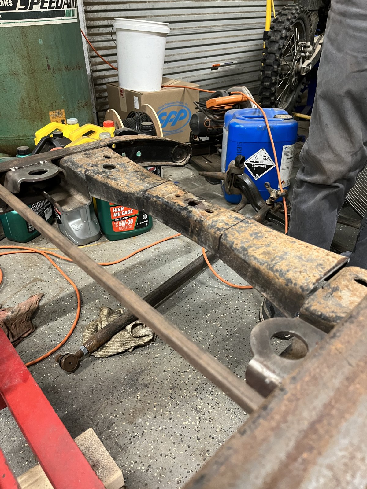

  13. Getting more of the "free" work out of the way while I wait for parts to finish the frame.
