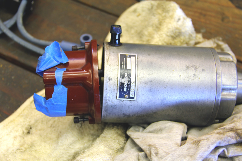

    Went to pop the cap on this Ronco Mag I've had for a few years.. Thought the high tension lead ran thru a brass rod up from the body into the cap contact spring on these Mags.. this one seems to have a plastic/ vinyl covered soft lead from the body/secondary winding going into the cap.. So far it doesn't want to pull out of the cap with gentle pressure and I really don't want to break it.. not sure what the trick is to get this to release ? Any Ideas...
    Thanks for the help ! -Dave

    It's hard to tell from a picture... I believe it should just pull out? At least mine does... Mine is like a little plug wire with a brass cap on it, maybe the brass contact has corroded together? If you have a local expert, I'd have them take a look before breaking something. From what I remember, that lead goes directly to the coil, and if you break it you replace the coil... which is a couple hundred bucks.

    Thanks for the help and warnings.. I'm guessing corrosion.. but again its just guessing..
    Time for a service....
