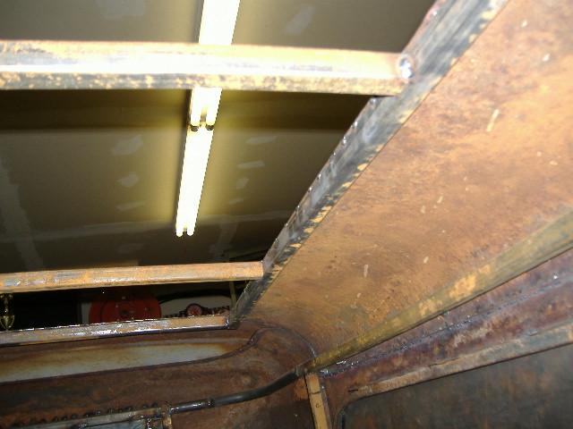

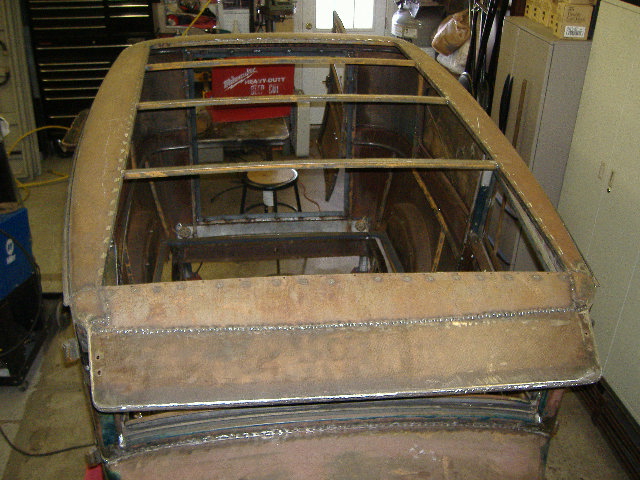

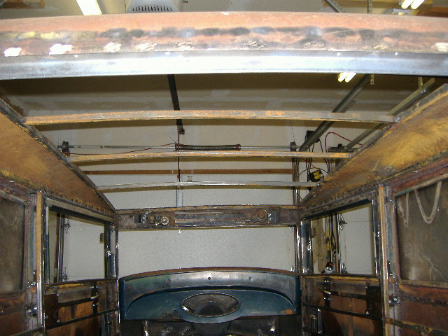

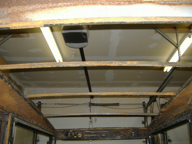

    It's not an A, and it's not a coupe. But it's an old car, and here is how I did it. Starting at the front match your original curve with your new material and then do the same for the rear area. Then for the center bows just lightly bend your square tubing so they a familiar to the front and rear starting points. With your coupe, the bows wont be to sharp of a bend. Just make them flow off of the side portion of you roof. Not to flat and not to much of a curve. And you should be good to go. ..John

    Nice job on the roof struts Ghost....so you bent them instead of pie cutting them. If I could find some wood ones I could copy them, I'll keep plugging along
