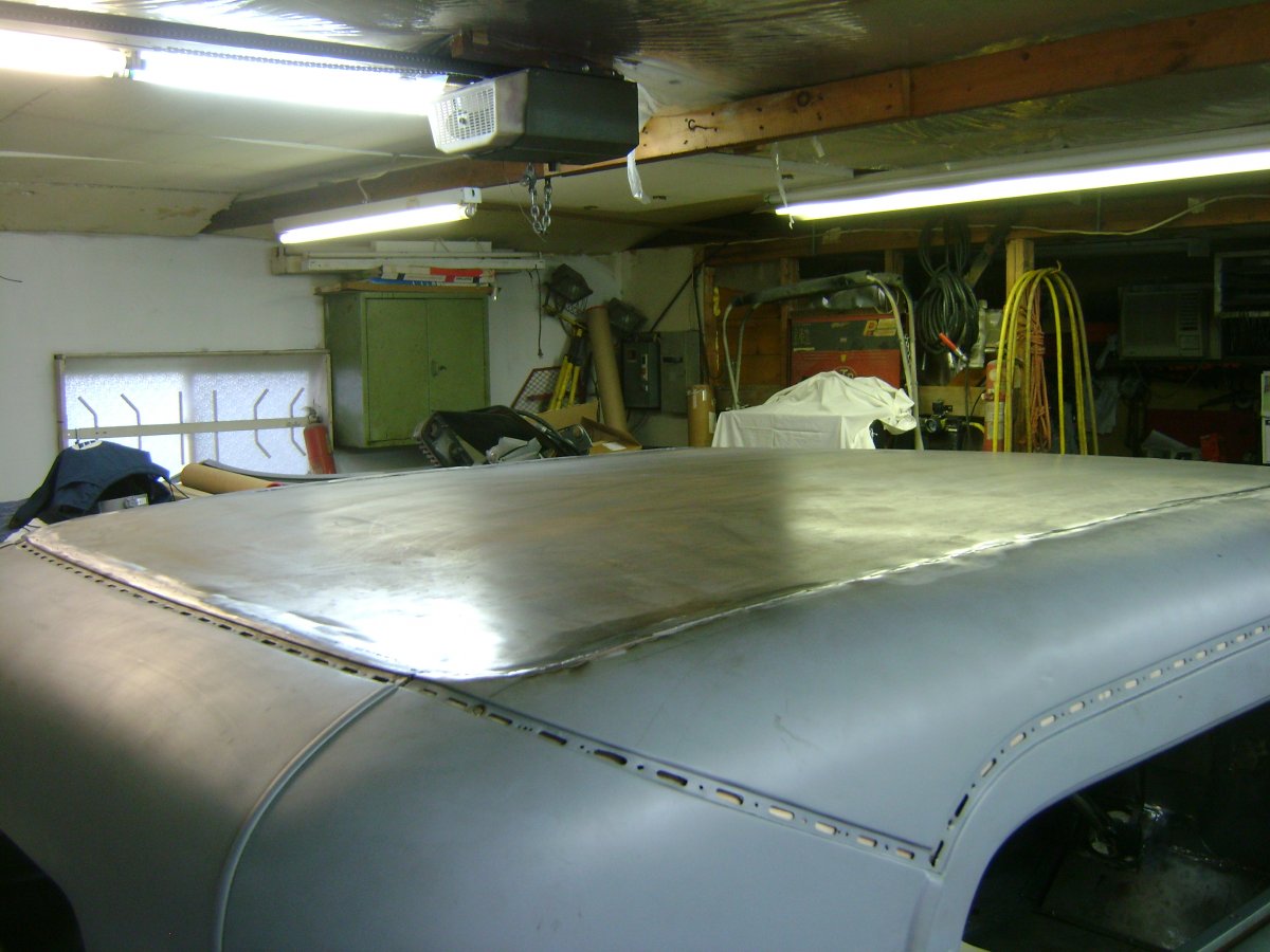

    I used a 1962 Chevy station wagon roof for the insert in my 34 Chevy 007.JPG

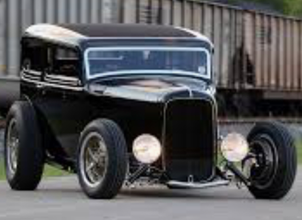

    I followed that build Rich, that was one nice car. I'm going to do something like that, I don't really want to do a weld in insert, to much welding and I would rather have vinyl. A lot of good ideas, thanks.

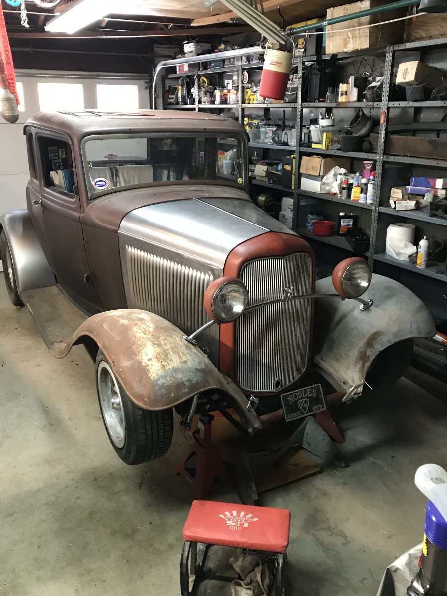

    59 Chevy Hard top on my 5 Window 32480E46-D798-475B-9113-CE043FF5759A.jpeg 6E38A16C-C892-4213-8902-37FBA431CEB0.jpeg
