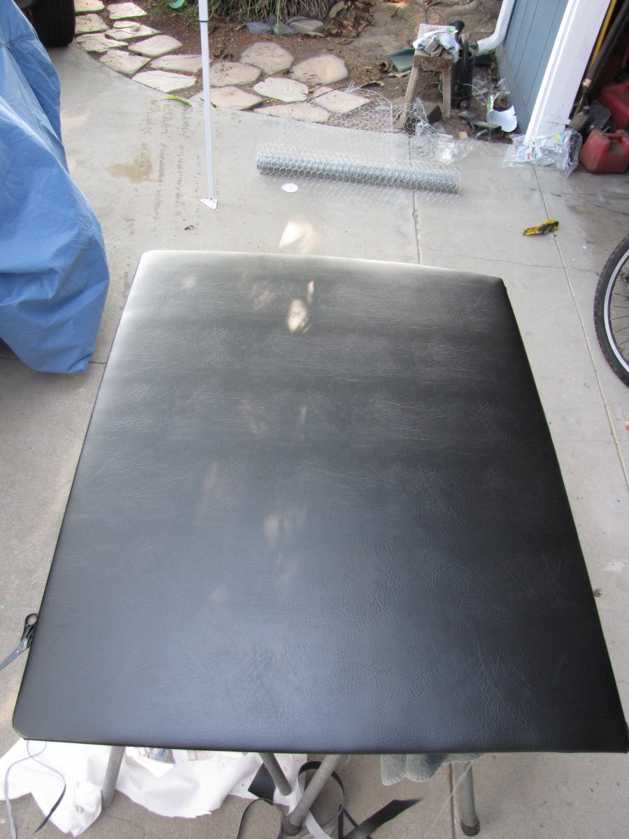

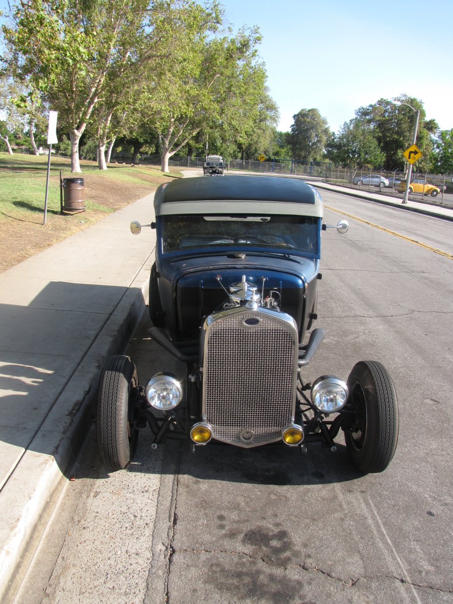

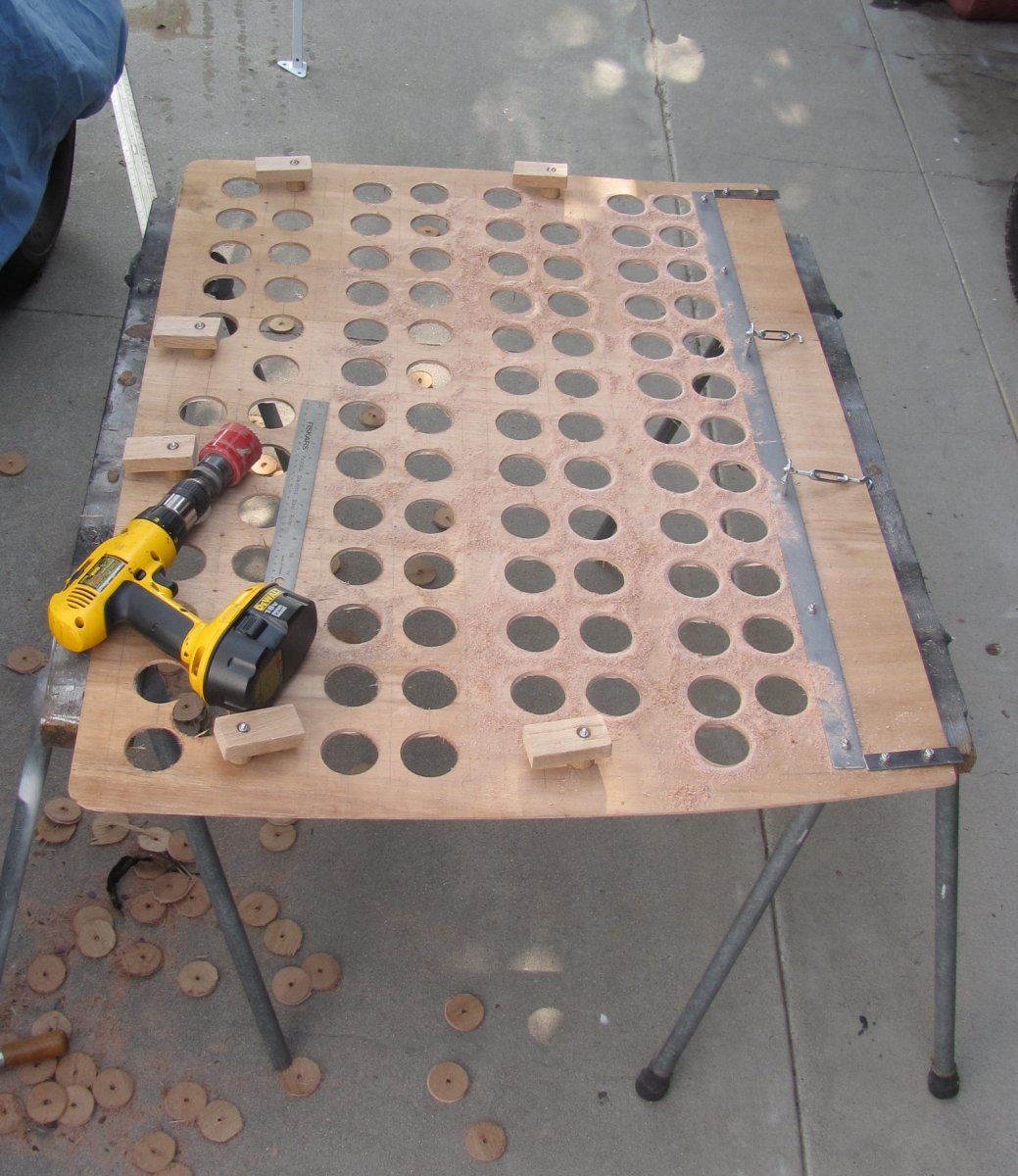

    I built the insert for my A pickup to be removable. The original roof bows were in the car, providing the basic shape, I used a s**** piece of 1/4" plywood and cut it to size using a pattern I made out of poster board. Then, to minimize the reflected sound waves I filled the ply with holes. Then covered it with batting and vinyl. I can remove the insert in about 3 minutes if I want to go with the top open, but to be honest, that is very rare (never?). When I eventually redo it I'll make it permanent instead of removable.

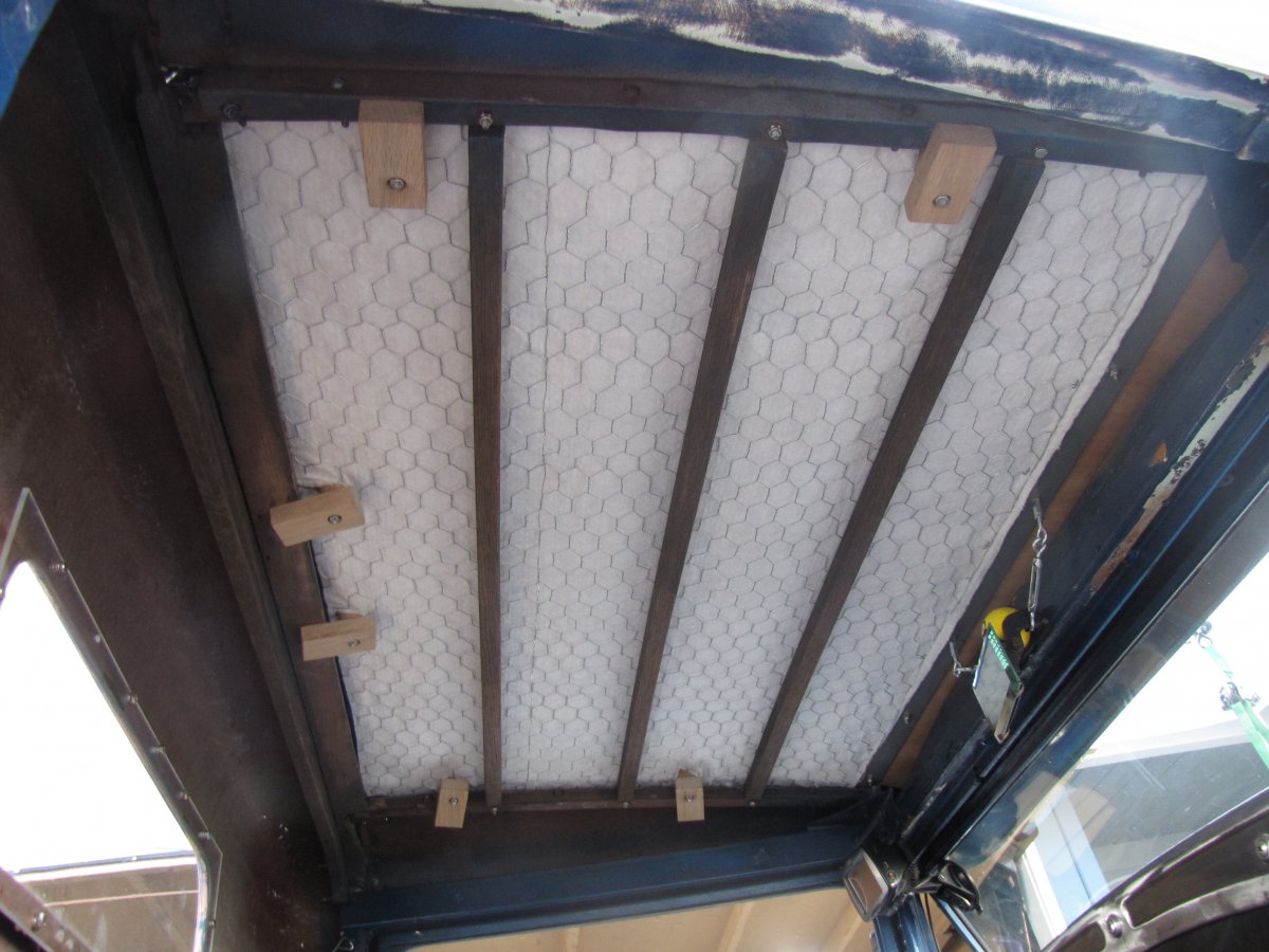

    Do you have any detail shots of the track/trim holding down the vinyl?

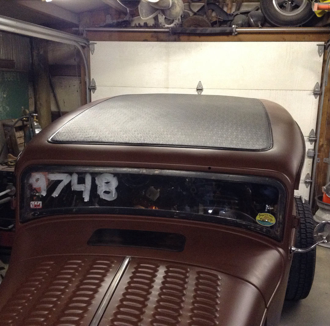

    I did the same as @sloppy jalopies and found an '86 Toyota minivan :confused: matched my A Tudor perfectly. I'm gonna cover it with vinyl later.
    More details here:
    https://www.jalopyjournal.com/forum...e-6-steel-roof-covered-by-stock-vinyl.636247/
  13. Blues4U
    Joined: Oct 1, 2015
    Posts: 8,221
    Blues4U
    from So Cal
    Yes. Note the oak blocks are to hold the insert in place. That was part of the removable aspect of the top. I originally wanted it to be removable. Turns out I don't remove it, it's just too nice having a roof overhead. So, if/when I redo it I'll get rid of those and use something far less noticeable. Otherwise it look like the original style insert at first glance, chicken wire and batting. IMG_7688.JPG
