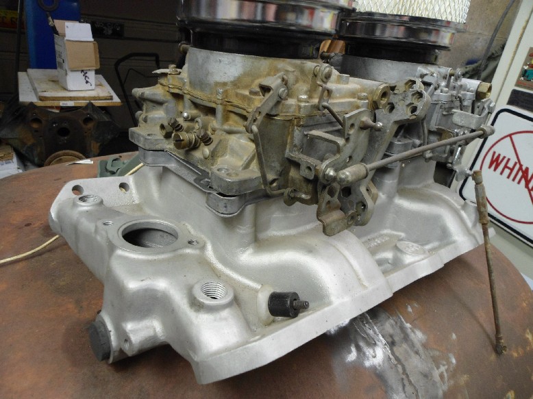

    any casting numbers on those carbs?
    I have a nice 4 jet that I will never use if interested

    I haven't actually taken posession yet. I have to run up there sometime this week and pick it up.

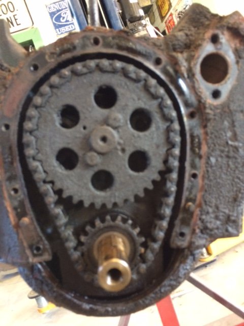

    Just ran across this post and I too am attempting to rebuild a 390. I have a question regarding the timing chain and the camshaft sproket. First, I noticed that the slack on the chain seems to be a little excessive and secondly, like you mentioned, there are only 2 bolts that hold the cam sproket to the camshaft with no plate to hold the camshaft in place. cannot remember when i dis***embled the engine if this is the way is was. I can pull the entire sproket-camshaft back and forth with the timing chain attached just doesn't seem right. Any help is appreciated.

  7. treb11
    Joined: Jan 21, 2006
    Posts: 4,126
    treb11
    If the mains were align bored/honed, the CL of the crank may have moved upwards, leading to a looser chain (you did replace it, right?) reduced center chain sets are available, but I don't know if they are for the Cad.

  8. Patrick D Sims
    Joined: Aug 5, 2017
    Posts: 5
    Patrick D Sims
    Yes the mains were align bored and the timing set/chain is new. This is probably the problem. just not sure if the slack i have is acceptable. worried about moving forward.

  9. treb11
    Posts: 4,126
    treb11
    Just for giggles, I looked up Caddy parts on https://egge.com/part/sag-1705-c-505/ and their sets are interchangeable with SBC, so theoretically you could get a reduced center timing set. YMMV

  14. 57 Fargo
    Joined: Jan 22, 2012
    Posts: 6,181
    57 Fargo
    Not every engine has a thrust plate for the cam, the lobes are actually ground on a very slight angle so the lifters spinning “push” it into the block so it can’t walk forward.

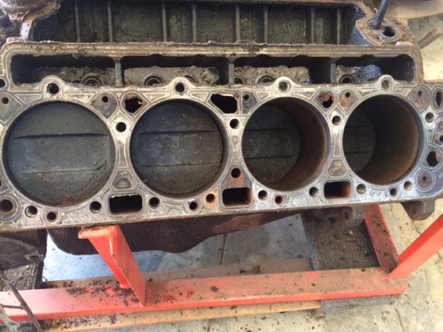

    Sorry Roothawg, I’m momentarily high jacking your thread! I’ve been trying to patiently to get this 365 apart for months. I’ve soaked cylinders in trans fluid, brake fluid, kerosene, PB blaster and a combination of all them. Have tried heat and much pounding with a big sledge and no luck! Got pissed, drilled lots of holes in pistons and beat them apart with a chisel. Probably messed up at least one connecting rod so far. Oops. Anyways 3 down and 5 to go from the 365 Cadillac from hell! [emoji3][emoji1303] Was excited and wanted to share in the H.A.M.B.!

    Wow. That looks bad. I think I would look around for a better core. Caddy's are addicting......Welcome to the sickness.

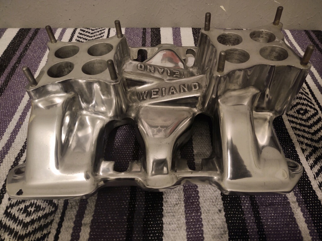

    Got my intake back from the polisher. It looks better in person.

    Kinda sorry I didn't buy that from you when I had the chance:p. Looks awesome Chris.

    Does anyone ever chrome their intakes after polishing? Silly question?

    This one was supposed to be plated. They tried but he didn't like the finish. So, he just polished it up.
