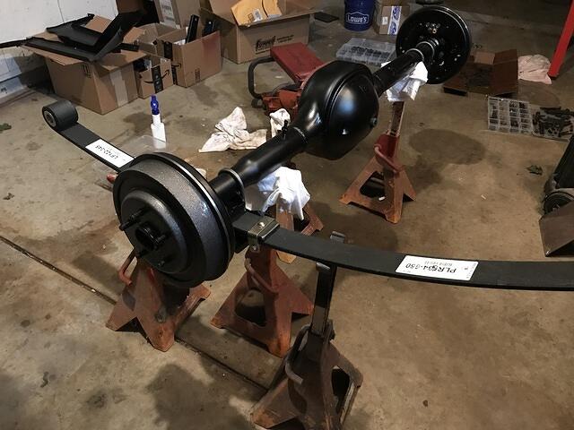

    I figured I had the front suspension tackled so I may as well tackle the rear end. In high school I had picked up a set of 4.11 gears from a local farmer and my birthday present that year had been a Detroit Locker and install kit. I hadn't planned on more torque than the driveline would handle at the time so I stuck with the 8". We will see if it lives with my choices.
    I had to literally cut the brake drums off of it when I brought her home and tried to roll her off of the trailer (I used the loader to lift the rear end to put it on the trailer).
    Upon pulling the center section apart the first thing I noticed was that I needed a new gear set...
    So I spent some money and bought a new set of 4.11 gears. Right choice? I don't know but it sounded good at the time and all of the drag strip calculators said bingo! I also took the opportunity to pull the locker apart and give it a thorough clean up before putting it all together - that was fun. BTW the first photo is an effective way to hold your diff in place while you torque your ring gear fasteners.
    At the same time I was busy blasting anything not attached to the ch***is and painting it. I don't have more than a 24 x 24 attached garage here now (sure do miss the shop) so a makeshift paint booth it was. Worked surprisingly well for the most part.
    I went with rebuilding the drum brakes at the time. I should probably migrate to rear discs before I put it back in the car permanently. I have also noticed that I have developed some wetness on the axle tube to center section housing weld joint so there must be a pin hole or porosity.
    To finish it off I threw on a set of Calvert split mono-leaf springs and Caltracs. I am not convinced that the springs will give me the ride height I am looking for with 15" rims but we will see I reckon. I also think I am going to drill the pad hole one inch forward to move the rear end back an inch. The springs have rusted just sitting in the garage so I will need to re-finish those before I put it back under the car.

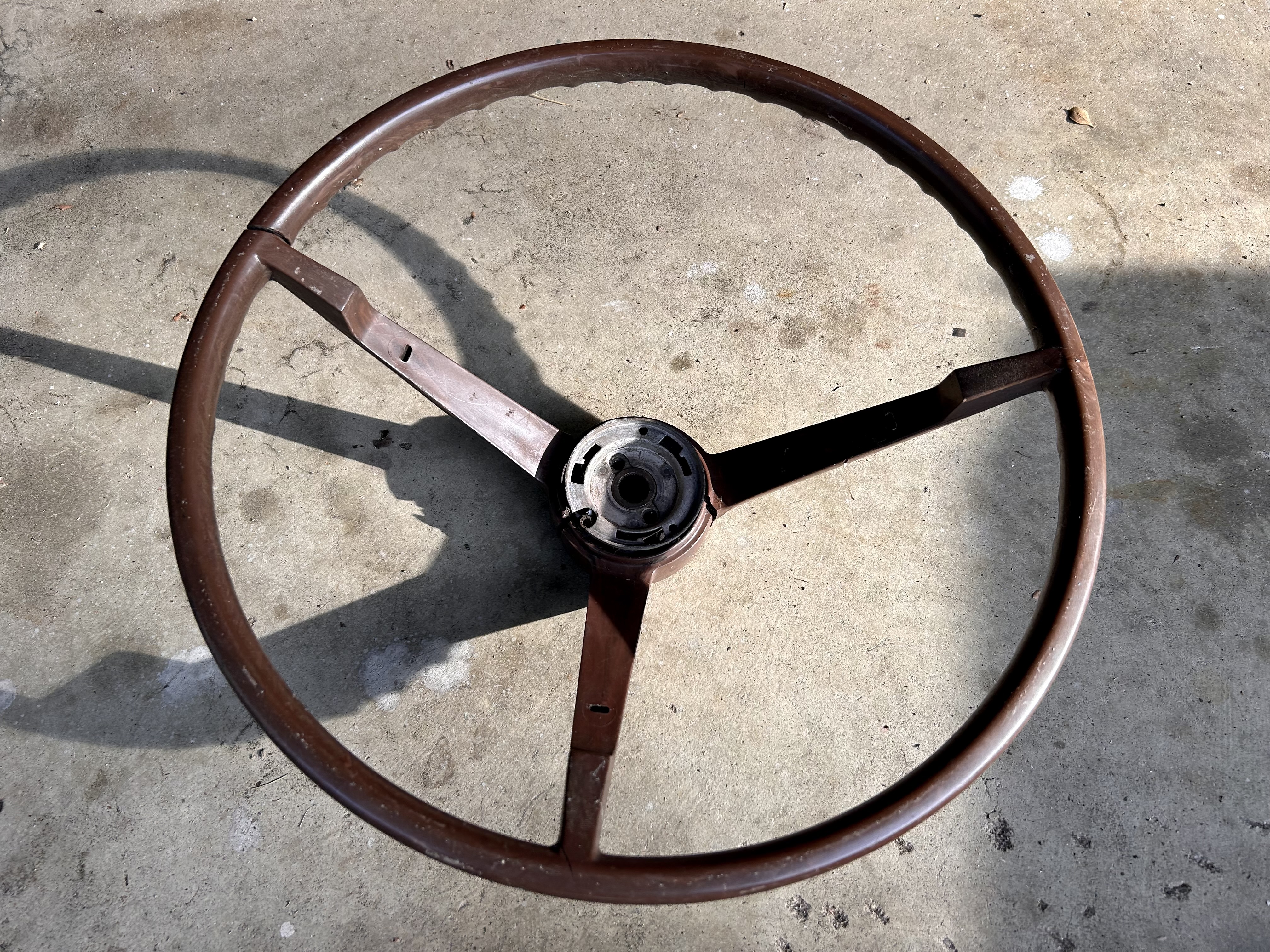

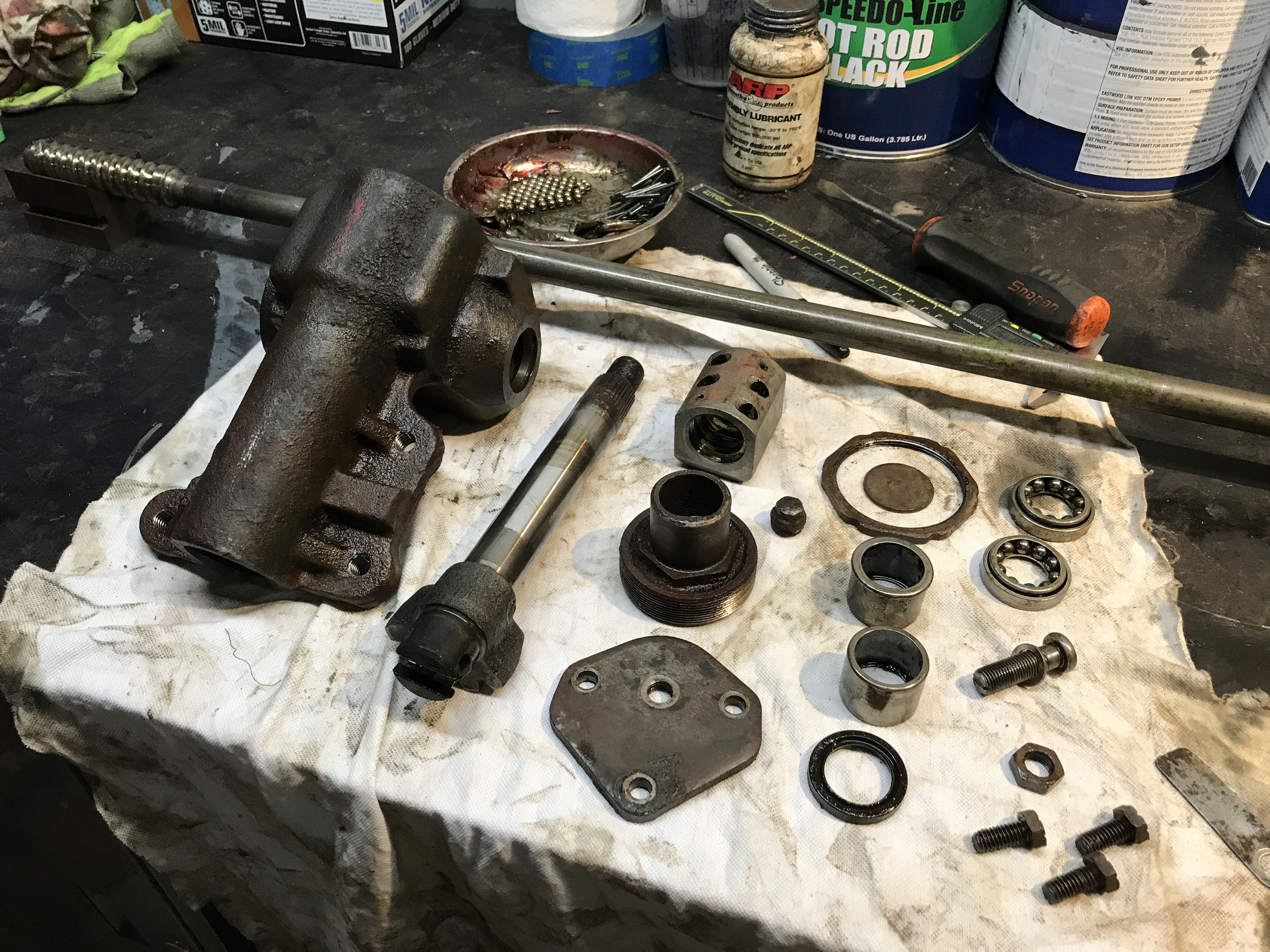

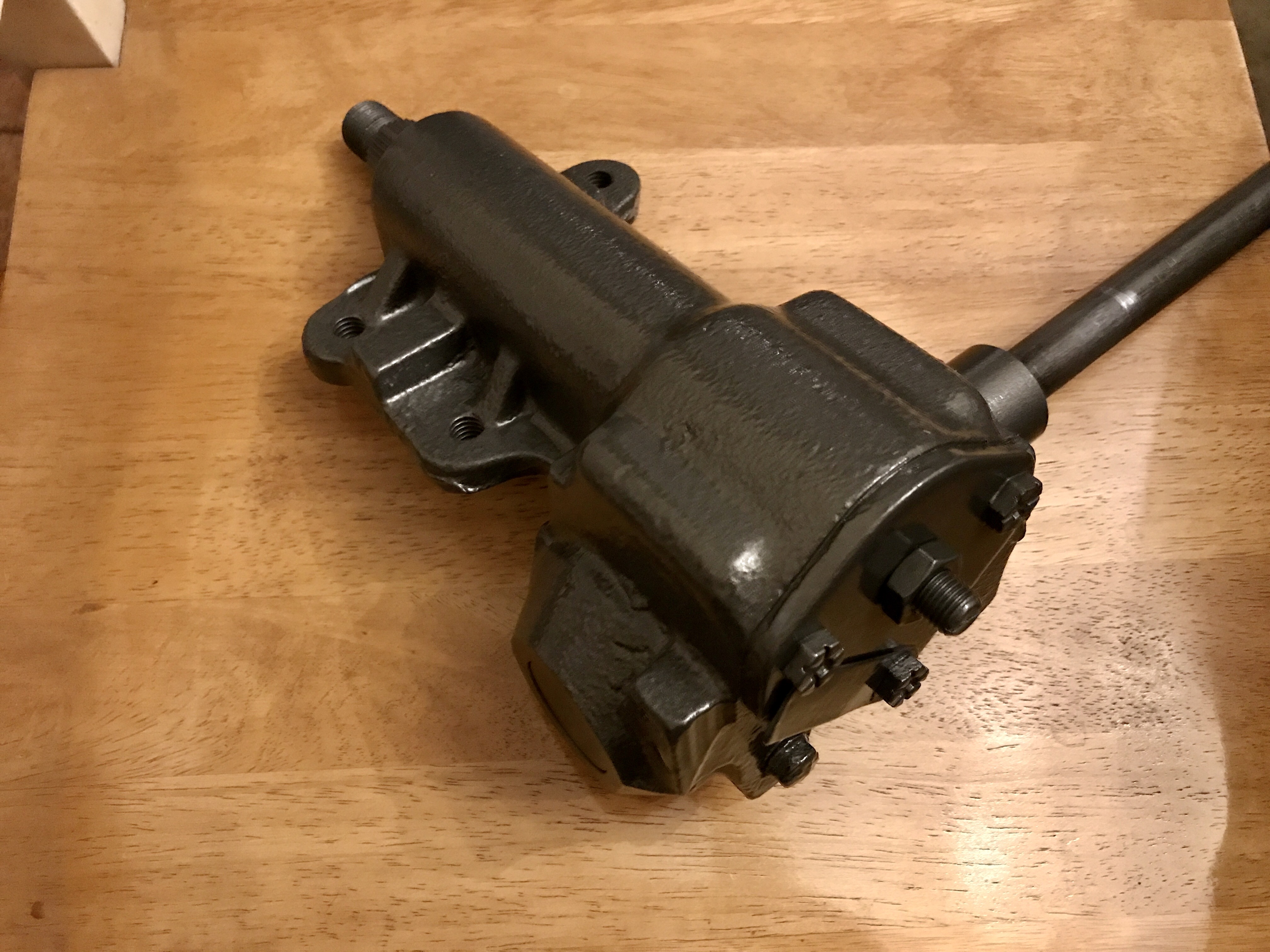

    One of the things that had plagued me since owning this car was the loose steering. Some of it was the worn out suspension, some the horrible power steering shuttle valve and the rest the gearbox. I remember sawing on the wheel like you used to see in old movies to keep it going straight down the road. Mostly holding the wheel against one direction or the other.
    So with the front end rebuilt and the PS eliminated I was left with only the loose gearbox to replace but at that time they were unobtanium. Enter this old girl at Parts Galore (RIP) in Flatrock, MI. A friend and fellow comet enthusiast turned me onto her and I was hoping to grab the clutch pedal ***y and other ***orted items (most of which had been harvested already). Well it just so happened that on a cold October day in 2019 I snagged the manual gearbox with the correct shaft diameter for use with the new steering.
    Unfortunately whoever ******ed the clutch pedals bent the steering column downward to extract them.
    I visited NPD up I 275 and picked up a rebuild kit and went to work. Some time spent in the press with the shaft marked and sitting in V blocks got it straightened out.
    Let me also say that my existing gearbox upon tear down was toast. Everything internally was extremely pitted so she went to the steering box graveyard in the sky. Luckily I harvested the balls out of it first because the “new” box was short two. But otherwise the new box was in great condition internally.
    I was also able to snag a manual column tube from Facebook marketplace locally from a mustang to rob the collar from for my column. Because 4 speeds are more fun than automatics…
    The finished product.

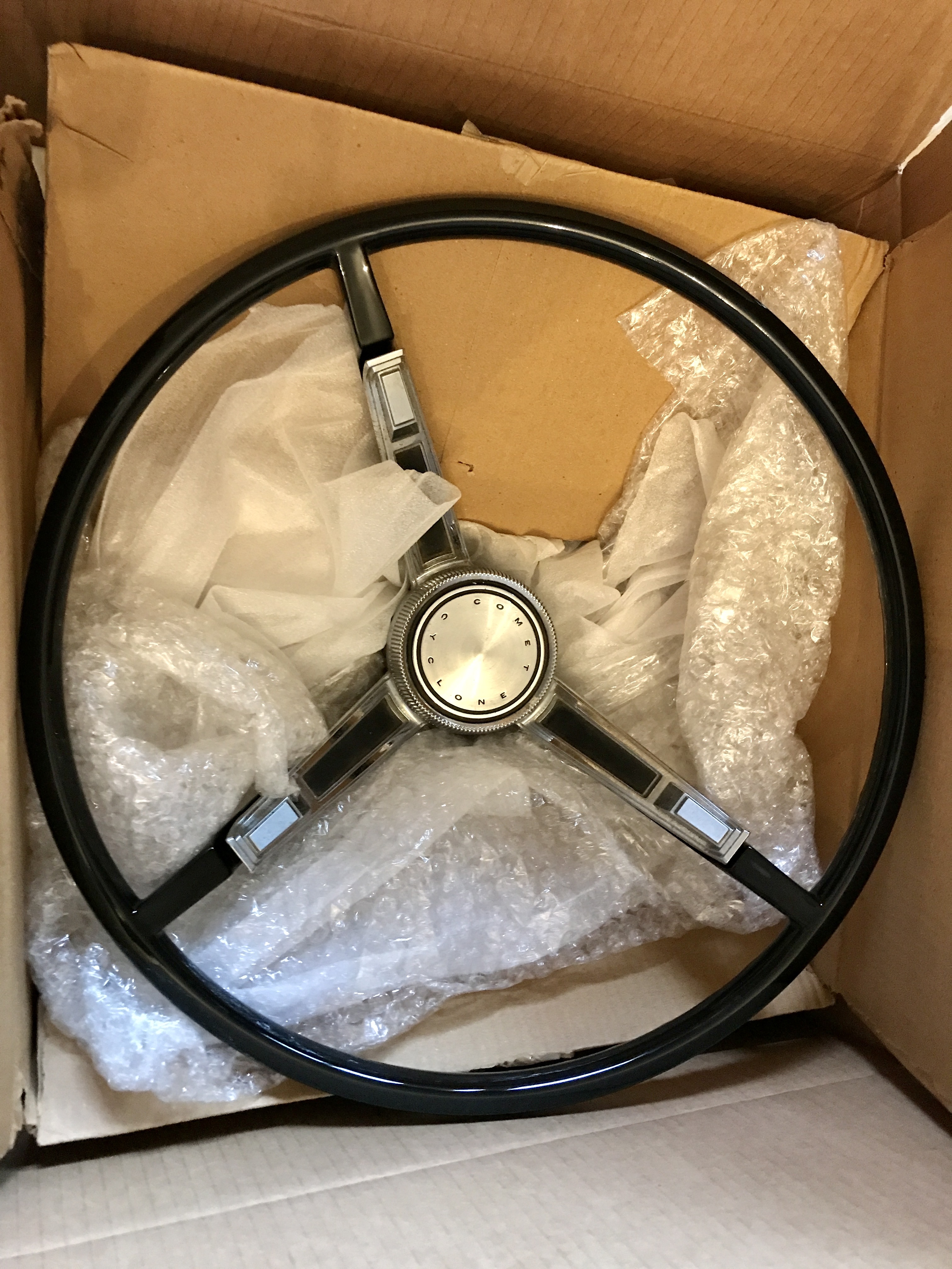

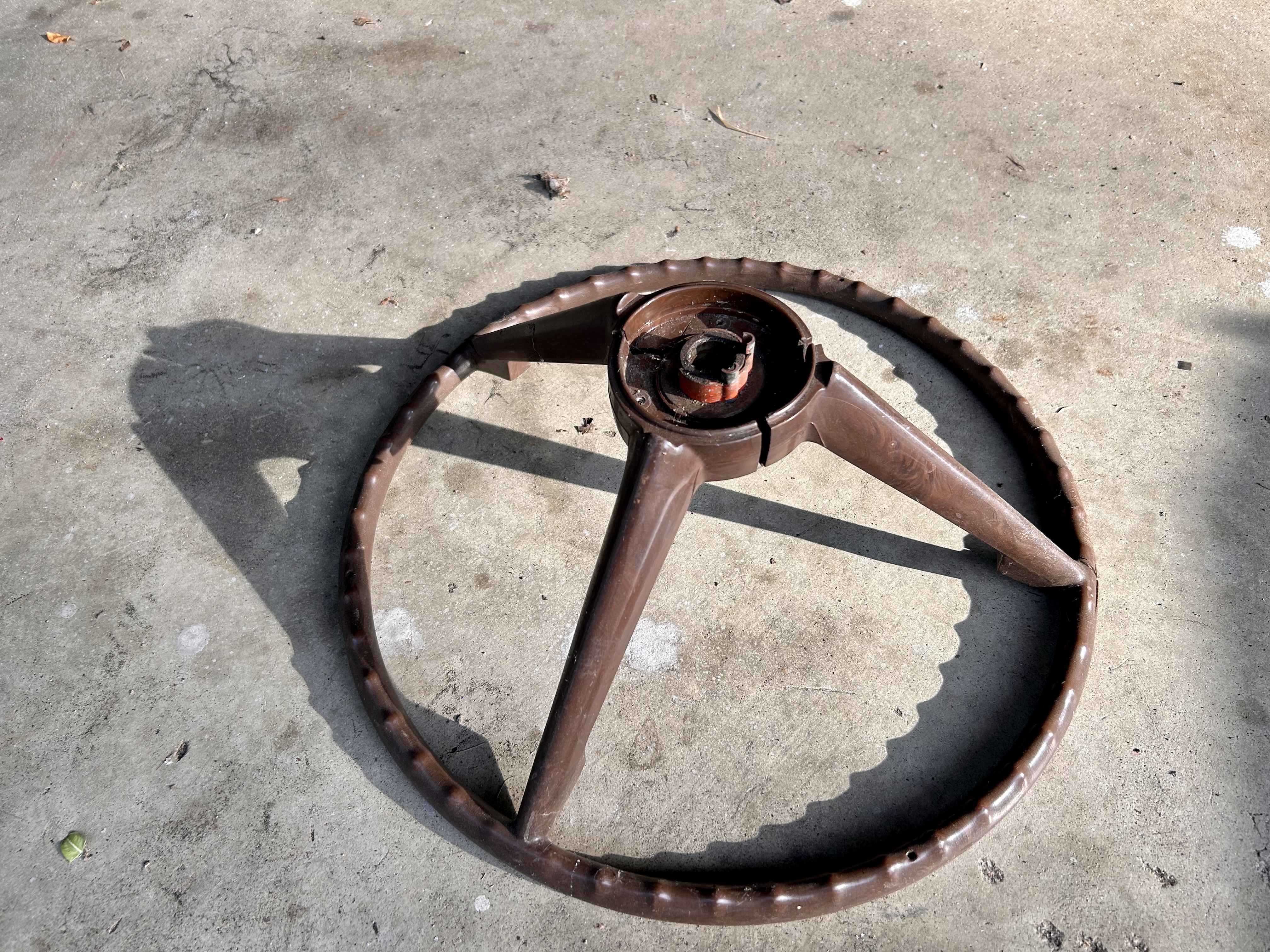

    While I was at NPD I picked up a new steering wheel. My original is pretty well deteriorated and not sure if it can be restored or not. I did learn that there is a difference in the horn and blinker contact architecture between generator and alternator cars. My car was originally a generator like all 64s and the wheel I got was for an alternator car and the center wouldn’t clock when installed.

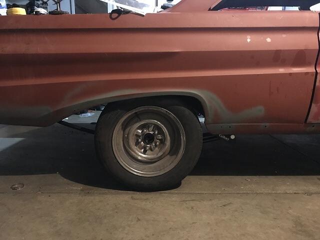

    Are ya planning on a mini-tub for the rear? Like others said.."they just ain't much room" under there. (although...the smaller rear tires just 'may' save your rear end and ****** because the tires will break loose before the drive train 'parts' will !:p)
    NOW would be a good time to trim those shock towers down for a little more header room in the future.

    It has been mentioned that the rear wheel houses should be modified now that you plan to push the rear end back an inch or two. I agree. When I was mocking up my Comet I did some serious measuring before I purchased the wheels (width and offset) and the tires. ( height and width) With the car at the preferred ride height and wheels and tires in hand I proceeded to relocate the axle center line, and leaf springs, witch then mandated the inner wheel wells needed to be modified. I moved the inner wheel wells inboard and also lengthened them to the rear of the car. All of this is very incon****uous unless you look in the trunk or notice the inboard springs when crawling under the car. My car does sit lower than most so I am sure ride height and tire/ wheel combination will determine what modifications your car will need.
    The shock towers can be trimmed to allow better spark plug and header bolt access, this is an area that is highly visible and modifications should be thought out and executed for maximum strength and visual appeal. In my mind success is modification that is unnoticeable. I always think about what Steve Strope from Pure Vision Hot Rods says… “it’s like an Easter egg hunt, the more you look the more you will find”

    no mini tubs or shock tower work. I have no plan on chopping this car up right now. Nothing outside of a 4 pt cage so I can mount actual seat belts in it. I have a little guy, not quite 2 yet. Maybe round 2 will include tubs before I give it to him.
    225s will fit. That is what this thing came to me with. Plan is skinnies in the front and 8.5 or 9” stickies out back right now. Has caltracs so I have ZERO illusions of hooking too hard.

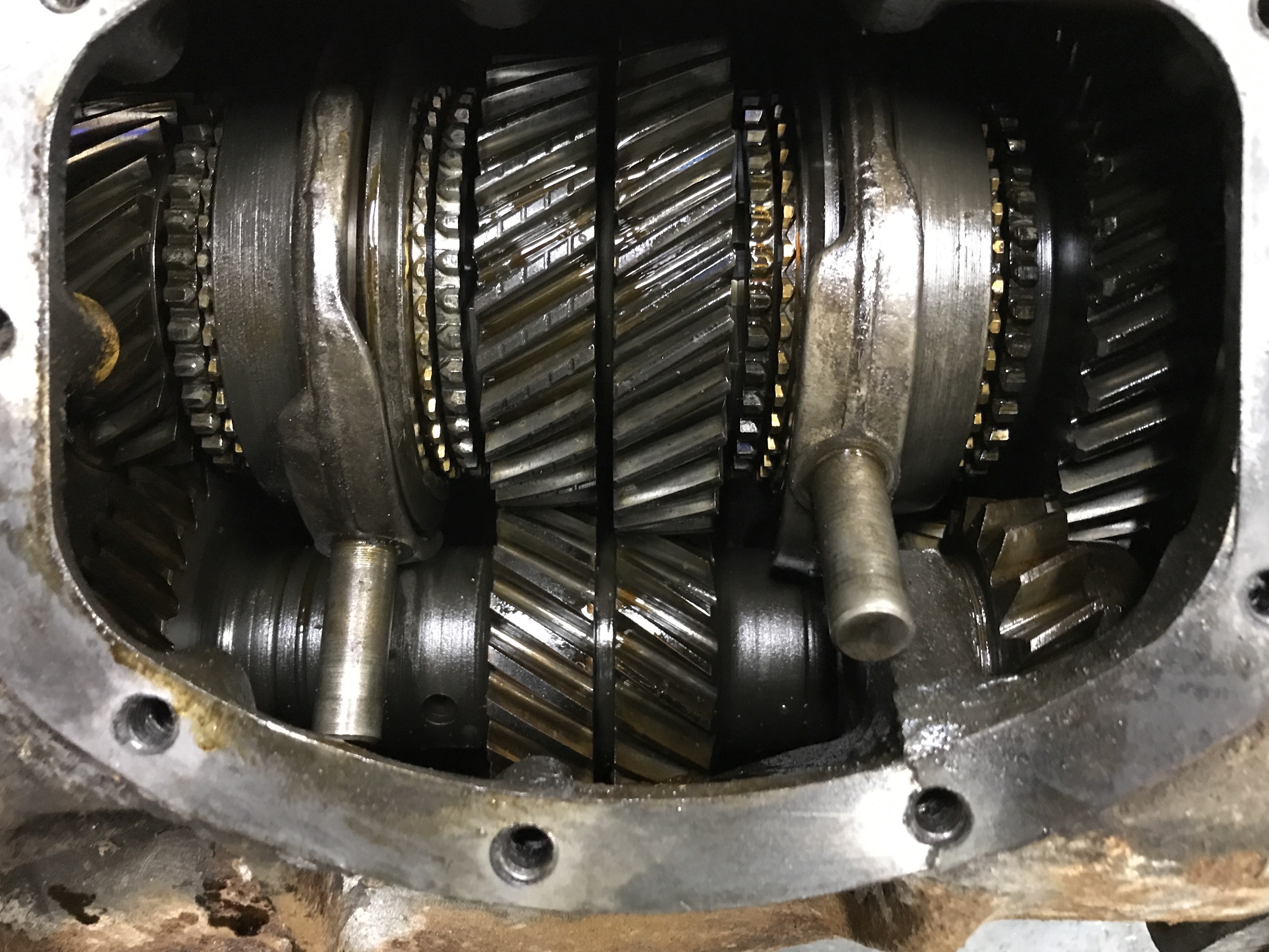

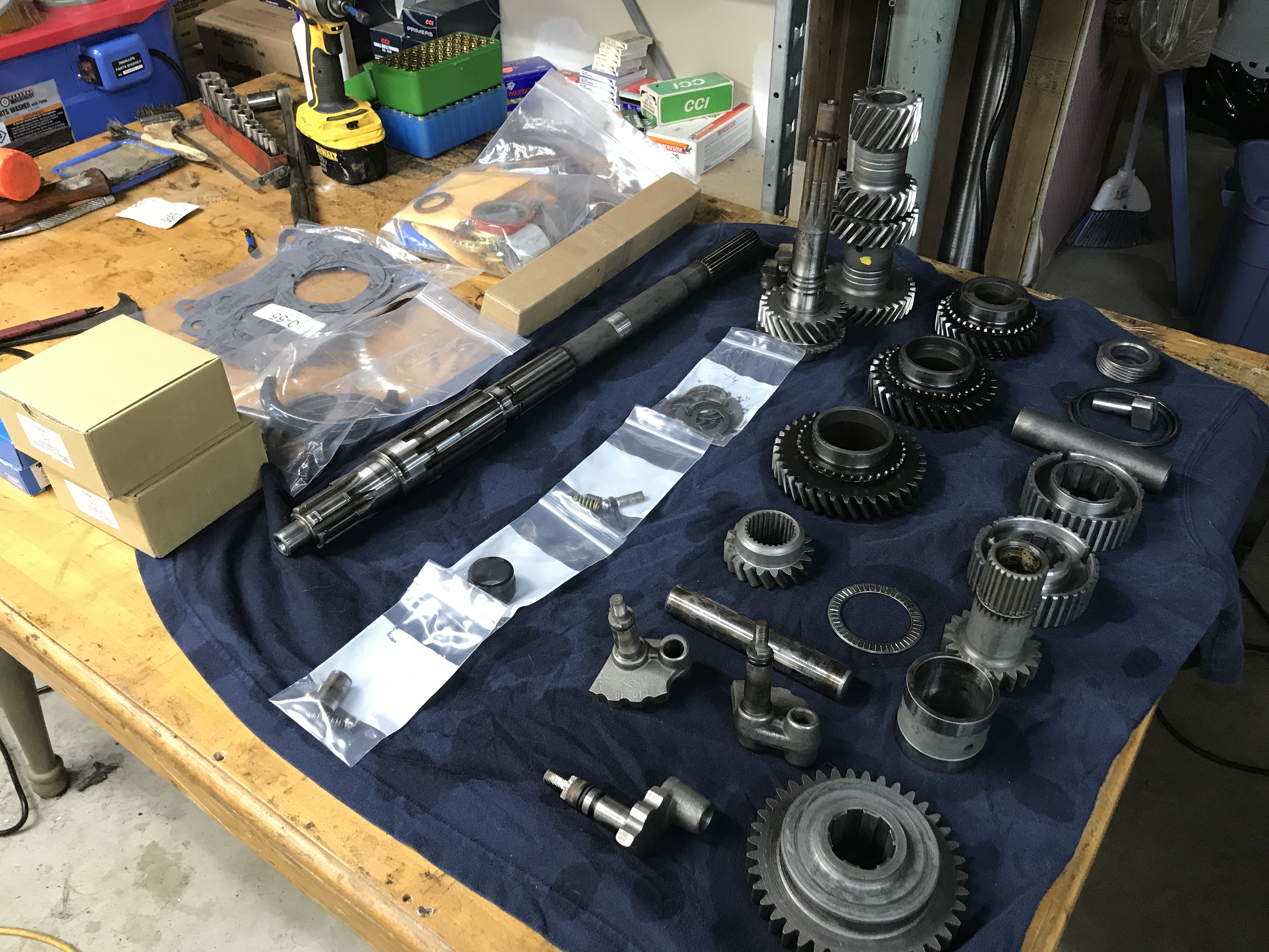

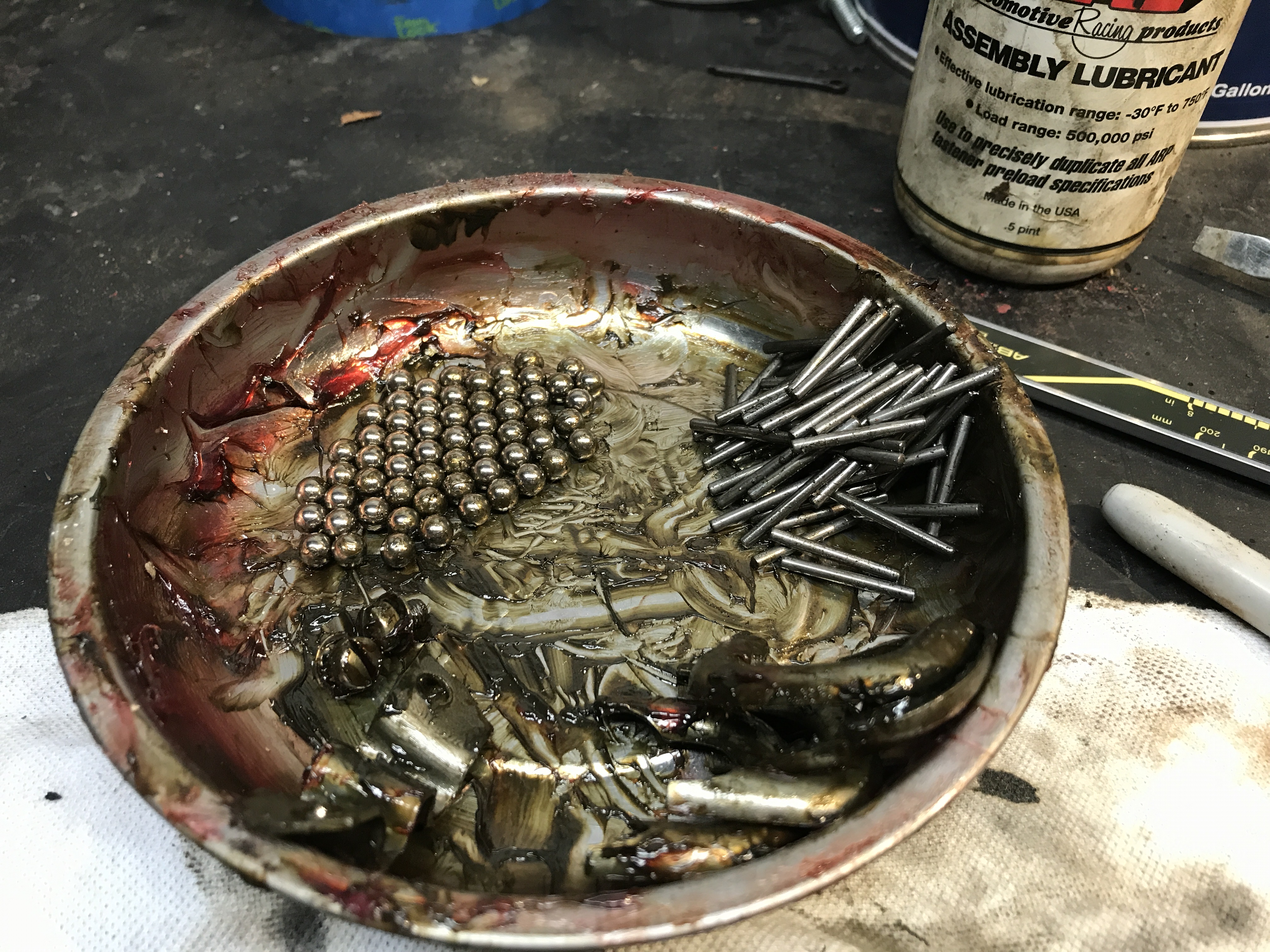

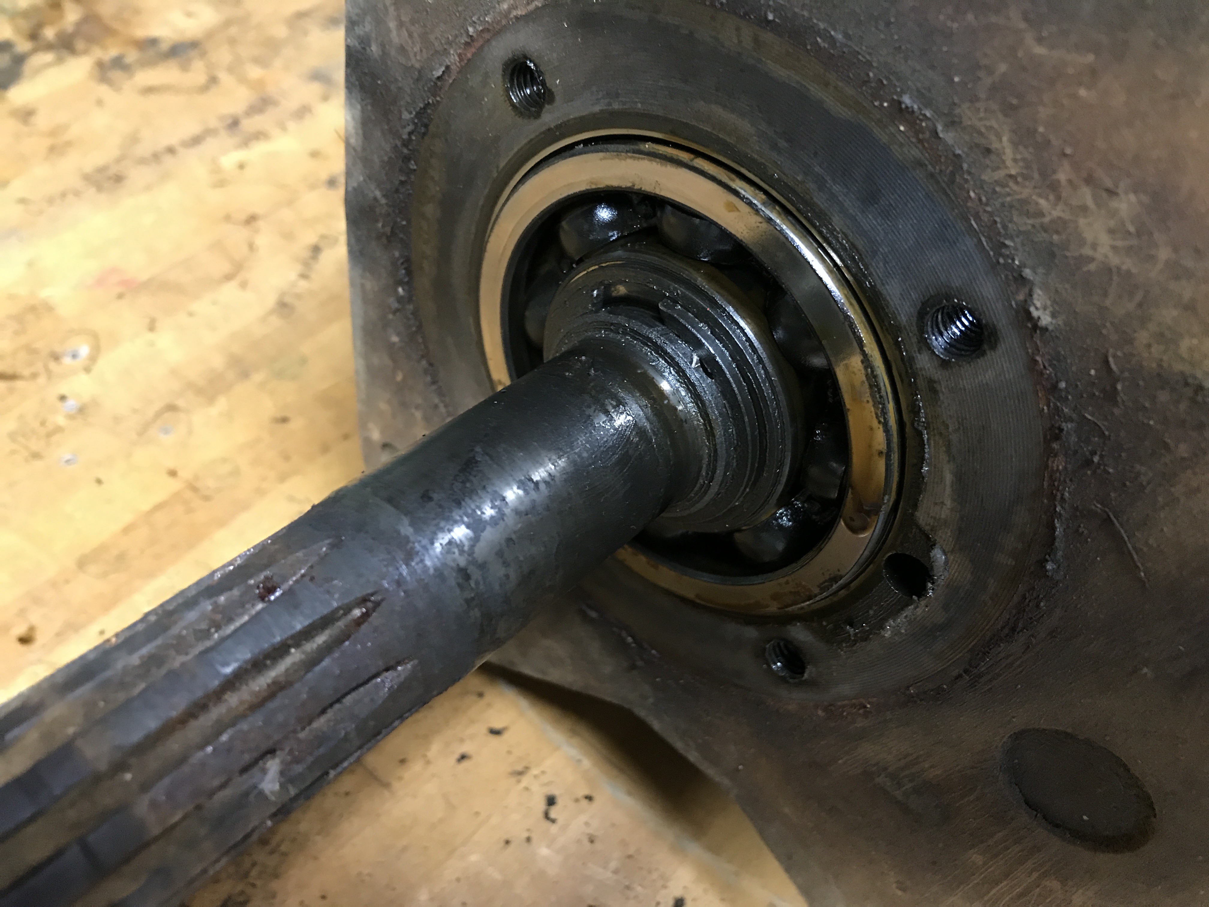

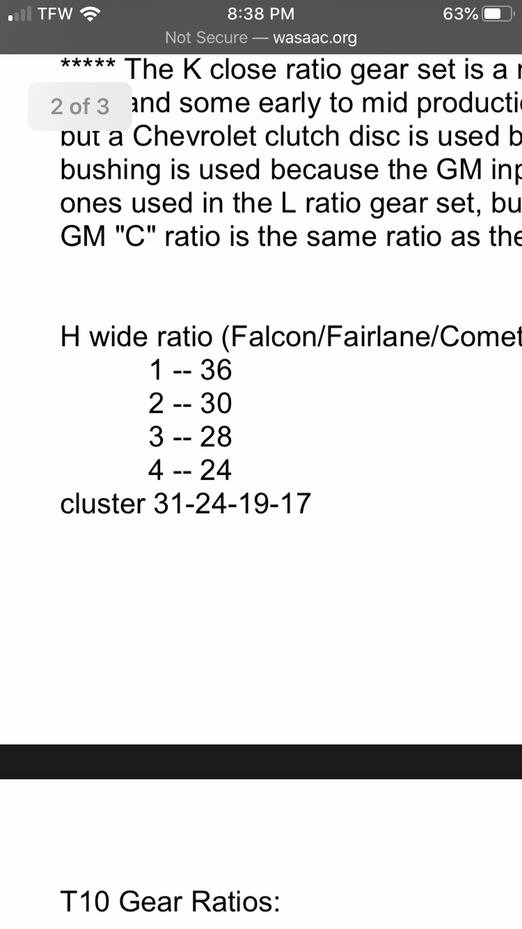

    In the Winter of 2019 I decided that it was transmission time so I started looking for the correct 4 speed. Again, FB marketplace delivered and a short drive to Ohio later I had a T10. The previous owner told me that it came from a wrecked ‘65 Cyclone and had been sitting around for decades. I popped the cover before buying and she looked clean so $350 later I was on to my next adventure.
    A little research and it’s a wide ratio run of the mill wide flange T10.

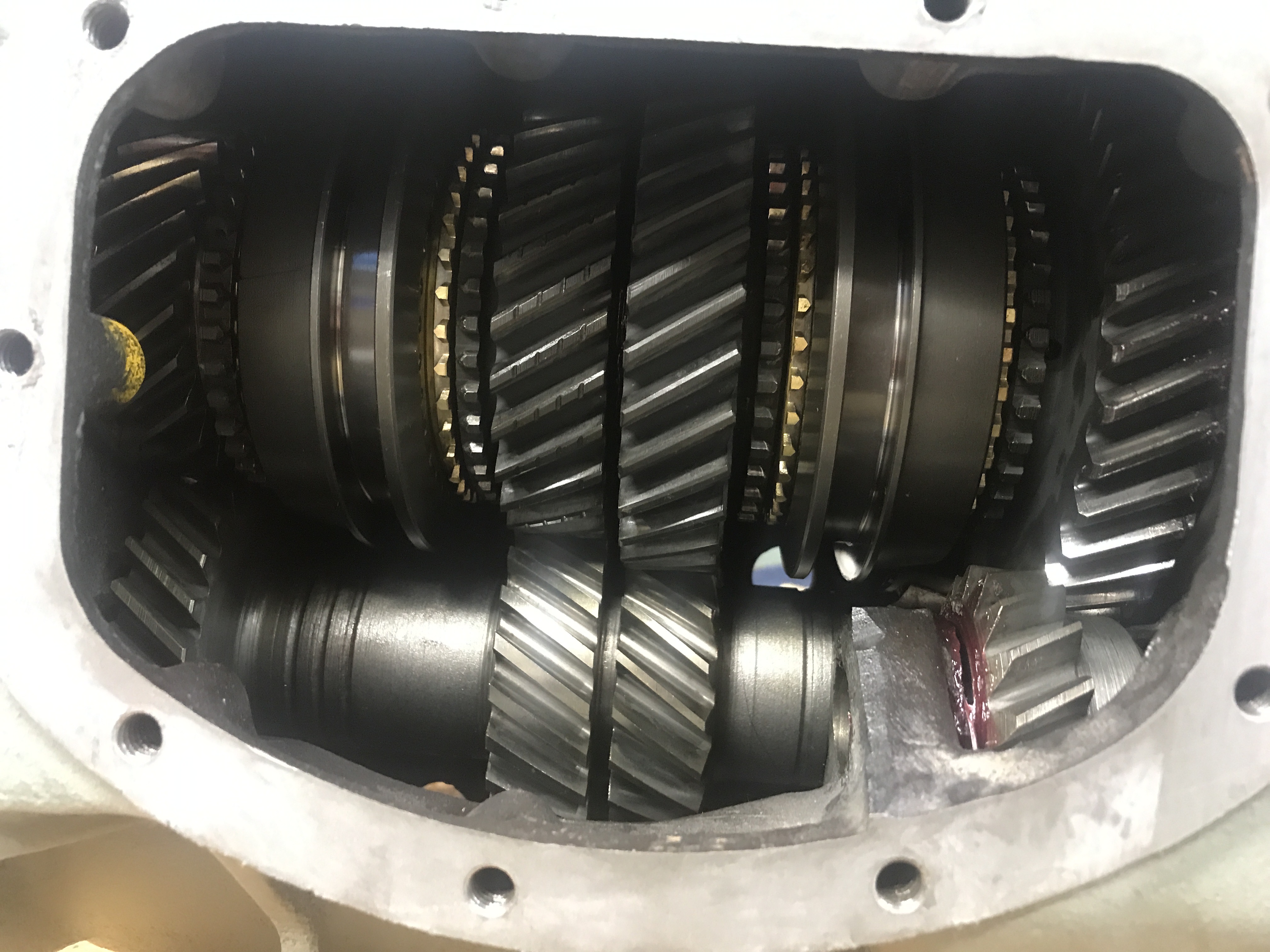

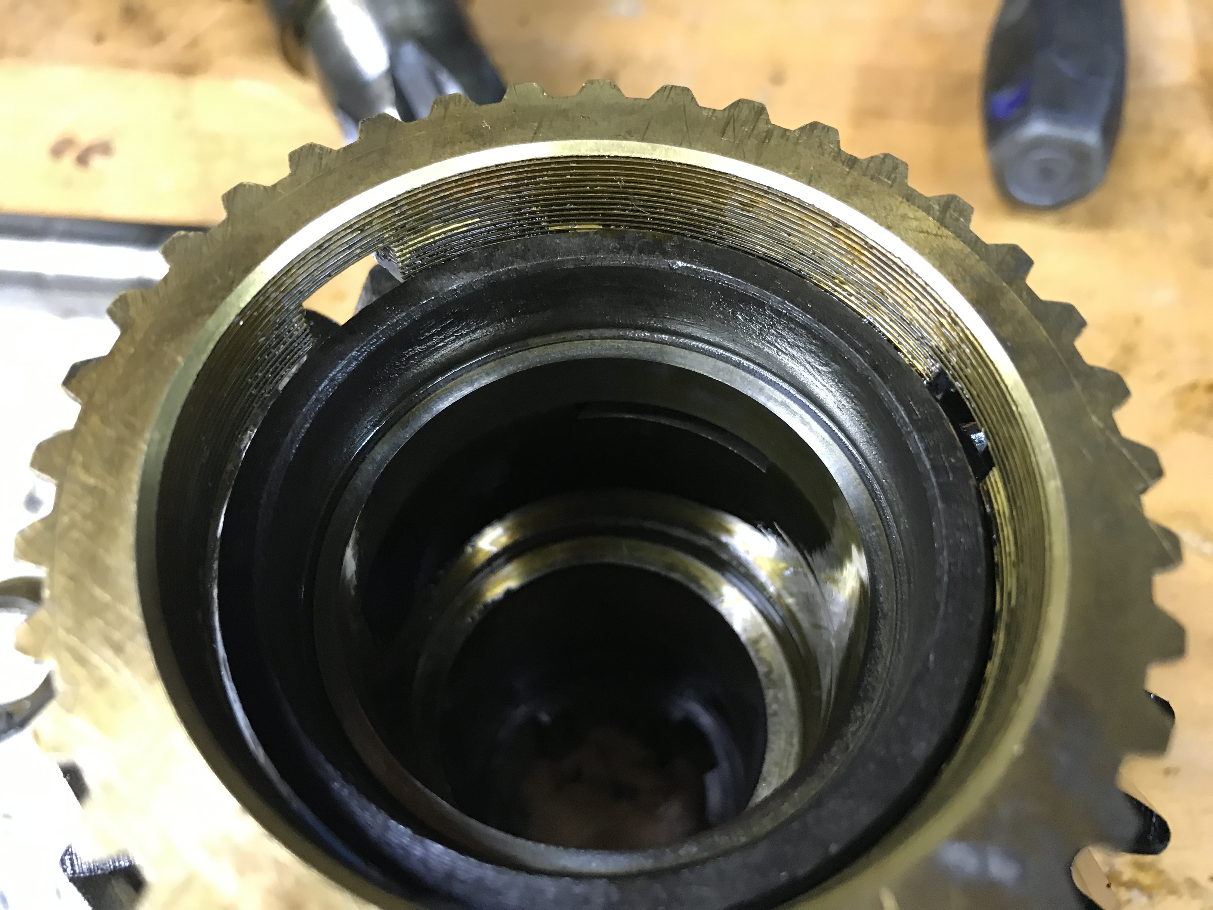

    Dis***embly wasn’t very exciting except for some porosity where those needle bearings ride. So new cluster gear shaft it was
    I bought a pretty straight forward complete rebuild kit, new cluster gear shaft, reverse idler shaft, forks and upgraded synchronizers and keys that supposedly help with the pop out of 2nd gear deal.
    After A LOT of soaking and scrubbing and some sandblasting I bolted it back together and primed and painted

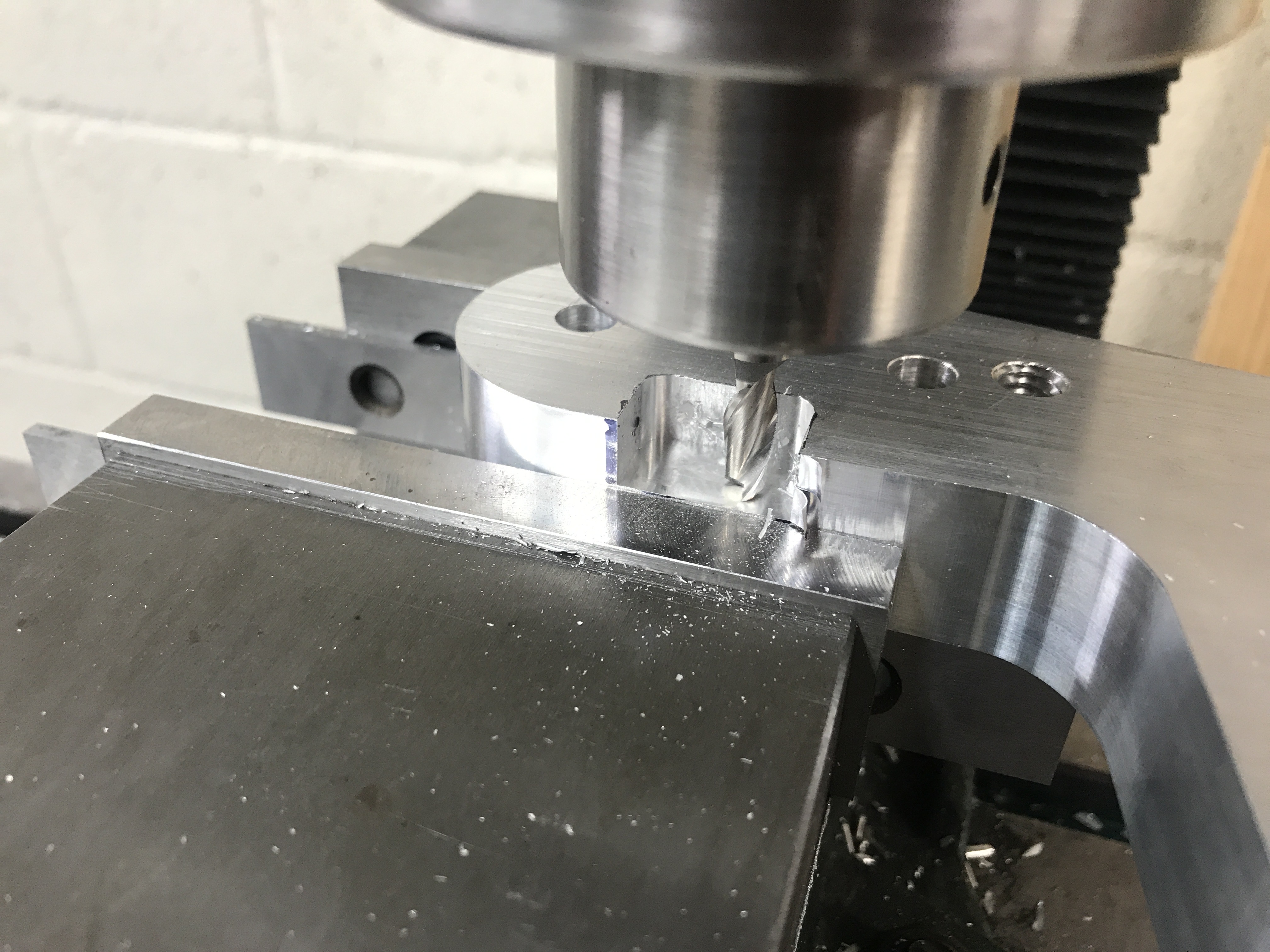

    eBay provided a reconditioned Hurst and install kit. The mounting bracket required some time on the mill to relieve so it would actually bolt to the tailshaft housing.
    Then this week a NIB QuickTime bellhousing showed up on FB marketplace about 10 minutes from me for a price too good to p*** up.
