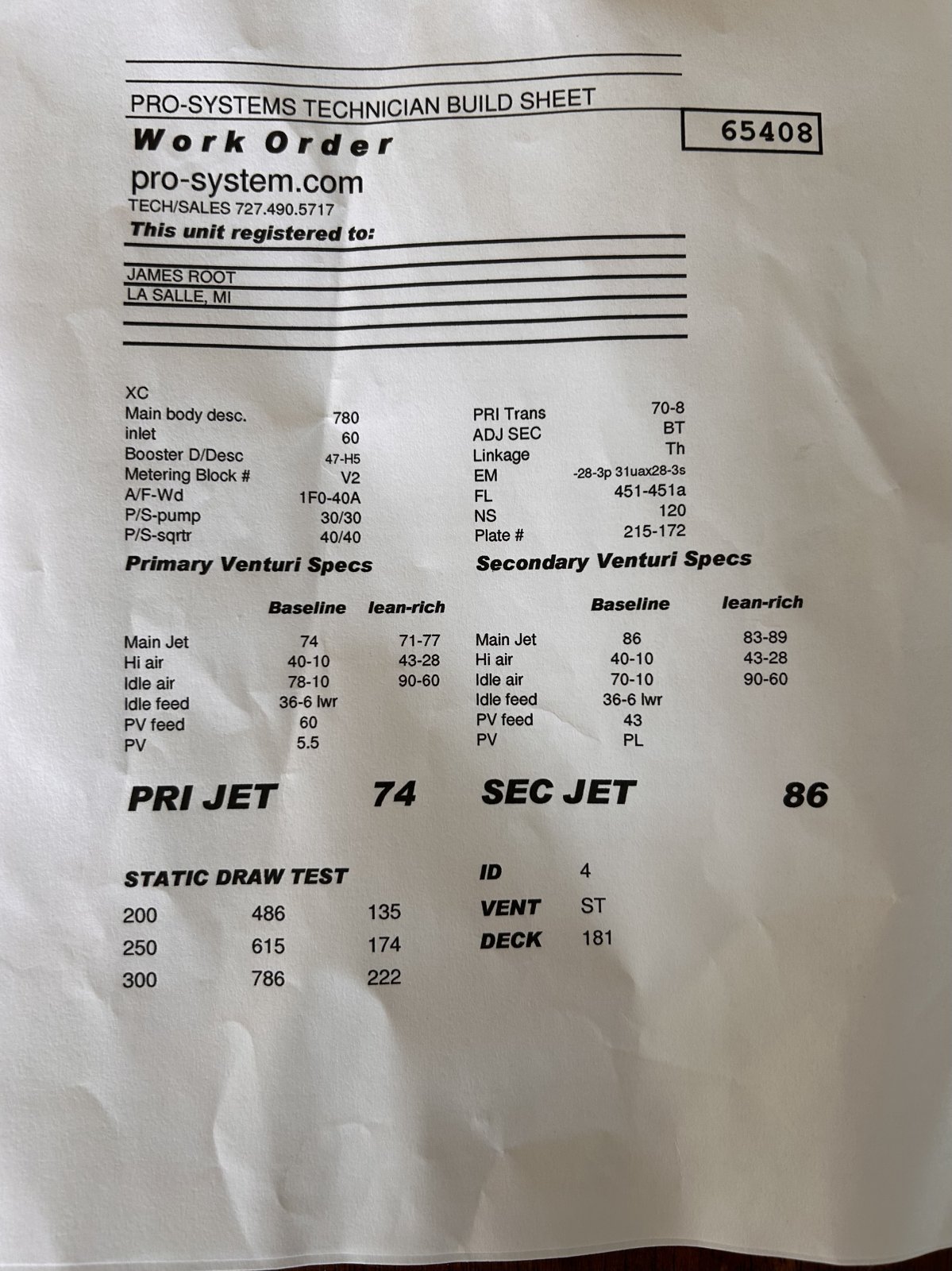

    With a set of M/T drag radials you’re going to destroy that 8 inch diff. Carb around 750 cfm? Nice build.

    780 body, 750 plate

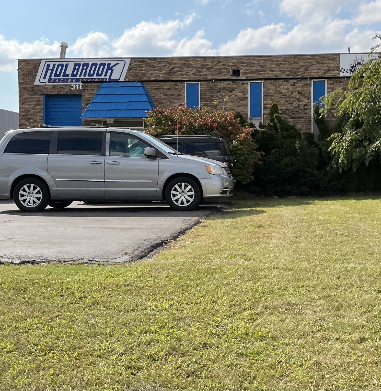

    Did manage to find a photo of the original 289 after dad and I “rebuilt” it circa 1988. Holbrook Racing in Schoolcraft originally did bottom end rebuild (name stamped in crank) but there was a piece missing from one of the mains - literally. So new bearings and crank it was. In my benevolence I hand ported the heads and gave her a valve job in HS auto shop - had an uncle who was a machinist who did screw in studs. The intake came from the m***ive swap meet that to be held adjacent to MIS in the Irish Hills. Carbs came from a swap meet in Toledo - one was always junk! Camshaft & springs were the solid lifter flat tappet that used to be offered decades ago in the Ford SVO catalog. Still have the headers - albeit a bit more beat up and rusty. Pretty sure I am going to eventually just buy a set of Doug’s.

    Did you go to Jefferson??? Cousins all went through the Auto Shop program there bitd…I live 5 blocks from Holbrook…still in the same spot..

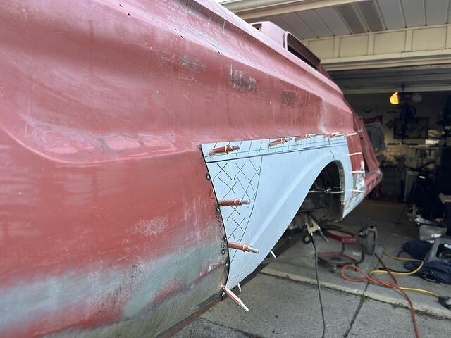

    Last year I finally found a sigh of relief when a gentlemen on the FB decided to pound out and offer rear quarter repair panels. I promptly jumped on a full set as it was a better option than just using fibergl*** and while i may be somewhat talented I am no tin knocker by any stretch of the imagination... I recently dove in head first with replacing quarters. P***enger side first as that side is the least eroded side. This is my first foray into ever replacing sheetmetal on a vehicle. Been "different" to say the least. These panels require a little m***aging but they are 100% useable. Too bad he only made a limited run and stopped.
    I ended up welding up the erosion on the inner fender and then giving it a couple of layers of gl*** weave and West Systems Epoxy on the face for some strength and sealing. The flange is intact. Not sure if I am going to weld the fender lip or if I am going to trim the lips mostly away and bond it with 3M 8115. Opinions?
    Took some fitting and bending and tweaking to get the p***enger panels to fit but overall it was pretty easy. rolling the rear correctly to get it to mate properly at the end of the wheel well has the most challenging - it is close right now - needs some t******* and final rolling. I flanged the top of the original skin (still need to trim the replacement to sit in that flange). I got a little carried away when I began this endeavor and cut to size fore and aft so I tacked a strip to the back side of the car skin to let the new panel rest against so I could **** weld.

    Worked on the drivers side last week. Repaired the inner fender rot, new flange and pieced the skin together.
    I also took the opportunity to dig out whatever this sealer type stuff is that FoMoCo poured into the area between the outer skin and the inner structure and rocker. That void adjacent to the rear seat panels. The stuff definitely didn't "seal" the area and promoted corrosion.
