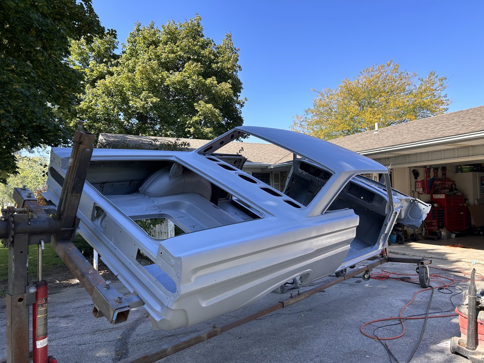

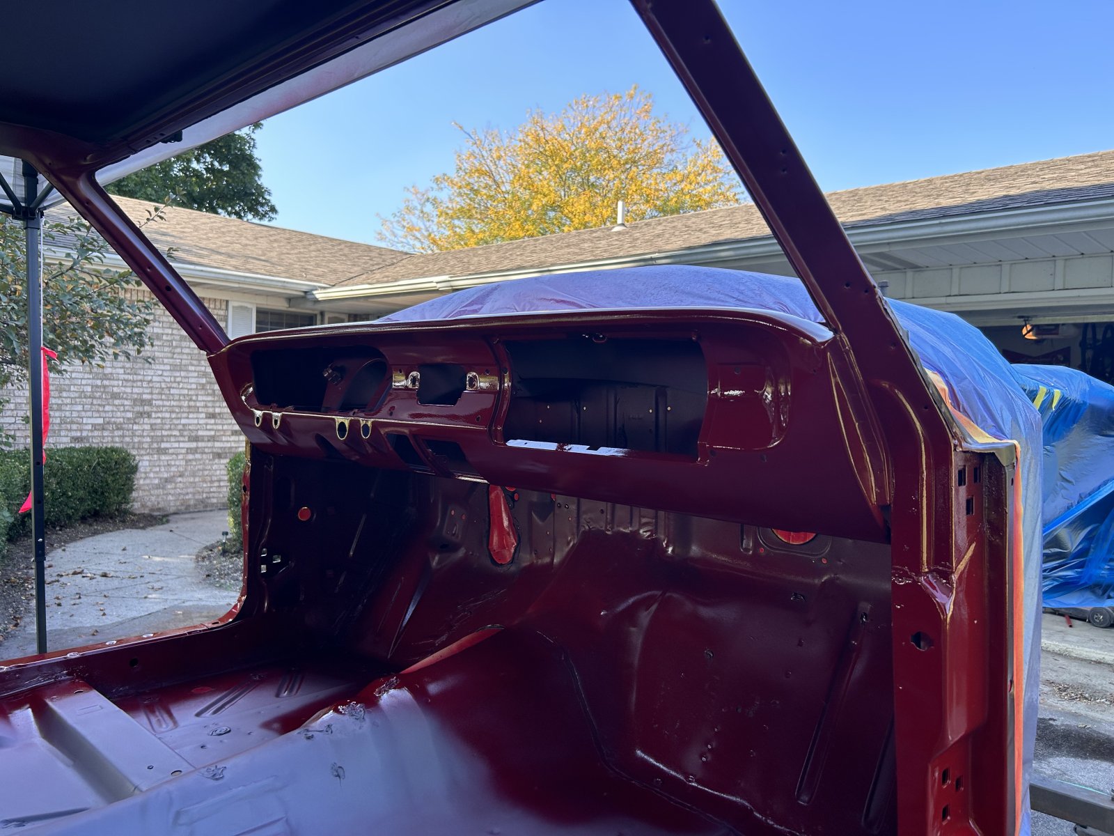

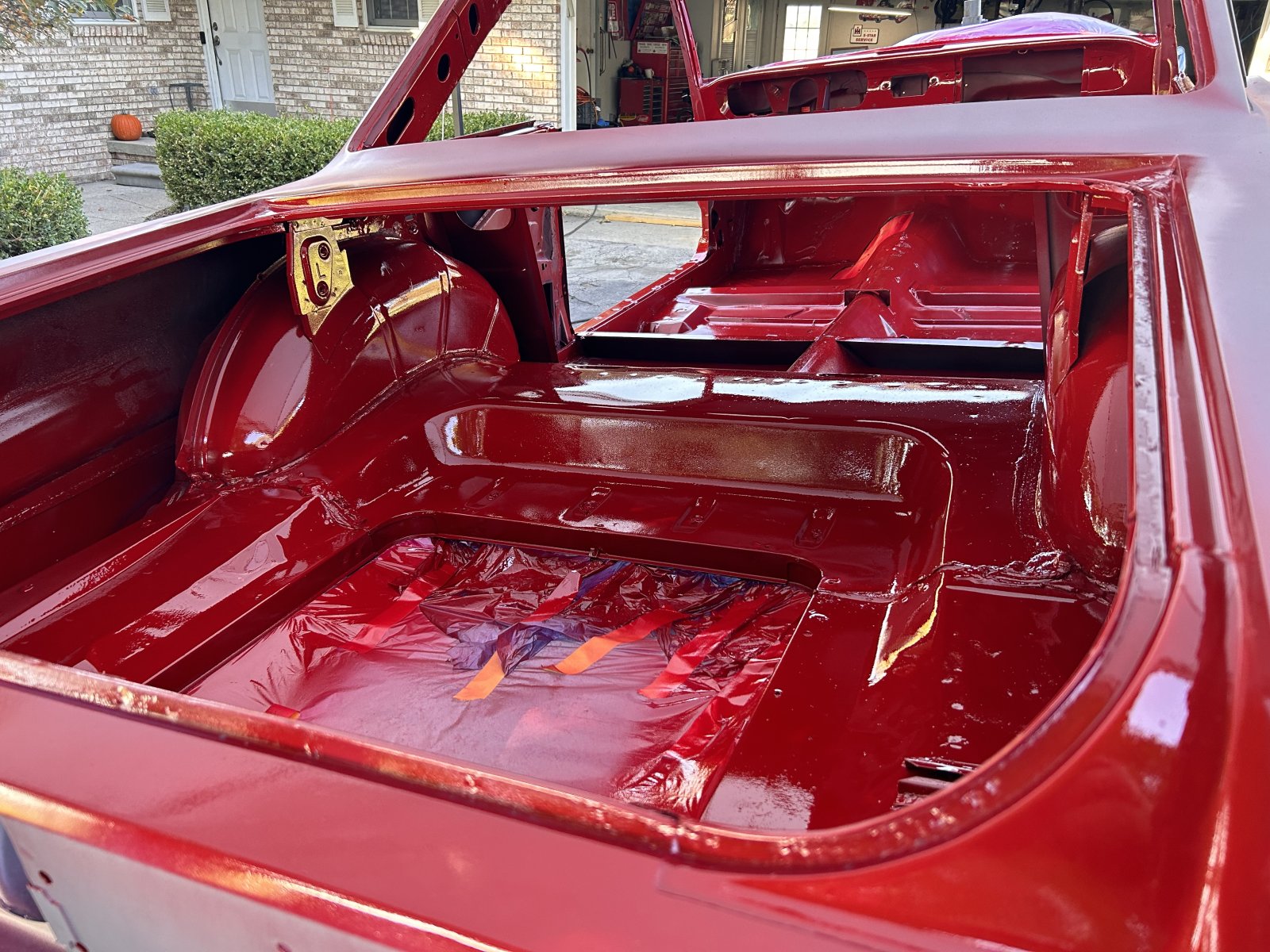

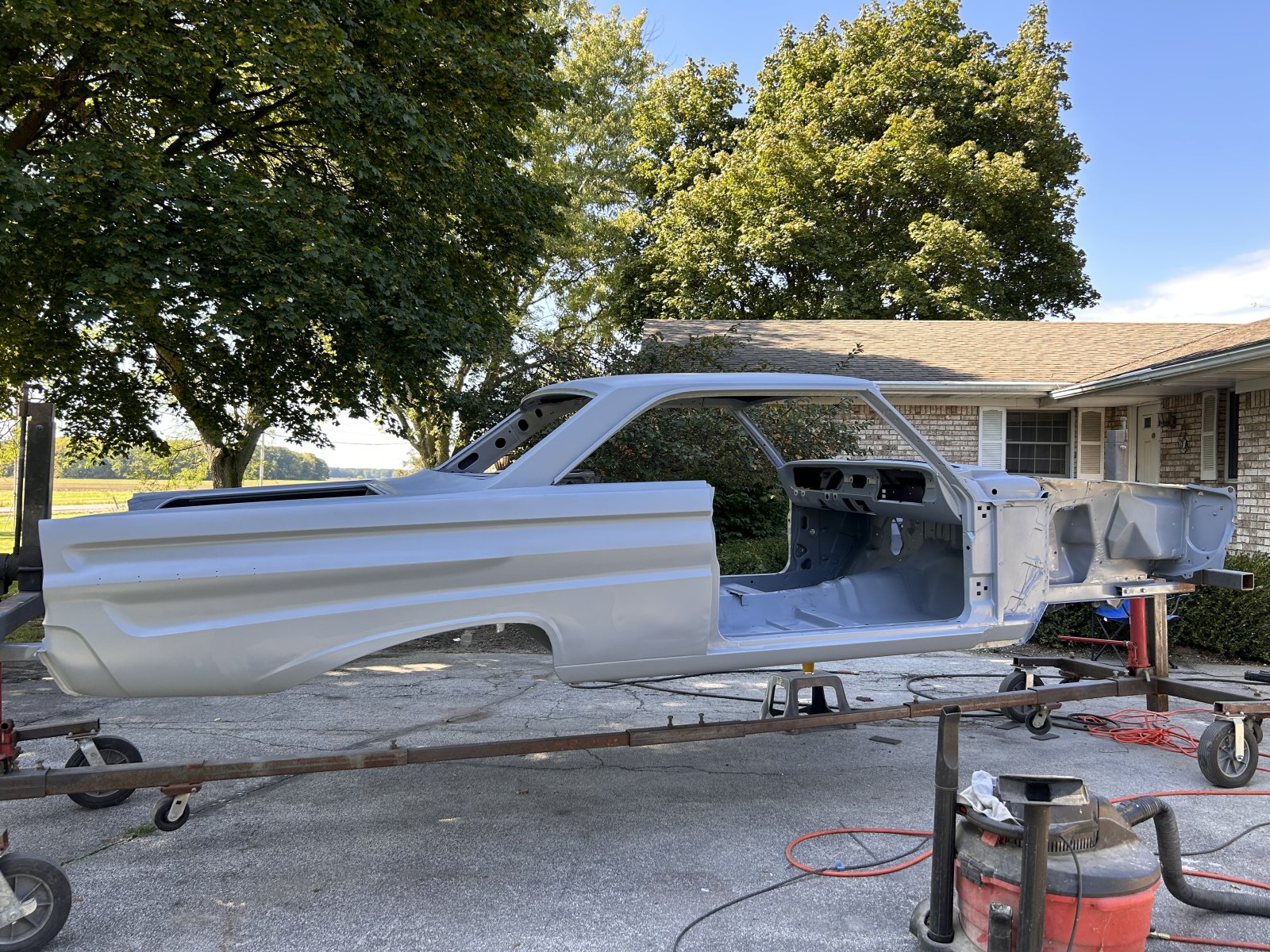

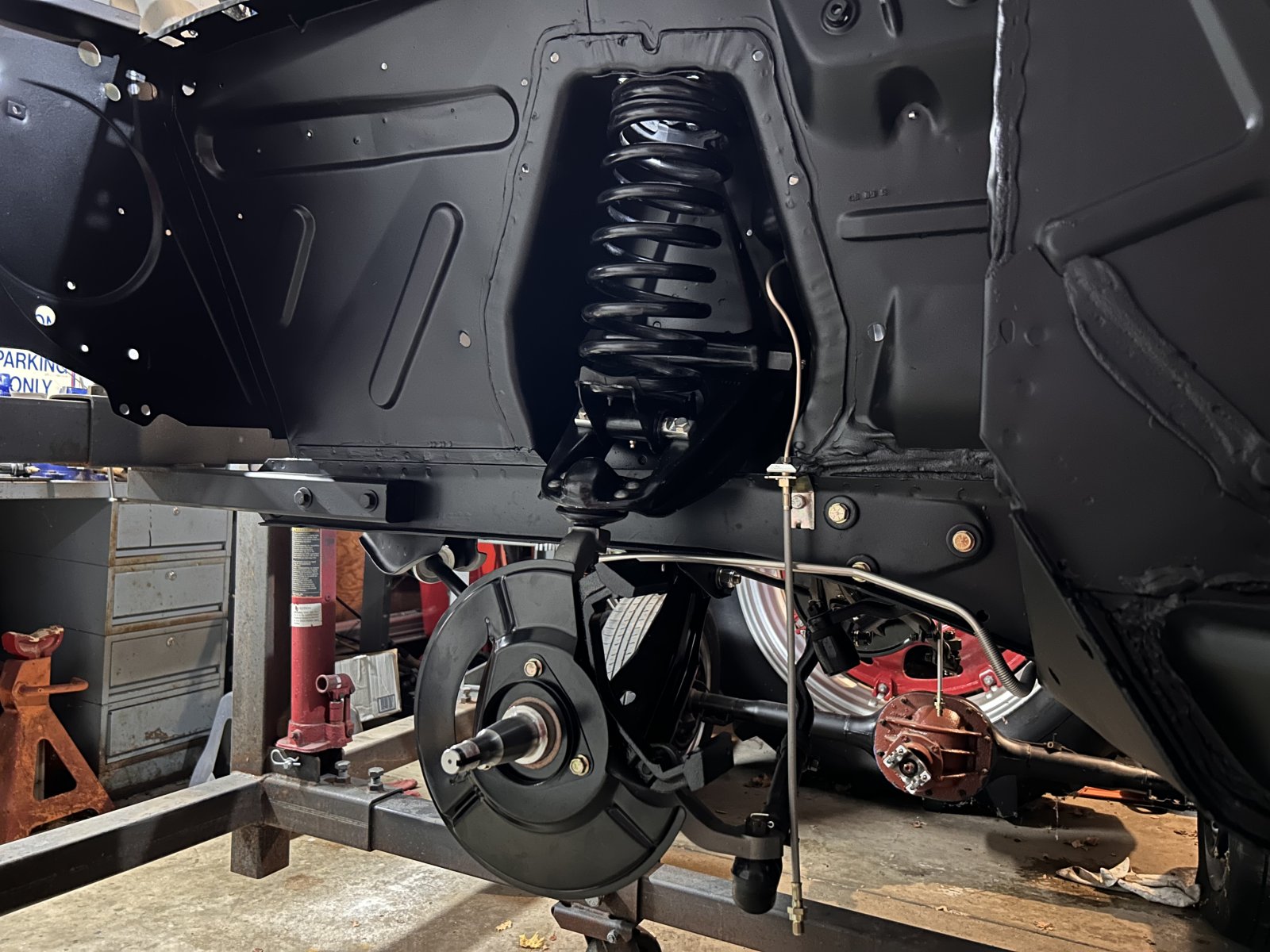

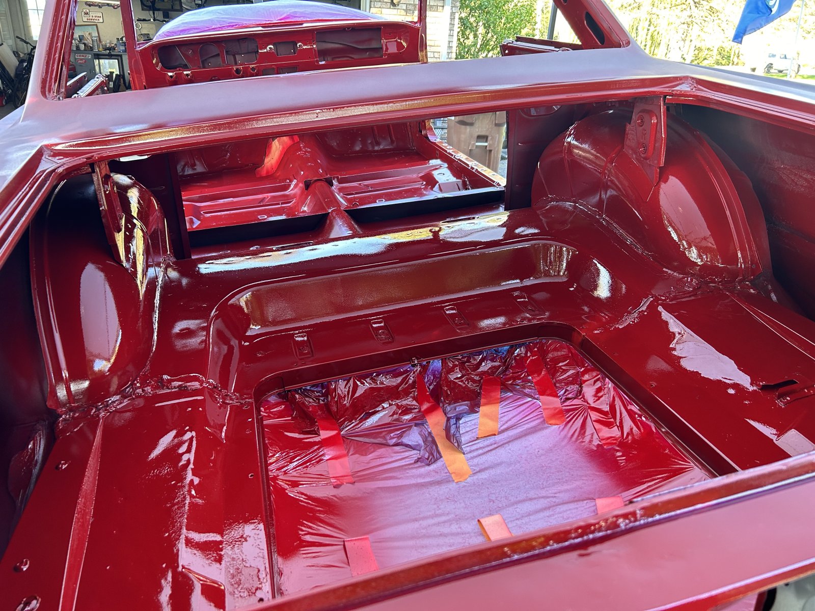

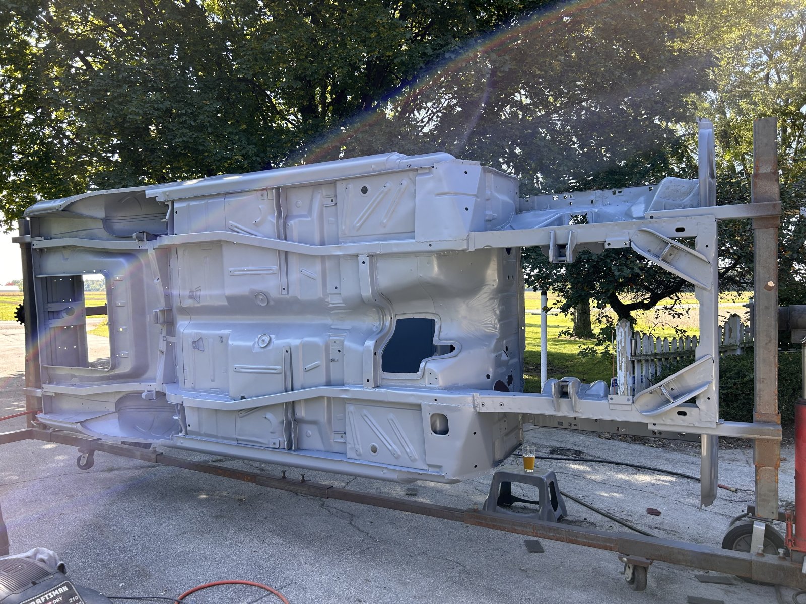

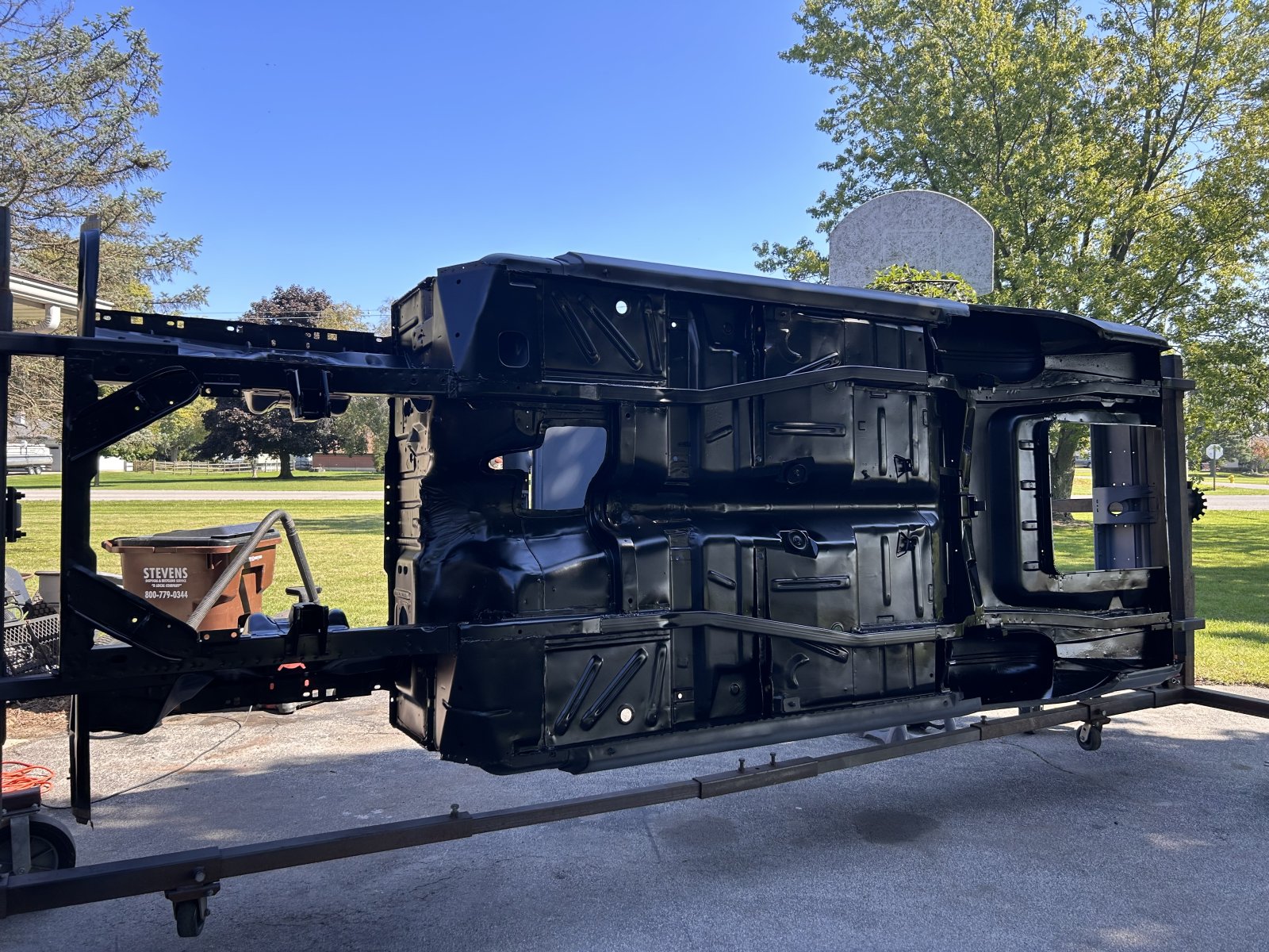

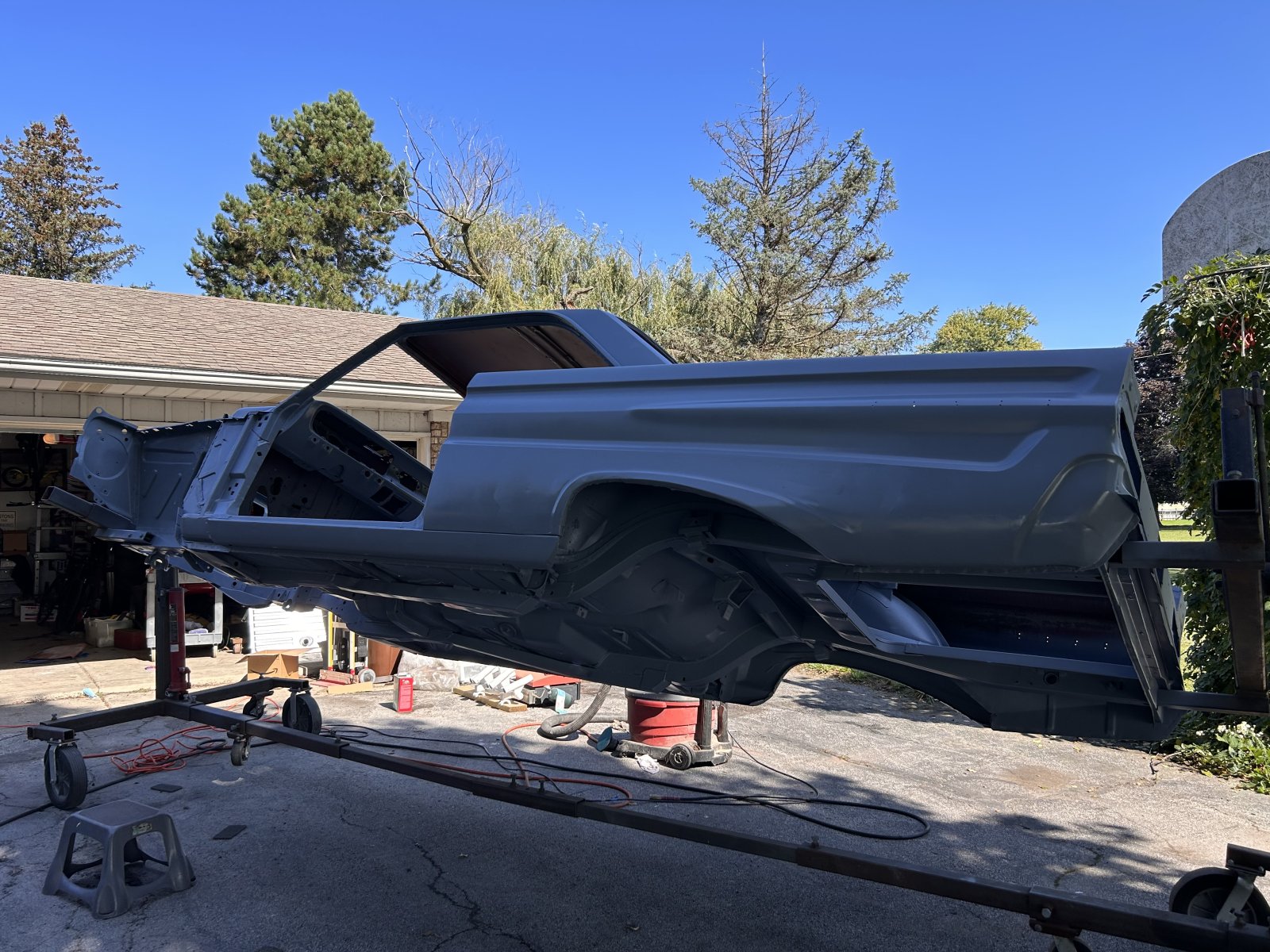

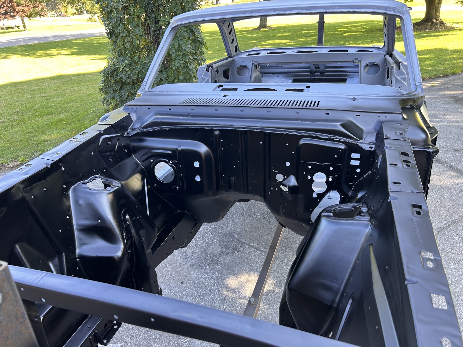

    Been a minute. Think all of the photos with X’s hotlinked from my own private hosting got to me.
    but anyway I got it all ****oned up and primed with PPG 2K epoxy a little 2K urethane satin black on the bottom and front and Carnival red on interior last Fall before the weather turned…. Spent another month in the garage starting to ***emble some stuff after that

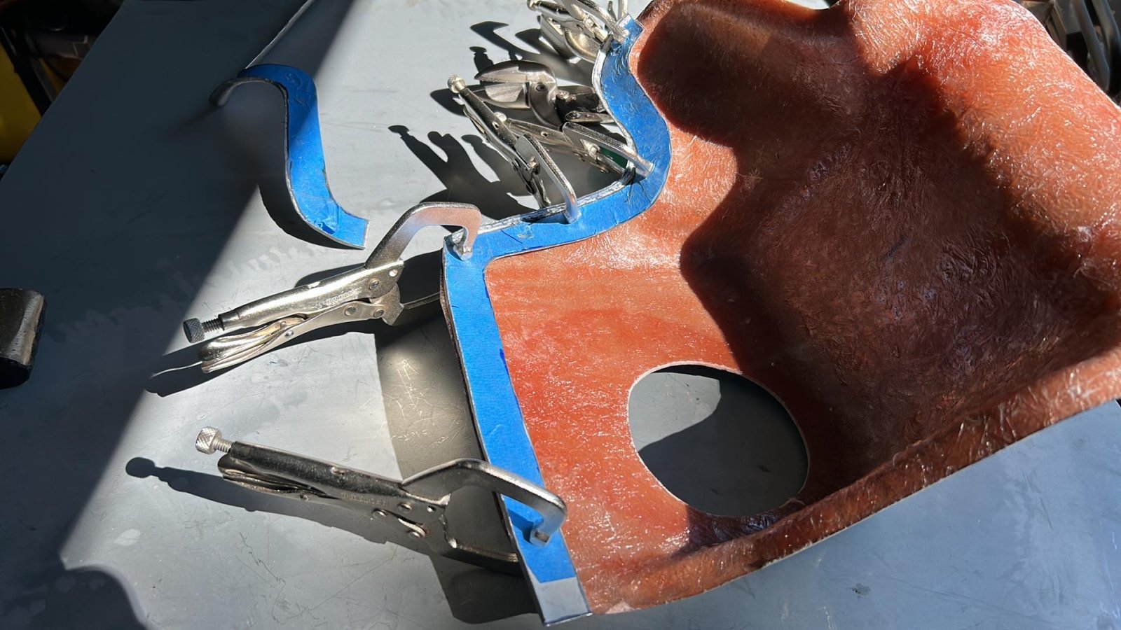

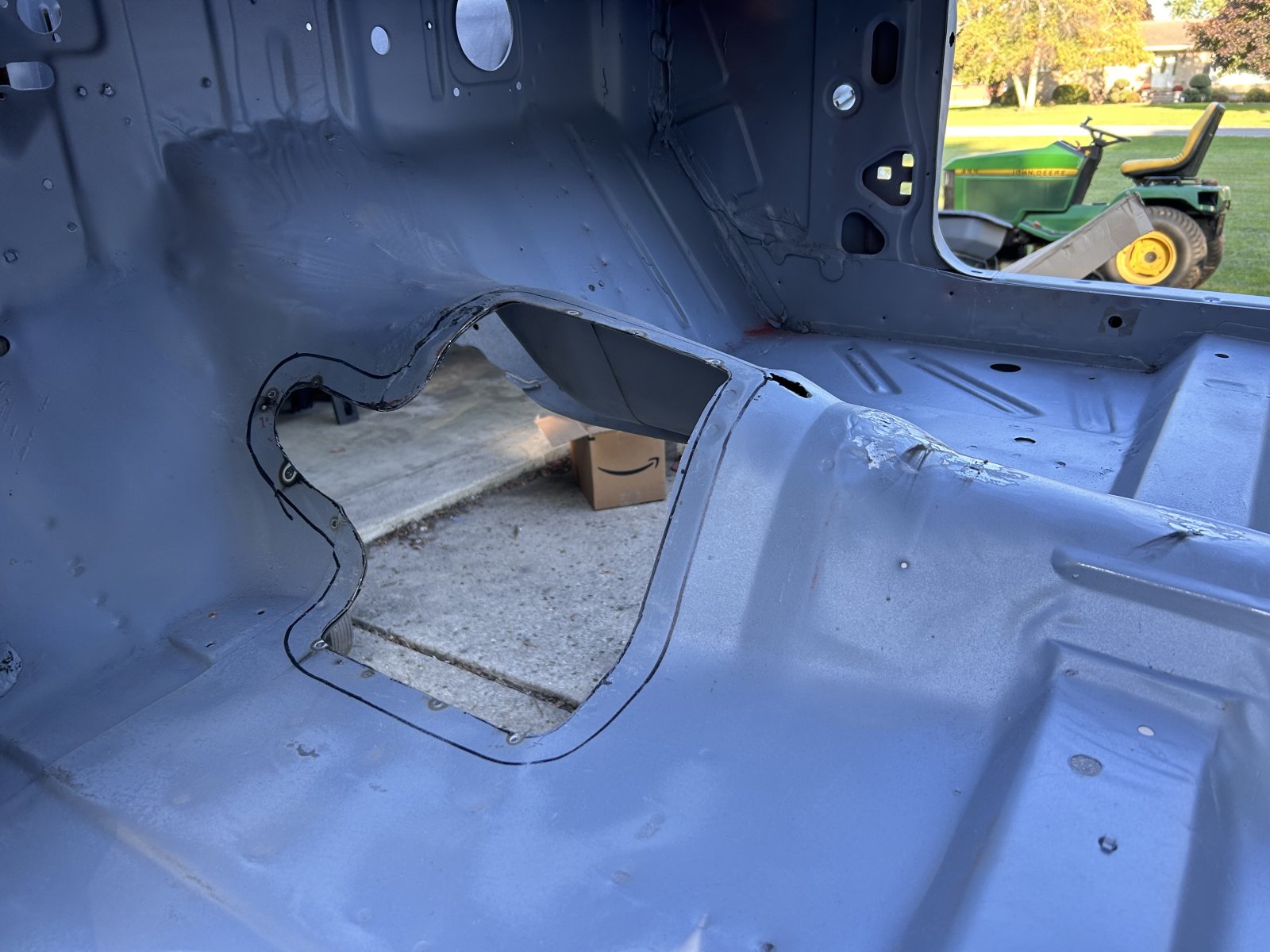

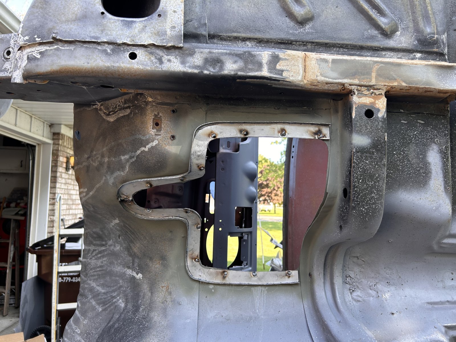

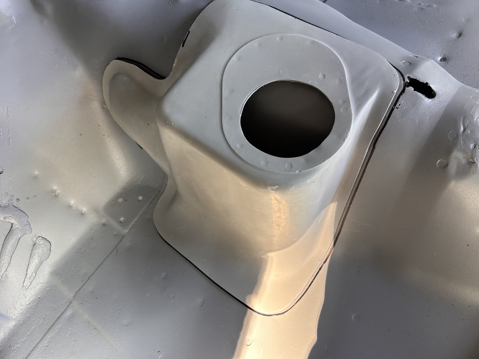

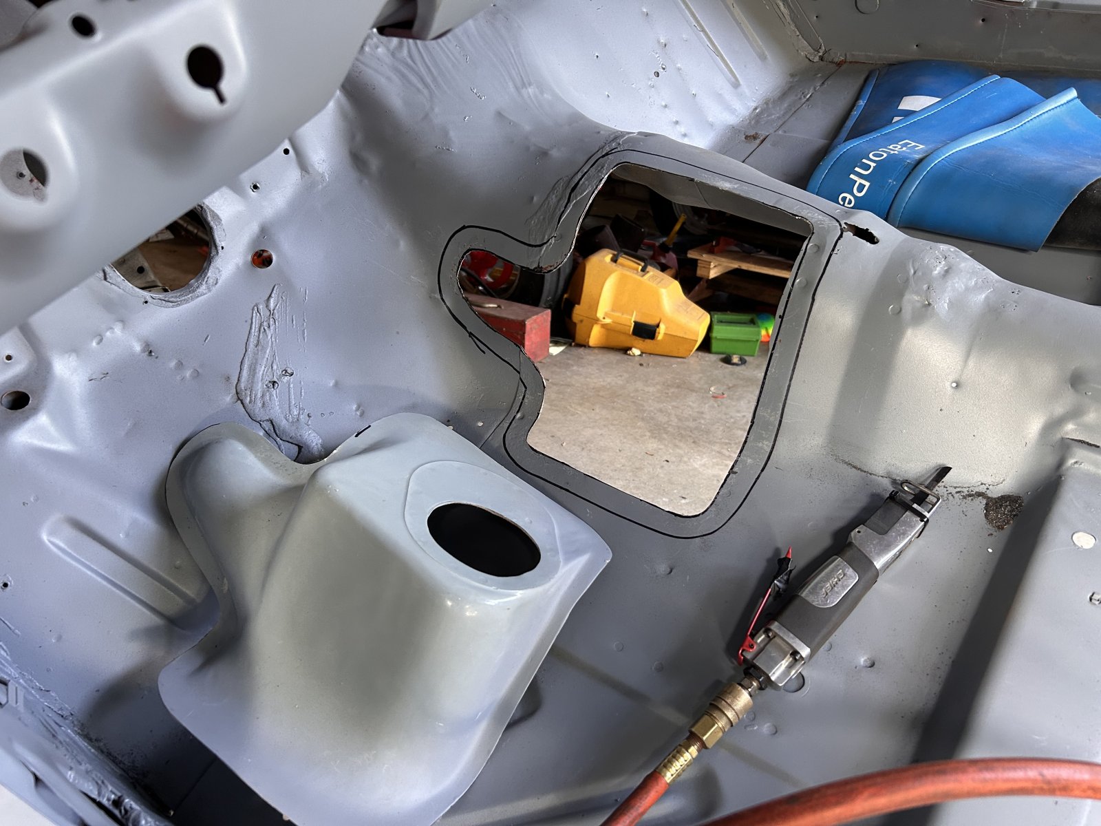

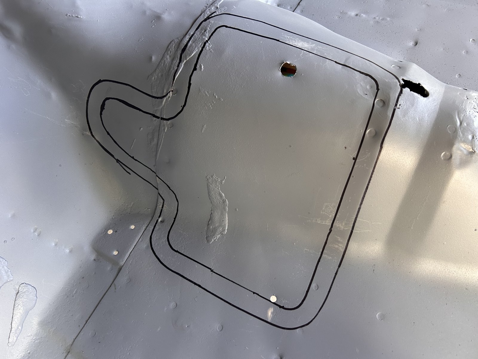

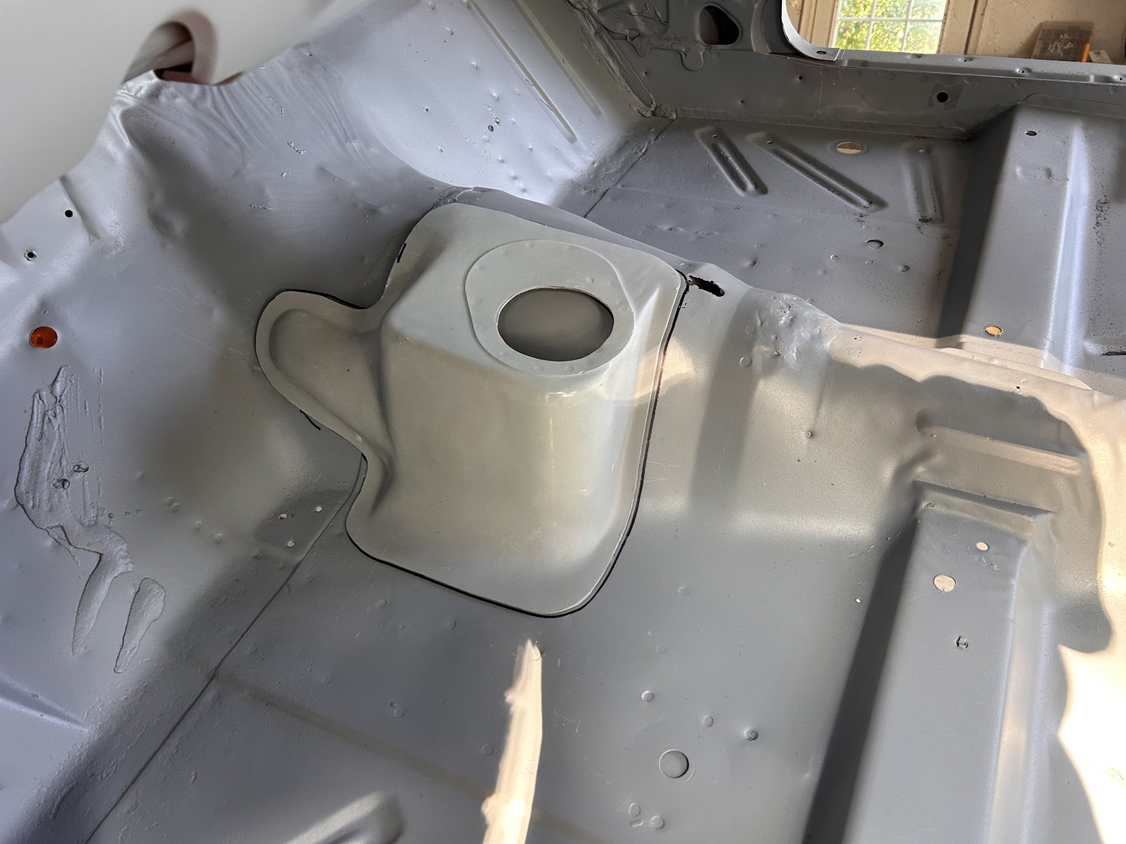

    Everyone knows that manual transmissions are more fun. I was like a kid in a candy store finally being able to cut this hole after dreaming about it for the last 25 years
    IMG_1936.jpeg IMG_1934.jpeg IMG_1937.jpeg IMG_1951.jpeg IMG_1943.jpeg IMG_1947.jpeg IMG_1948.jpeg IMG_1935.jpeg

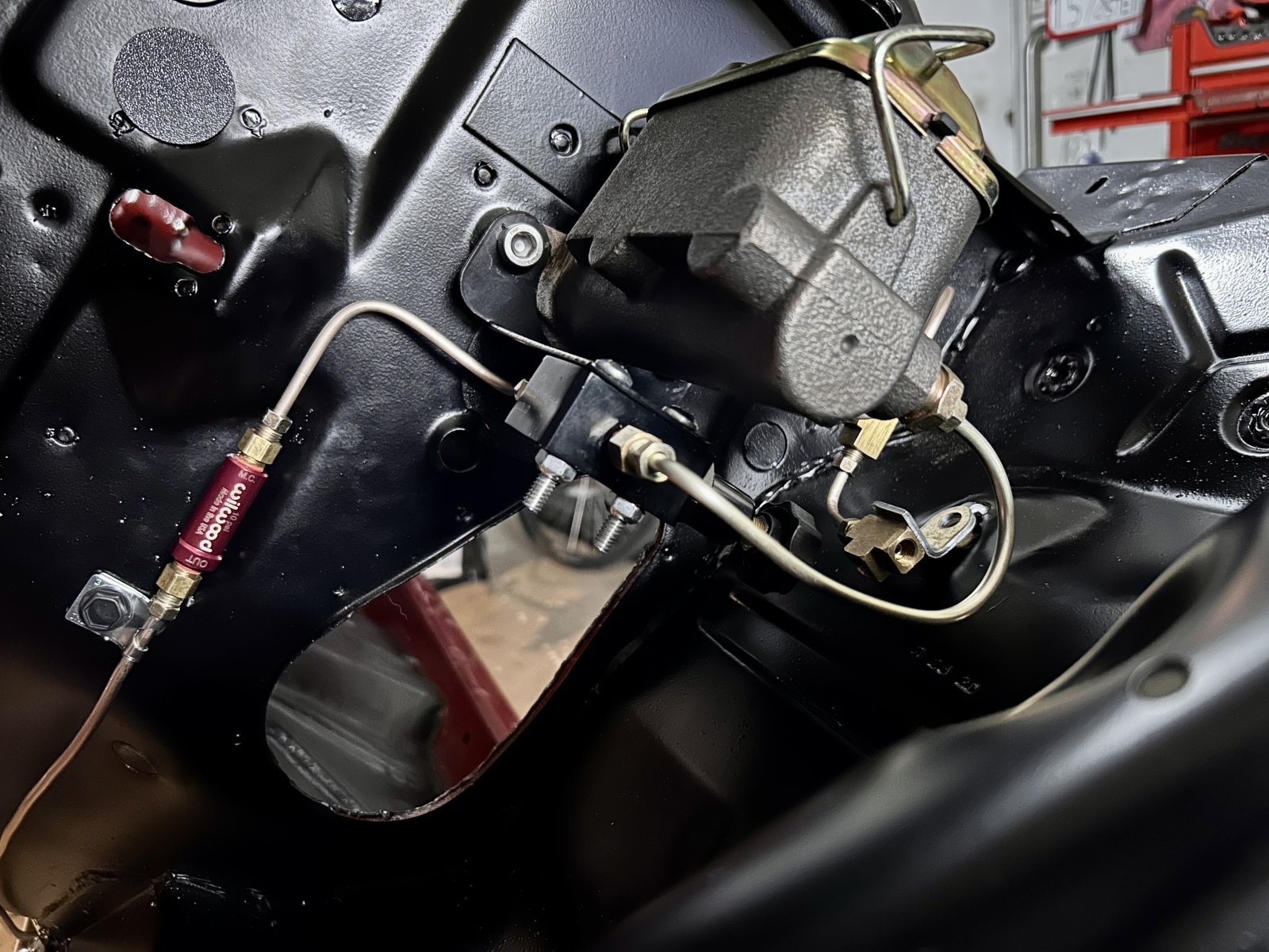

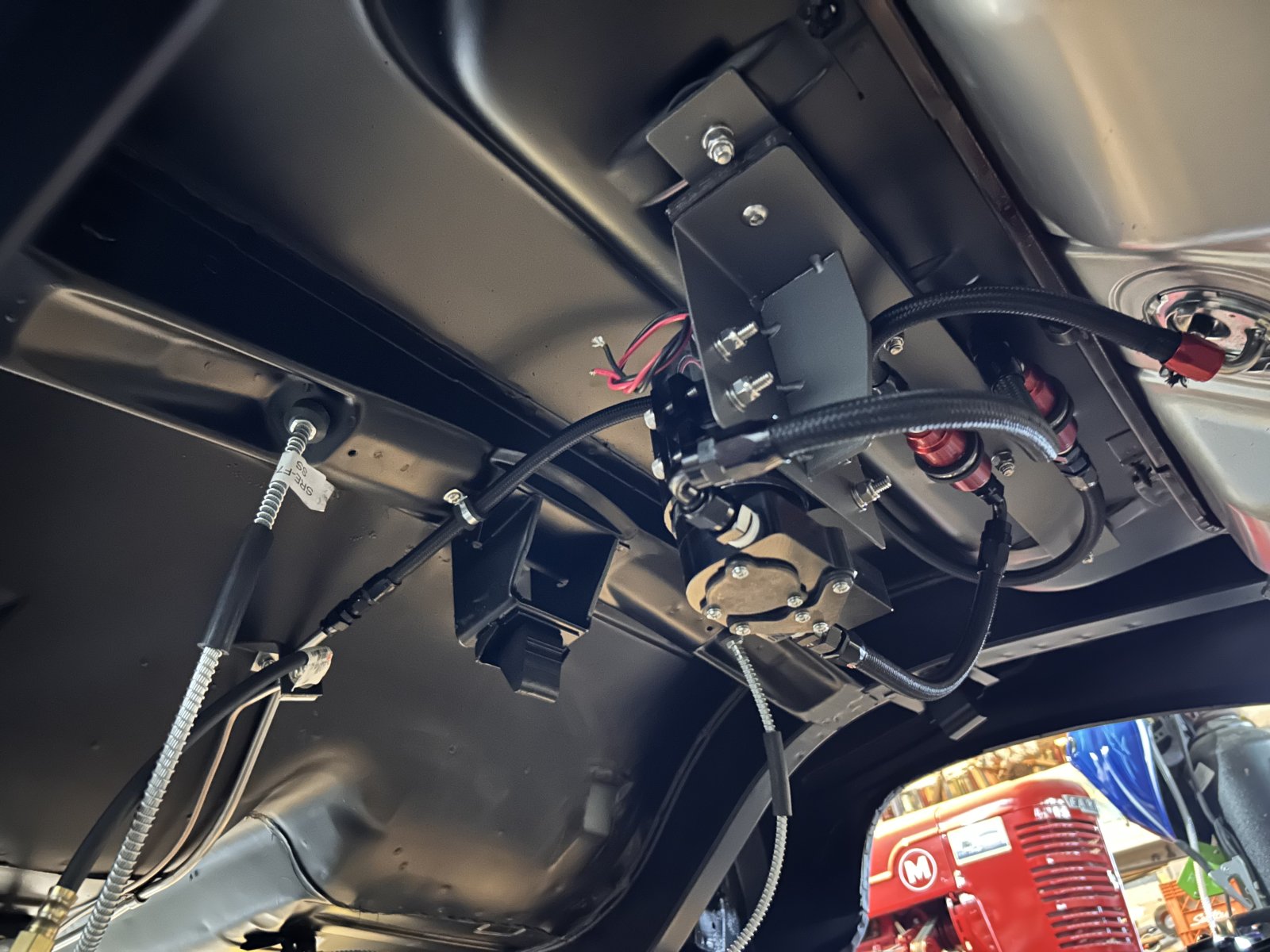

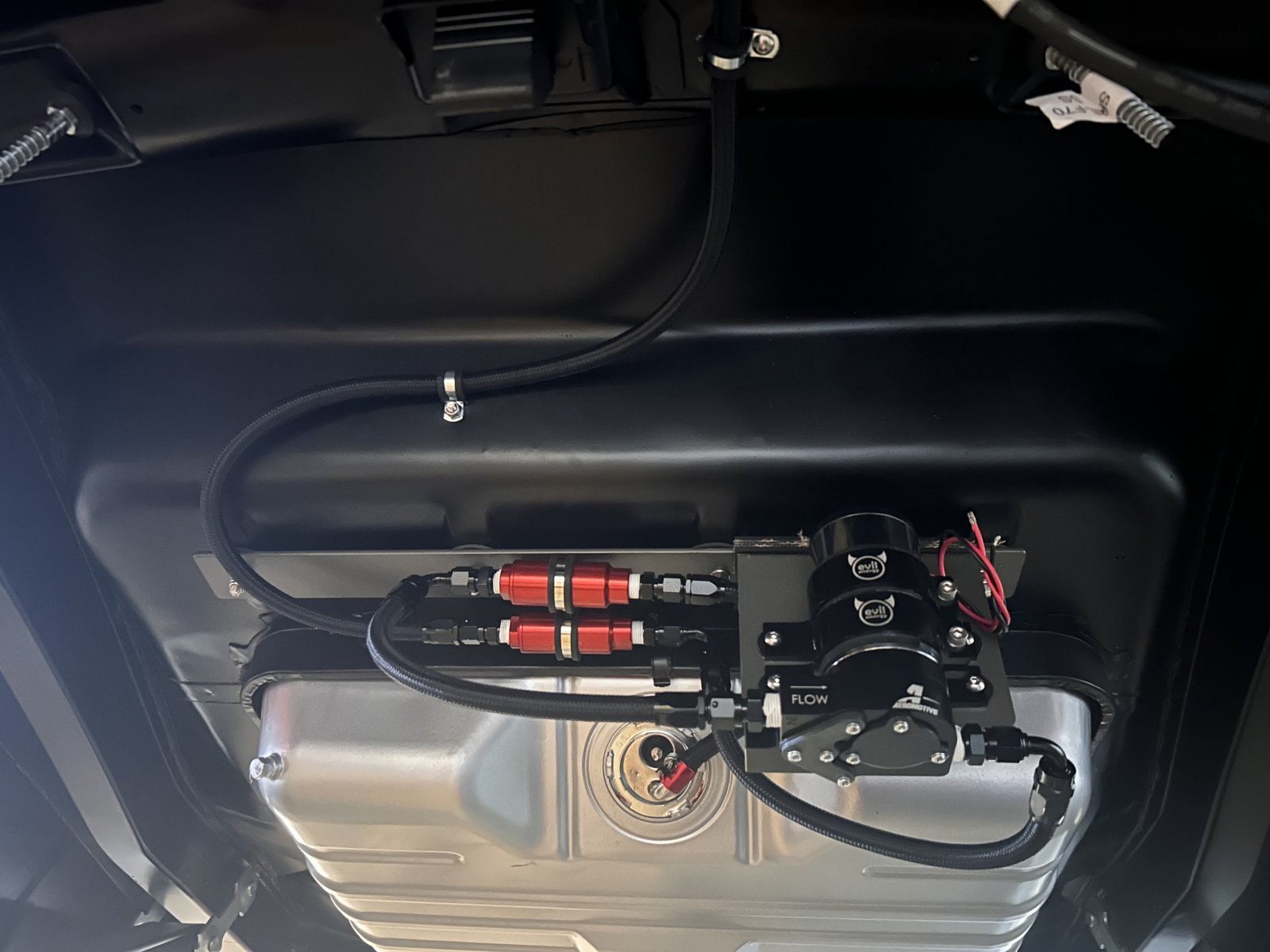

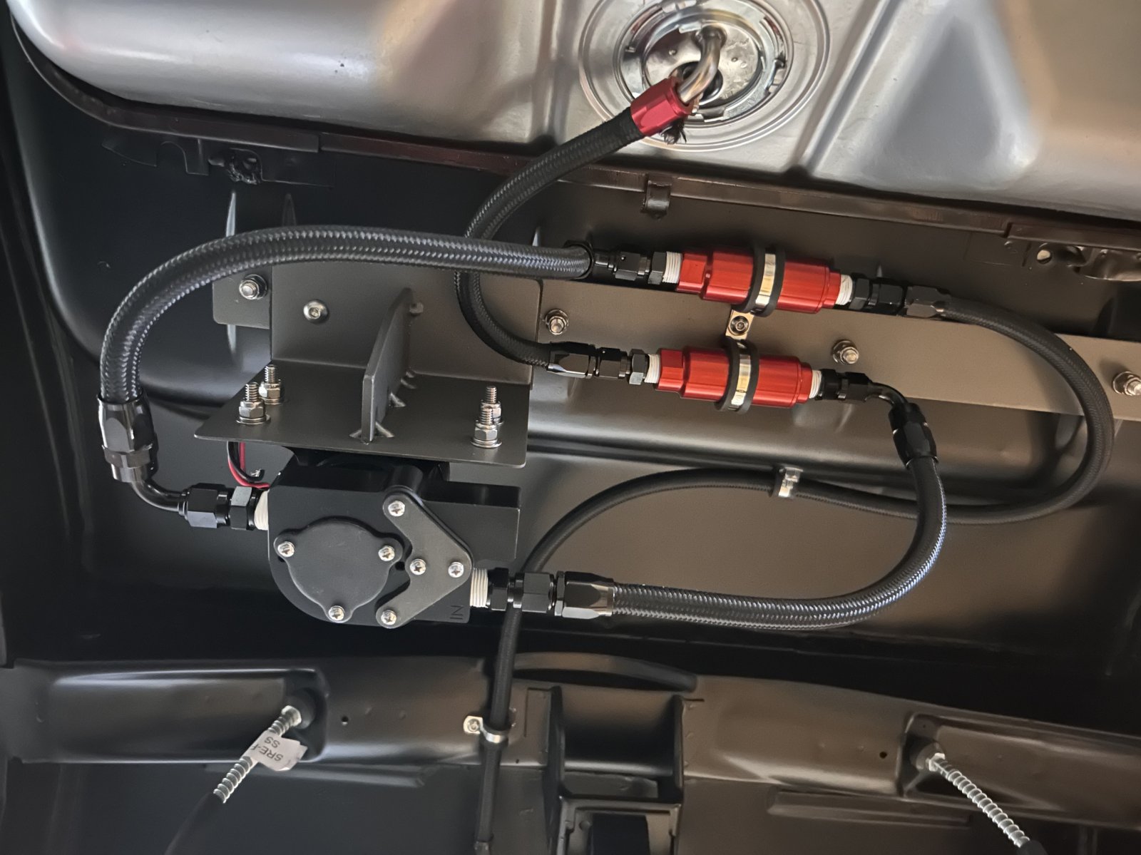

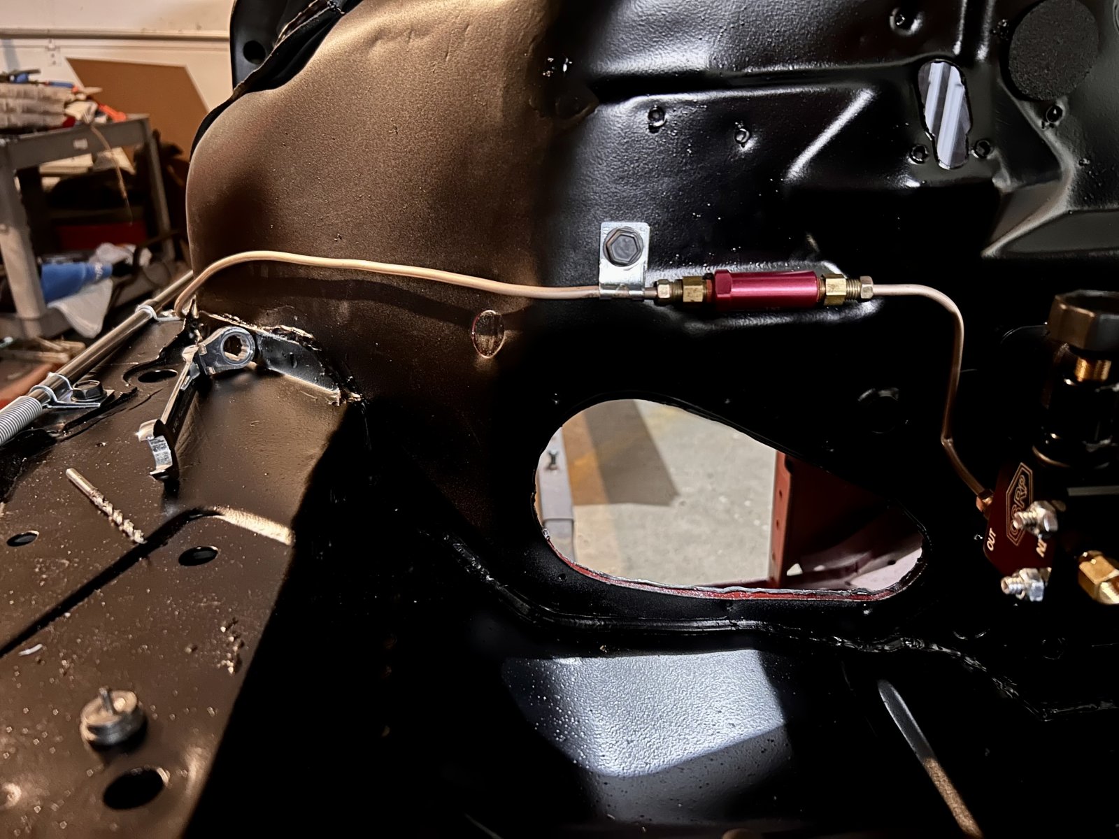

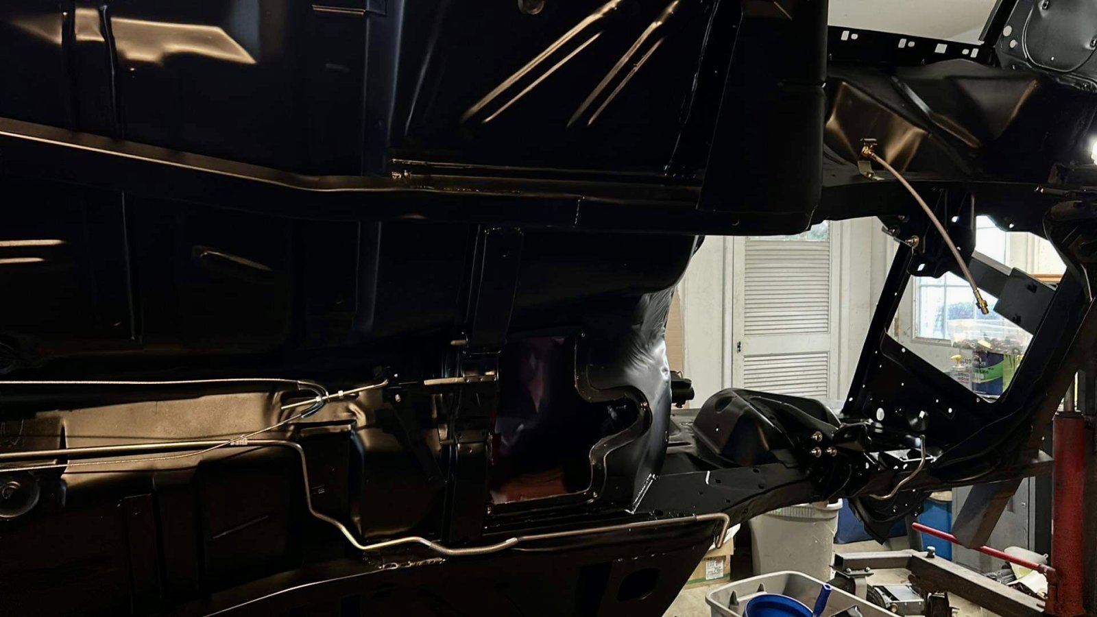

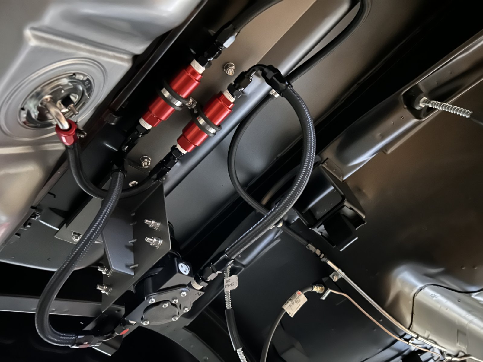

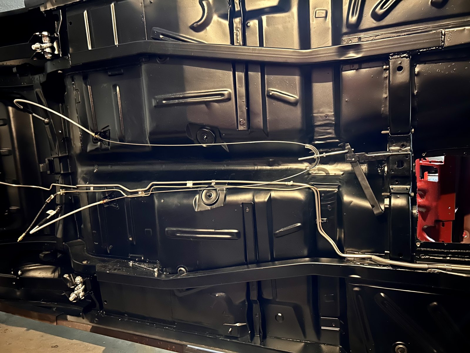

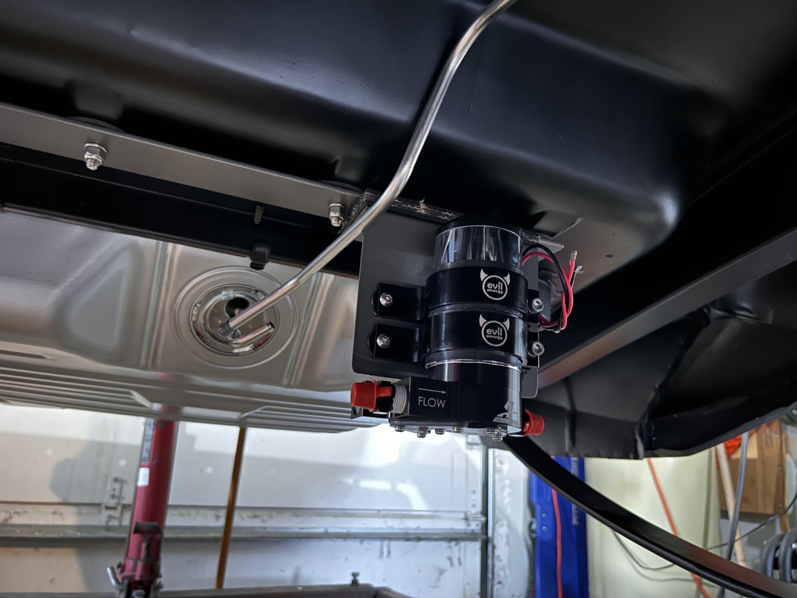

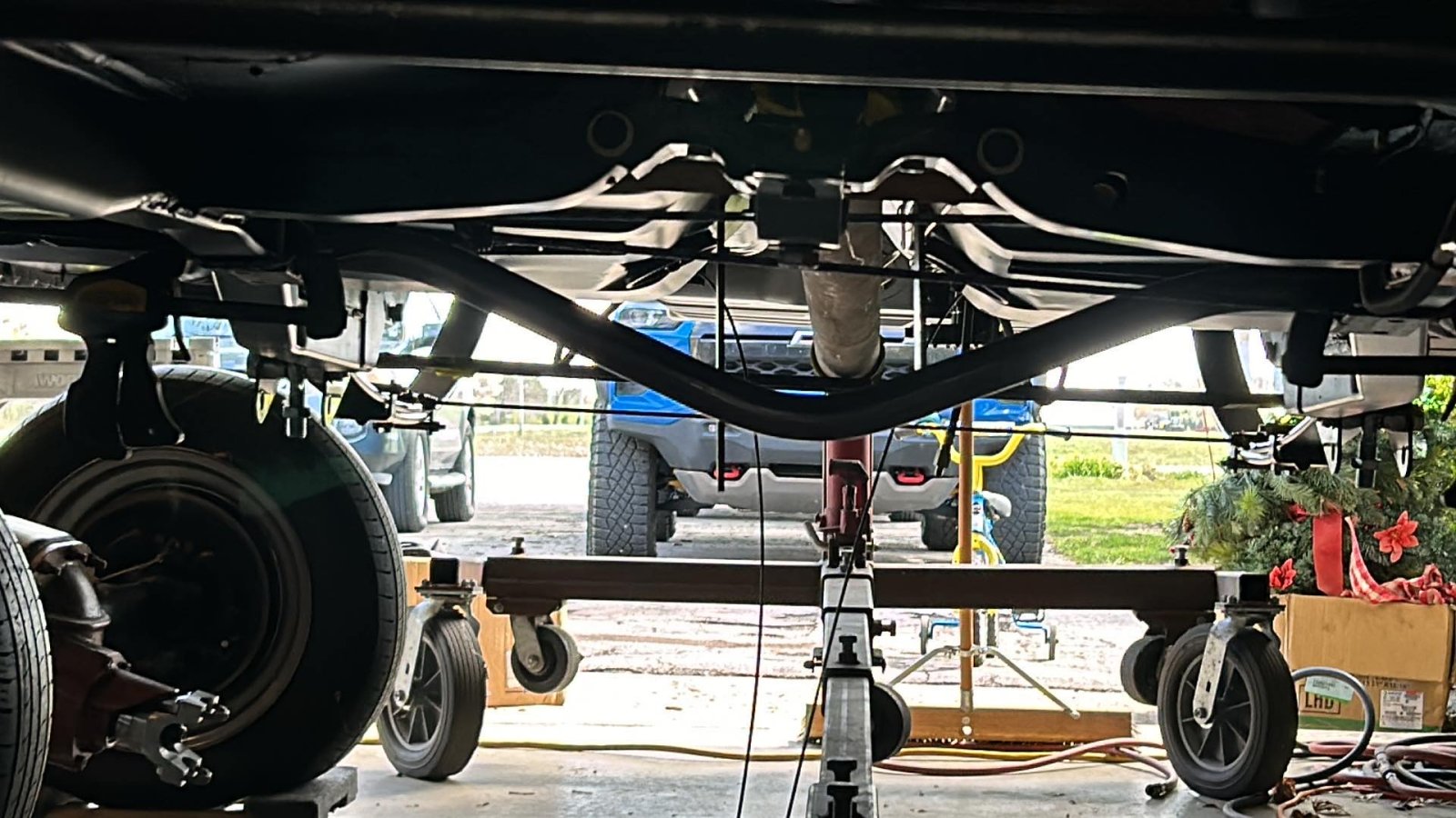

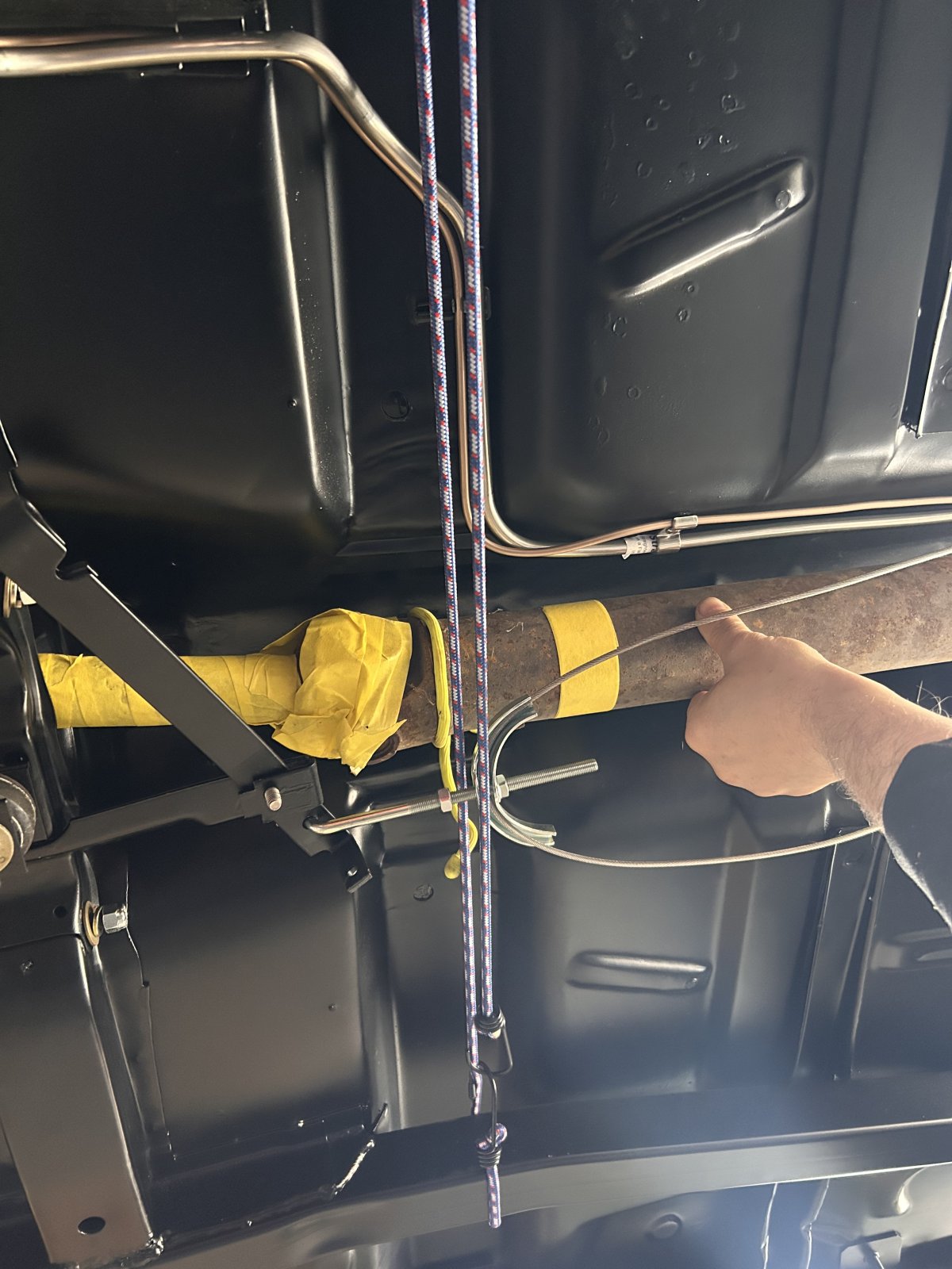

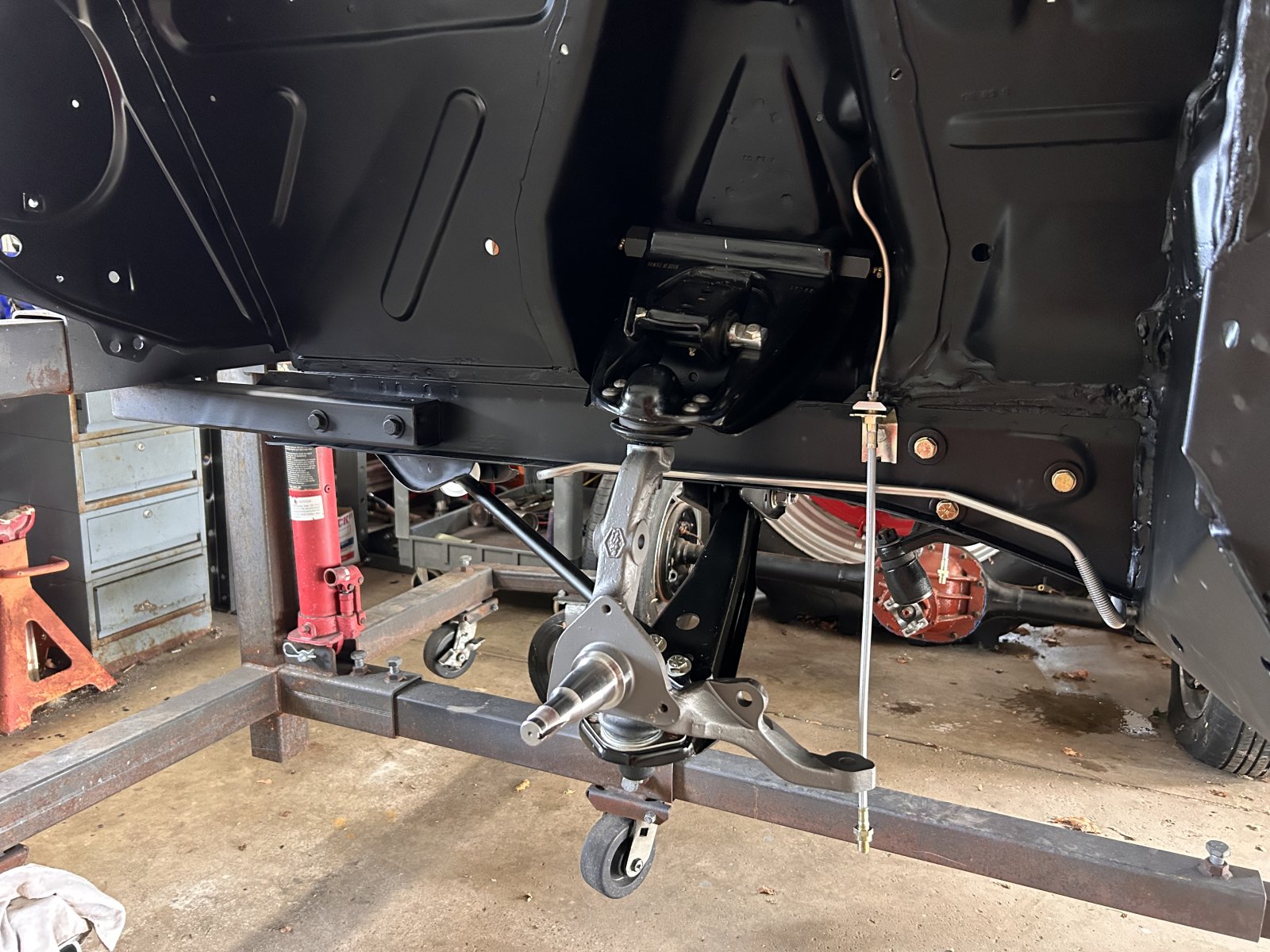

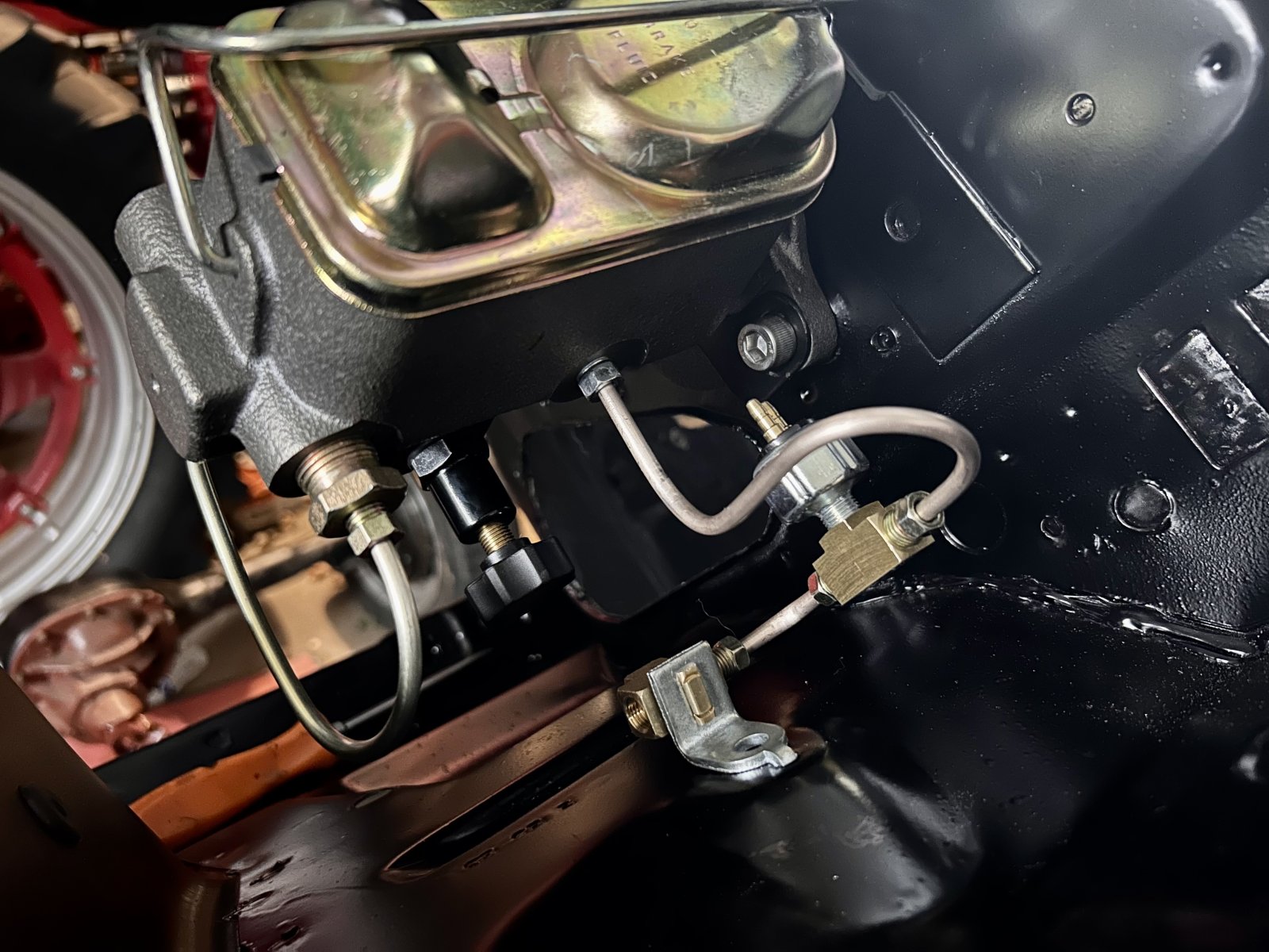

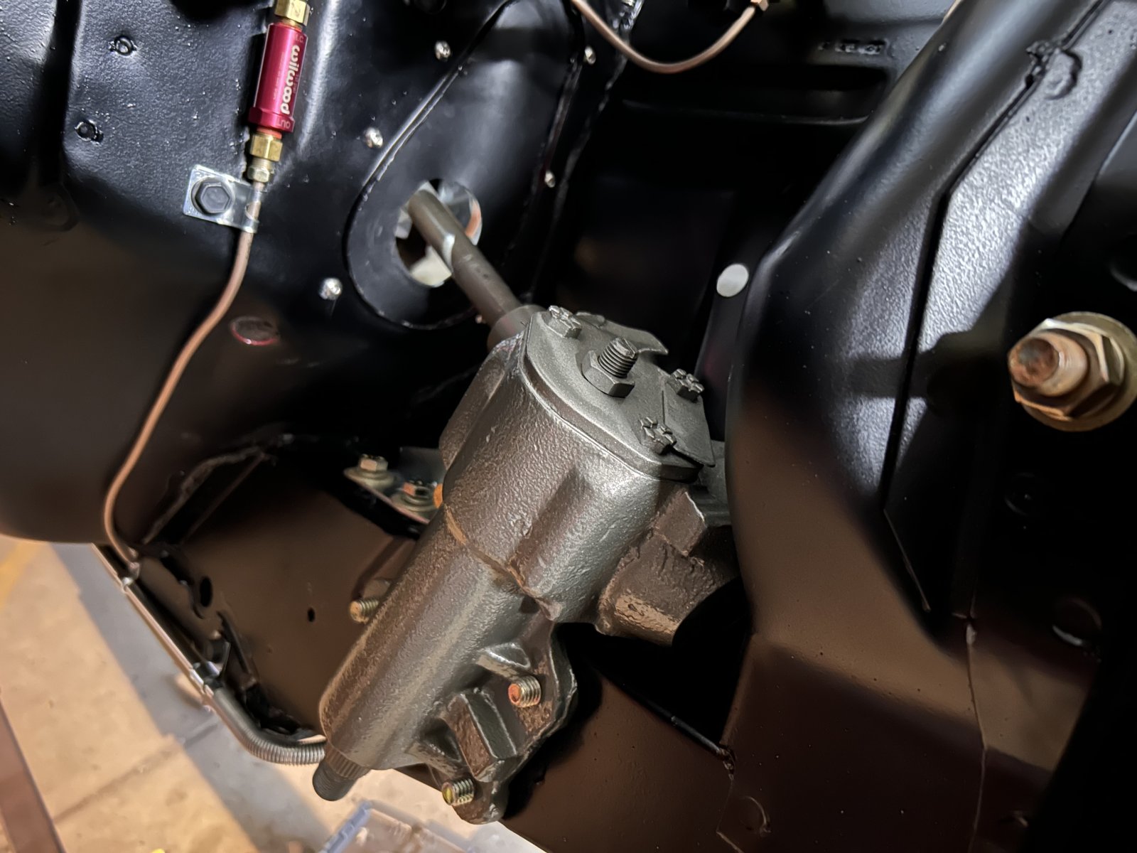

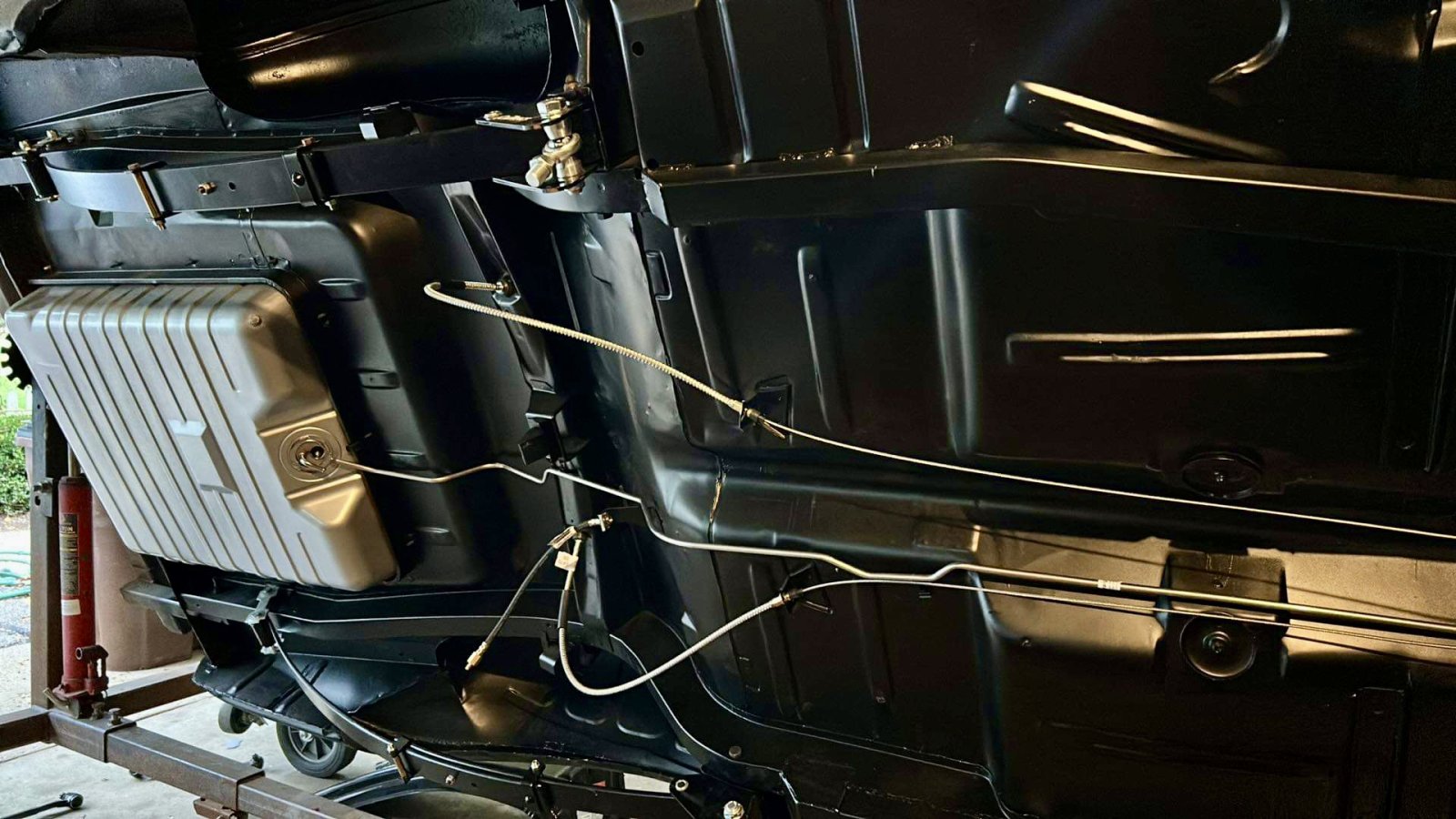

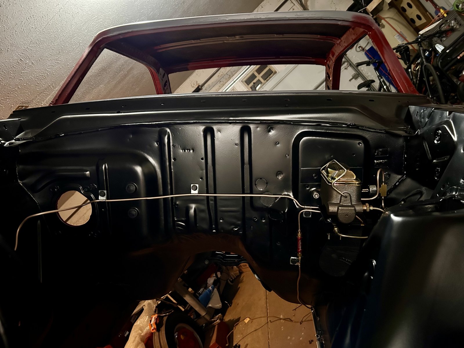

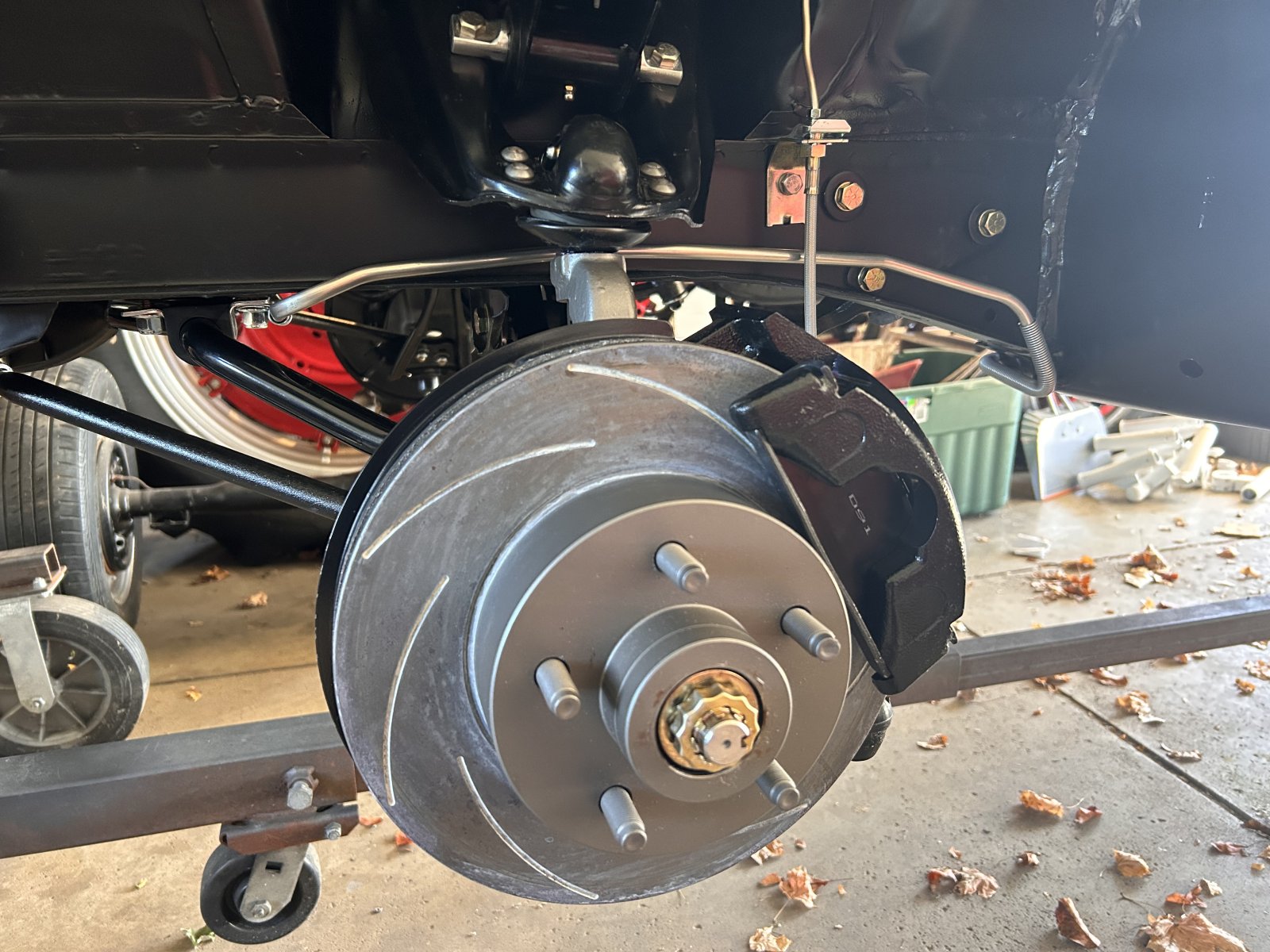

    Fuel system plumbed and brake system fabricated.
    After pricing having my original tank cleaned and coated it was more economical to buy a new tank so that is what I did. I chose a new float and pickup with a 3/8 outlet (original was 5/16). Tank was sealed to body with 3M caulk strips.
    Aeromotive H.O. pump and filters. CPE braided hoses and AN fittings from tank to hard line. Hardline is an Inline Tube (Sterling Heights, MI) 3/8” Stainless piece.
    brakes are front disc conversion from CSRP and rears are drums. The new parking brake cables are exact reproductions from Inline Tube. They are the only correct length ones on the market and mimic originals eliminating plastic found on other offerings that melt against exhaust.
    lines are all hand made CuNi. I added a 10# residual valve to the rear lines. One thing I ran into was that my car originally being power brakes had an extras cutout in the firewall because the booster sat lower. Now that the car is manual the master cylinder moves up leaving the extra opening. A bit of time with some dial calipers, modeling in Solidworks and an hour on the 3D printer and I had a block off plate.
    I recently decided I needed roll control so I do need to plumb that in. Once I get if off of the spit I will do that. But having this thing on the rotisseries sure makes all of tons work so much more enjoyable they lying on my back under this thing.
    IMG_2117.jpeg IMG_2118.jpeg IMG_2098.jpeg IMG_2128.jpeg IMG_2131.jpeg IMG_2140.jpeg IMG_2146.jpeg IMG_2150.jpeg IMG_2177.jpeg IMG_2182.jpeg IMG_3128.jpeg IMG_2165.jpeg IMG_3234.jpeg IMG_3267.jpeg IMG_3268.jpeg IMG_3269.jpeg IMG_3270.jpeg

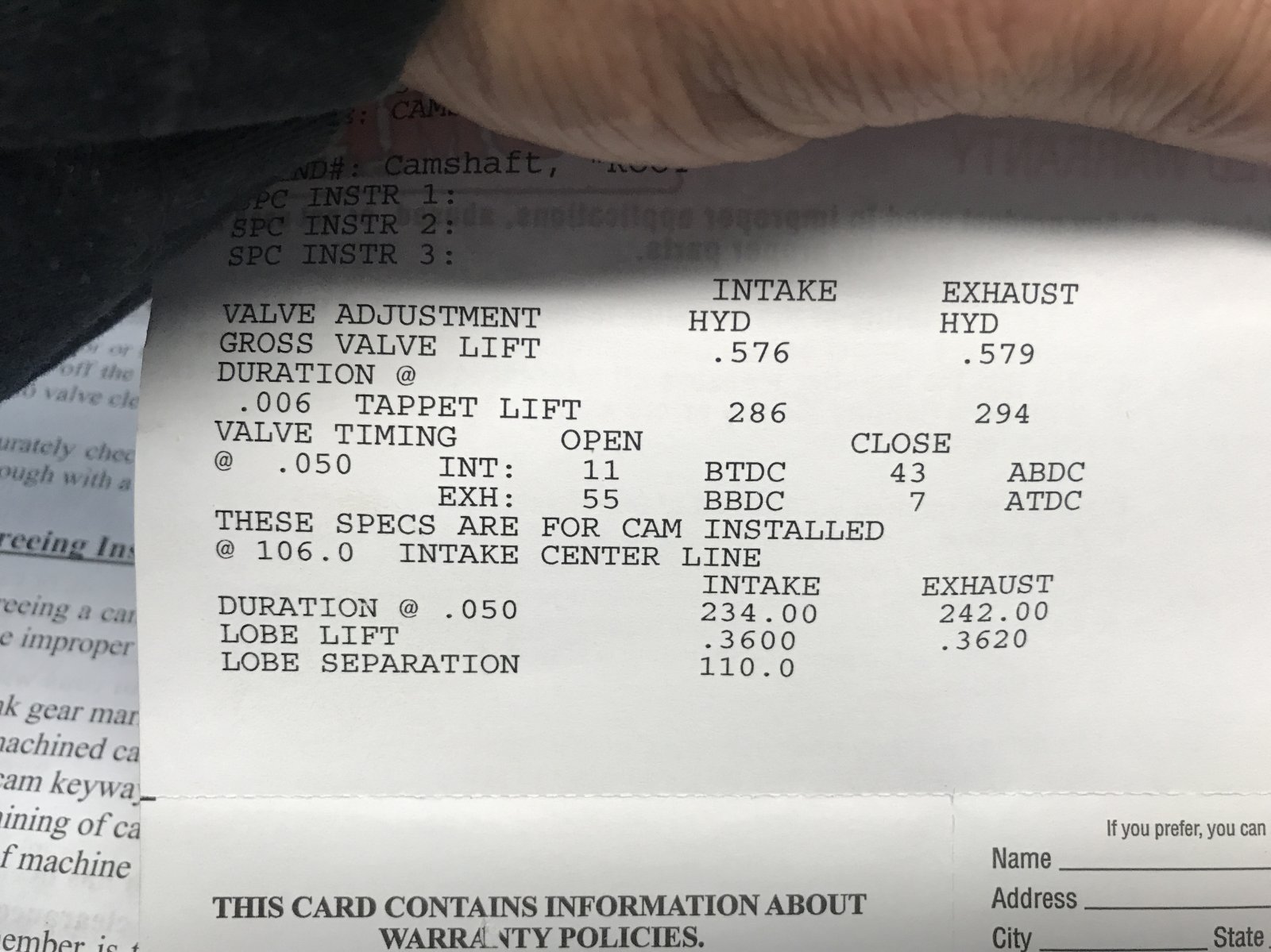

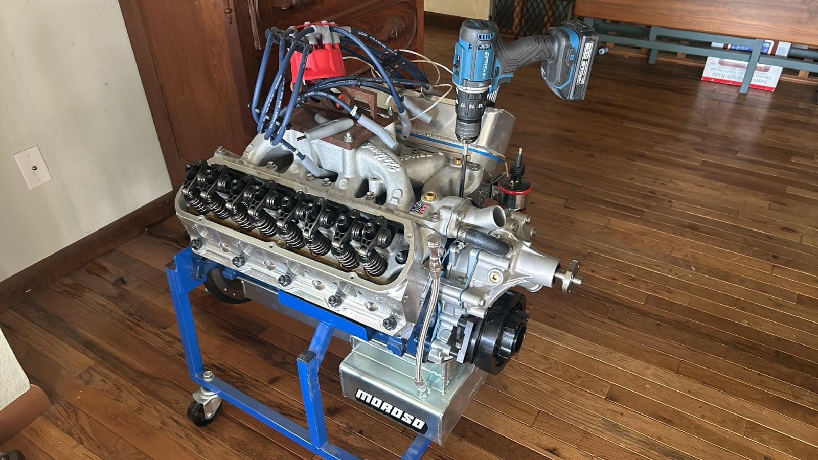

    Spent Friday afternoon getting the little Ford ready for her trip to the Dyno later this week. Since it has been sitting here in the corner for at least 2 years I primed it, checked all of the valve adjustments, put a curve in the MSD, verified timing pointer and TDC aligned and sealed and installed all of the plugs in the manifold since I will only need two this week (and one once in the car).
    So here ya go, place your best SWAG for what she will make.
    Deets -
    90’s **X marked 5.0 block.
    331 CID (3.25 x 4.030)
    Piston to deck is right at 0.005”
    **** cast crank and I beams - 28 oz (balanced)
    Power bond SFI damper
    10.22:1 Static (mahle flat tops - 6.5 cc) / 8.56:1 dynamic
    Felpro 9333TP1 head gasket
    TFS 190 11R cylinder heads (56 cc basic CNC runners)
    Comp Hyd Roller (cam card attached) - degreed to 106 degree IC.
    Elgin Hyd rollers - uses original dog bones and spider
    Comp roller rockers (1.6:1)
    Edelbrock RPM airgap
    Pro-Systems 4150 (780) - baseline tune attached
    Driven 10W30 break in oil will switch to 20W50 VR1 for tuning.
    MSD has purple bushing, 1 blue, 1 light silver spring installed.
    no additional porting or matching or cleanup performed. Still up in the air on trying to tune with a spacer(s)
    will run without water pump or alternator using shop long tube headers and Sunoco 94.

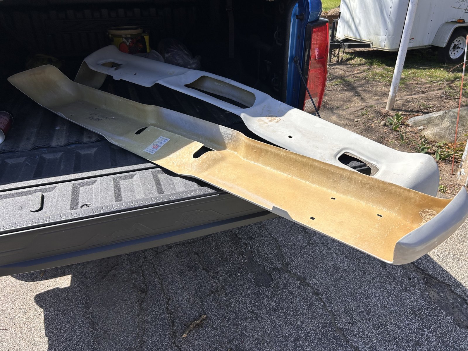

    Saw your post on Comet Central..you need to buy a lottery ticket..ya got a gl*** hood and bumpers locally…unheard of…

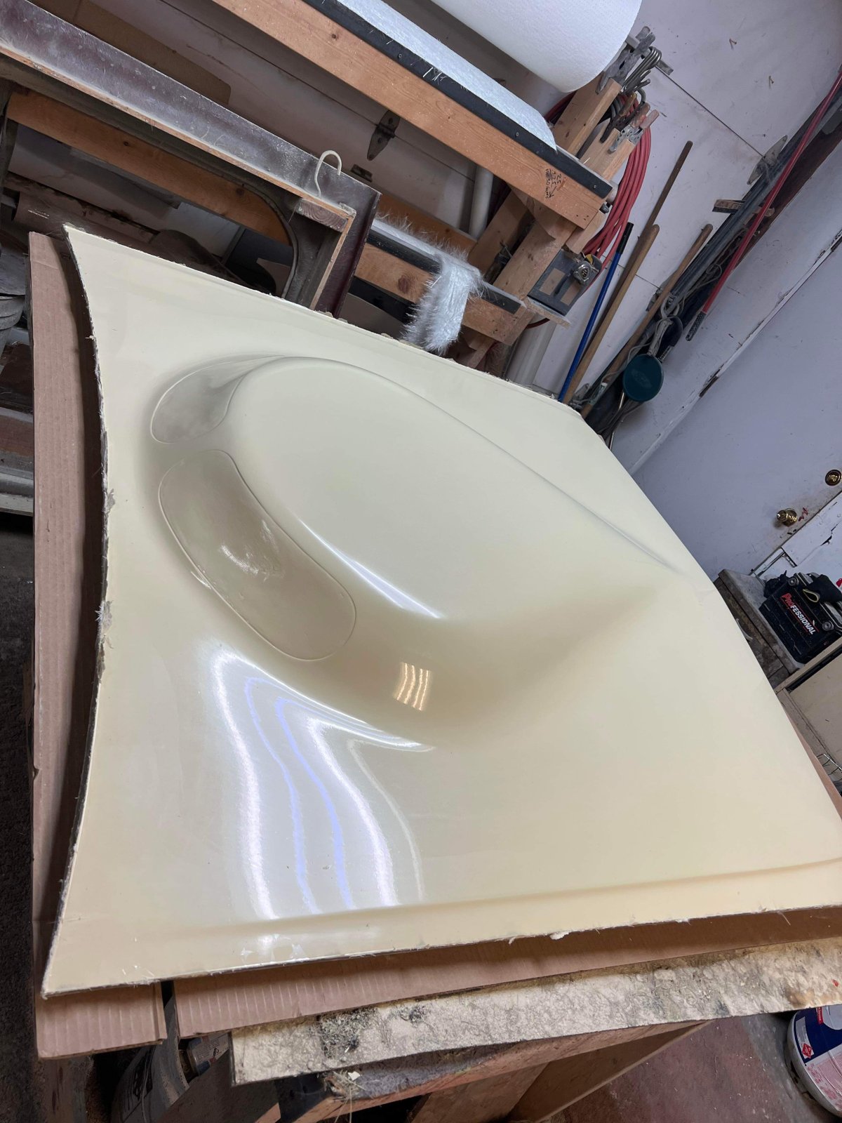

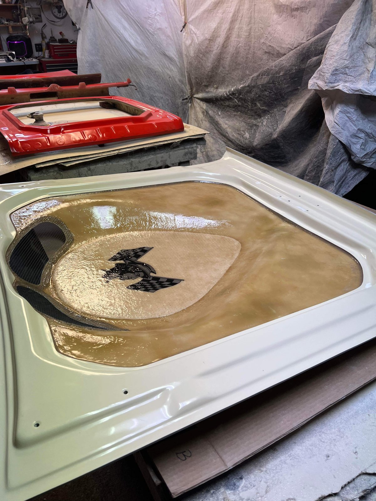

    Yes - I think it was February when Tim Mills messaged with photos to tell me my hood would done that week. Had been so long I had forgotten about it to be honest. He lives 20 minutes from me so I took a Saturday morning drive and handed him a few C notes and shot the breeze for an hour and checked out his work and upcoming plans. The hood is pretty nice. No complaints about his quality and the price was reasonable for the effort from a one man shop.
    Then a few weeks back I went to the Monroe, MI swap meet (first swap meet I think I have been to since I was a teenager). 20 minutes in I spotted a set of bumpers - NOS Crites for my 64. @ $200 they were on the way to my truck in a matter of minutes. Incidentally while putting them in my truck I met up with a gentleman from Brooklyn working on a 64 and sold my old fuel tank for almost as much as the bumpers just cost me…
    Maybe I should buy a lottery ticket! If this 331 stays together and runs like a scalded dog on Friday I just might do that!

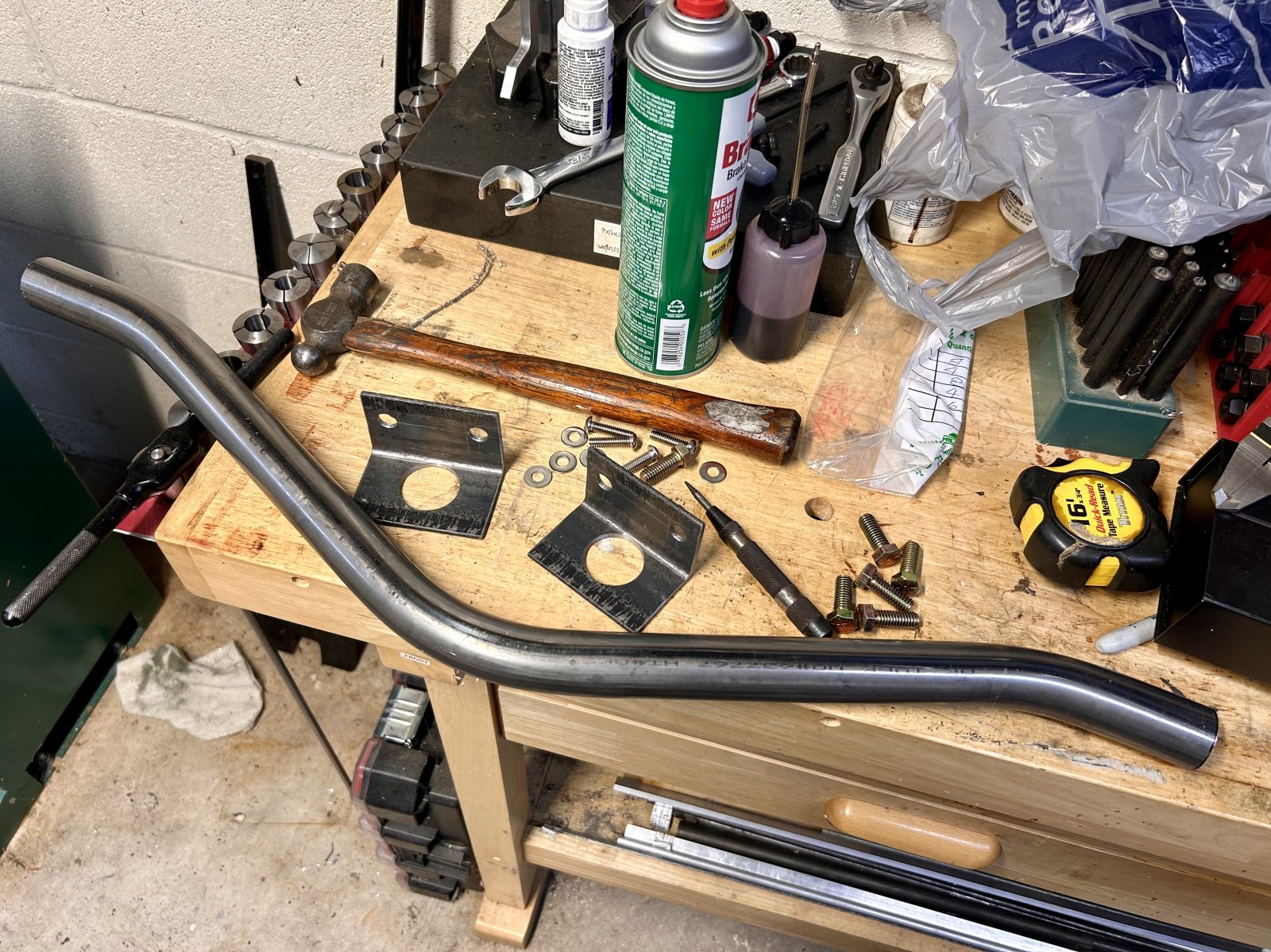

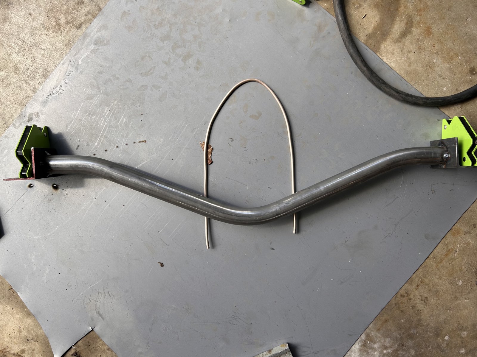

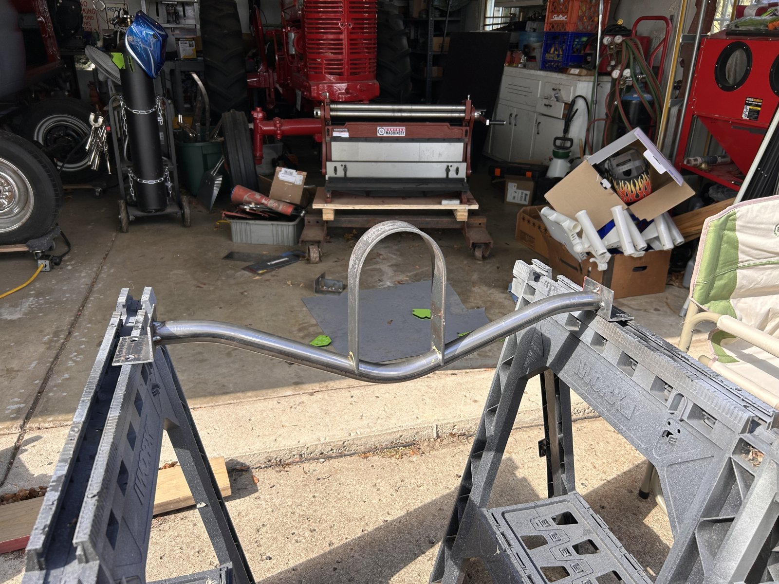

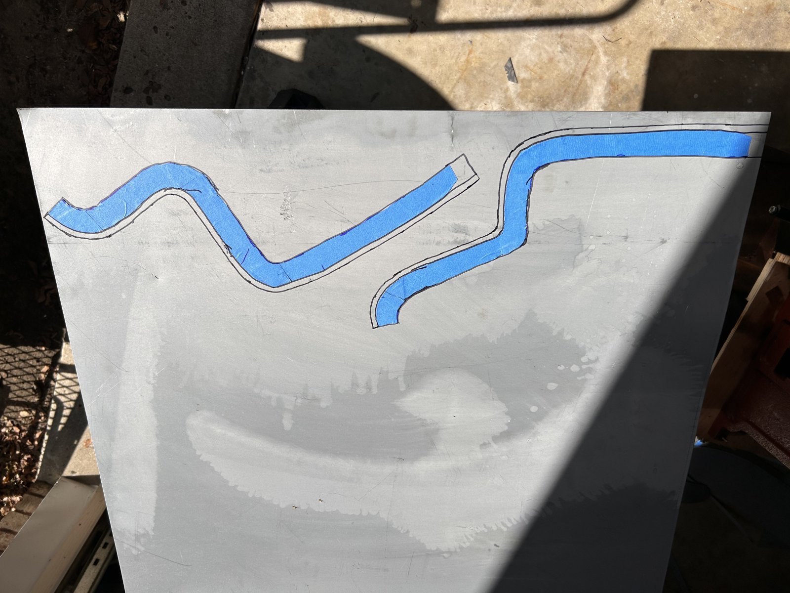

    Considering I want to run slicks if I take it to Milan, etc I figured now is as good a time as any to make a driveshaft loop. The tunnel on these cars is kinda small. I started with a compe***ion engineering “kit” and ended up just using the bottom piece and fabricating the U from 1/4 x 2 strip. Not sure how I like it as it will hang down a bit. The thought was I can add a middle piece in the U later to more contain the loop once I have drivetrain installed and then below I can p*** the parking brake cables through. I still need to put some panel nuts in the sub frame connectors to bolt it in.
