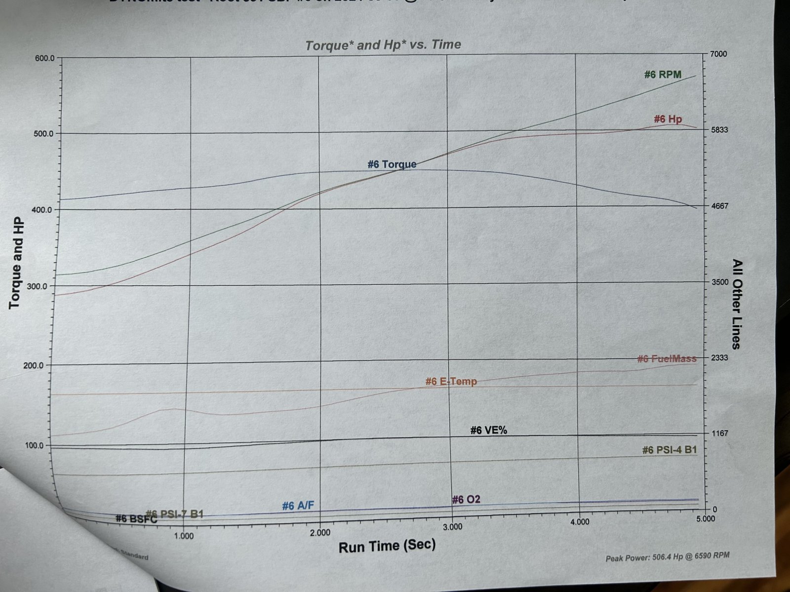

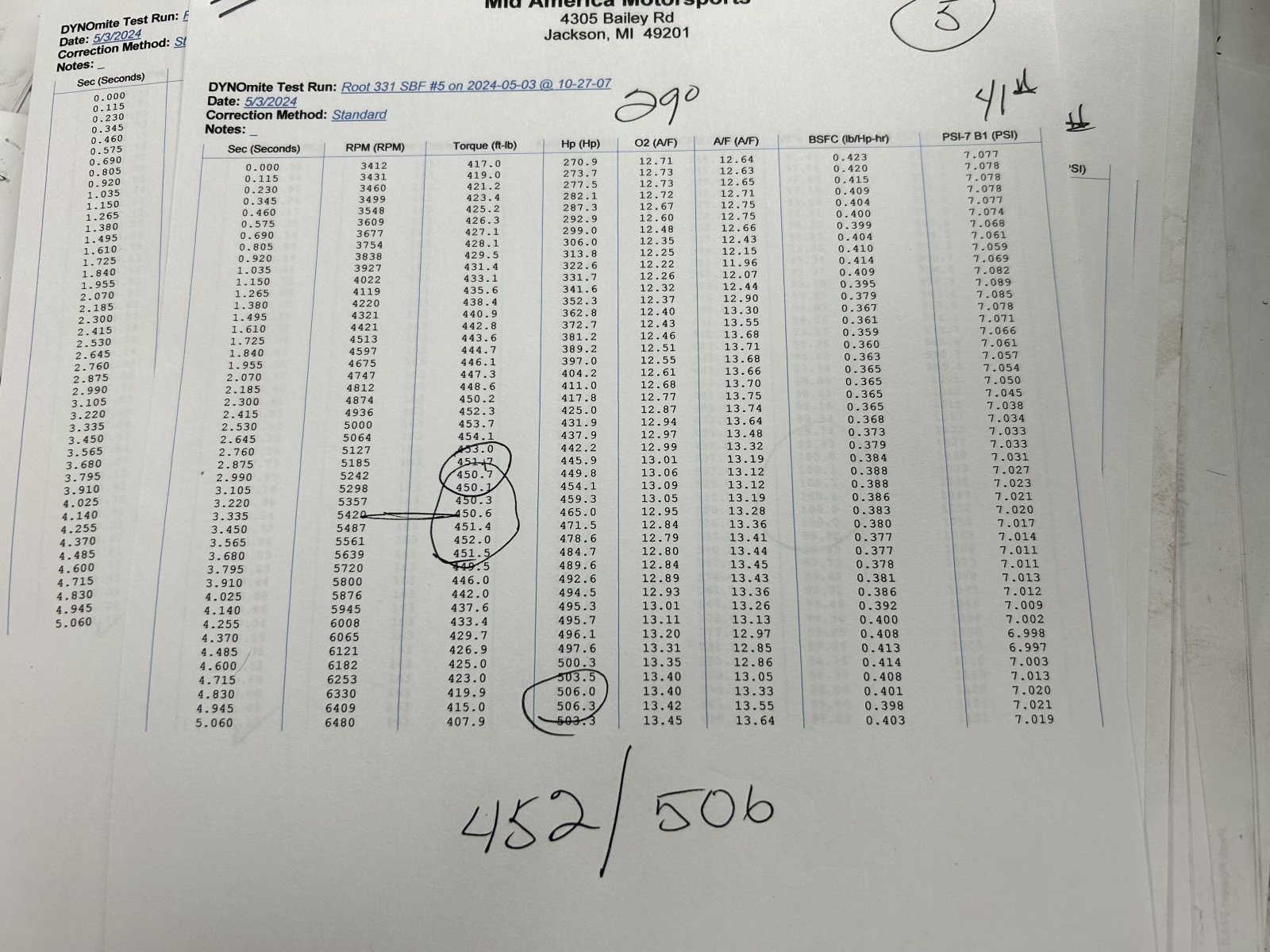

    Just a weee bit more ****y than I had intended…
    swade41, loudbang and Oneball like this.
  7. RmK57
    Joined: Dec 31, 2008
    Posts: 3,289
    RmK57
    I was out 25 hp. Nice numbers, I’d be pleased with that! Probably could have picked up a bit more experimenting with carb spacers.
  8. oldiron 440
    Joined: Dec 12, 2018
    Posts: 4,623
    oldiron 440
    Looks good, gotta love the tq curve!

    Flattttttt

    My camshaft is a hydraulic roller, probably should be a mechanical roller… which equates to just a wee bit more “area under the curve”.
    The cylinder heads are where the power lies on this motor… no doubt if I had gone with a stronger bottom end and block, more camshaft and a single plane this motor could have pushed the 550-575 boundary maybe…. The rotating ***y, block and hydraulic lifters are the weak points now…. We didn’t take it further than 6750 because of that.
