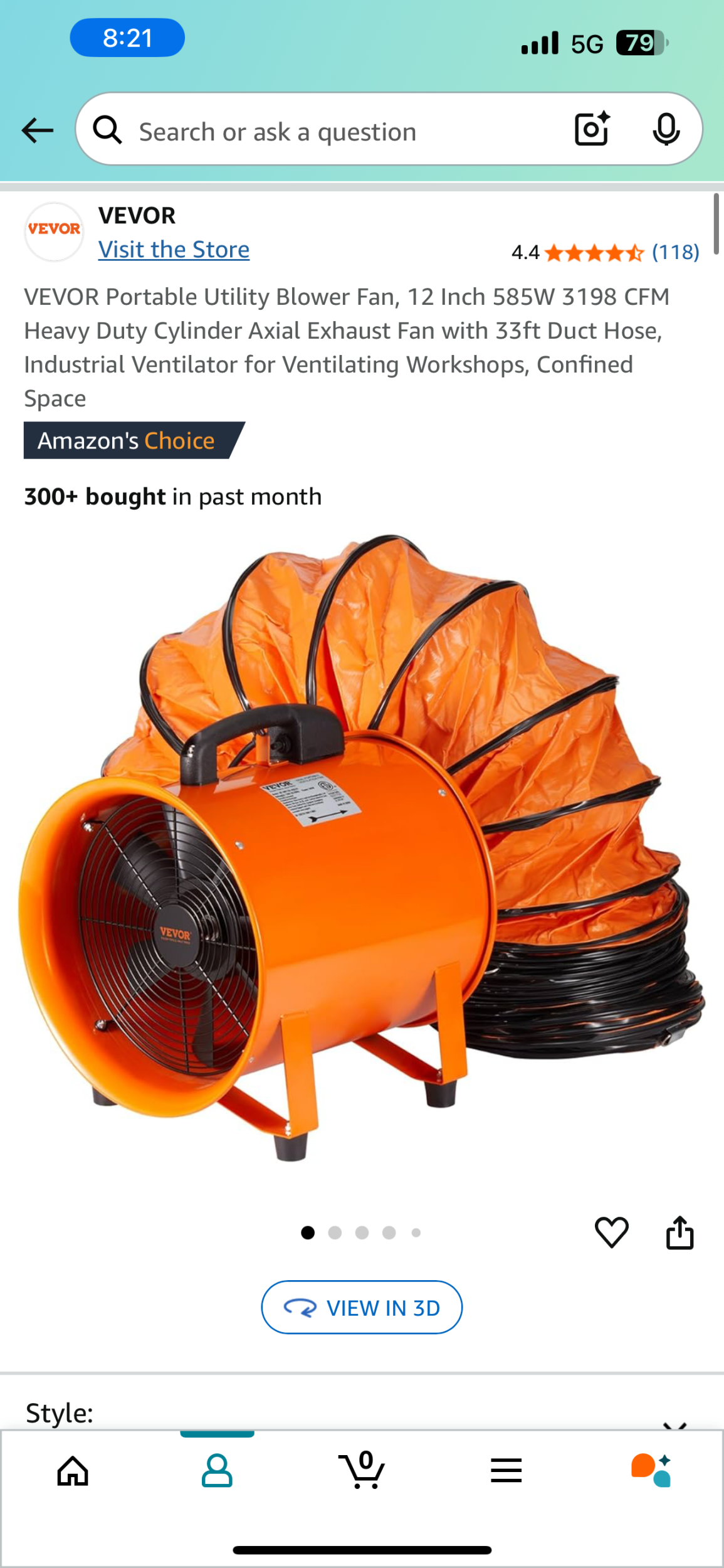

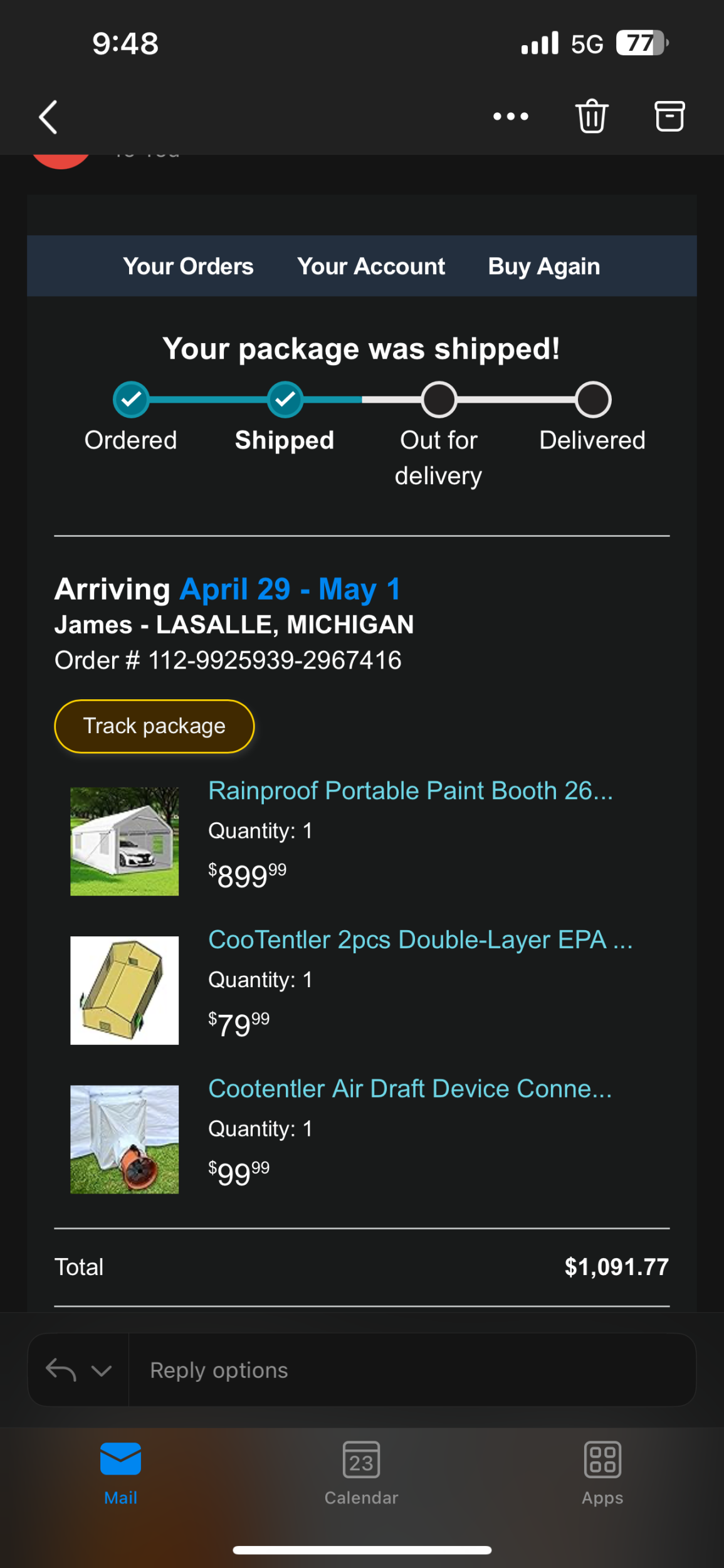

    it’s from Amazon. This one is 14W x 26L x 10.5H. I also bought window filters and the box to attach a blower to and a 3200 CFM exhaust fan and tube.
    In figured it was a better option than one of those blow up booths which deflate on you if the blower loses power or a circuit breaker trips, etc. I am doing this whole car with most of the panels off of it and it’ll all be in and out of this thing multiple times over the next couple of weeks.
    I struck out at every turn trying to find a booth to rent locally. So here we are…. When I am done with it I have a friend who has agreed to purchase it all from me for his project (s). So In the end I’ll be out a few hundred $.

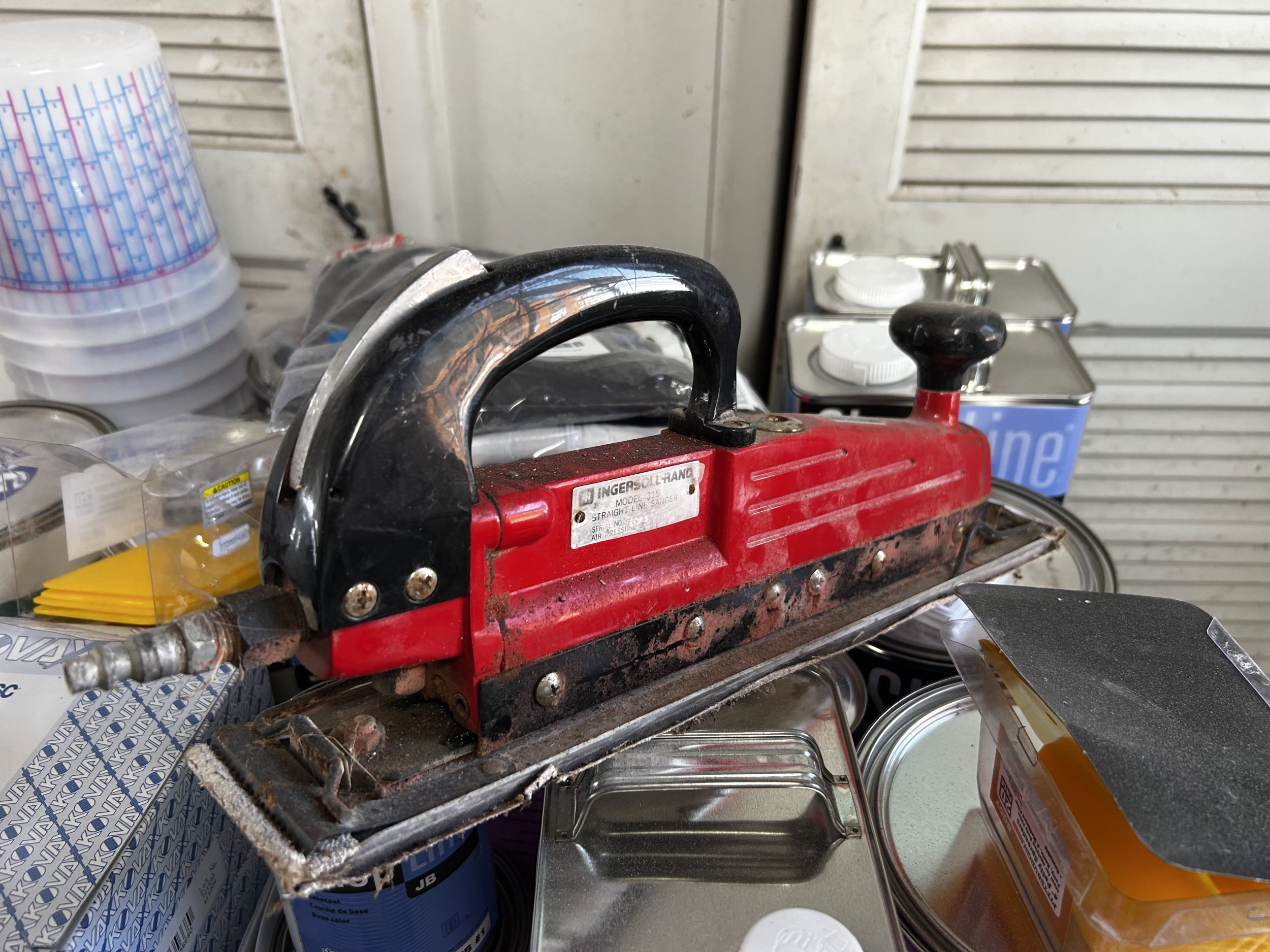

    i thought everybody uses an airboard w/ 60 grit or so to do initial knock down

    I mean…. But don’t ever go accusing me of being smart…

    Wow I haven’t seen an air file being used since the 80s, I know I have two of those Viking air files and a couple Hutchins in-lines and a Hutchins orbital but none have been used for thirty years. Now it’s all done with DAs and hand boards…
