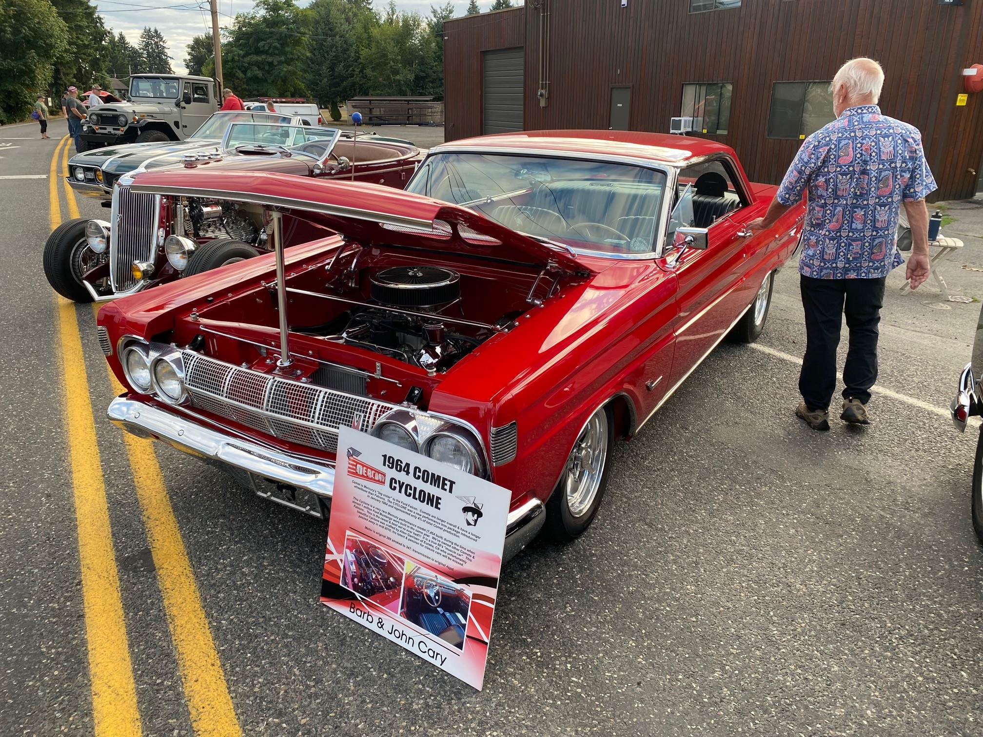

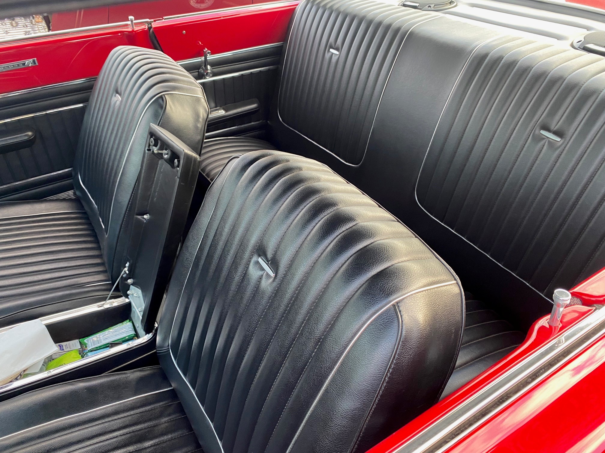

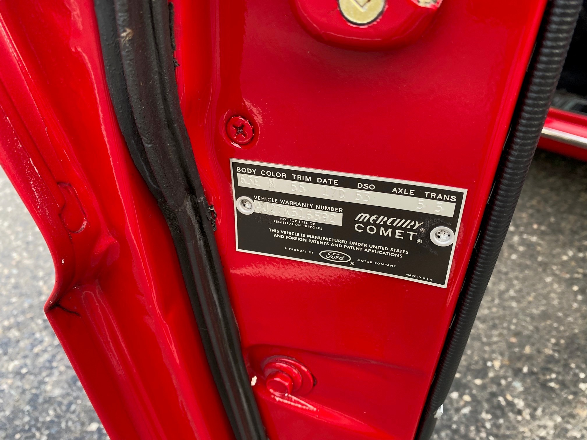

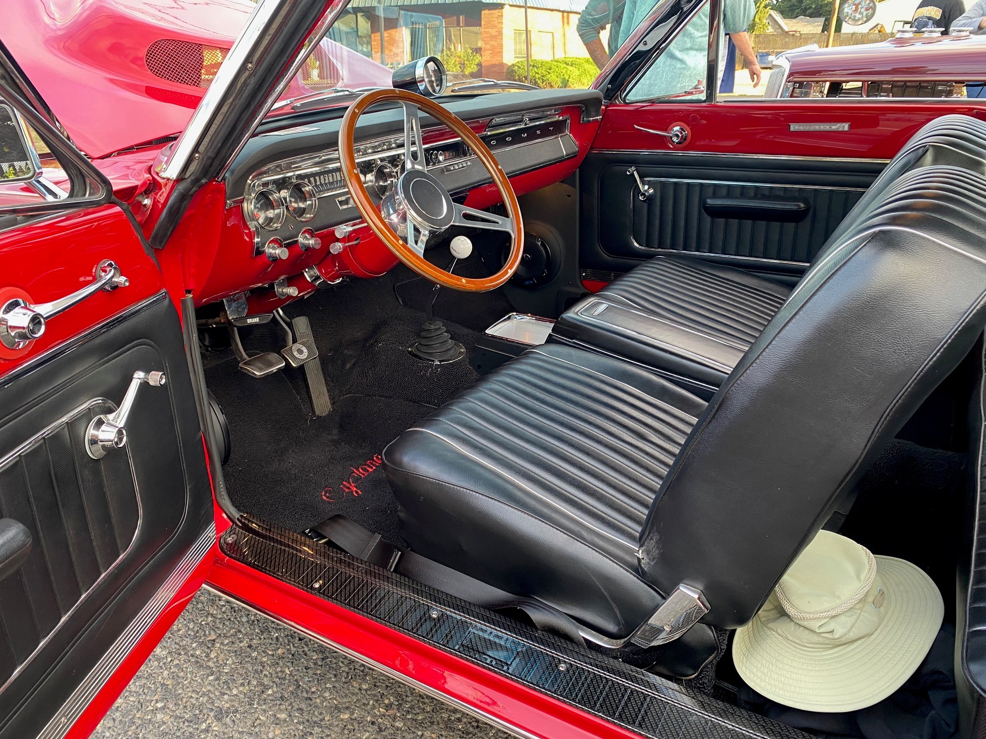

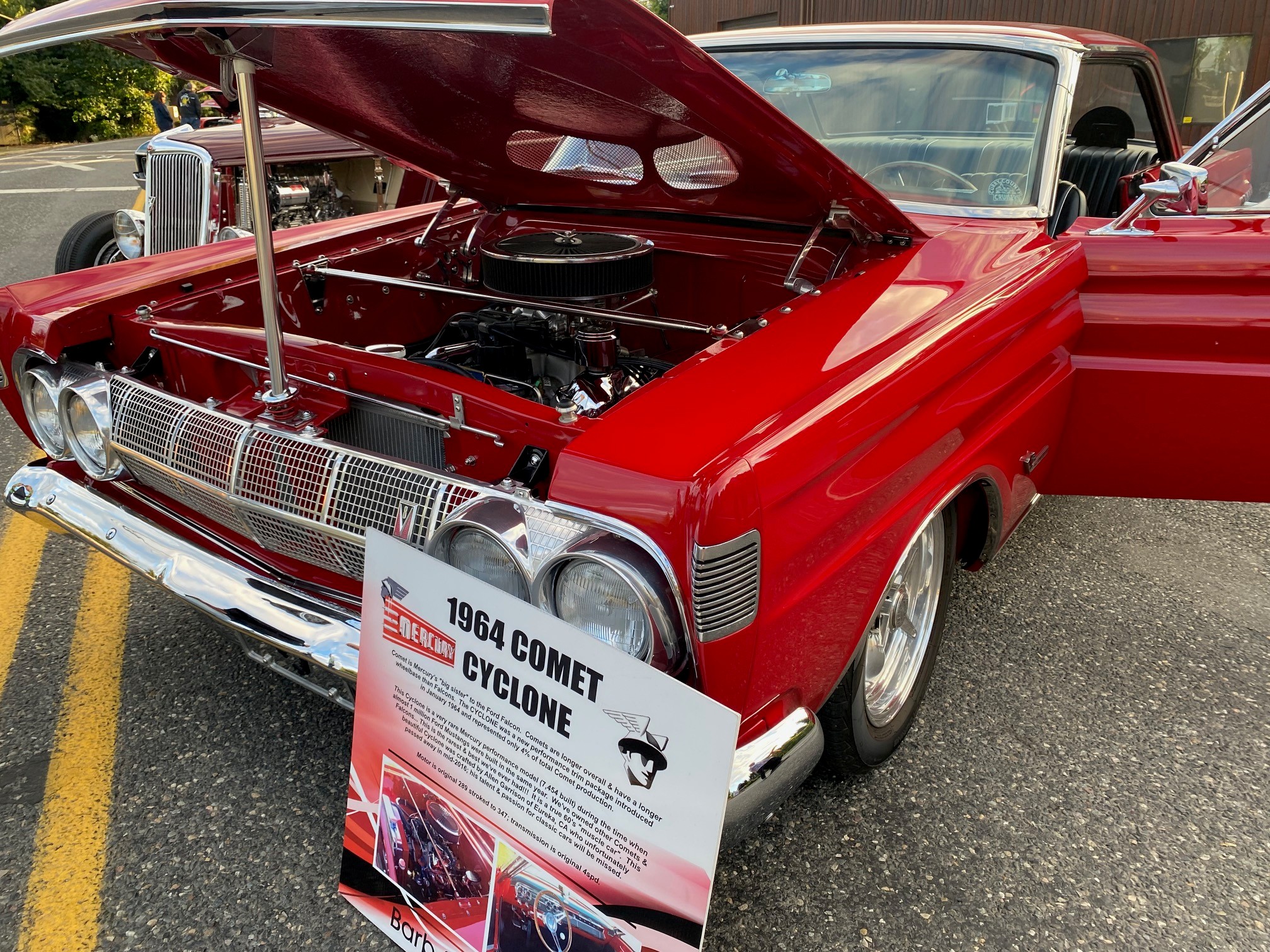

    I saw this one the other night at a local cruise. Nicest guy you'll ever meet, very nice Comet. I thought about your thread and thought I would post a pic or six for inspiration, navigation and motivation.
