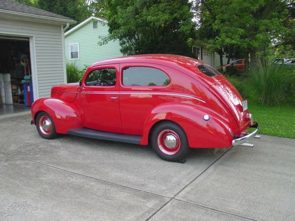

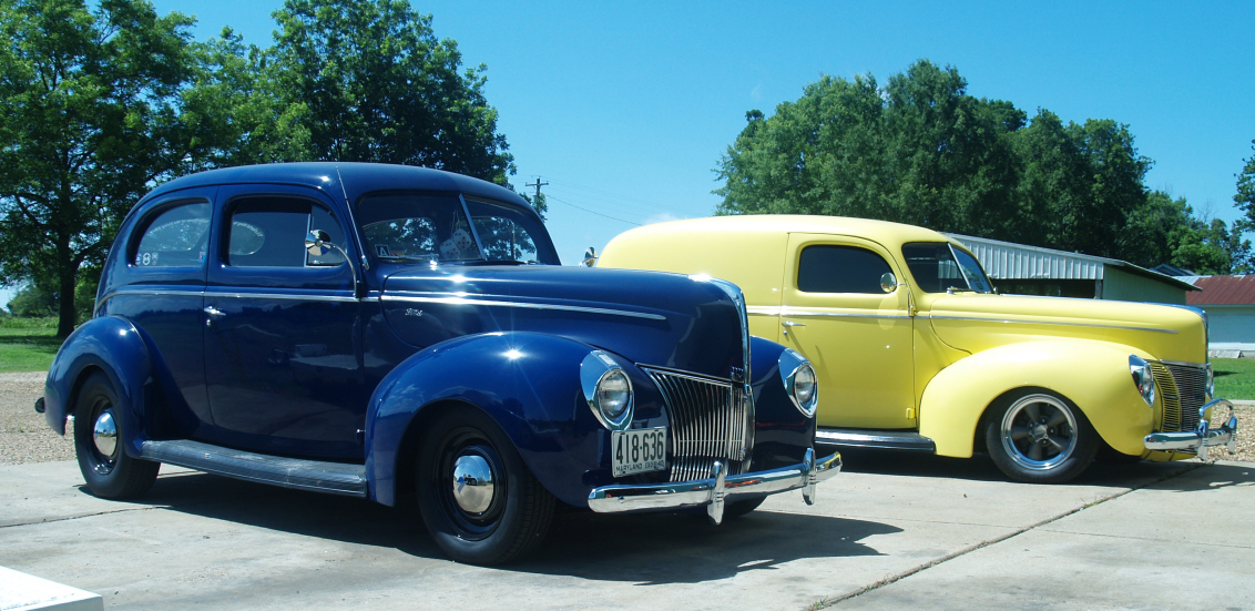

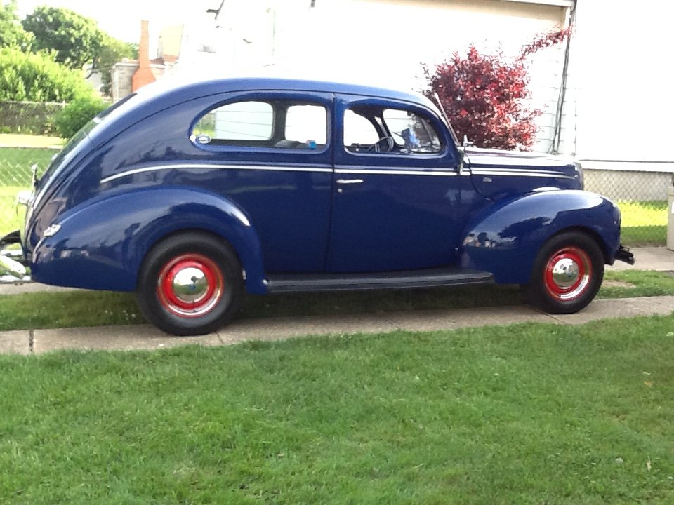

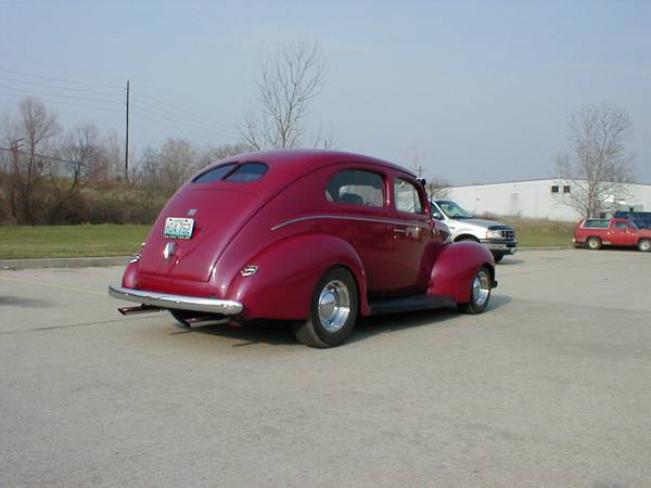

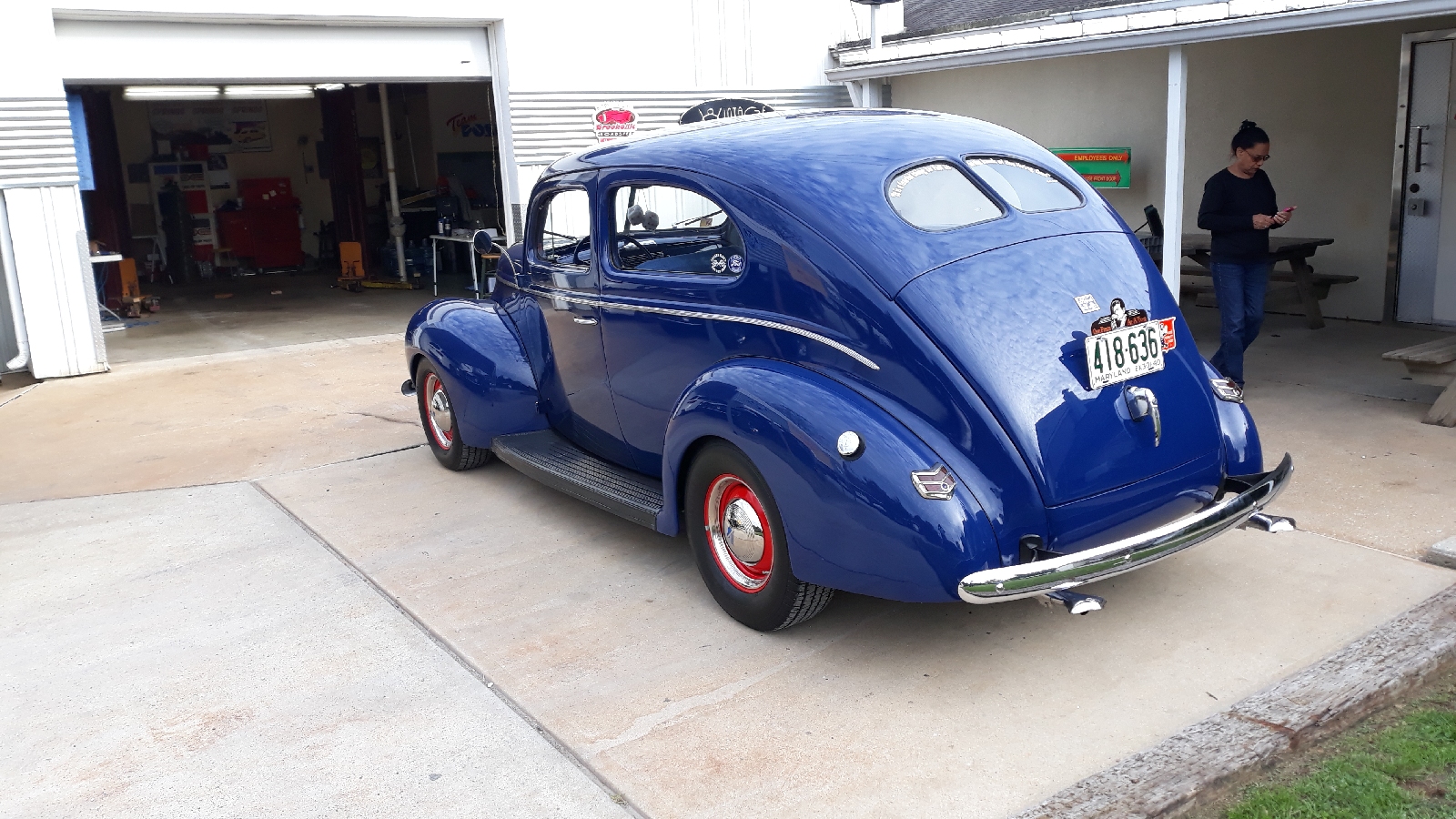

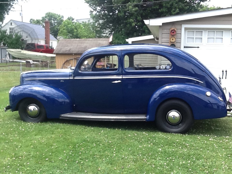

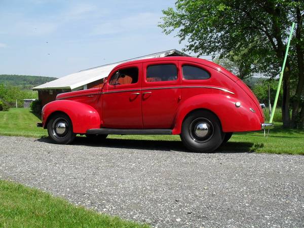

    image.jpeg image.jpeg image.jpeg image.jpeg image.jpeg image.jpeg image.jpeg Yep , that's about where mine started ,like the changes ,upgrades Dale, Weedburner 40 did for me . Here's a couple red ones and mine from start to now , enjoy that 40 very nice and great story .

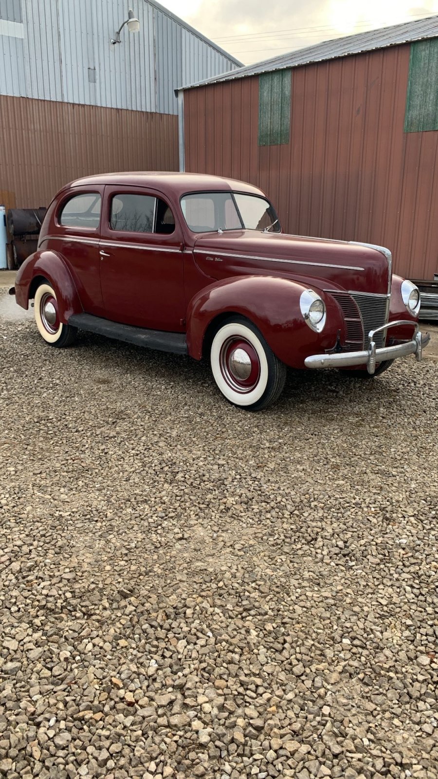

    C8BB1154-0637-4AFA-9F58-ACDAF1C0AB0B.jpeg Thanks for the info on the banjo gaskets. I need to get under there with some brake cleaner and figure out exactly where it’s leaking from. Hopefully it is something simple!
    I did get to put about 20 miles on the car today just cruising around town. The car did great! I’m still learning all the quirks it has and I did have a funny run in with a highway patrol who didn’t seem to mind that I had no license plates and no brake lights lol he just smiled and waved me on. I’ve got a good list of parts ordered that I am anxious to get started on. One place I am stumped at the moment is tube shocks. We’ve got the front upper brackets but I am struggling the find the 2” shackles with a shock stud built in. I’m also struggling to decide on what kind of mounts I want to do on the rear. I’m not a huge fan of the shock angle that comes with the brackets that bolt onto the brake backing plate. What have you guys done with your tube shock setups??
    Also, I did snag one new photo of the car today while it was warming up to head to breakfast.
