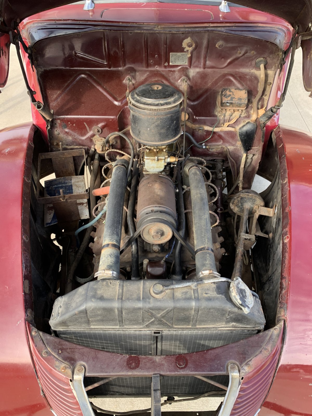

    I've seen the breather cap with a steel flex hose you ask about, but don't think I've ever seen them for sale new. Somebody is going to tell you that you need to add a PCV to the engine, but you are probably right about the rings. I'd actually be looking as to how the stinky stuff is getting into the cab. Or just drive faster so it all blows away.

    I will keep looking, somebody will come up with something. The smoke making it to the cab doesn’t smell great. As I mentioned above, I’d like for my wife and baby girl to enjoy the car as well so the smokes gotta go, atleast somewhere other than in the cab!

    Lakeside, When I bought my 40 in 1963 it had a rear breather tube that bolted to the intake manifold and was also the oil fill tube. It had a piece of steel flex tubing similar to what is shown below to vent the oil (blow by) fumes under the car. If your engine has a lot of "blow by" then a rebuild is in your future.

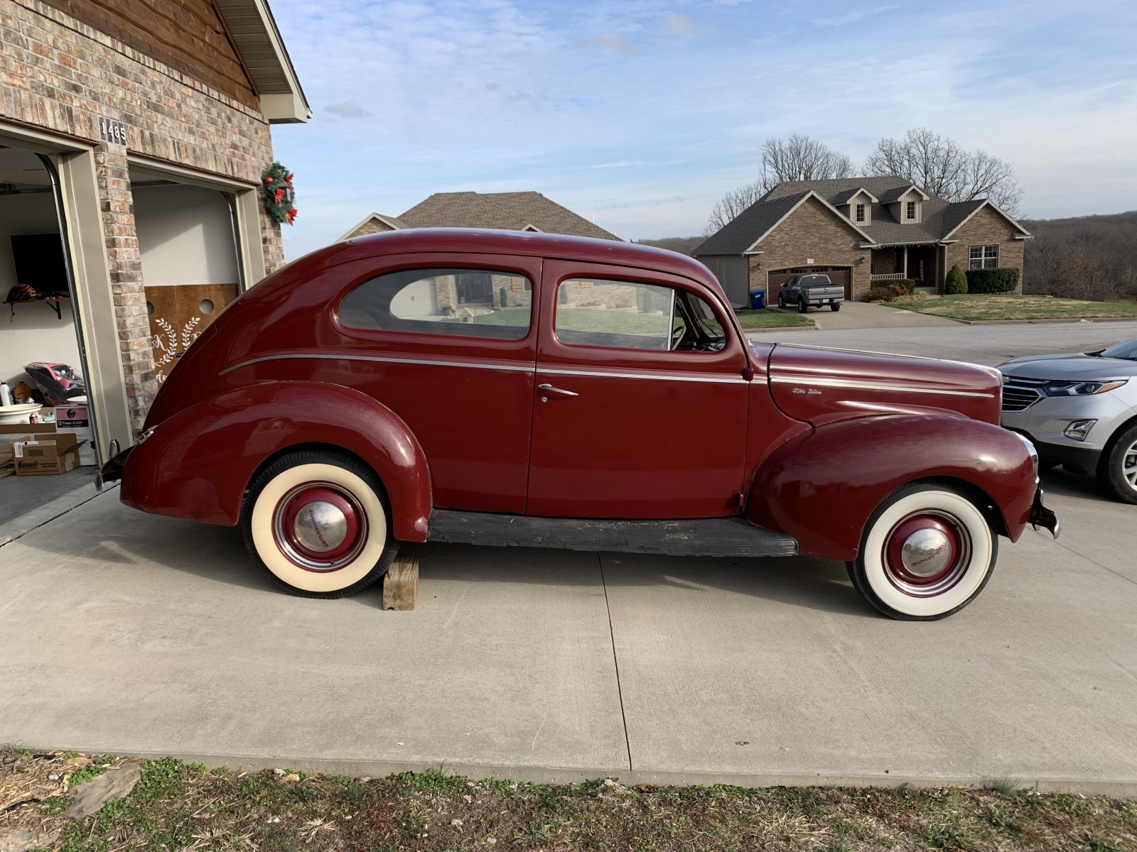

    2FA1E438-9EA4-4250-AC52-1EB2515FFC87.jpeg 103341AA-AD19-41BE-87CC-505496973B14.jpeg 21289DA7-103D-4116-885B-957144990BDA.jpeg 20F886D0-8DC1-48B6-8571-E2EA2C19C3BF.jpeg E3209148-1404-4AE5-BD14-93F35C236347.jpeg Hey guys! Work and my wife were kind enough to give me a couple of days off, so here’s another update. Well, not really an update but I did have to snag some pictures for the insurance company and thought I would share them here.
    I did get a NOS lock cylinder and key installed and functioning so I can check that off of the list. I also found out that after putting some miles on her, some wiring has moved or broken and has caused one heck of a parasitic draw, bad enough to be dead after one night of sitting. That issue, combined with the broken and bare wiring all around the car I have made the decision to rewire it ASAP.
    FYI, these will be the last photos with this wheel and tire combination! Stay tuned.

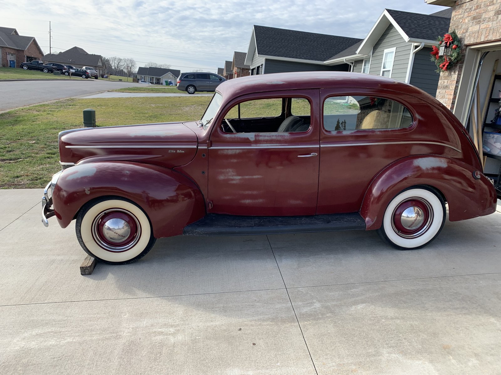

    Alright, you twisted my arm. Here is what we believe will be the stance once my collection of suspension parts makes its way under the car. Also got the radials mounted up on some merc style 15’s with chrome nuts and beauty rings. I took @bchrismer ’s suggestion on the Wimbledon white wheels and they turned out awesome. @gbrown ’s photoshop work brings it all together with the stance! I’m really looking forward to making that picture a reality next month.

    That's some impressive photoshop work... I thought that was real and that you had been working like a madman and holding out on us... That'll look great. Keep on keepin on.

    Actually that was a pretty quick photoshop job. I had a 6 year old breathing down my back on when I would be done so we could go play. I think @Lakeside65 should show the first photoshop I sent him! It was about 2 inches lower all the way around. And as I told @bchrismer via text I would try to do every trick in the book to get it that low.

    This one?? I love that stance
    Yes sir!
    I’m really not either but I’ll take them for the price. These were $75/ea for the fronts and $90/ea. You can’t hardly buy two bias plys for the total I paid for four. I am considering running some portawhite walls on these. I miss the white wall look already.
