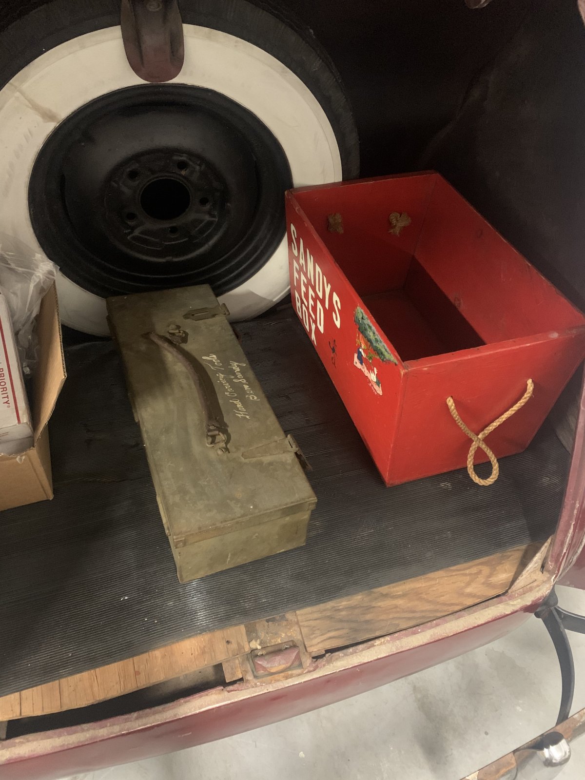

    Tonight I spent some time cleaning up the garage and I decided to grab a couple items out of the attic that I figured I could make some use out of with the 40. One being what I would call a “picnic” box and the other an old tool tray that housed my great grandpa Benny’s (who I am named after) woodworking tools. He hand painted both of these items back in what I would guess to be the 40’s, just like the car. I plan to keep a selection of hand tools from my grandpa’s (Benny’s son) old snap on box he gave me years ago in the tray and some oil and what not in the box. I think they are right at home in the trunk and I’m tickled to get some use out of them!

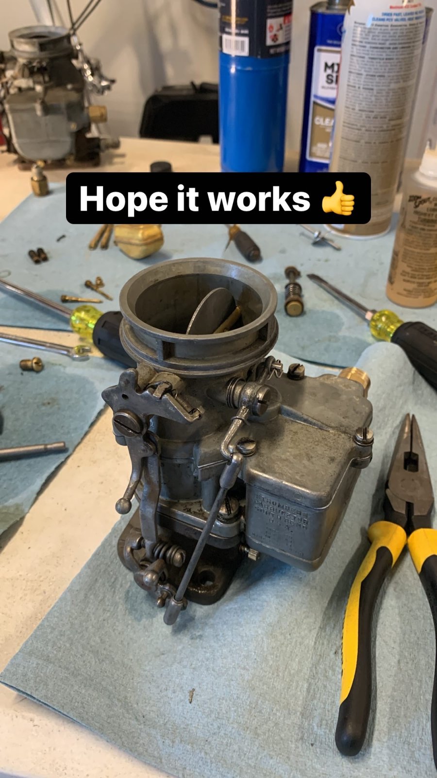

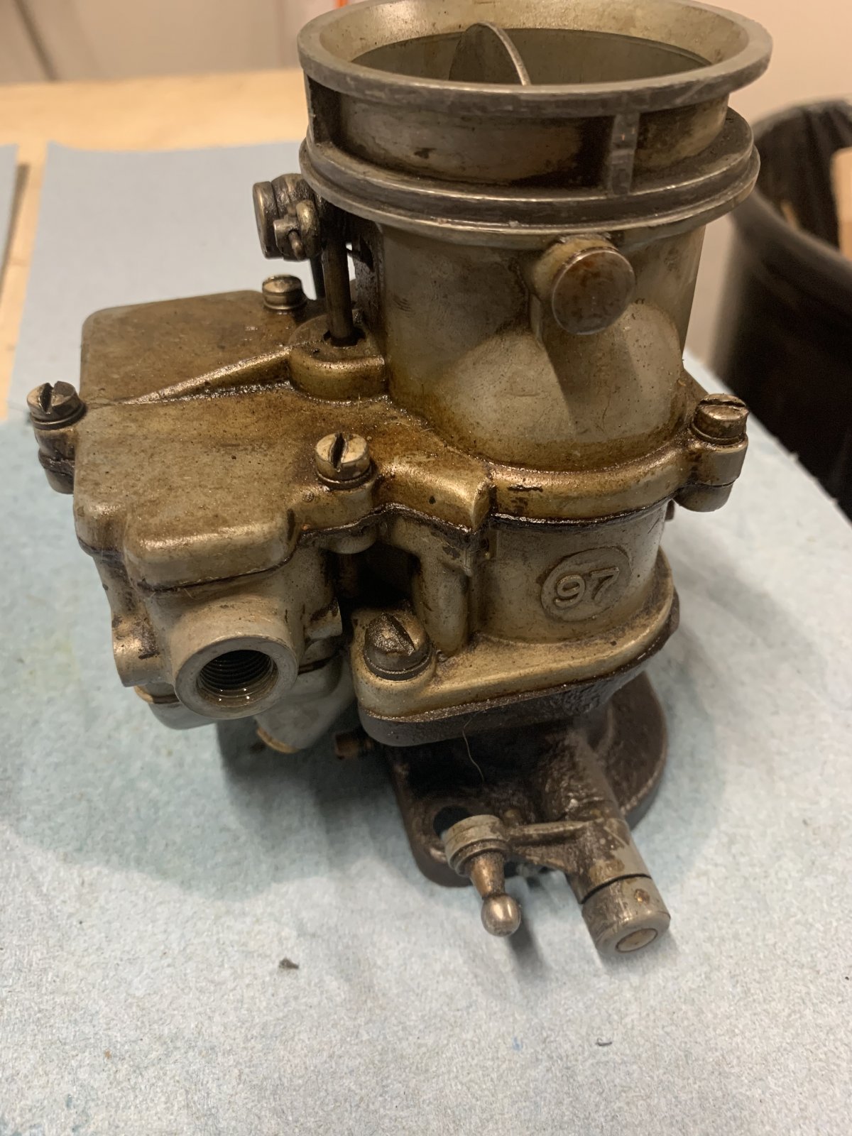

    Finally decided to take a swing at rebuilding the Stromberg 97 that came on the car. It would start and run fine but never would idle and was leaking pretty bad. I ordered up a master rebuild kit as well as a float, new emulsion tubes and new idle pickup tubes from Stromberg. I wanted to make sure if I screwed something up I had the part to replace it. Dis***embly went well, and then I let all of the individual pieces soak overnight in some chemdip. The YouTube videos from vintage speed on these rebuilds were extremely helpful. I some everything put back together except for the top and couldn’t get any fuel from my squirters. I luckily had a spare carb on the shelf so I robbed the power valve out of it and it got it working. The car now fires almost before I can hit the start ****on and has a nice low idle. It’s a breeze to drive now that I don’t have to manipulate the choke to keep it running while also trying to down shift, turn the blinkers on and stop at the same time lol. Next weekend I will be making a trip to pickup the motor that will probably be swapped into the car next winter if I don’t change my mind, then the weekend after that we will be giving Rosie and al***ude adjustment. I can’t wait, stay tuned. B8CD0495-F97C-4FA4-8C5F-8FEC295A0C22.jpeg 79E0486D-12CE-4F89-8D3E-1B64641A15C5.jpeg CA276C43-48A0-4AF5-AA59-F2A5CF96DBF0.jpeg

    Good job. Getting the engine to run smooth is one of the milestones.

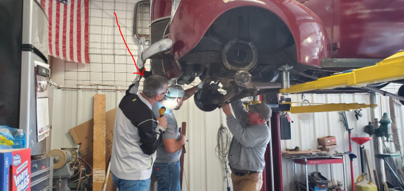

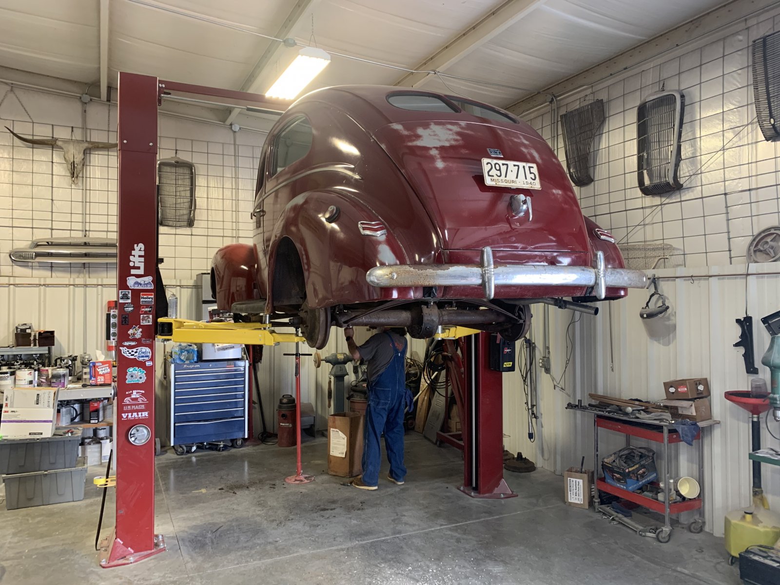

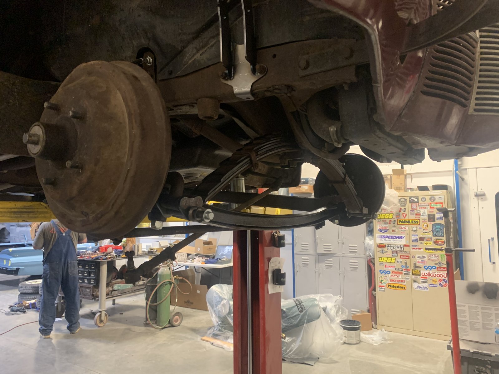

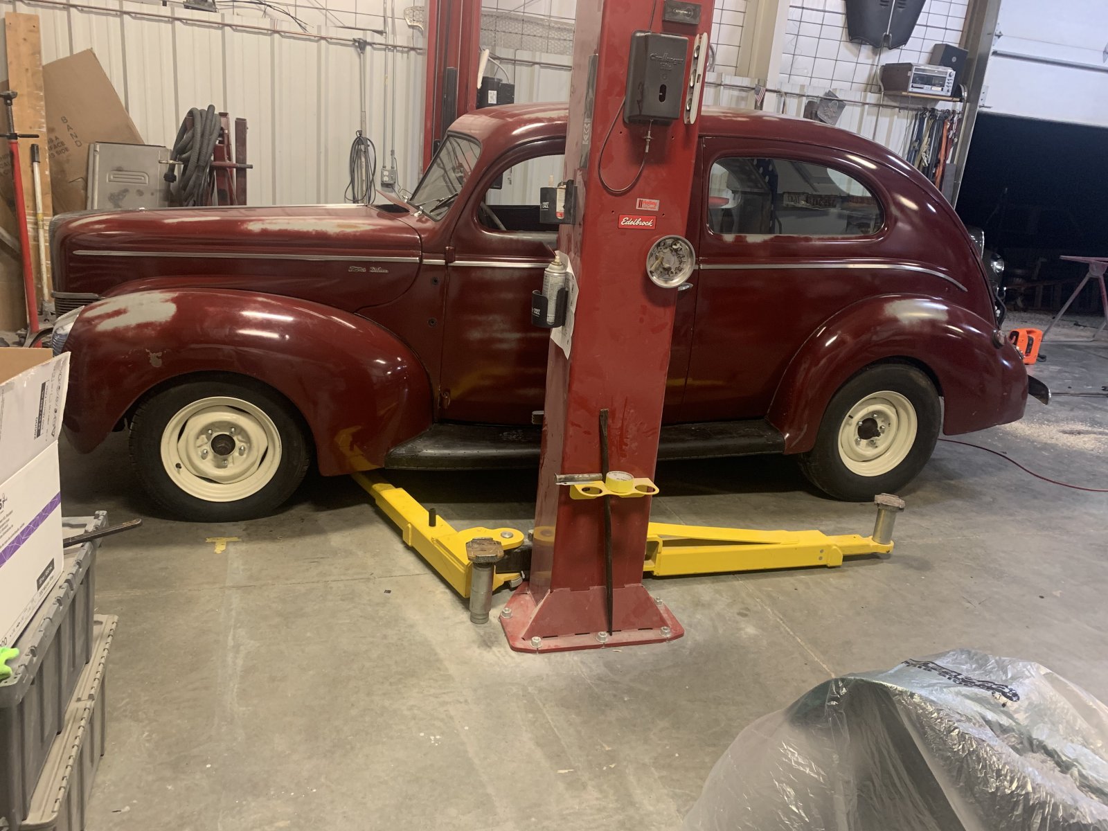

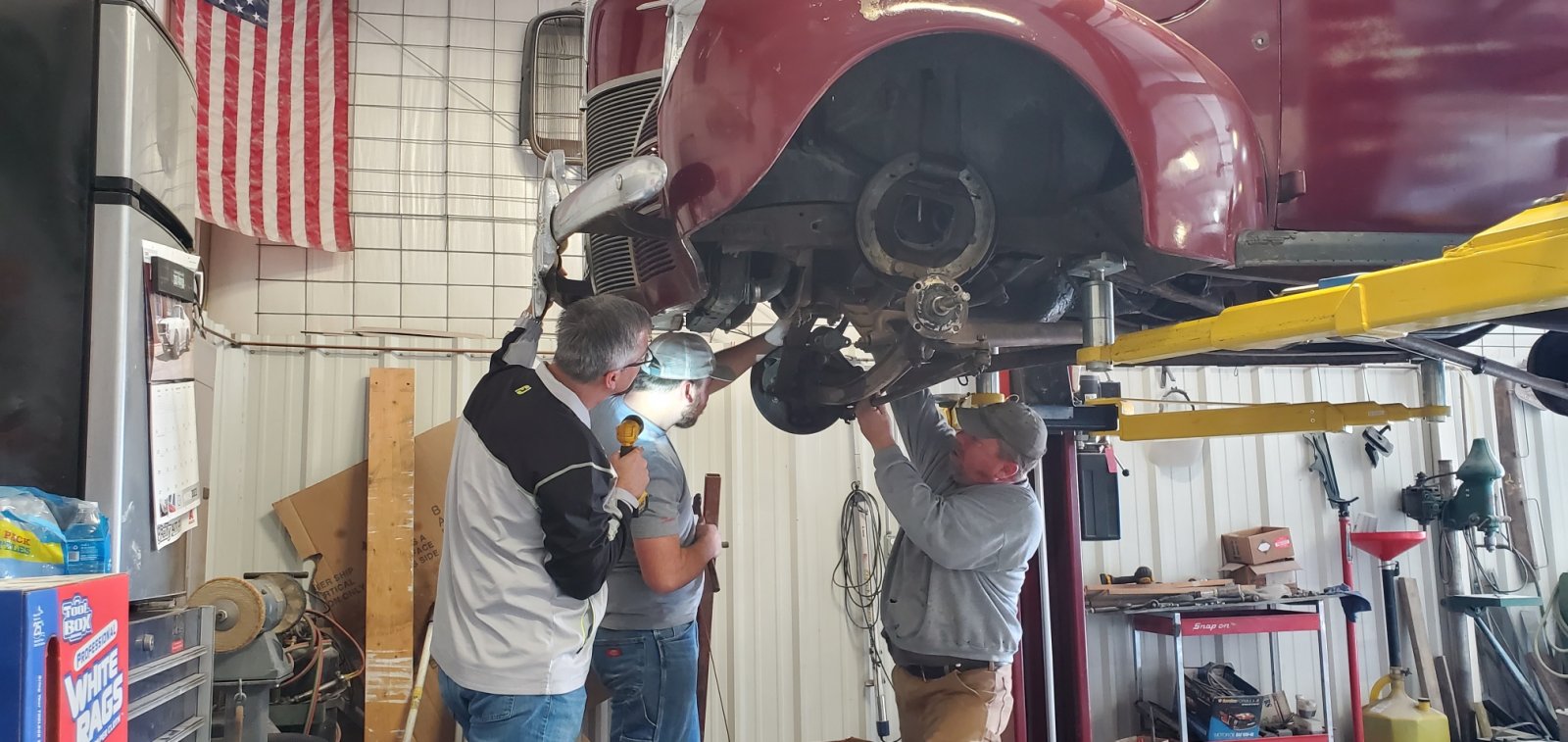

    Well, overall the day was good and we got almost everything done that we wanted to get done. We had a few things fight us but ended up figure most of it out. We went ahead and reversed the front spring and installed the drop axle. Unfortunately we found that the p***enger spindles tapered hole for the drag link was upside down. The drag link needs to go in from the bottom of the spindle and the taper is from the top down. We didn’t really understand this was, but I will have to call the spindle provider on Monday to figure out a fix. Kind of frustrating but you can’t win them all. We did get to drop the car down and see it’s new stance, and I am very happy with it! Huge thanks to @bchrismer and Mike Meeker for all of their help. I think I’d still be pulling the wheels of if I were doing it on my own. DA82EF99-A208-4568-AE56-9DAAA8DA5307.jpeg 4B7906A3-36BC-4348-8FF5-760649AB0249.jpeg 0F7C873E-907D-448B-82ED-4C5C7A6F3566.jpeg D050E696-6F23-42F7-943F-D0B9DF6A72B0.jpeg

    Great improvement in stance

    This happens every time I ask someone to hold the flashlight. Glad he was helping you this time. :cool:

  22. If the tapered hole is not too deep (too large of a diameter at the small end), you can run a tapered reamer from the other side HALF WAY THROUGH and install the drag link. The taper does help to keep the rod end tight (wedge fit), but if you torque down the nut and cotter pin it, you'll be OK.

    Haha for as many times as I’ve held the light wrong for him as a kid I’m sure I deserved it. That’s my dad, and he isn’t really into hot rods so I was thrilled to have him stop by and hangout even if it was just to light up the back of my head :D

    Yep, you can just taper the spindle arm halfway from the other side to flip the tie rod. I've done it a few times and have thousands of miles on them with no problems. The tapered reamer is a 7 degree and is available from Speedway as well as others.

  28. @alchemy , @'28phonebooth beat me to it, but you can re-taper the hole, so it enters from the side you want. Done it a few times myself. In fact, I think that there was an aftermarket pitman arm that was sold this way, at one time.

    Speedway lists one, but it's out of stock and they don't have a date when they will have more of them in.

    Thanks for all the suggestions guys. I found the reamer on speedway but it appears it’s on back order and I’m not going to spend that kind of money for a fix. I won’t be around to finish the car for two weeks anyways so I can wait for the new spindle to show up.
