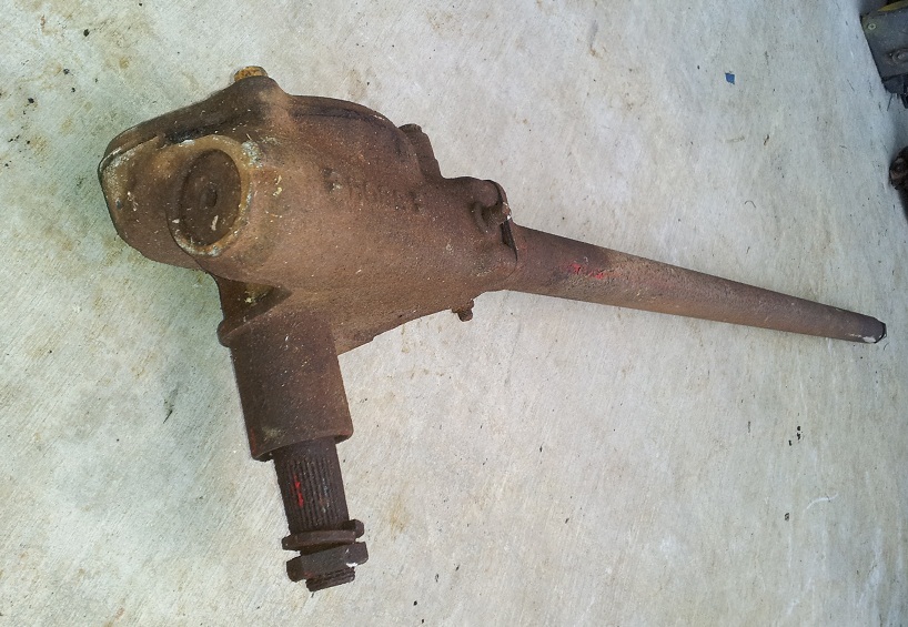

    Got a ROSS Steering box for free.
    Marked:
    Cover = ROSS T225998
    Housing = ROSS TA 142985
    It looks like it was never machined...There's No mounting holes.
    It's really tight!
    Question:
    1. What's it from and is it any good?
    2. If worth it I Have to find a Pitman Arm and steering wheel hub...What fits? Any Sources?

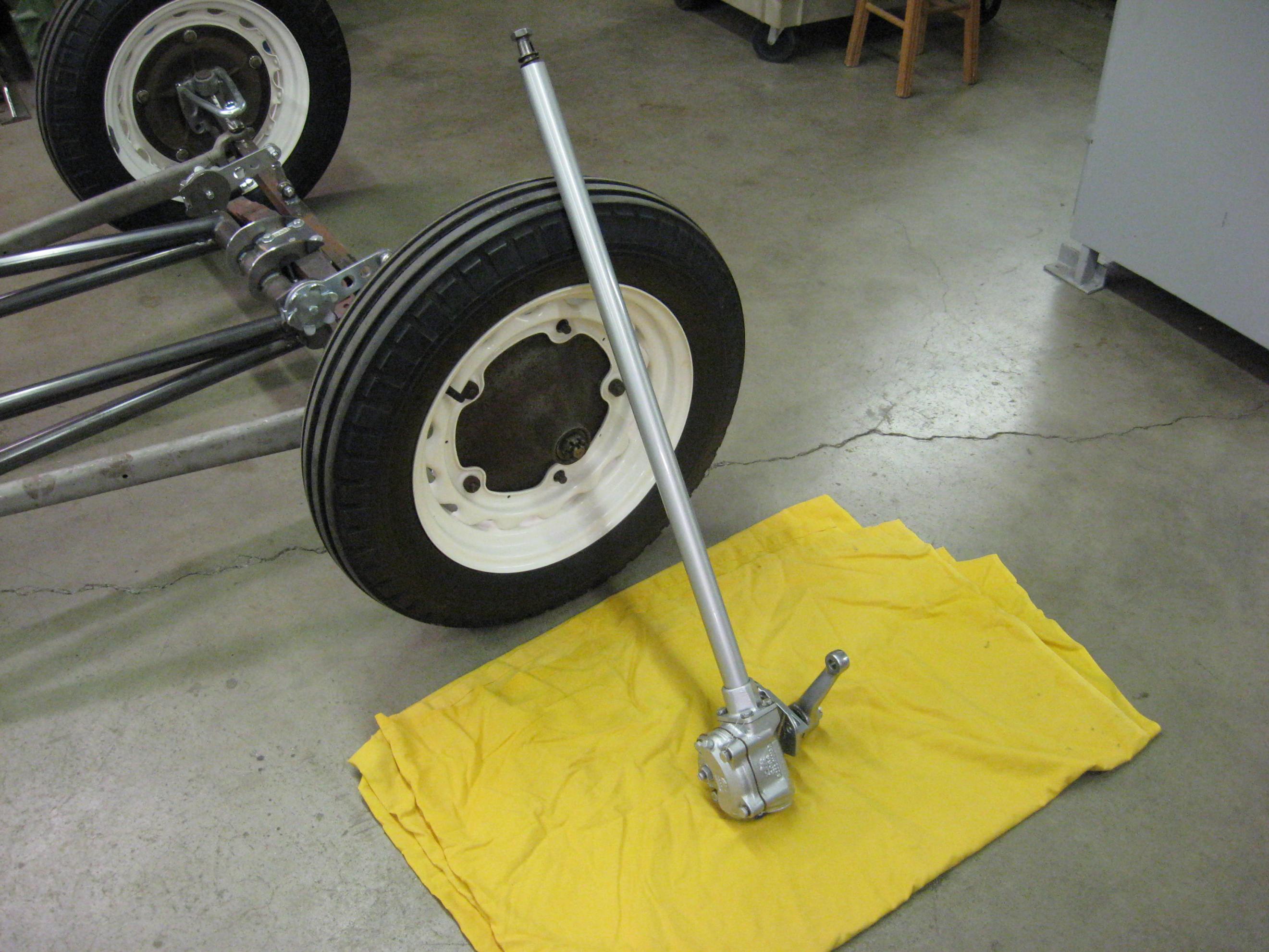

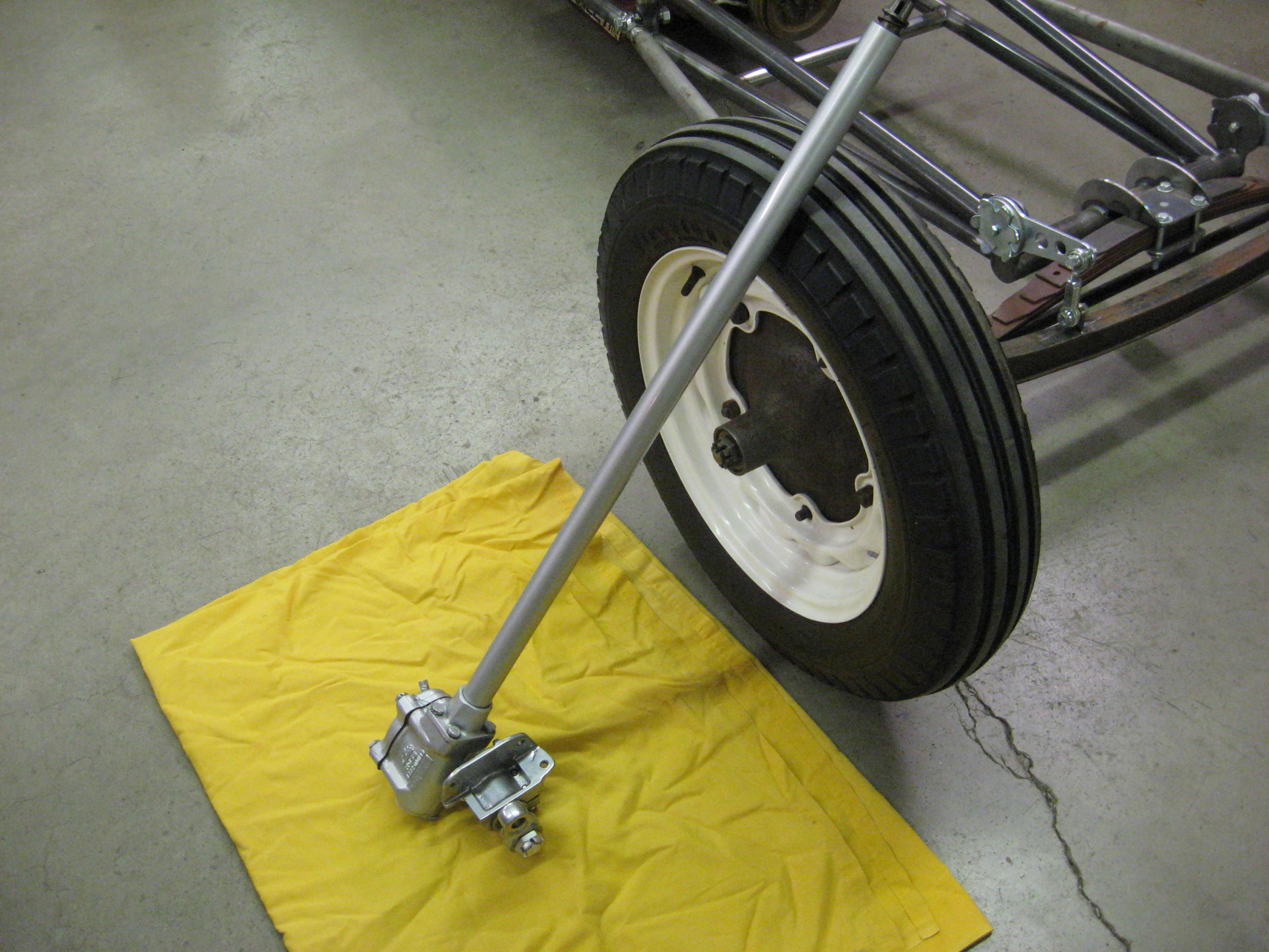

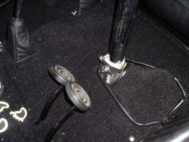

    It is out of a 67 and older VW Bus, they used one built by ZF along with Ross. To use it drag link fashion the pitmon arm will have to stick up. You will need a clamp mount like the one shown, it is a great steering gear.

    That box is also out of old Crossly,s Around 1948 or so. In a dragster the box is mounted with a plate on the right side. And the shaft is extended to around 12.5" from center of pittman arm to center of box. A Corvair Pittman arm will fit but may be too long for some installations. Not sure about the steering wheel end.

    Don,These Ross boxes are out of Crosleys, I think from 49 and later, notice the mounting ? Did the earlier ones have a clamp style mount? Until the OP checks the rotation it will be hard to know the real application.
  7. Marty Strode
    Joined: Apr 28, 2011
    Posts: 9,580
    Marty Strode
    Here are the pics.

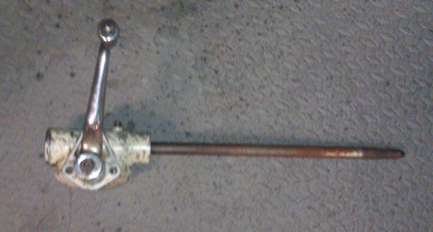

  11. Got one in my dragster.... Right hand steering

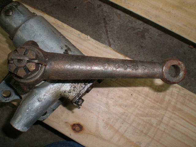

  16. I picked up a Ross box at LA Roadsters swap meet last weekend. The guy had 3 10 gallon drums of them. He told me they came of of 3 wheeled mail delivery vehicles. He didn't have any pitman arms for them and didn't know what would fit. I figured for $30 it was worth a try. Came home and took the arm off the original '31 Chevy box from my roadster and it dropped on like it was made for it.

    Pulled a reverse Corvair box out of my roadster and installed an old chrome Ross given to me by a friend. Hoping it would work as good as the Corvair. It is at least as good. But maybe it is all in my head but works good. Corvair arm fit right on it. Splines are pretty much standard so probably a lot will fit.
  19. I'll be danged, I put the old Chevy arm on a Corvair box. It fit! Maybe if I could have found the 'vair arm, I would have tried it first. I've been trying for a while to find a box that will work on my roadster. Tried Vega, car's too low, 'vair, arm goes the wrong way even though reversed, 'stang, same thing even reversed, and I gave up on the 31 box even after finding new bearings, isn't the internet wonderful. Hoping the Ross is the answer.

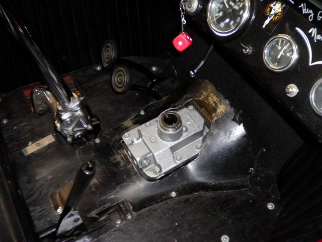

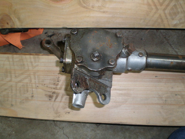

    Picked up this aluminum Ross box at the Monroe swap meet. I liked the idea that it was aluminum and thought it might be an Anglia. The ford logo on the arm would seem to confirm it. It's a cross steer unit so steers backwards.
    Norm

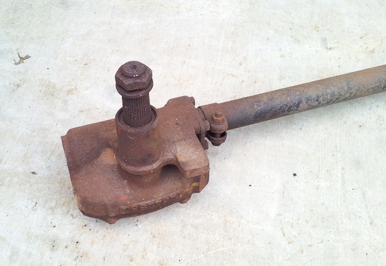

    Looking for a good Ross Steering box like this one. This one has a bad worm gear, so one for parts only would work too... Thanks in advance..
