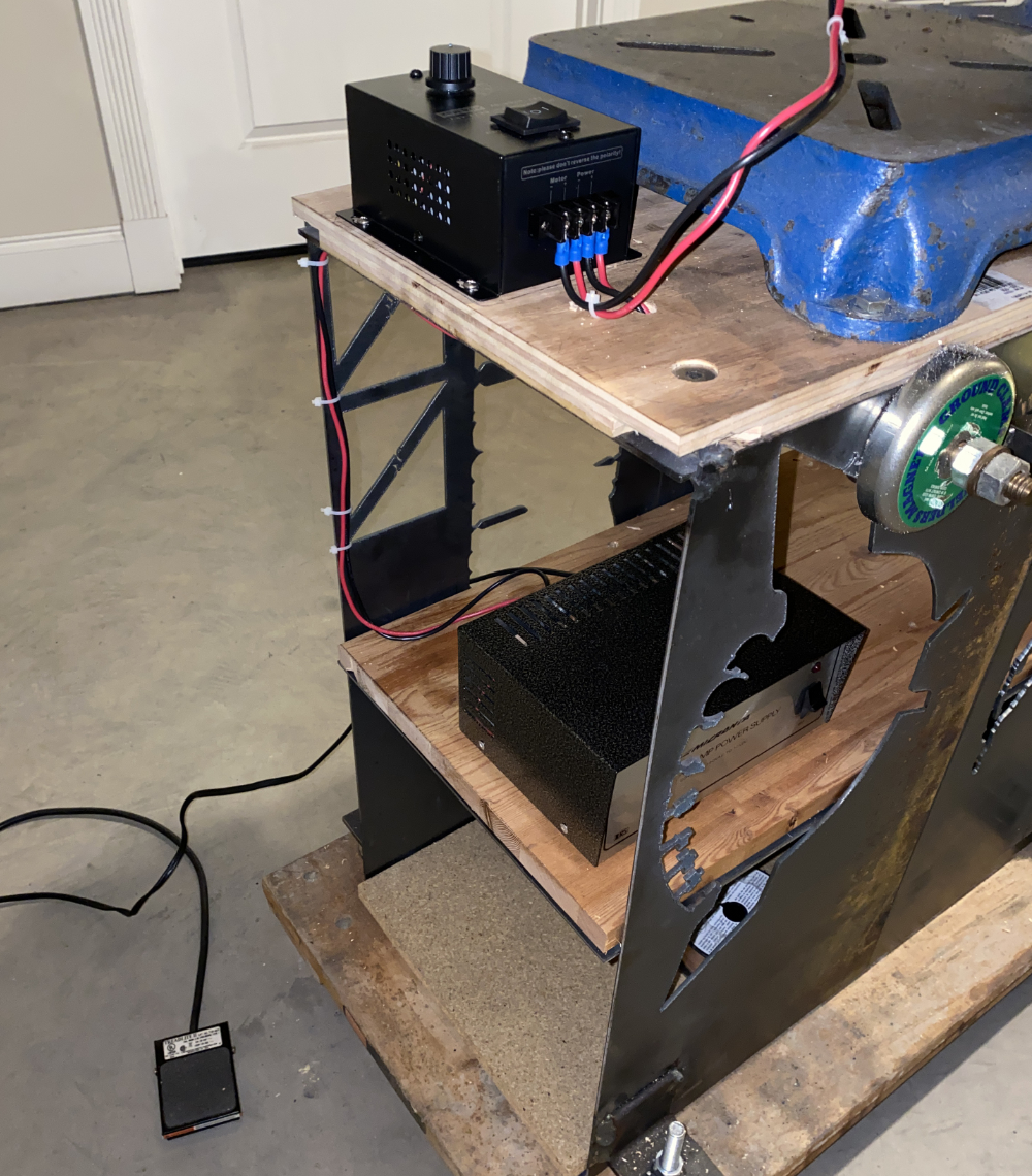

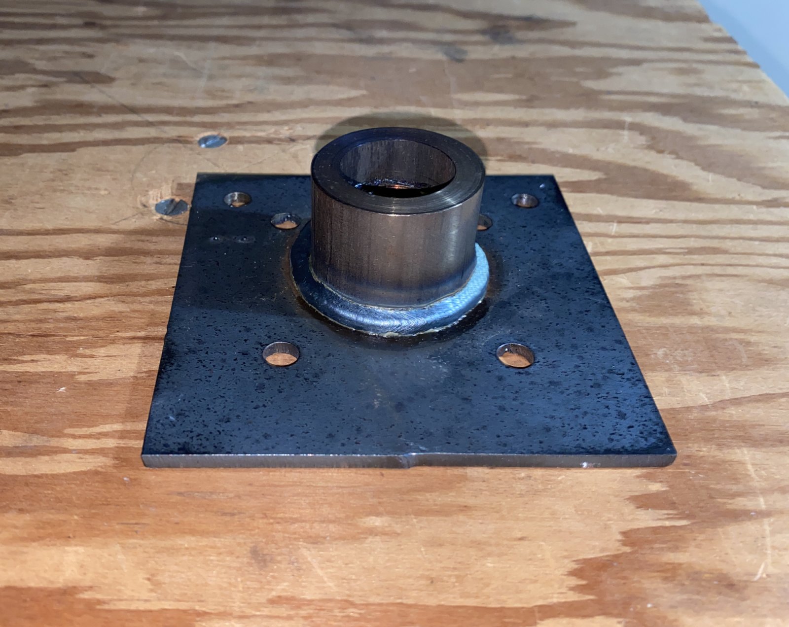

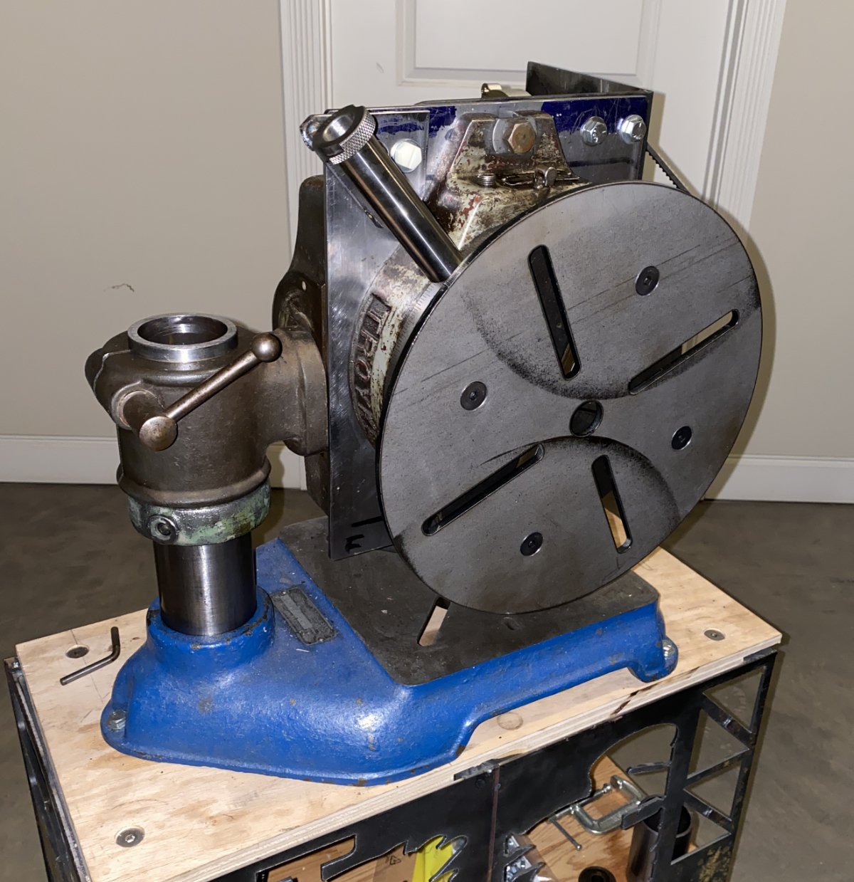

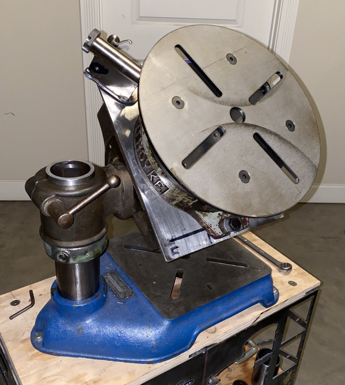

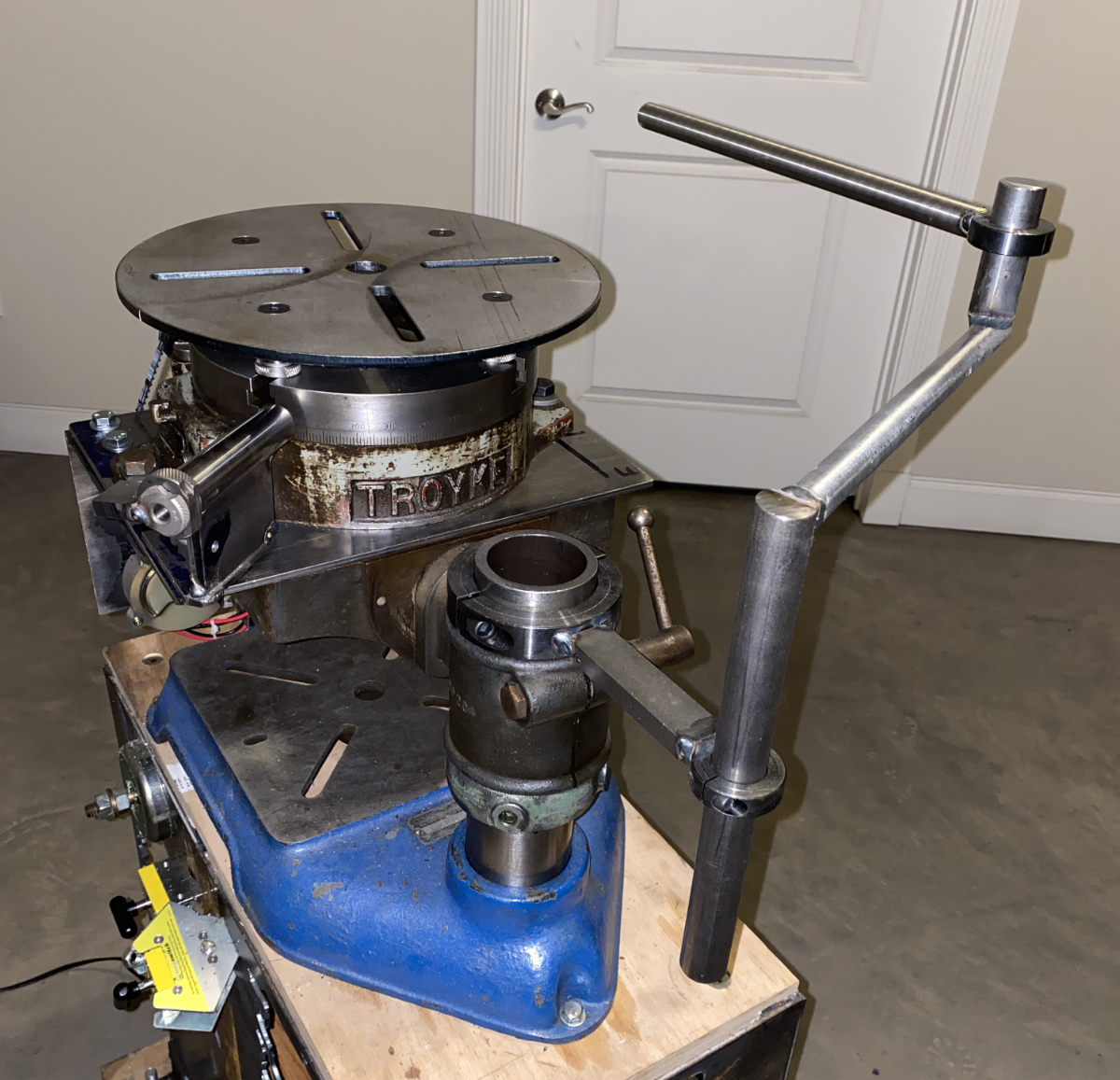

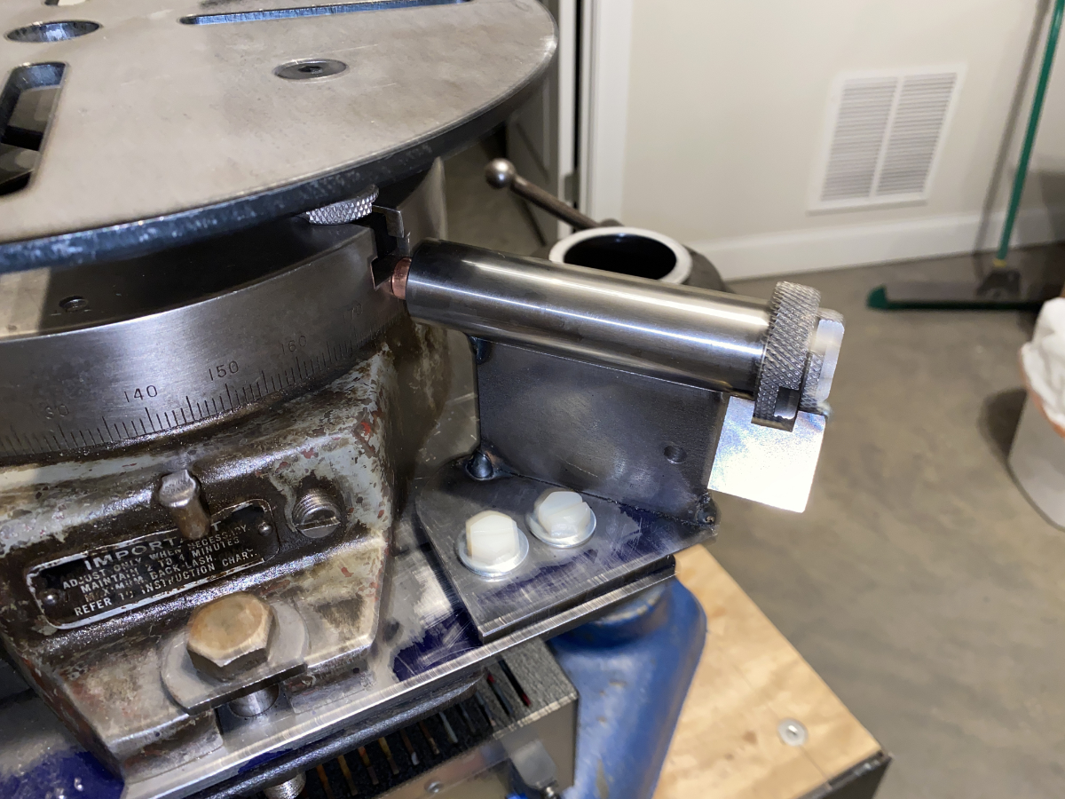

    When I got a bigger, newer rotary table, I tried to sell my old 9" Troyke on eBay with little luck. I decided to use it as a rotary welding positioner with parts from an old drill press. It tilts up to 90 degrees, and uses a variable speed 12 volt dc motor. Three clamping shaft collars and some s**** steel bar make a sturdy adjustable hand rest.

    Can we get some details on the motor and speed controller?
    I have a positioner that is missing some parts.
  4. Plasmaman
    Joined: Jul 12, 2021
    Posts: 41
    Plasmaman
    Motor is a 12 volt dc 100 rpm gear motor from https://makermotor.com. Speed controller is from https://lnztech.com. Since my rotary table has a 40:1 worm drive reduction, your speed requirements will undoubtedly be different than mine.
    Power supply is an older 8 amp 12 volt dc unit from Radio Shack. I picked it up on eBay.
