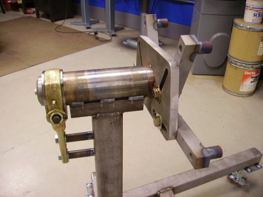

    I don't have any pictures but I saw a real heavy duty home made stand that used big truck air brake parts for the rotator. He used a slack adjuster as the rotator and a complete S cam for the rotating axle. The mounting plate was welded where the S cam was and he made a crank handle that went on the adjuster bolt for turning over.
