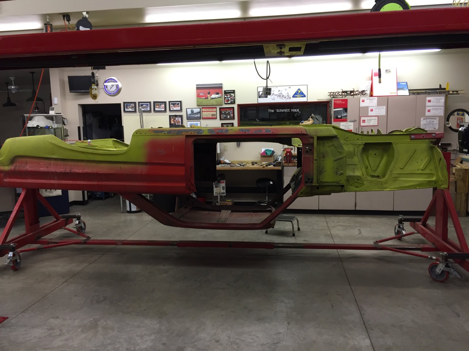

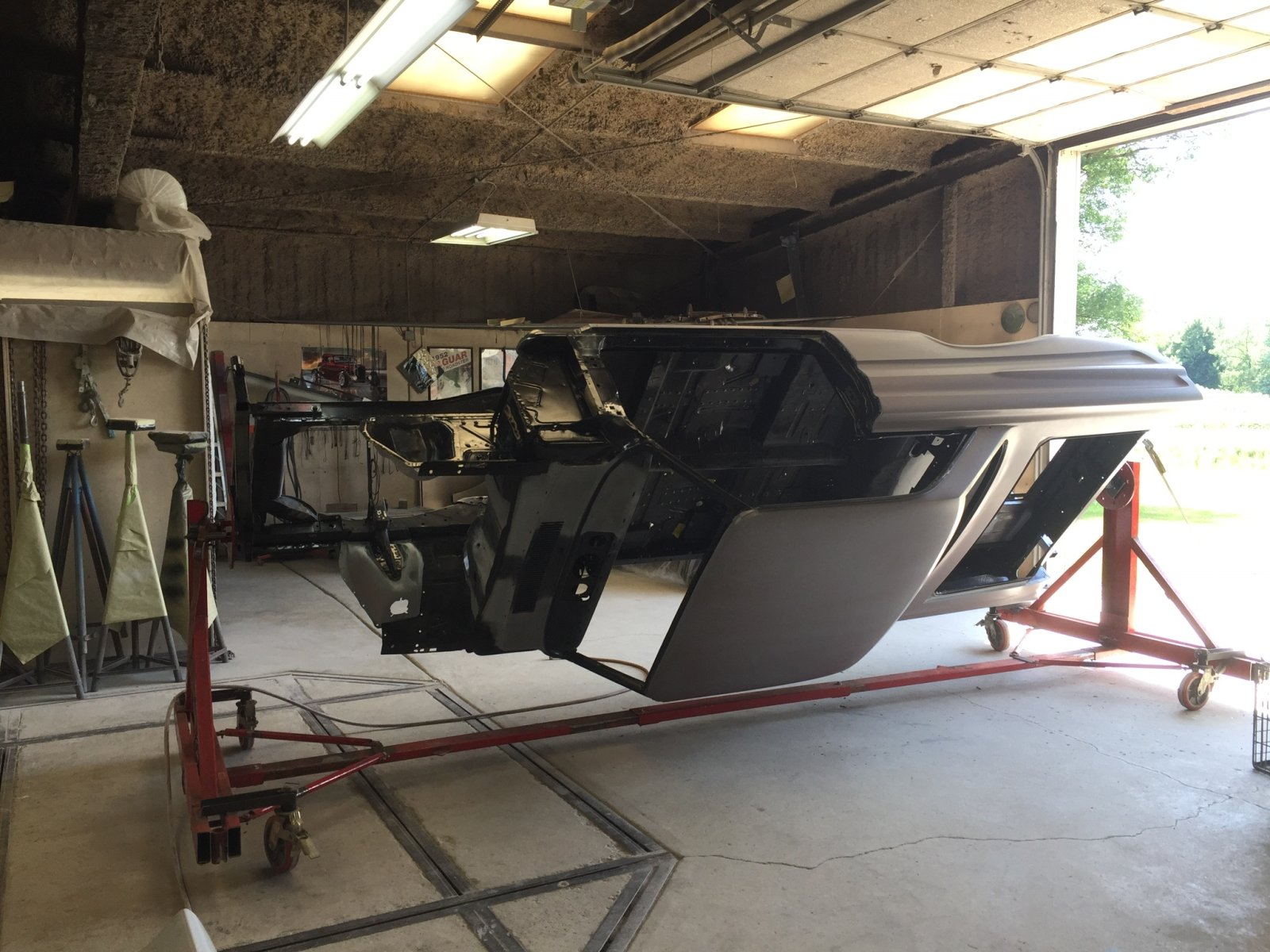

  10. kabinenroller
    Joined: Jan 26, 2012
    Posts: 1,441
    kabinenroller
    Being that mounting the body in a conventional manner is not possible because you need to replace that area you could use the rear panel as a mount but I would recommend you add substantial temporary bracing to the panel. As mentioned in a previous post bracing the door area would be a good idea also, with four doors there is a big gap even with a B post. When I mounted the my Comet body on my rotisserie I used the bumper mounts. ( uni body design) you also have to take into consideration the balance of the body once it is mounted so when you spin the body it is balanced.

    For mucsle car unibody restorations, they often use a body cart when removing all the rear structure. After the shell is solid, they will move to the rotisserie as shown by @kabinenroller.
