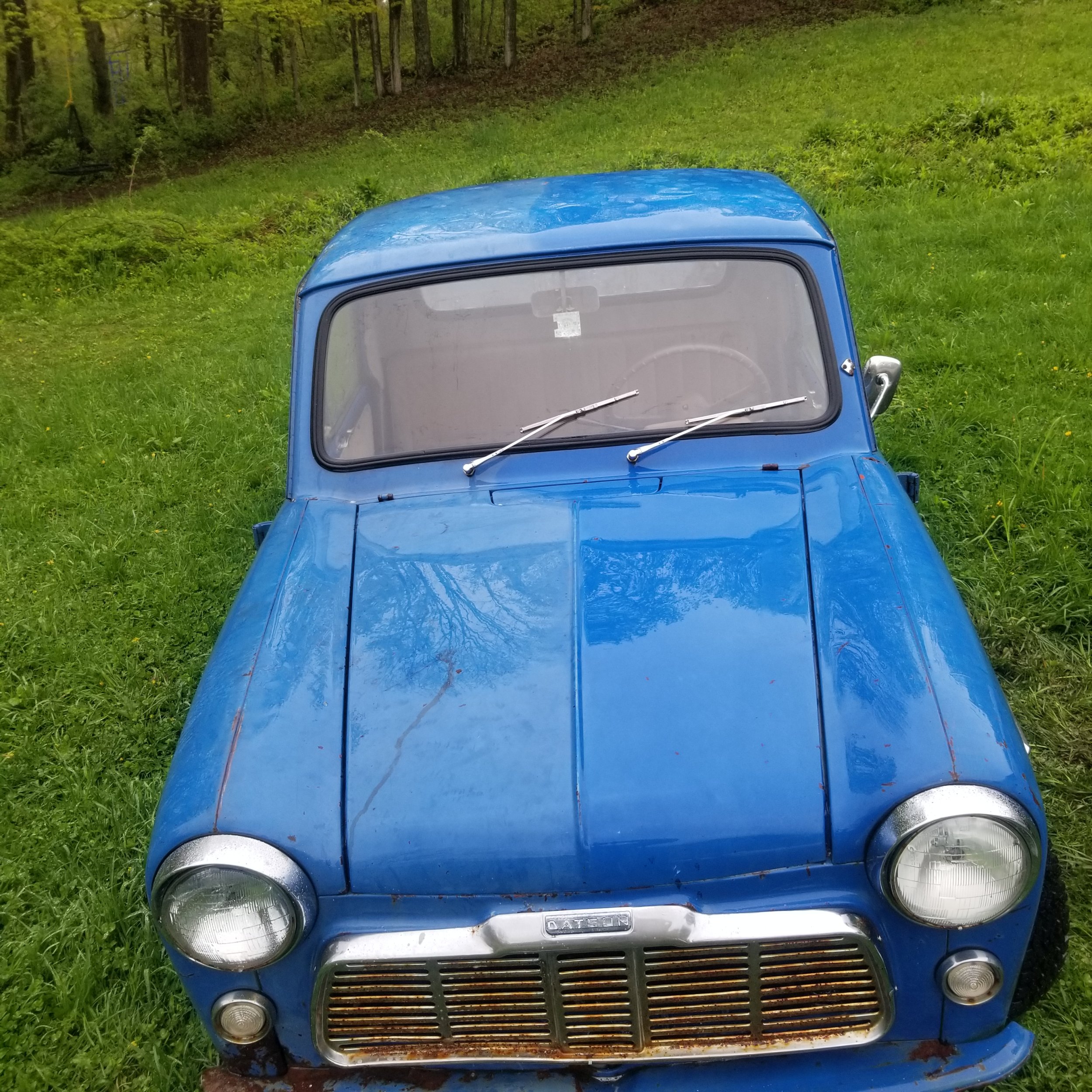

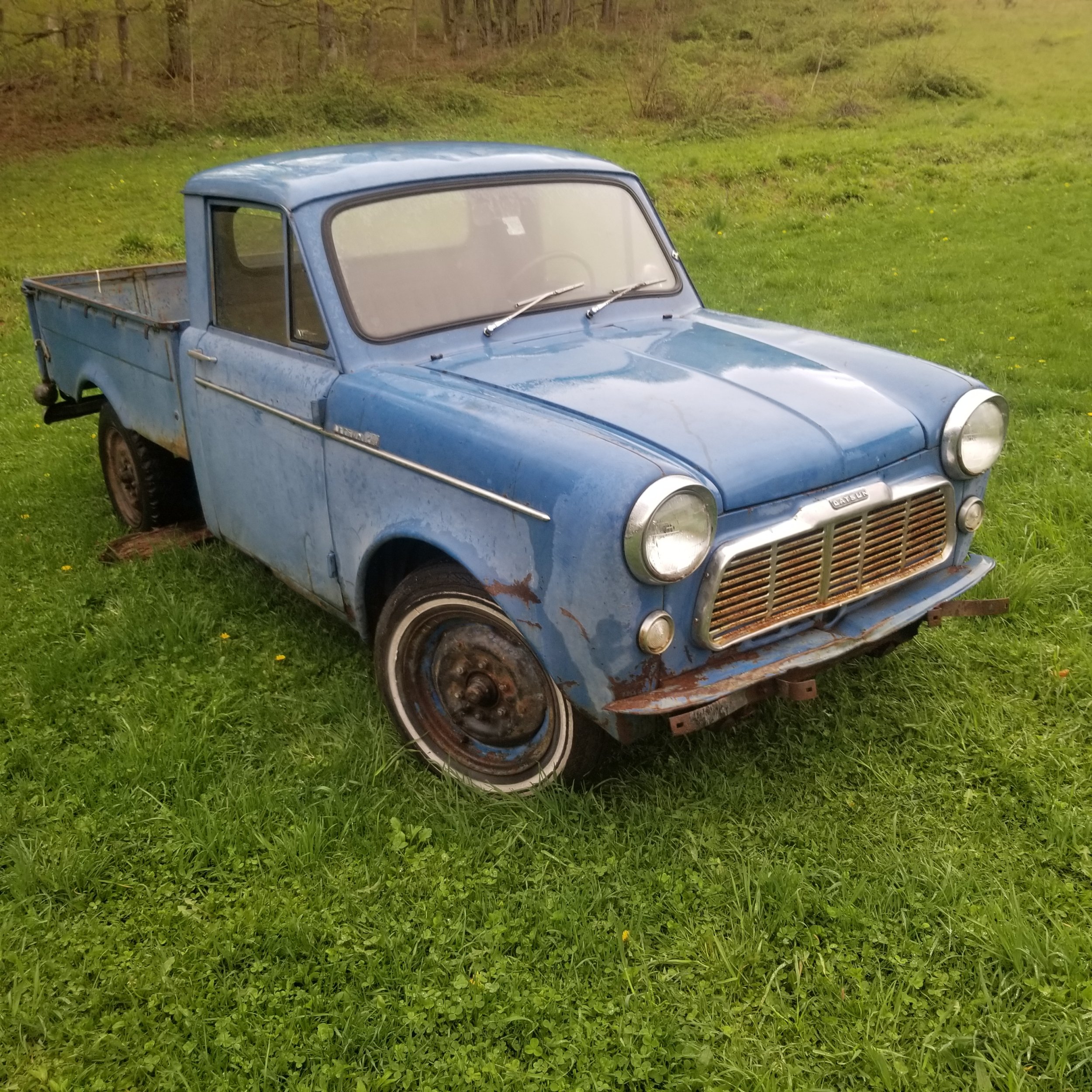

    Well I'm back again. This time with a 1960 Datsun plg221.
    I bought this with the full intent of restomodding it. Now that i have it and have learned the rarity and condition of it I'm a tad conflicted tearing into it. However, as parts have been unobtainium I find myself accepting the fact that running is better than rotting... 20250505_173245.jpg 20250505_173304.jpg 20250505_173245.jpg 20250507_202716.jpg 20250506_121922.jpg Messenger_creation_B5CCCCFF-7EED-43AC-BEAF-7A4C4696C2DF.jpg 20250505_233656.jpg

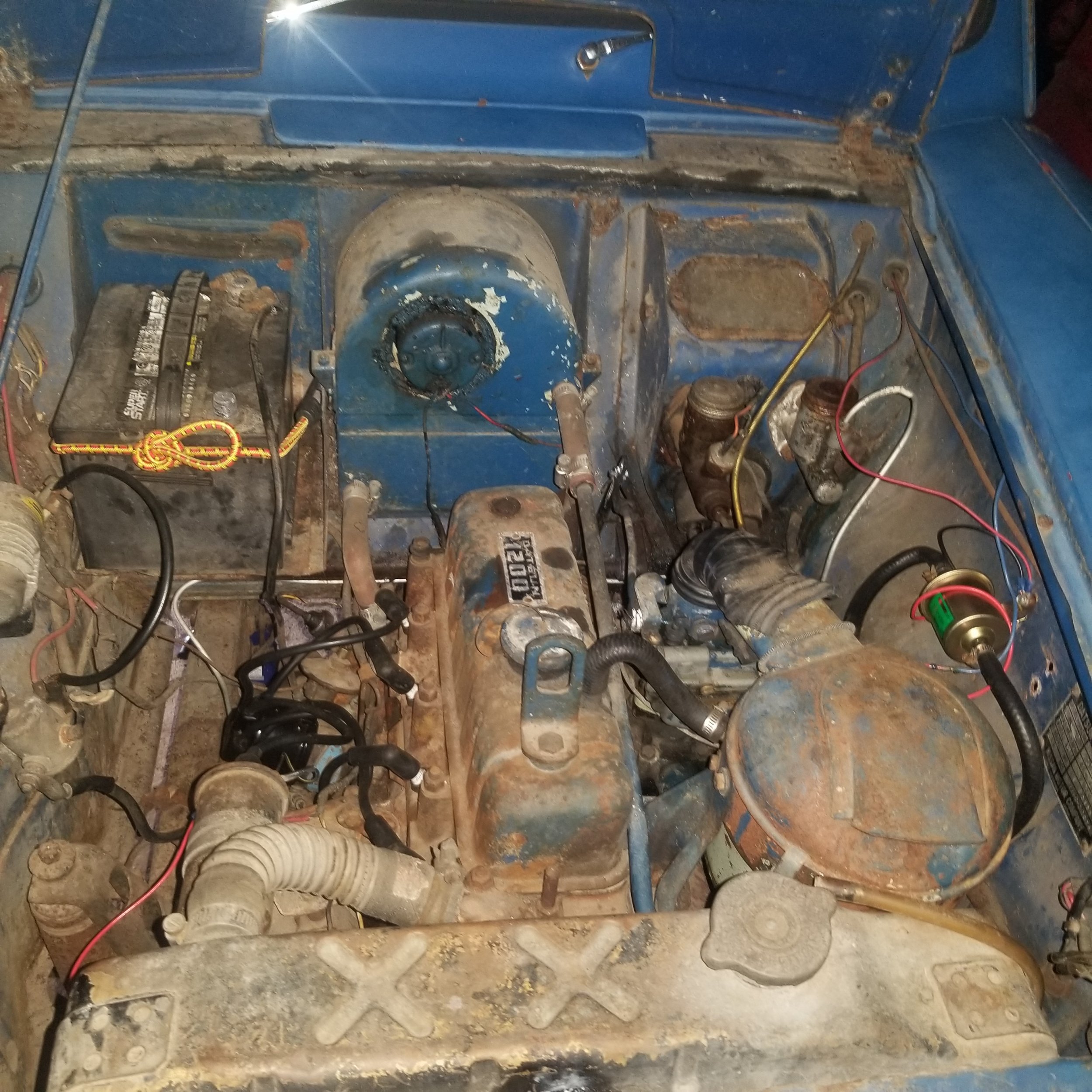

    Enging is a whopping 48hp. From what i can find its called an A1. This is #509 20250521_173458.jpg
    So far I've been able to get her running, but only with the choke on.
    I broke the OEM hitachi distributor cap. Was able to find a replacement on ebay, but it was hundreds of dollars and in Vietnam so F that... i found a similar no name one online and took a gamble and it paid off.
    OEM mechanical fuel pump gone and blocked off. Bad*** aftermarket 60s electric fuel pump dead. Had to break down and buy a low pressure lawn mower pump from Amazon.

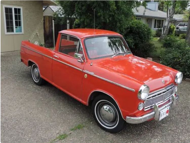

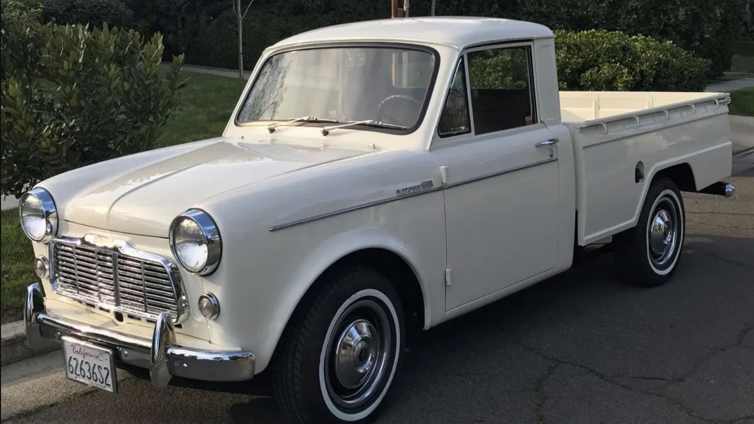

    I had a 1965 Datsun pickup with the "Cameo" bed that was sort of part of the cab. here's one just like it but in better shape. paid $500.00 for it around 1985, mine was a 4 speed column shift.slammed the brakes one time and blew out the master cylinder, after it sat for a while I sold it for $300.00. easy $10,000 truck now.:(
    the frame on the 65 is a minaiture version of my 73 truck. they also built station wagons on this truck ch***is

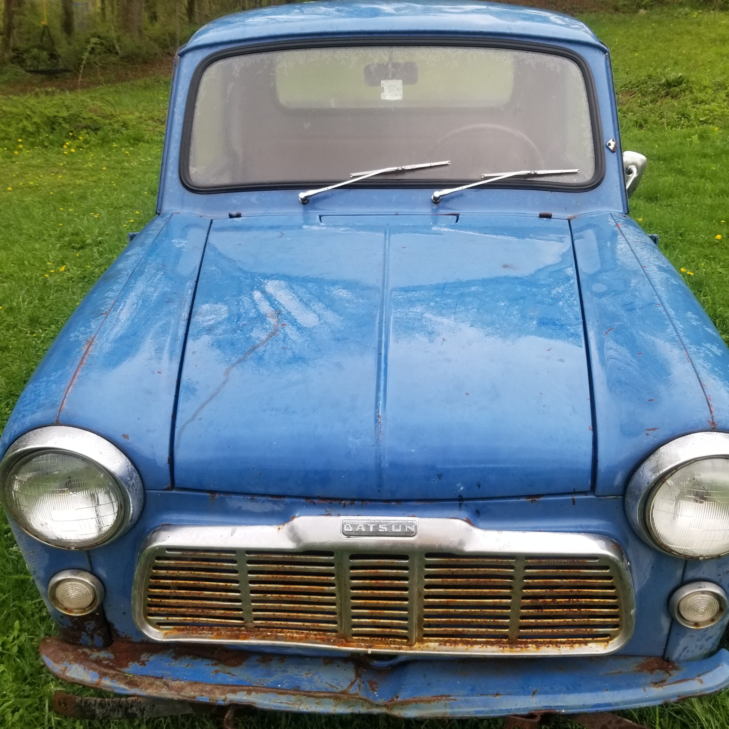

    Mine is a 4 on the tree. Took me a while to figure out reverse. Thanks YouTube, i never would've gotten that.
    Truck is TINY!!! 58" wide overall. Engine is 18" long.
    Mazda Miata just happens to be 59" wide (pay attention cl***)

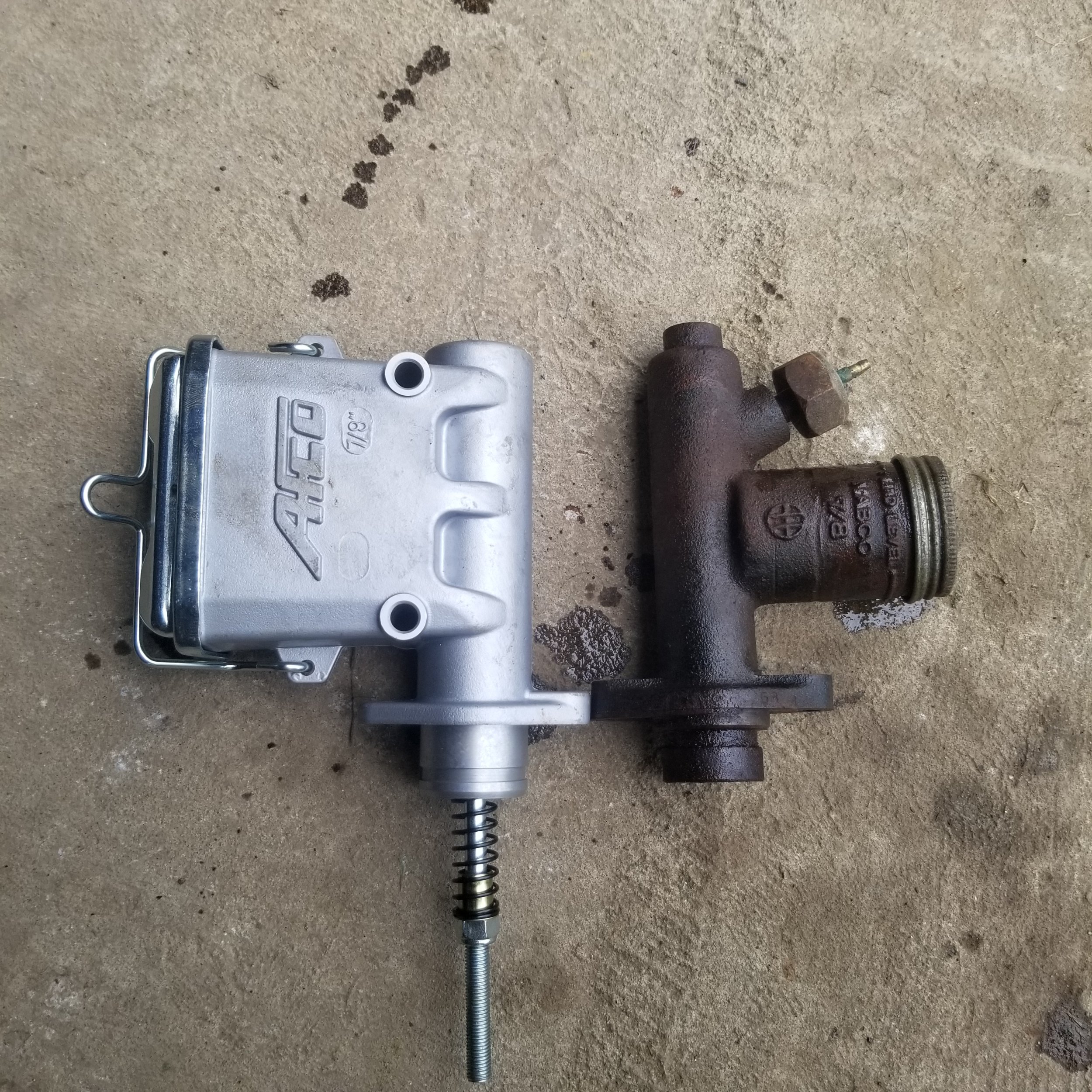

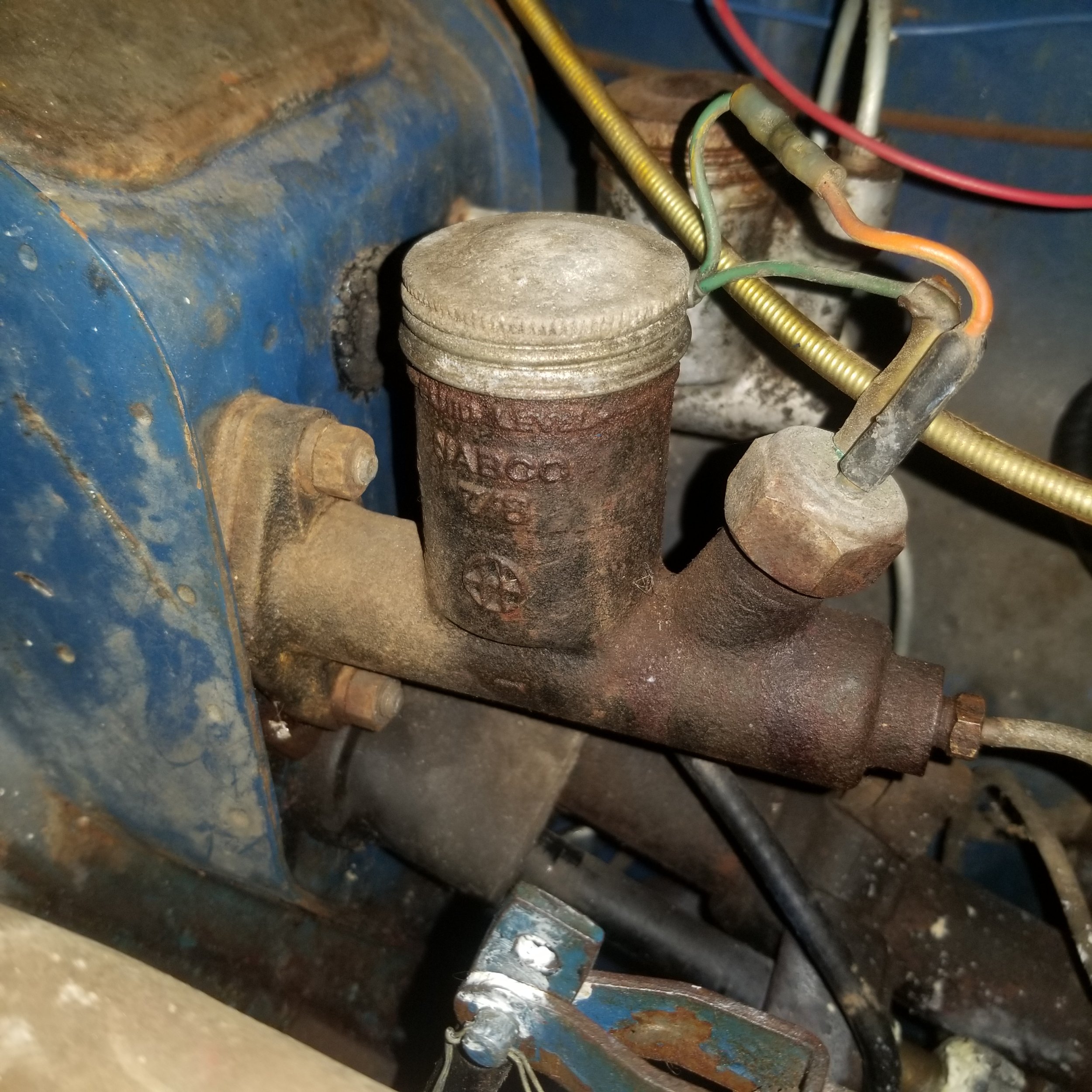

    49ratfink, about the master cylinder.. mines failed also. Leaks out the pushrod. Yet another piece i can't find.
    I just ordered a universal AFCO unit. I'll report back once that comes in.

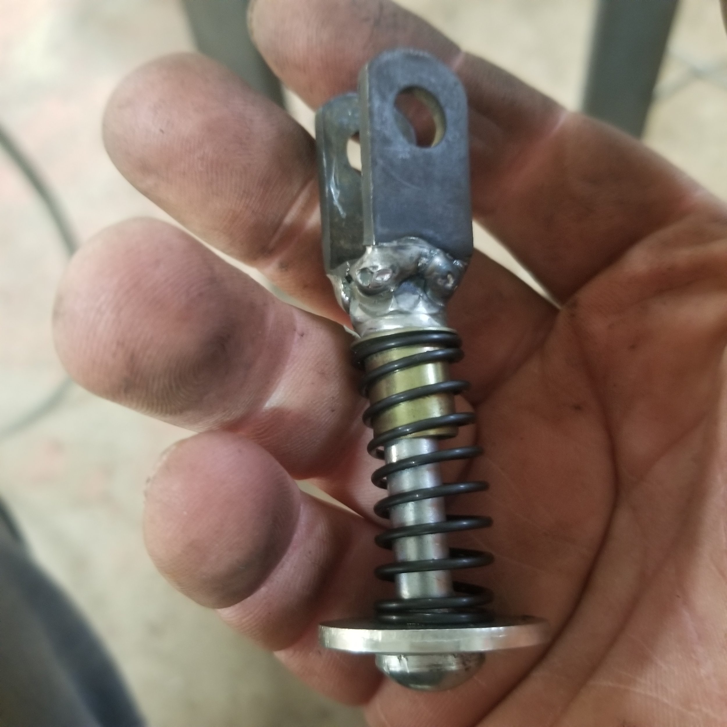

    My new master cylinder came in today. I can't believe how smoothly everything went. All i had to do to make it fit was ream the holes out a tad, and adapt the pushrod.

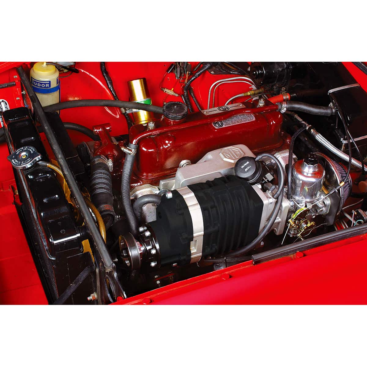

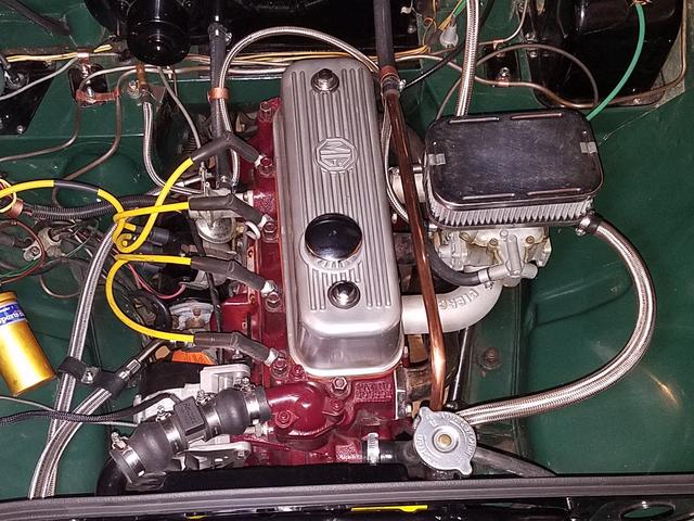

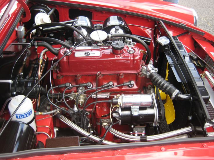

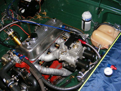

    Many Japanese auto engines of that era were basically copies of British engines.
    That Datsun engine is a copy of the B-series Austin and is identical to the motors found in MGAs and MGBs.
    The Datsun versions are usually smaller in displacement. They were used up thru the 70s so finding parts or even bolting in a more powerful 1800 MGB engine would be a piece of cake. I'm not sure what HP the Datsun engine in that truck has, but MGBs are in the 95 HP range and can make more.
    Cams, intakes, exhaust manifolds, SU carbs, distributors will mostly interchange. That "rare" distributor cap is about $12 from Moss, for example.
    https://mossmotors.com/mga-039-distributor
    https://mossmotors.com/150-040-supercharger-system

    Your carb is probably something uniquely Japanese but you could swap on some SUs or get a manifold for a downdraft 2bbl Weber DGV or side draft DCOE.
    Headers for an MG may or may not work because they'll fit the engine but may not clear steering or ch***is components.

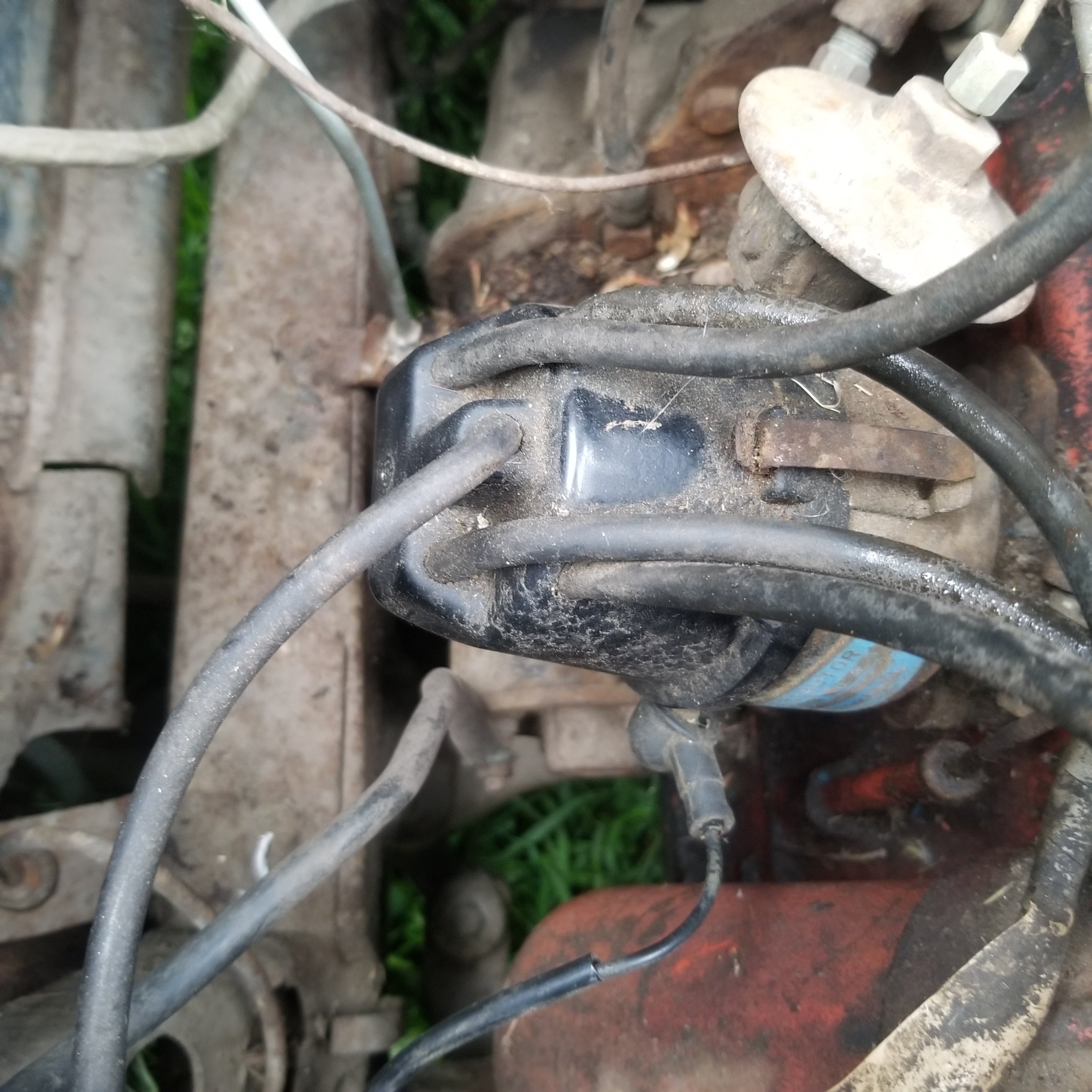

  24. The first thing i noticed with the first photo of the engine was the lifting hook on top of the valve cover. Your missing one and they are exactly the same as on my 1947 / 1953 Austin A40s.

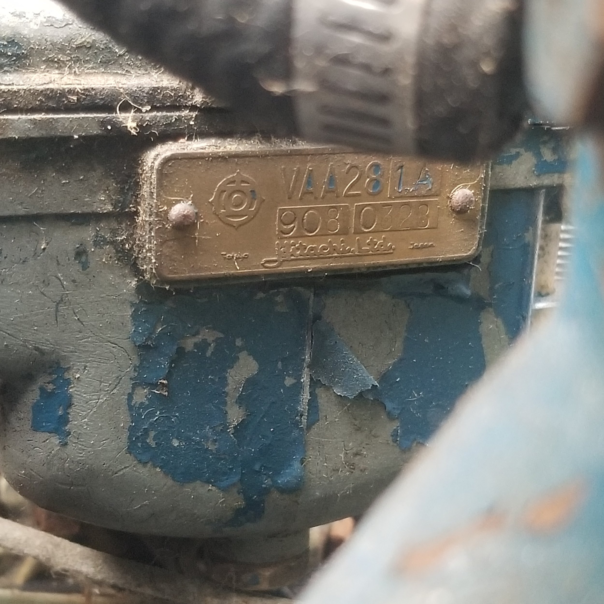

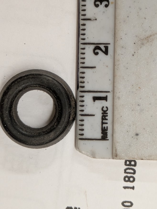

    I really need help finding a new accelerator pump for this thing. Im pretty sure this is why it was parked decades ago. I found a post in another forum from years ago, and it had to be about this exact truck. I just cant verify because all the pics are now gone. But the info lines up exactly with this truck. Anyways... they were looking for an accelerator pump then...
    If anyone could help I'd be greatly appreciative. The carb is a Hitachi single barrel. VAA28 1A 20250513_194013.jpg

    squirrel
    If it uses the cup type, you might be able to find a cup for the accelerator pump from dimensions, or if it's a leather one that's riveted/staked in place, some patient fiddling might be able to fix it.
    if it's a diaphragm, maybe you could make or modify one from another car?
    pictures would of course help point you in the right direction, we're guessing blind on internal carb parts

    I'll try and get pics, just had it apart again earlier today. I have an accelerator pump from a Carter WO i was hoping i could steal the seal from. Its just barely to big, coming in at 5/8".
    I cant tell if the bad one is really brittle rubber or really brittle leather. Half of it was in pieces in the bottom of the bowl.
    Best description i can give without pics is that the one i have looks like a stromberg one without the bend at the top.

    I did some math. Im probably wrong but from what im finding is one size smaller than 5/8 would be about a 15mm replacement cup. What are the odds of finding that locally on memorial day haha

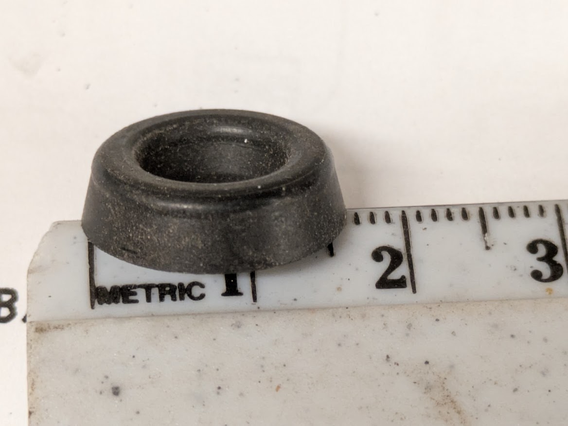

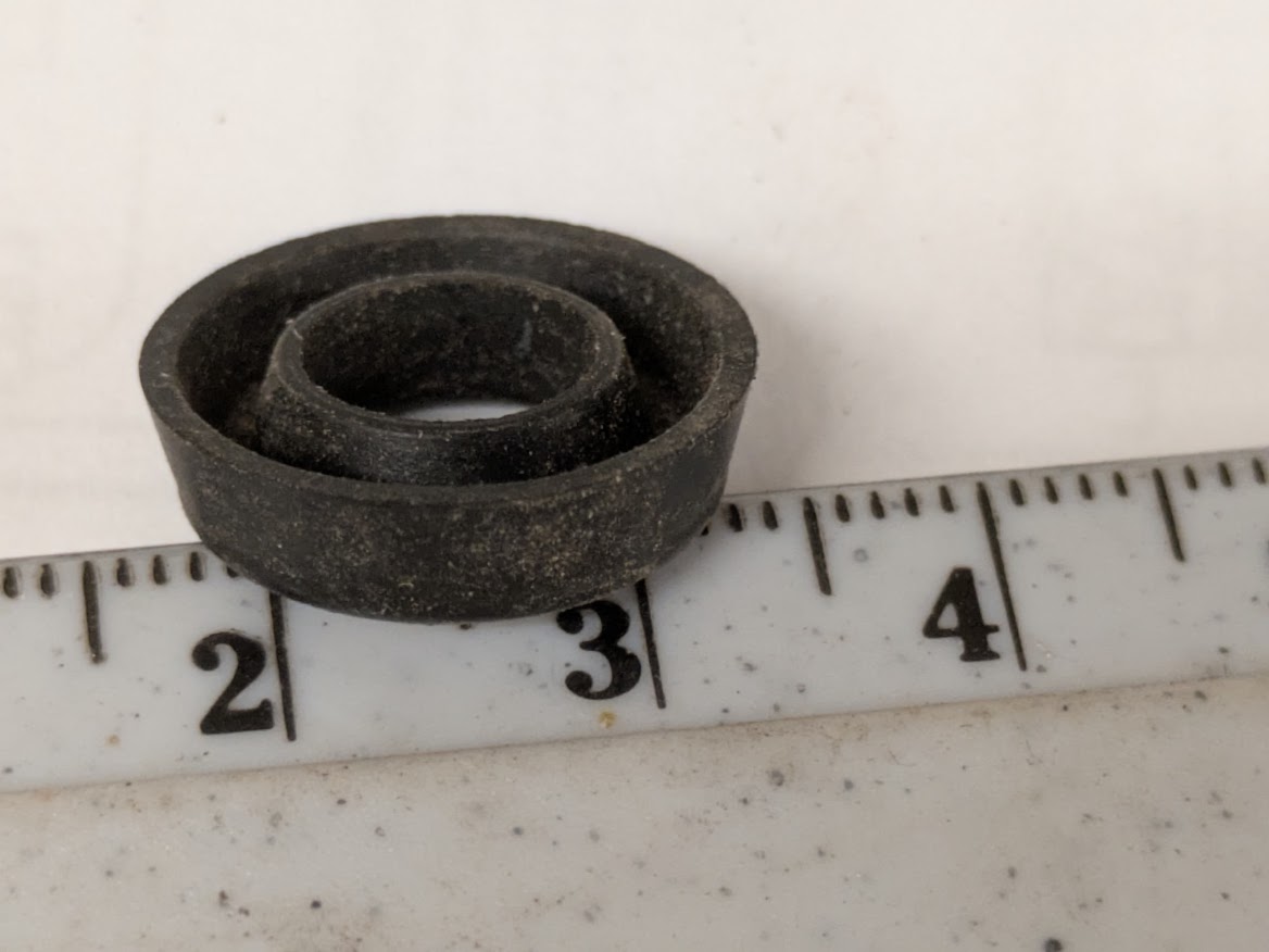

    you never know. This was in my little bin of misc leftover small carb parts.

    Oh man thats probably the one haha
    I noticed mine has a spring in it like this one. So it probably was rubber
