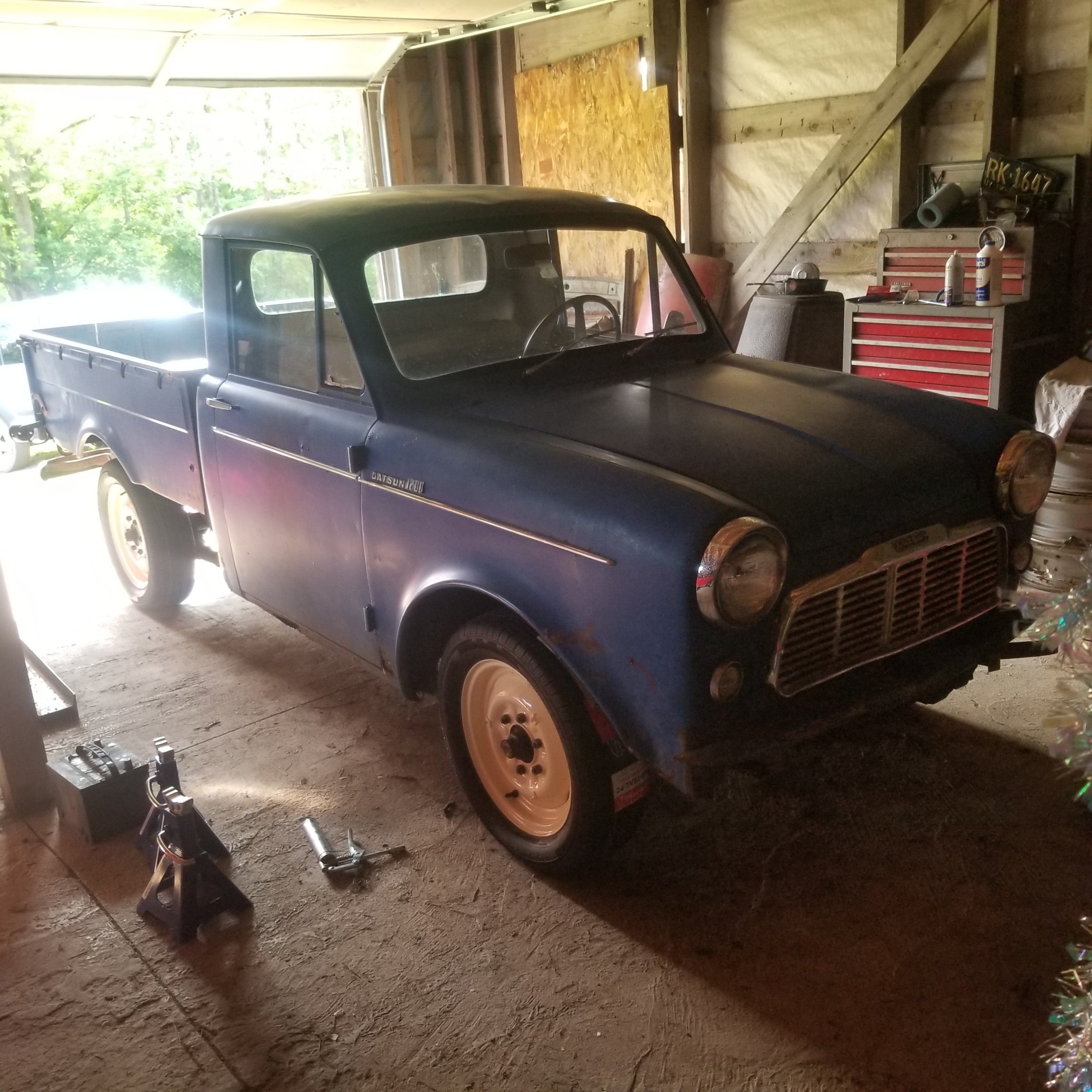

    Heres a boring garage pic.
    Im working on this in my unfinished garage at home. I lost my shop back in February from snow. I was spoiled, had it all. Tools, lift, ELECTRICITY... Now I'm doing all my work with a friggin flashlight strapped to my head haha.

    Never noticed until now how much the front resembles a Mini. And this isn’t a boring pic, it looks like progress!

    So my buddy was at the parts store getting stuff for his mini cooper(modern) and the guy working the counter told him about a mini cooper pickup truck that went by on a trailer the day before haha
    Take the grill badge off and nobody would know
