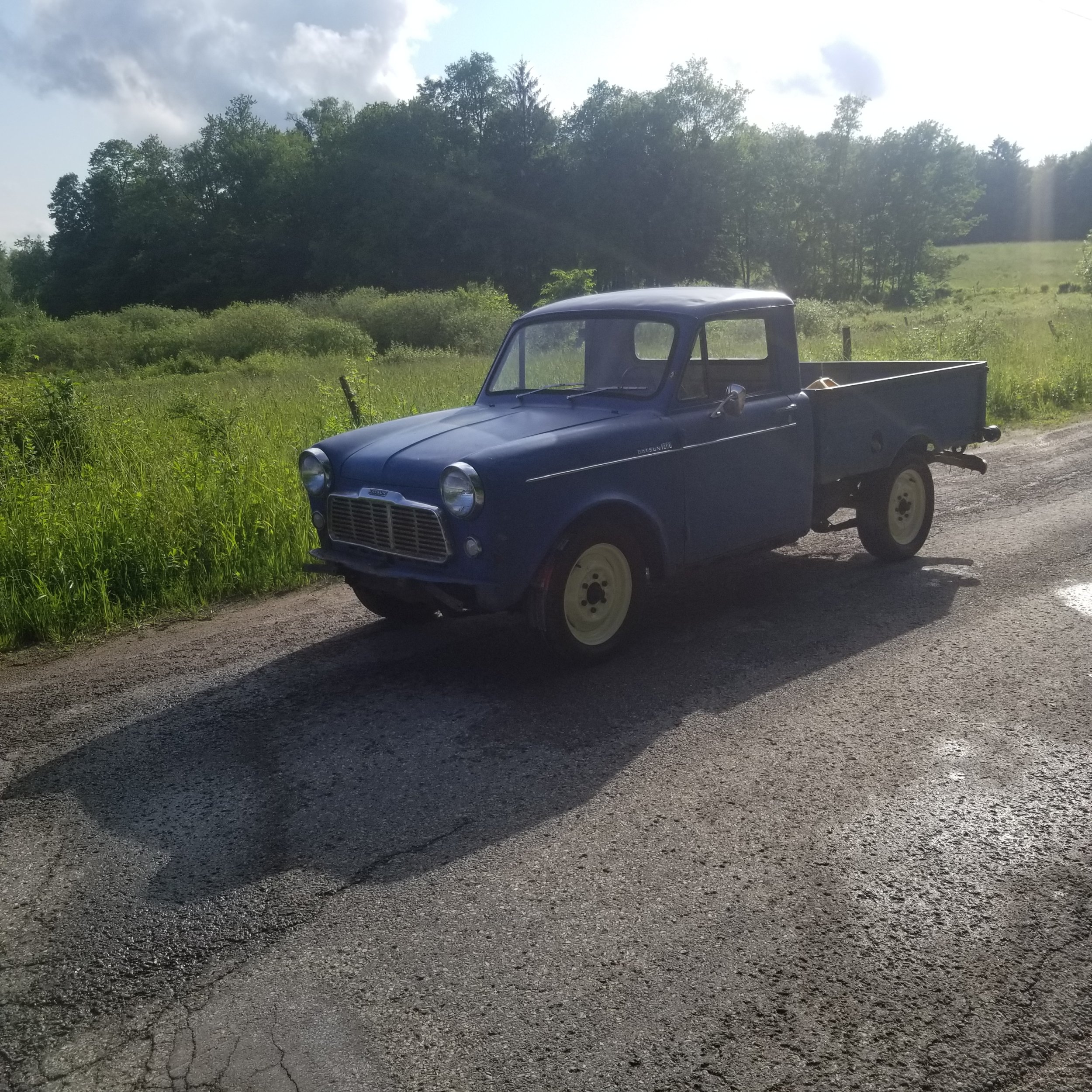

    Cause: pickup line in tank fell off bulkhead fitting. Currently laying in bottom of fuel tank.
    Atleast the rain stopped.

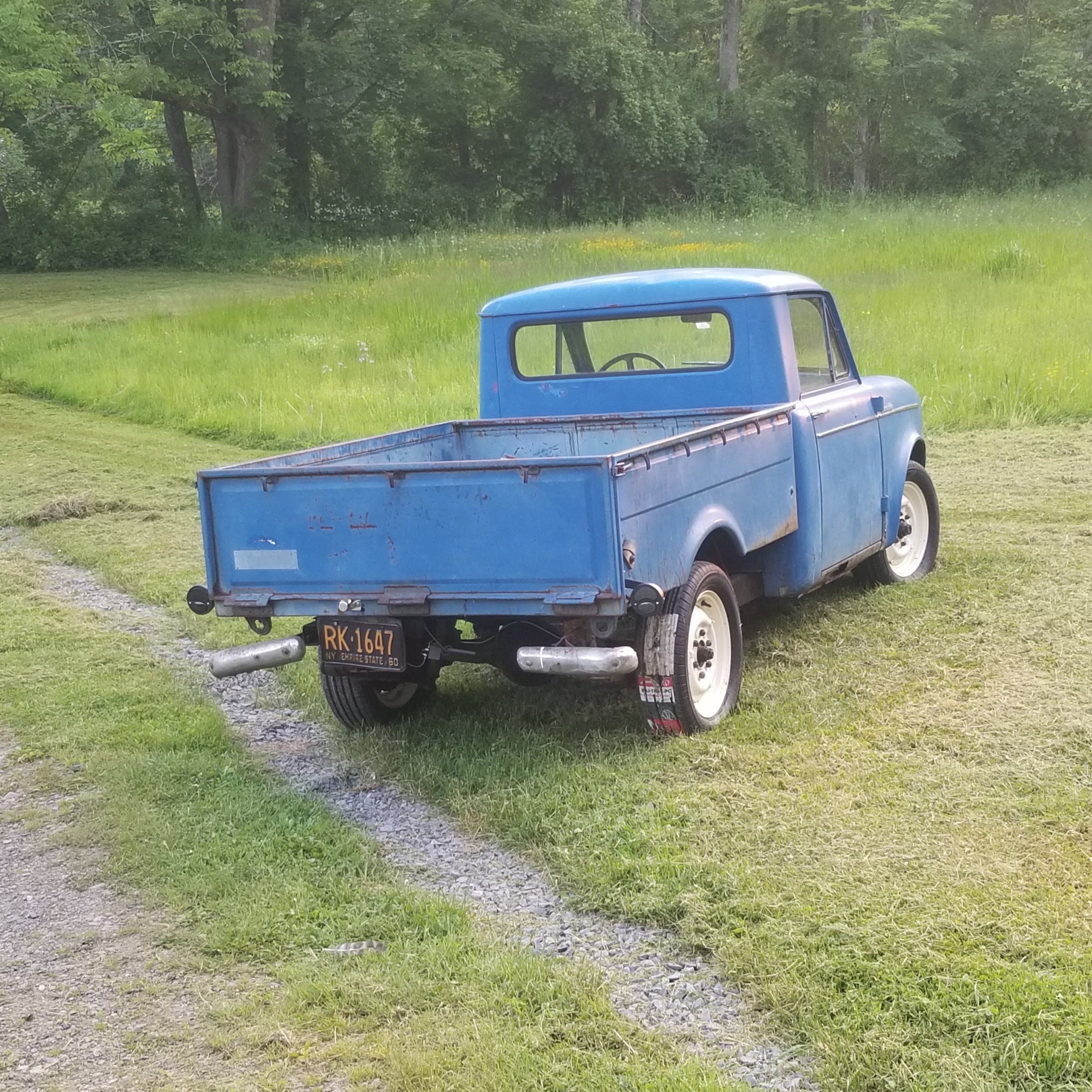

    The boy took some pics today

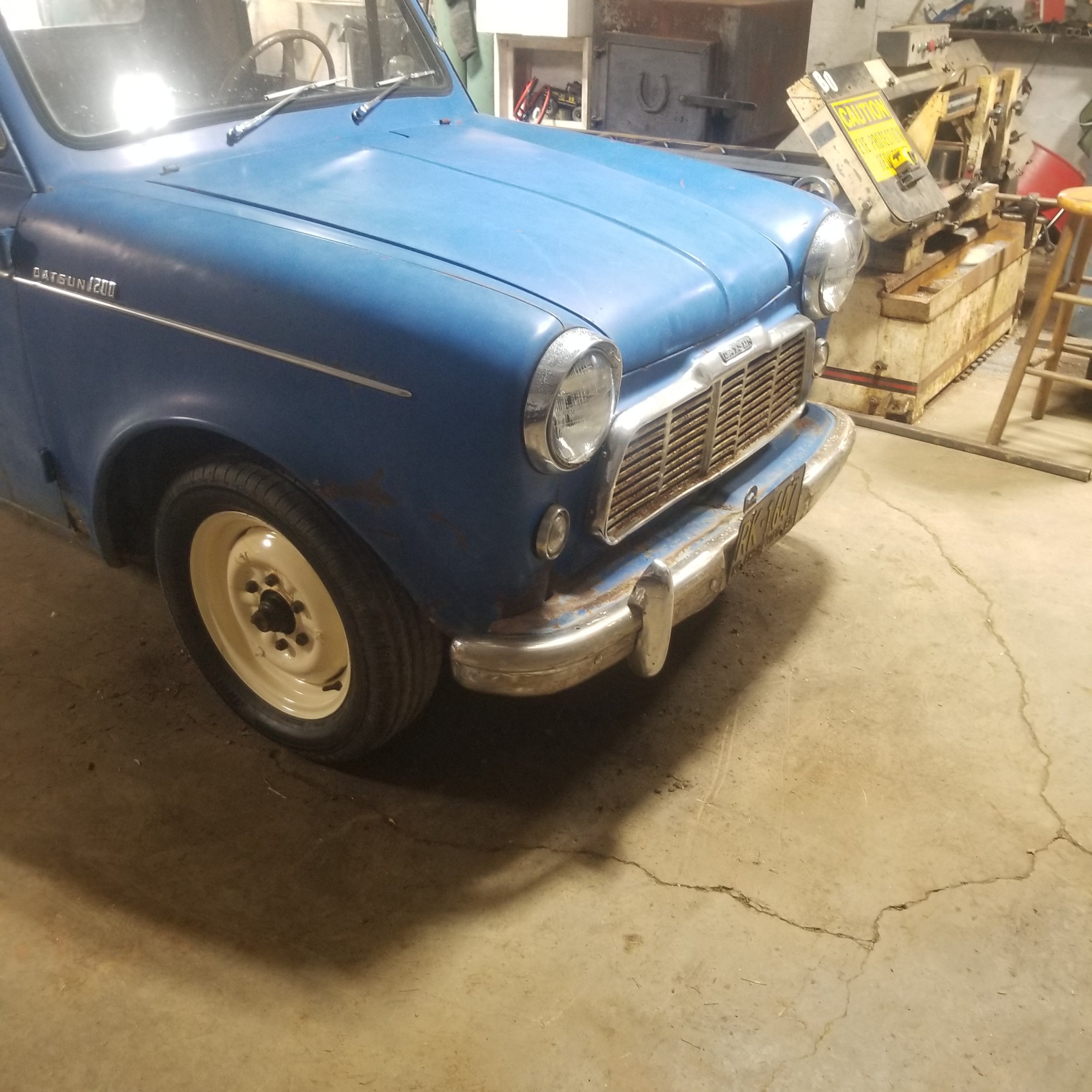

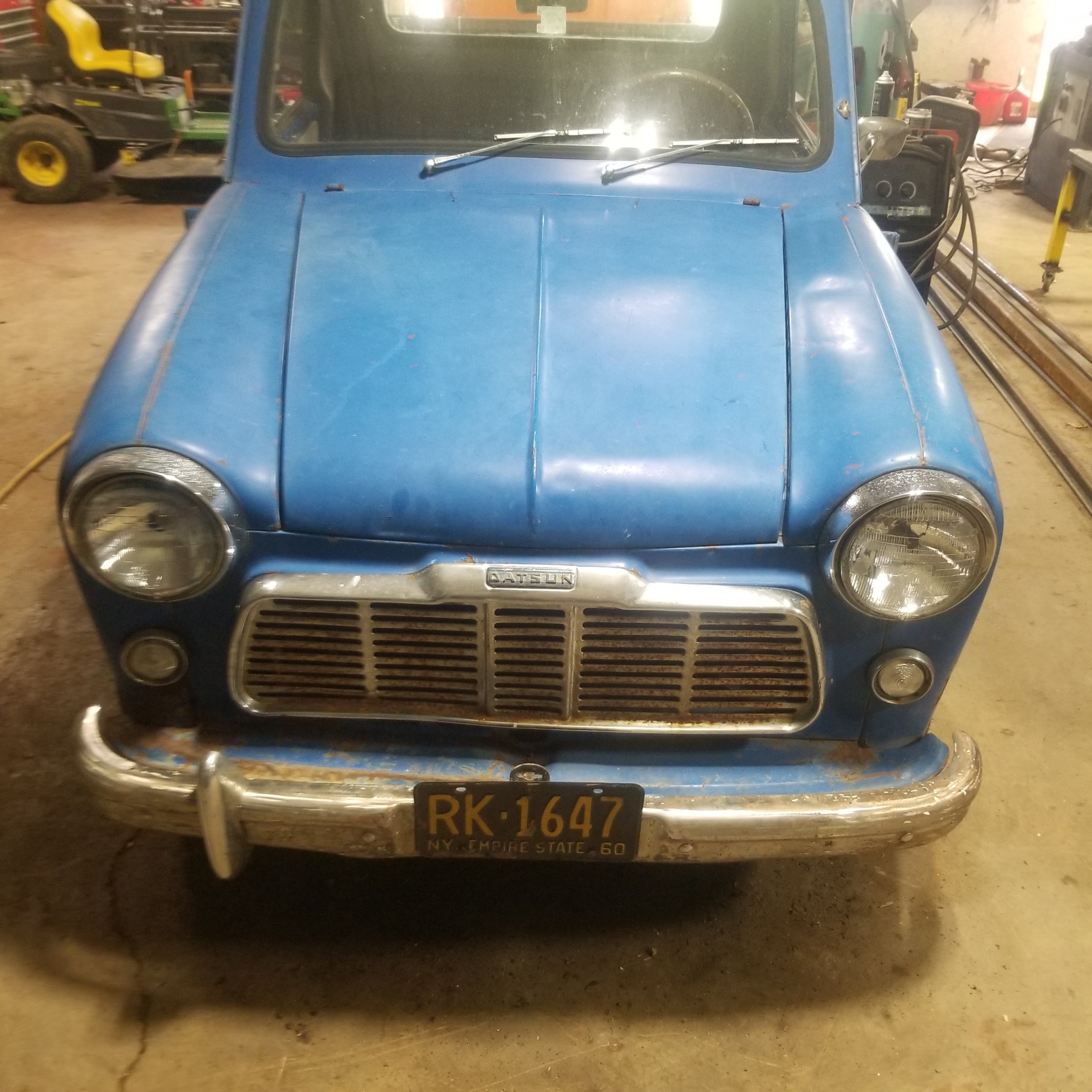

    Front bumper mounts have seen better days. I'll try and tweak them straight. If that dont work I'll just make new ones
    This is how it sits with all the bolts tight
    Deutscher, Sharpone, bobss396 and 4 others like this.
  19. hillbilly4008
    Joined: Feb 13, 2009
    Posts: 3,178
    hillbilly4008
    Loads of tweaking, hammering, and pulling. Good'nuff.
    The front p***enger corner took a hit at some point. Grill and front of fender were pushed back about an inch and a half. Don't really notice it till the bumper was on.
    Front frame horns where the bumper brackets mount were both tore off and stick welded back on in the past. Nothing straight haha.
    Decent now
