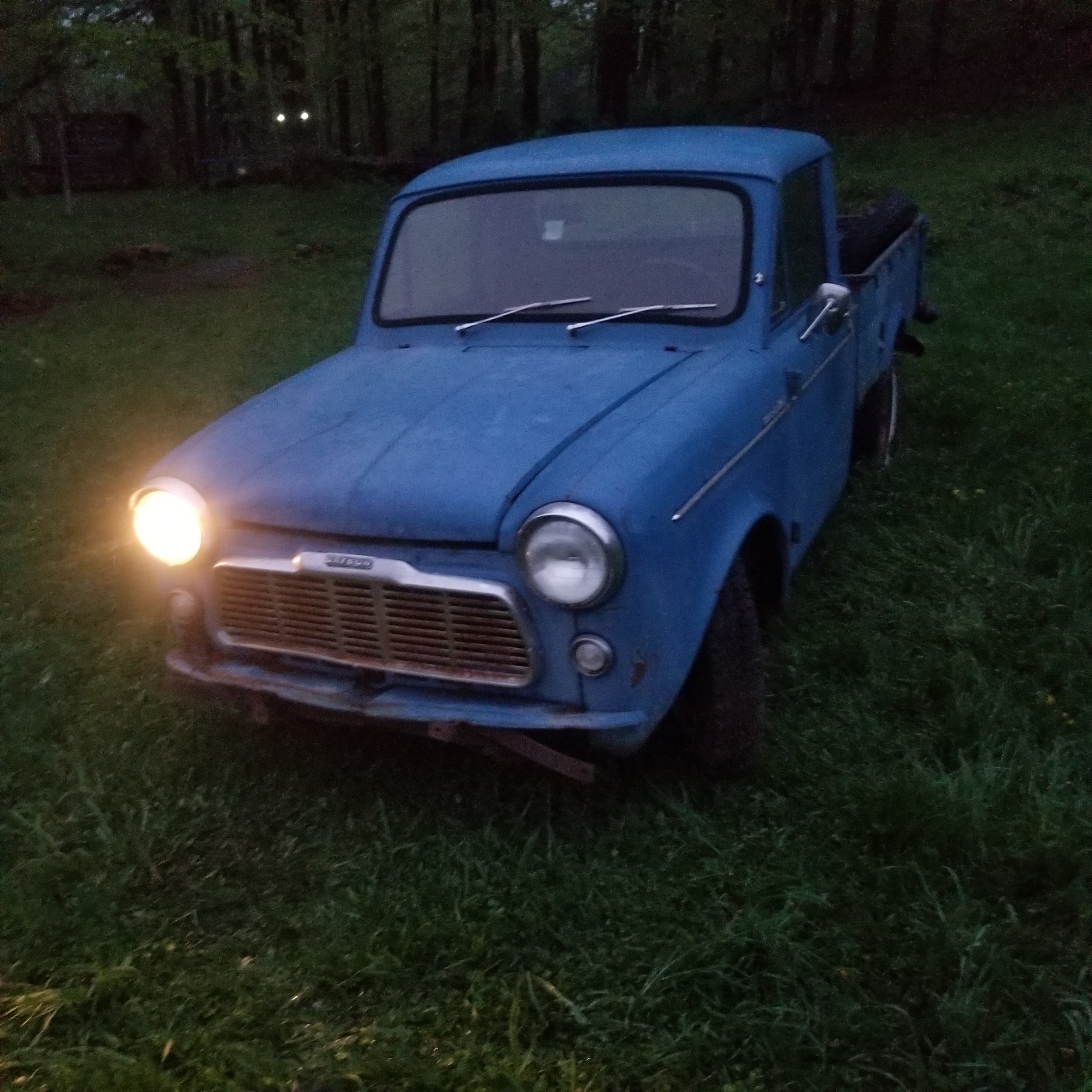

    So i dont know what i did, but somehow my marker lights and turn signals all work!?
    Flash really slow though. REALLY SLOW. I have LEDs in the tail. Normally the opposite happens.

    What you did was put forth some effort on the poor little truck, something it hasn't seen for years, and then you entered it into a car show!
    You have it excited now, its trying hard to help you out and its starting to fix itself, as best it can. :D
    The LED taillights probably solved a bad ground the old taillights had. Adding an LED flasher may bring the turn signals back up to speed. I had to add the LED flasher to my 49 Dodge for them to work correctly.

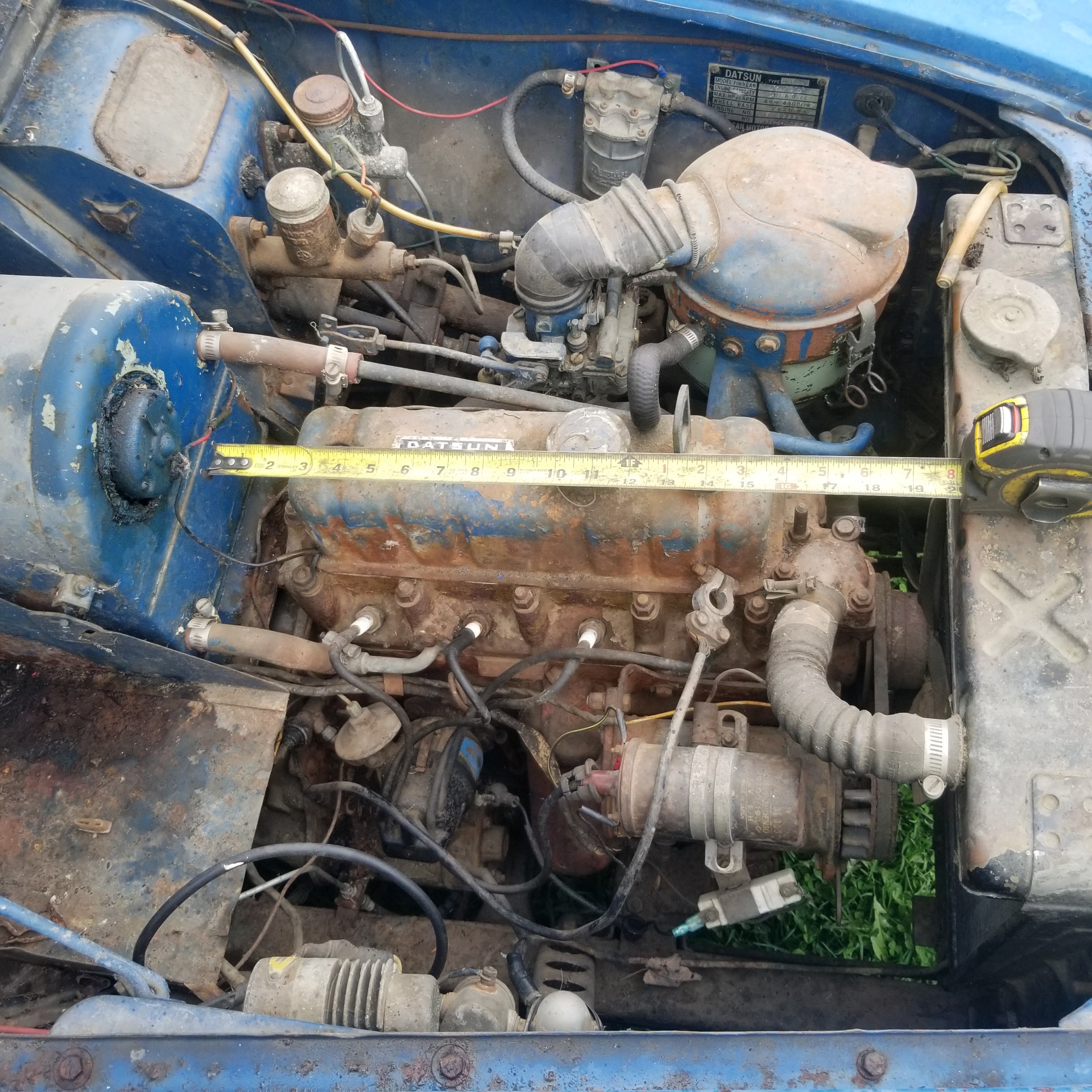

    1960 Datsun truck compared to an early Mazda Miata.
    -Miata weighs in at just under 2200lbs. Datsun weighs just under 2100lbs.
    -1991 miata engine rated at 116hp. 1960 Datsun 1200 rated at 48hp.
    - miata 1.6 engine length 18.9". Datsun 1200 length virtually the same.
    All specs accept for the Datsun length according to that there internet.

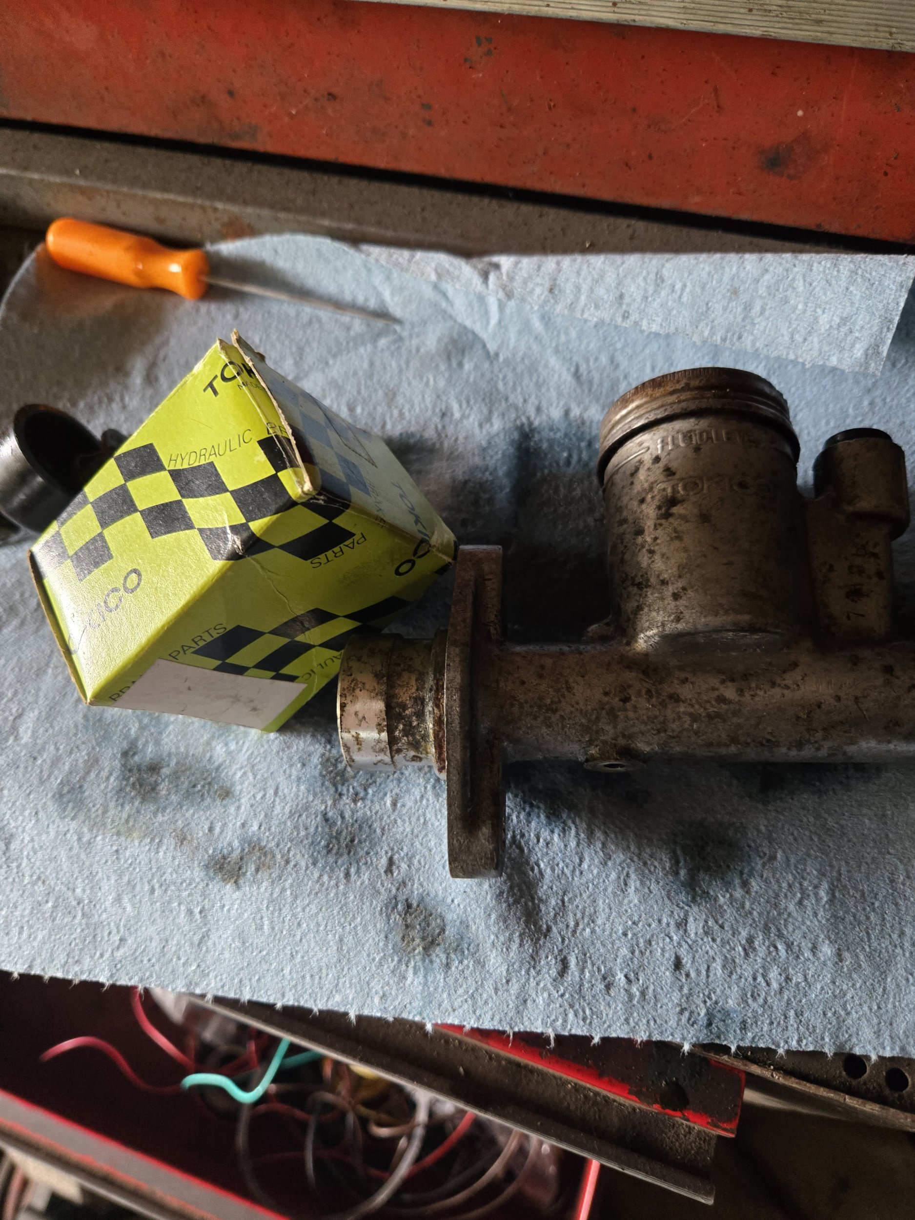

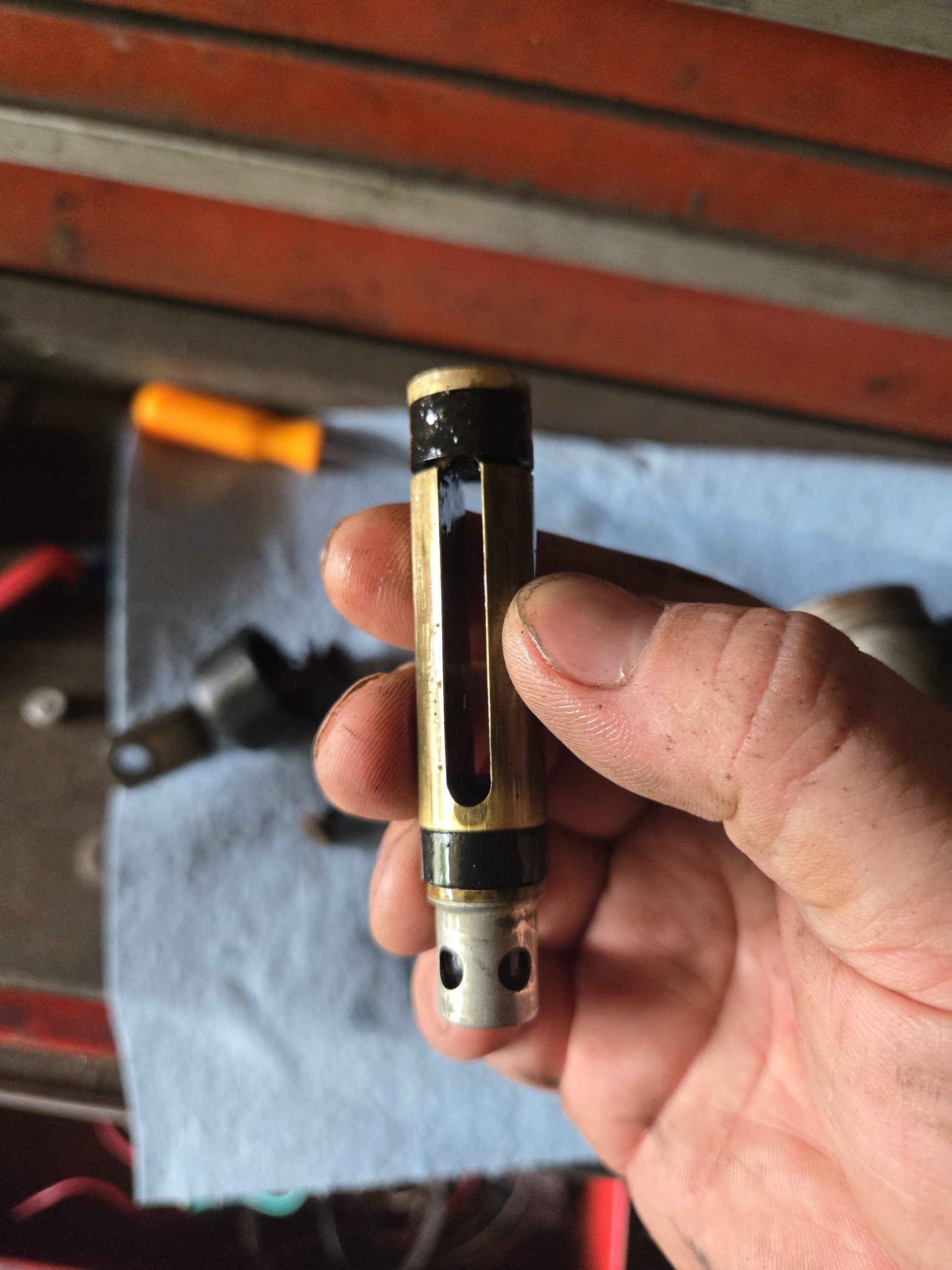

    Clutch master keeps going dry, found it leaking down the firewall inside.
    I took another gamble on buying parts. Got lucky again. Rebuild kit for a Datsun 510 exact fit!

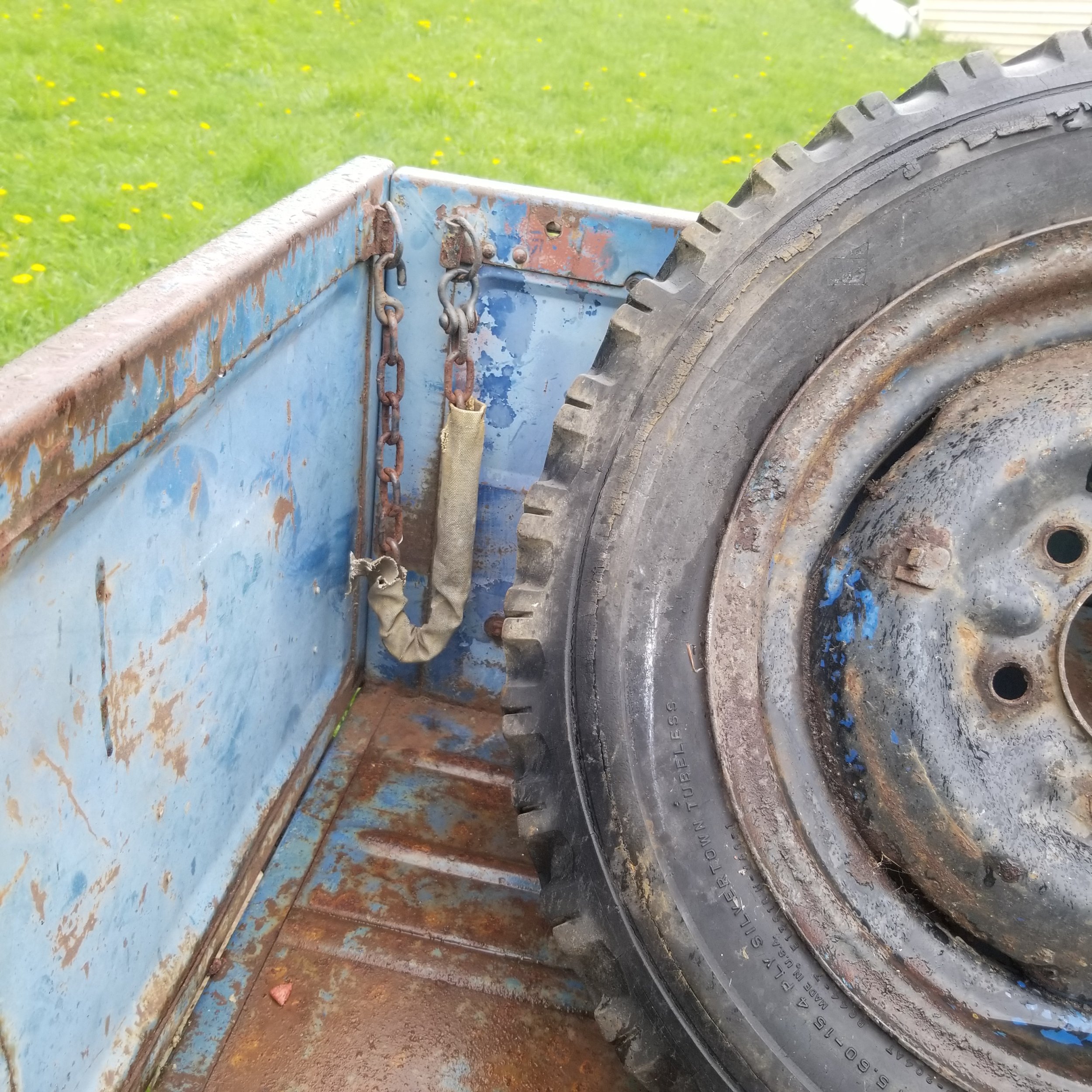

    Anyone know what this aluminum piece was for?
  15. SS327
    Joined: Sep 11, 2017
    Posts: 4,216
    SS327
    Tie down spot.

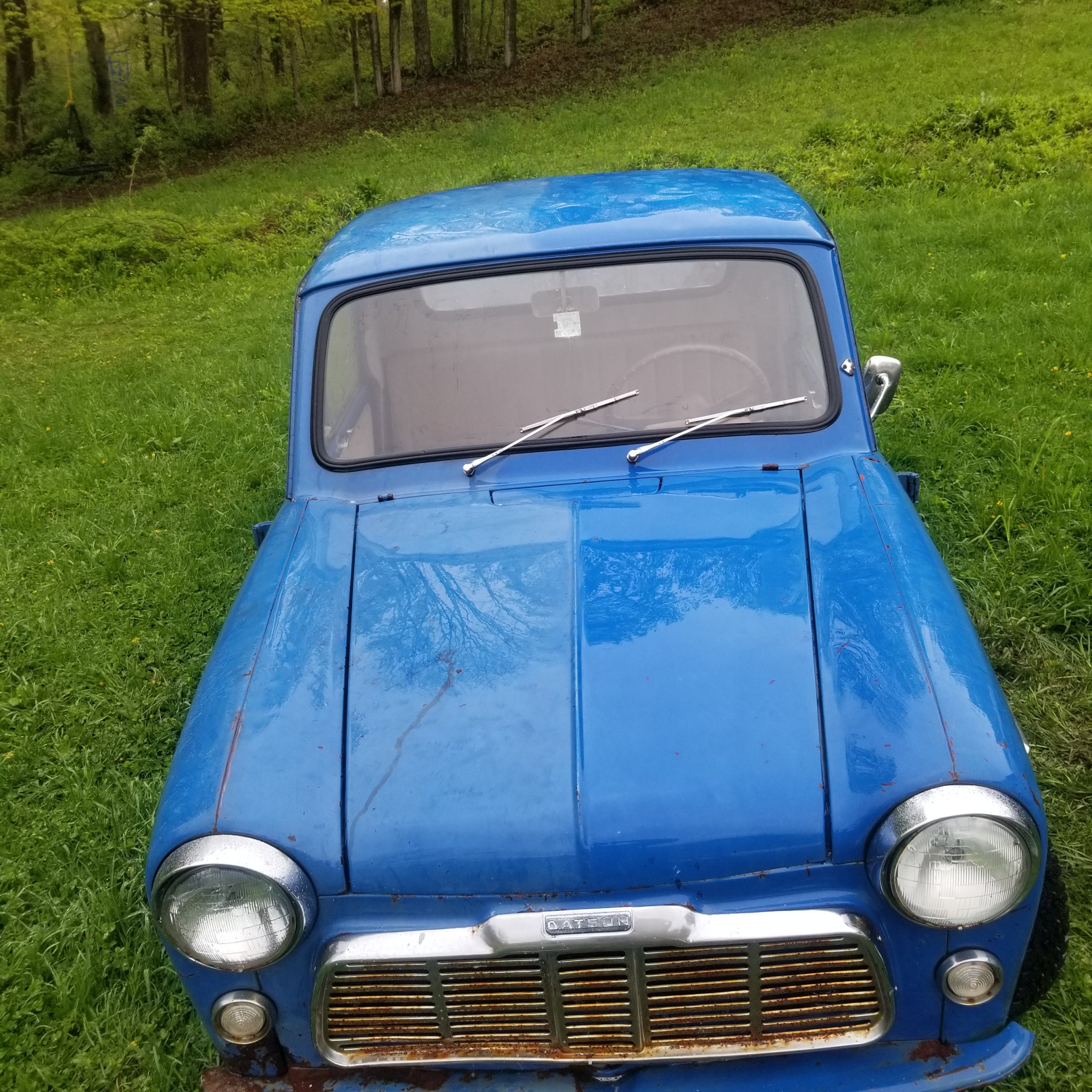

    Put a few hours in trying to get rid of this chalky paint. Went with the ol' rubbing compound by hand. so I wouldn't go through what is left of the paint. It now has a nice satin sheen to it.
    I ended up finishing with a coat of good ol' turtle wax right as it got too dark to really see what I was doing. Arms are dead now. Haha
    Hopefully when I go out tomorrow everything will be lookin good

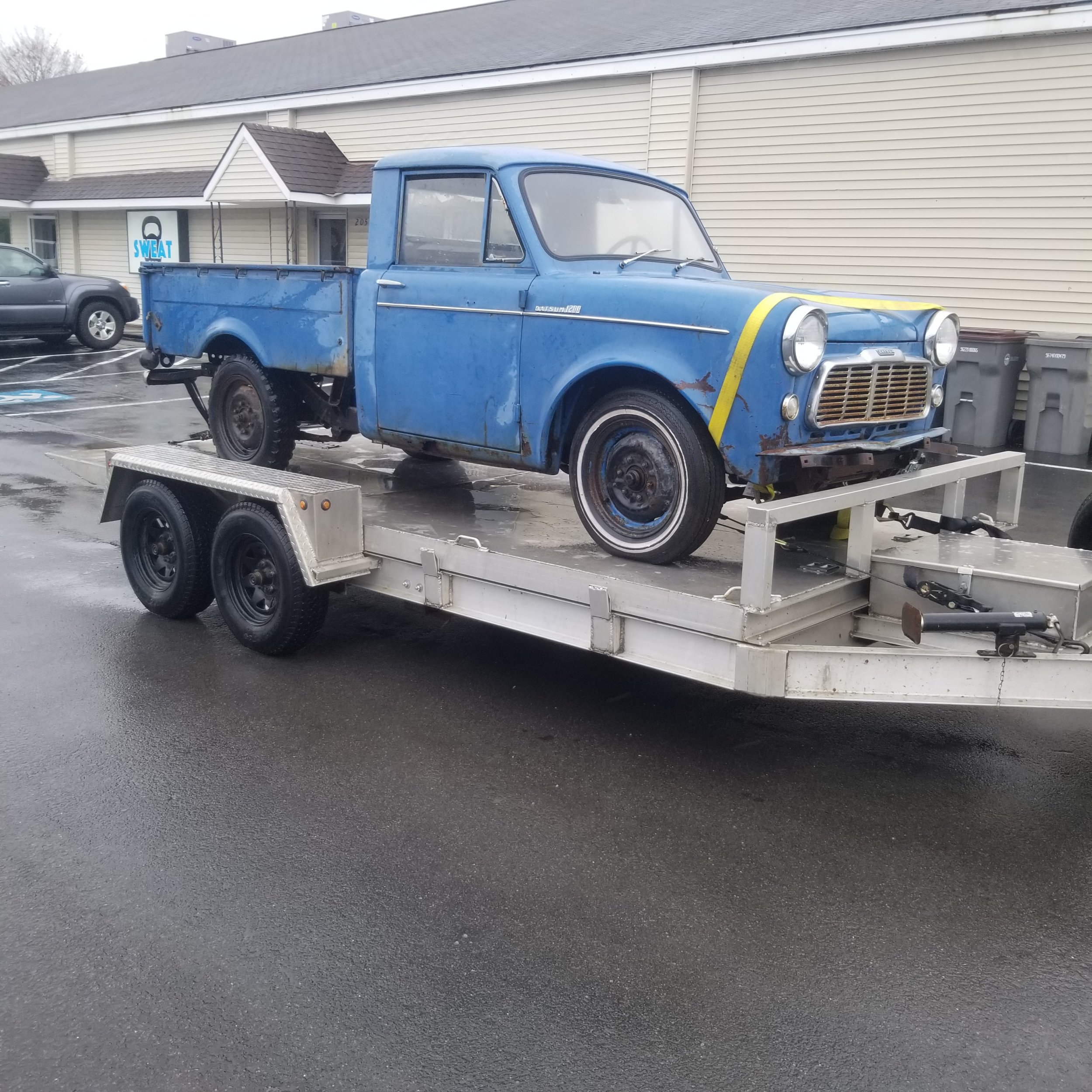

    Trailering to the local car show, 4 miles down the highway. Only because I haven't won my battle with the DMV yet.
    Looks WAY better than it did!
