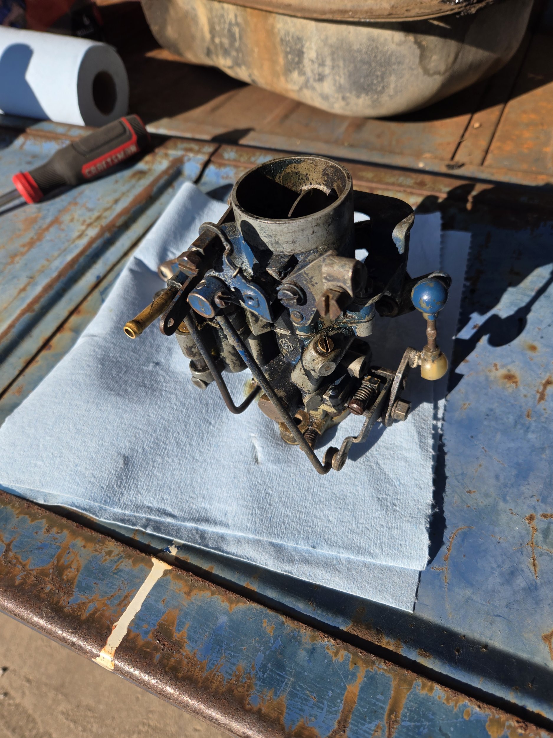

    The truck hasn't ran in over a month. I drove it into the garage after the local car show. The next time I went to start it it would just crank.
    I knew what the problem was, I was just dreading taking it back off and opening it up again..
    The accelerator pump p***ages were all clogged with crud again. This was all from not having the tank flushed good enough. Its been running off a boat tank, but there must've been **** in the lines still.

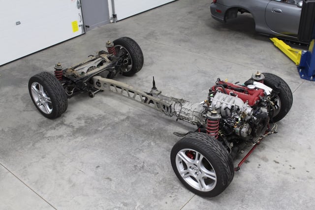

    Now that it's running again I did some side by side comparisons
    20250908_175945.jpg 20250908_175930.jpg 20250908_180247.jpg 20250908_180056.jpg
    2 blatantly obvious things.
    1. Truck is 10" longer wheelbase
    2. Miata is 7" wider with those tires
    leon bee, porkshop and squirrel like this.

    did you add an inline fuel filter before the carb?

    I have an inline filter and a sediment bowl with a filter. The rust was so fine it went through both... then turned to clay

    Maybe add a strong magnet to the filter?

    Im not doing a body swap. The plan is to mount/ graft the 2 subframes to the existing truck frame.
    This is all I'm keeping from the car.
    I really don't not want to do any body work to the truck, I think it looks perfect the way it is. If I was planning a full repaint it really wouldn't take much to wide body the front fenders and widen the pickup box. I dont think it would look all that bad if I did honestly.

    What kind of fuel filter did you use?
    Fuel injection filter will have a finer media to collect smaller particulates. I've gotten the 'clay' gunk in a freshly built carb.
    I now stick a filter in between the fuel line and fuel pump in the engine bay. 90s GM TBI/TPI filter(Fram G3727). It has threaded ends (16mm x 1.5), which allows a bit more versatility. So many 90's GM trucks used it, the hard lines and filter holder are ripe for the harvesting at your local yarde.

    Im just using cheap a inline plastic filter at the moment. Great tip on the efi filter!

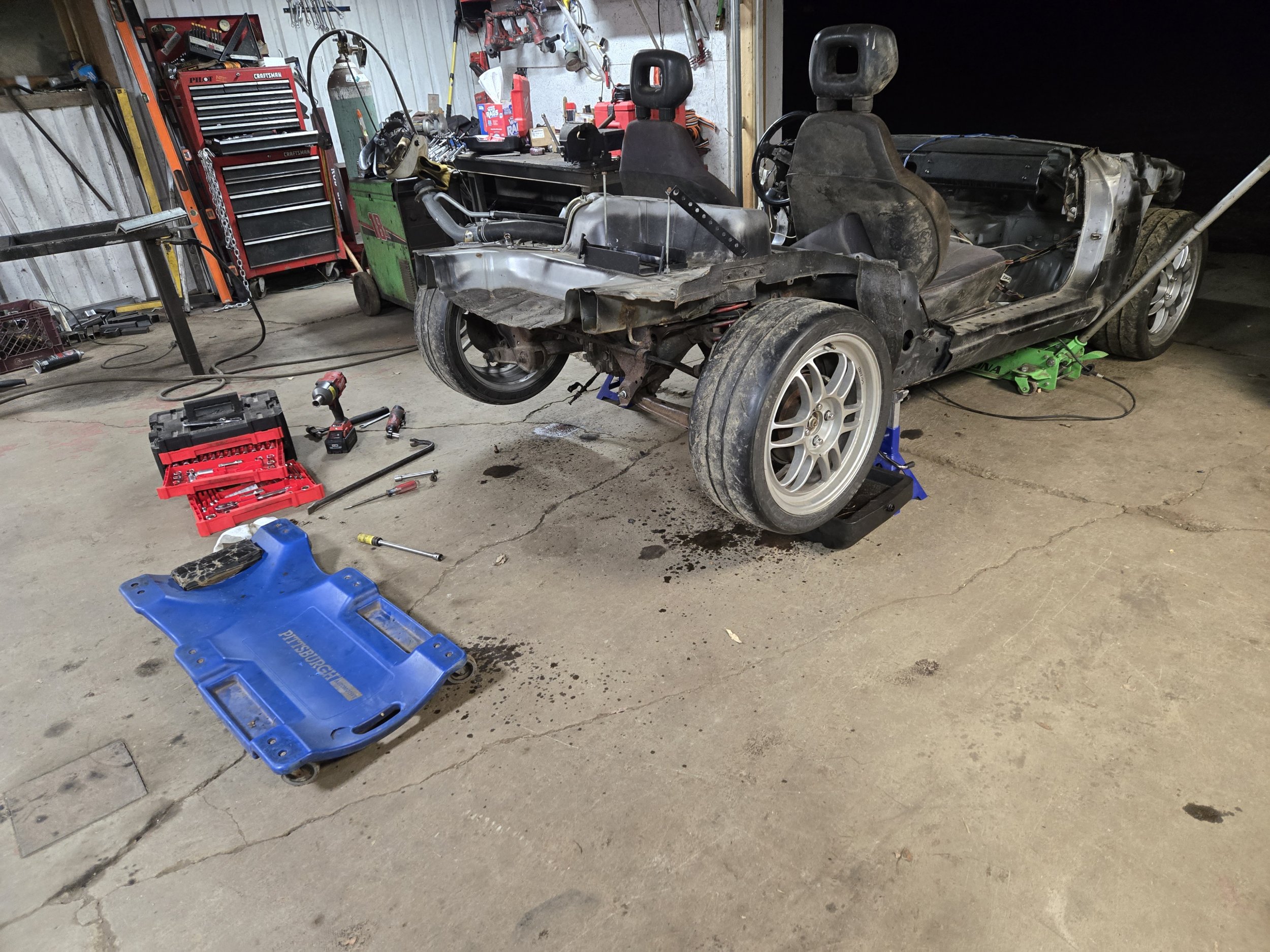

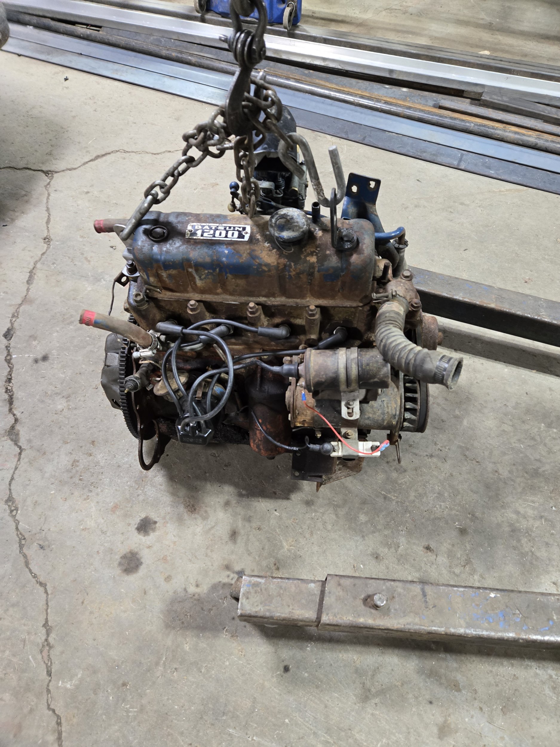

    Hoping to pull the engine over the next couple of days, I have the majority unhooked.
    Box came off very easy. Hoping to make big progress over this coming weekend.
