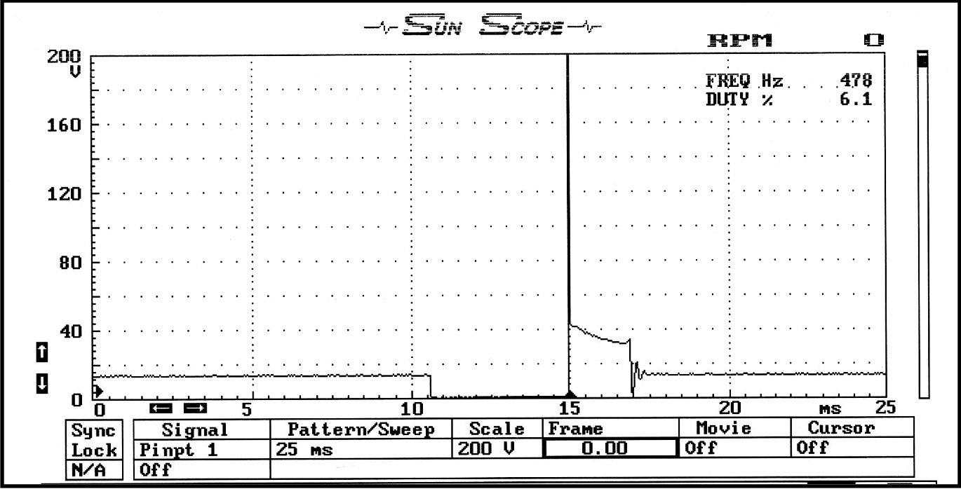

    Just for fun some time, connect an oscilloscope to the primary side of the ignition coil, and see what happens. You'll see a voltage spike of around 200 volts when the points open.
    I'd sure love to see a picture of that mysterious "AC" light bulb in the Rotunda tach, but so far no luck...he's keeping it secret. Is it a neon bulb? or what?
    here's one I saw several years ago on a point ignition system...notice it does dip below 0V, and oscillates
    41 GMC K-18, G-son and 57 Fargo like this.

    The secondary side of the coil gets over 10,000 volts. This is just the primary side!
    It's the magic of a coil and a condenser, and a pulse of electricity.
