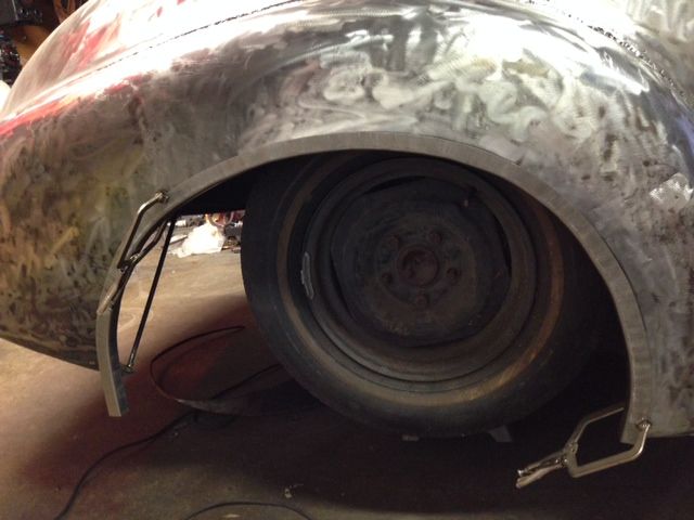

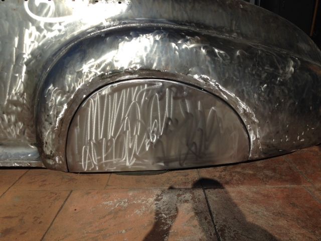

    Well moving on back. Time to change the rear wheel wells and make some flush mounted skirts. I first made a cardboard templet and held it up to check if I liked the shape.
    I cut it out and made a new lip that I would weld onto the fender. I also cut out the wooden bucks that I would used to hammer out the shape of the skirts.
    A lot of time on the shrinker and stretcher but I got them into place
    A little more work on the skirts and they will be done. Cut, weld, repeat.
    I'm going to bubble them out a little more towards the bottom but all in all I am happy. These are my third set of skirts I have ever made and I think they turned out the best to date.

    When making the overall shape of the skirts, was it just from your eye, to get a particular look or was there a particular size you followed? can you post pics of the backside / edge of the skirt? I am about to start this process and yours look good.
  9. DirtyNapkin
    Joined: Jun 17, 2012
    Posts: 374
    DirtyNapkin
    from Napa, Ca
    Voh, well mainly my eye. I kept the stock shape in the front. Then I played with how I wanted it to look towards the back. There was a factory brace on the fender in the back. So I also kept my new wheel well before that. I didn't want to loose the factory fender shape.
    I'll have to take them off this week to take a picture of the back side. I used 1/4" rod that slides through holes on the fender to hold the top in place. And I used 1/4" bolts on each on the bottom to hold them on.
    I hope that helped out a little. And thank you for your comment.
