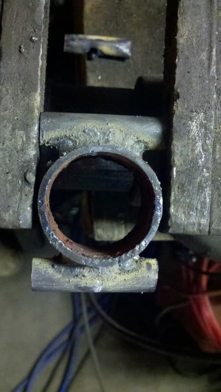

    I cut the steering shaft on the box and fabbed up a simple column drop out of a piece of 1.5"ID roll bar tubing and some 3/8" tube for the bolts, as well as some bent tubing for the drop.[​IMG]

  16. That steering box "mount" has got to be the most unsafe thing i think i've ever seen..
  17. Vintage Vandal
    Joined: Oct 3, 2007
    Posts: 720
    Vintage Vandal
    Safety is over rated!

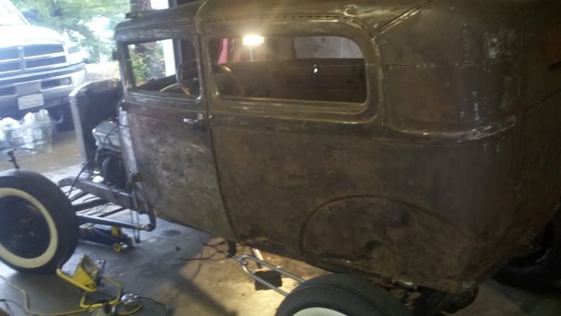

    I have been slaving away every night on the car... but nothing that photographs very well. I got the motor fired, a stout th400 built, a drive line made, both front and rear axles mounted. I had to pie cut the front bones in order to bring them up to the frame brackets and retain correct caster angle.Everything is coming together nicely and just about ready for a final dis***embly.
  26. Vintage Vandal
    Joined: Oct 3, 2007
    Posts: 720
    Vintage Vandal
    Here is a couple pics taken in my disaster of a garage before I start tearing it down. Building a car sure makes a fuggin mess![​IMG][​IMG]

  29. I'm certainly not upset. I bought up about a grands worth of rare parts from you guys and had them brought over here a few weeks ago. **** on that :D
    Yes but the exception is Travis Pastrana isn't going to kill anyone but himself jumping out of a plane without a paracute. This kind of at***ude is frankly ****ing arrogant and stupid.
    As is this..
    You need to remake that steering box mount because that **** looks like it'll break in no time at all, then you'll be cruising down the other side of the road and soon enough you'll kill someone.
    This is what our rules require we run over here for a steering box mount. I've used a '40 box on my Roadster and by the rules, we are required to run a plate that is minimum 12mm thick. I have only tacked it in these pictures, but it illustrates what you should have something similar to.
  30. 29sportcoupe
    Joined: Jan 14, 2008
    Posts: 350
    29sportcoupe
    from arizona
    You have rules that dictate how thick a steering mount has to be? Ohh thank god I live in the good ol USA! No rules, just the occasional guy drifting into on coming traffic.
