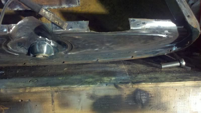

    I filled in the original steering column hole and braced the lower firewall with upper and lower square tubing, as it takes the force from my brake pedal. I also filled in a piece in my dash that someone had cut out along the way.[​IMG][​IMG]

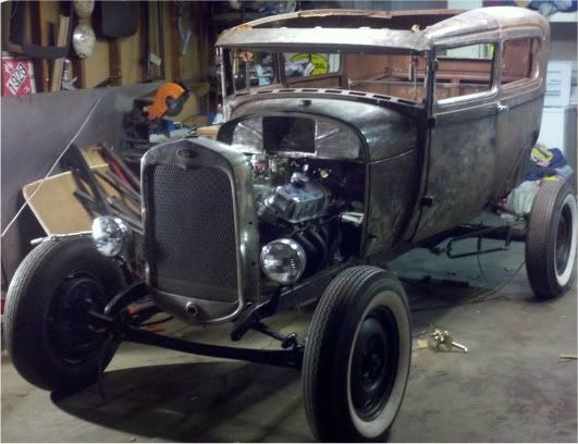

    Ok. Only six days til the autorama and ALOT to do.Ive been busy trying to get this car on the road everyday after work. Brake lines, ****** lines are all done. And Ive a spent a crazy amount of time putting a E-Z Wire harness in. I HATE wiring but it is all done now after much head scratching fuse poppin'! Here is an in progress shot of a 12 circuit wiring harness. Im sure glad I didnt buy the 21 circuit![​IMG]
  18. Vintage Vandal
    Joined: Oct 3, 2007
    Posts: 720
    Vintage Vandal
    Alright Guys,I haven't forgot about you HAMBers out there. But I have been hard at work trying to get this car mobile.And Mission accomplished! It's at the Sacramento Autorama at this moment. It is FAR from done but I drove it there without being on the side of the road which was good enough for me. Pics soon to come

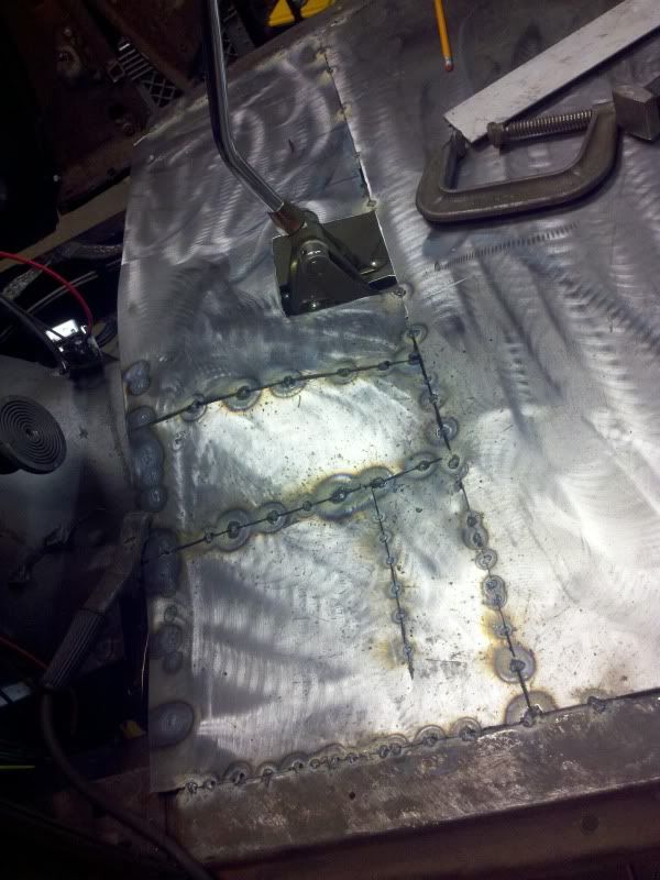

    I finally transferred the cardboard templates to sheet metal and started cutting. It took a while to get it to fit the contour of the transmission hump.[​IMG][/url][/IMG]

    Ok, it was time to take my first test drive in the sedan. 2 days before the Sacramento Autorama. I was extremely excited to go piss off my neighbors with that big block. I went to check the fluids one more time before my long awaited departure and.... My motor was filled with the chocolate milkshake of Water and oil.:eek: I dont think I have ever been so disappointed:mad:I ended up putting on A new intake, different heads, and new gaskets. No more water for now. Here is a pic of the car on a 3:00am gas stop on its first drive in many decades. This car is SO fun to drive and is scary fast.[​IMG]
