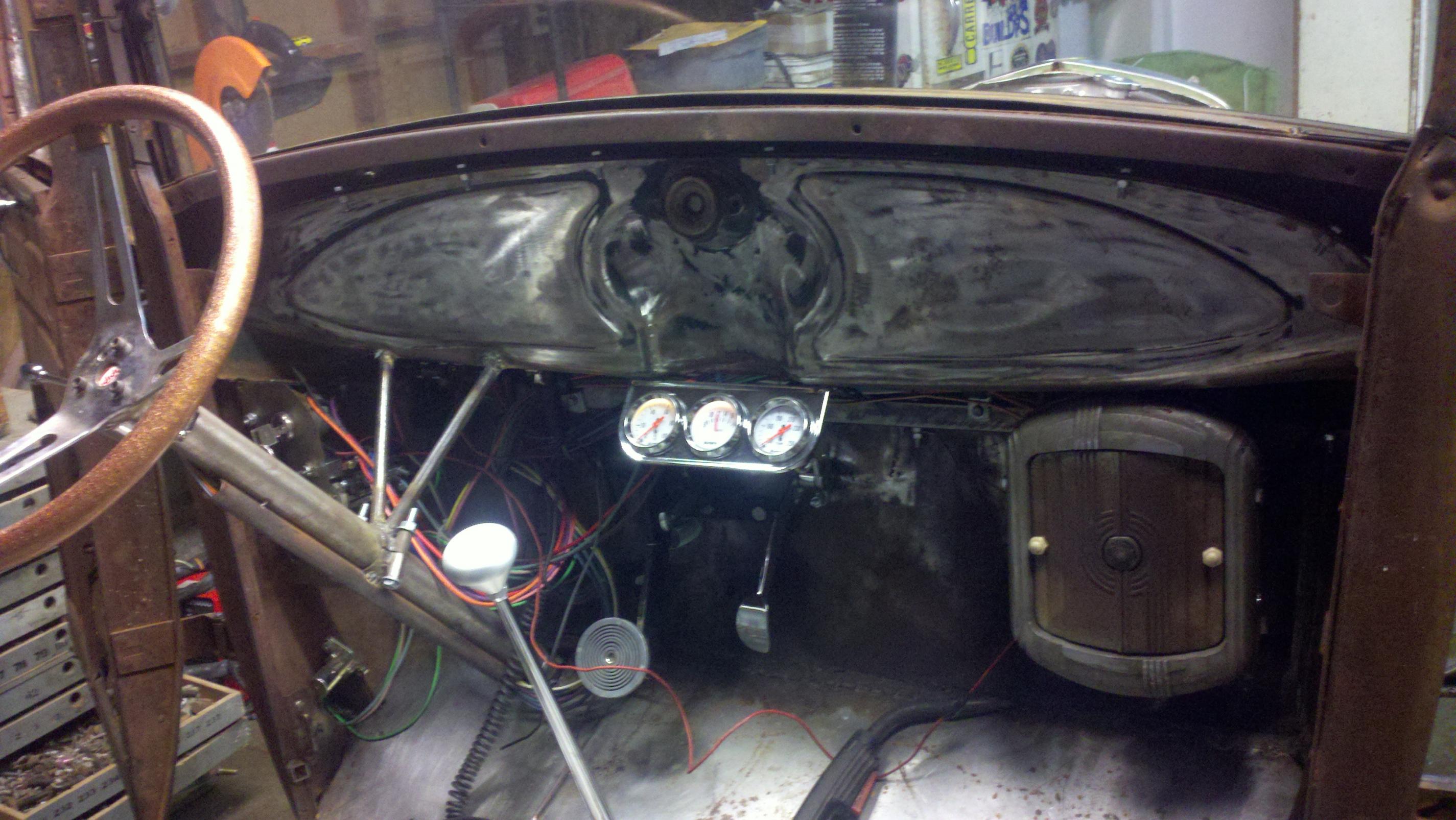

    Now on to my next pain in the ***:trying to get a 53 ford dash to fit my sedan. Never done a dash project before so wish me luck.[​IMG]
  29. Vintage Vandal
    Joined: Oct 3, 2007
    Posts: 720
    Vintage Vandal
    Marked for surgery [​IMG]
