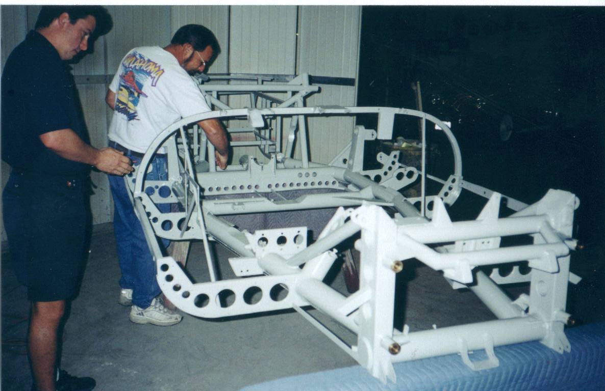

    Here is a tube frame that I think is made by last refuge hot rods. Not sure what material they use...
