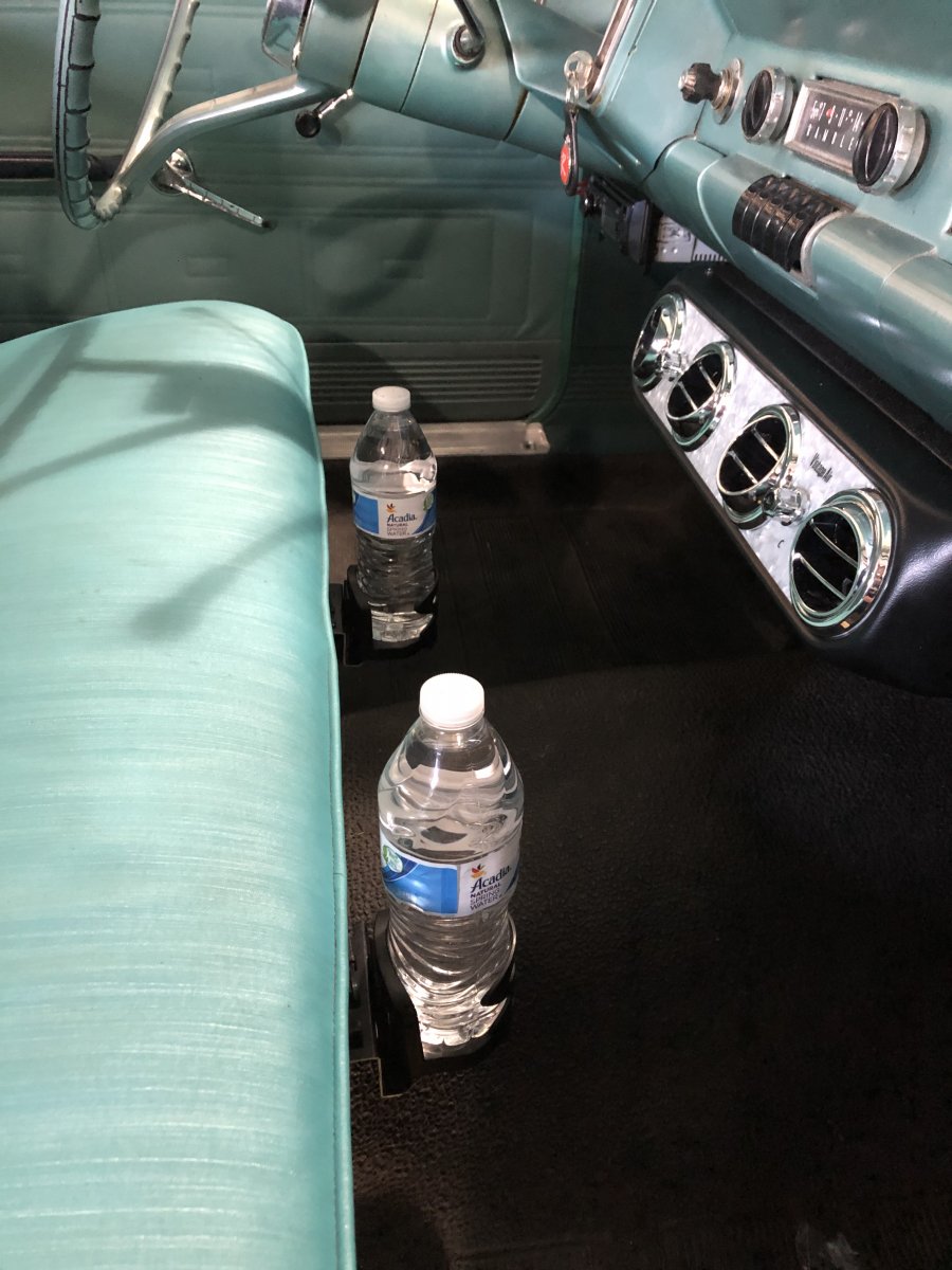

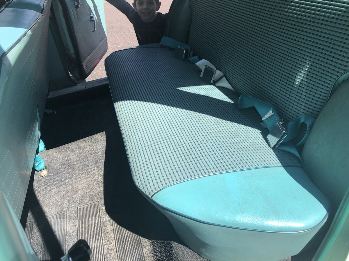

    Finished up the car tonight... installed the seatbelts and the all important cup holders. Neither came in a 63 Rambler. Haha I also put one white belt for whoever sits in the middle. Six separate lap belt ends would be the perfect storm for three angry kids to start fighting. Now there should be no confusion. Plus Amazon only had 4 turquoise belts... I had a white set from another project, so there you go. Just waiting on two side mirrors... they should be here on Friday. Down to the wire here. We are on schedule to hit the road Tuesday morning. Can’t wait!!! 40CC1AB6-240A-478F-BA78-71EFAF4CEC8B.jpeg 3A4E6FE3-73F7-4614-B685-2996DEE72177.jpeg 7EE2EC6D-5C8D-4321-8501-DBA02722679C.jpeg 794699D8-AE26-4A05-B08C-430092DC17F8.jpeg

    Where did you get the cup holders?

    They are just cheap plastic cup holders off Amazon... I made some brackets, painted them black, and screwed them into the metal seat frame with some self tappers. I had to make them move with the seats so they couldn’t get fastened to the floor or something. The Rambler has that front seat option, the seat moves all the way forward and folds down to make a bed. Not that I’m planning on using it... but I still wanted it to work. Unless something really goes wrong... haha

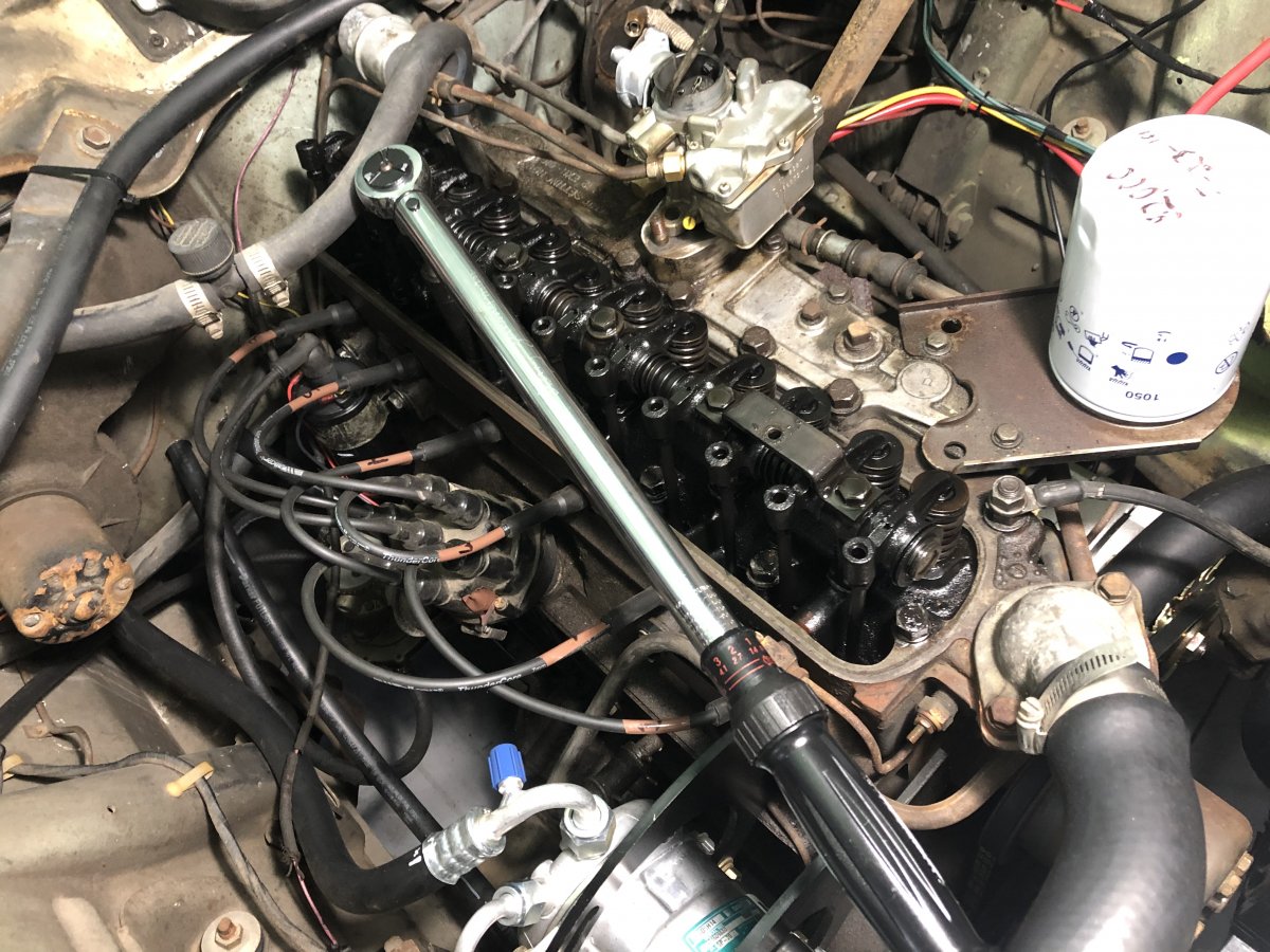

    44EE39F0-1CB8-49C7-B43E-A2E99E5787A0.jpeg Pulled the valve cover off tonight and put on a new gasket. I also took the advice of a few above and re-torqued the head bolts to make sure they were good. Tomorrow I’ll top off all the fluids and pull the front wheels to grease the wheel barings. Also, my two rear view mirrors should be here tomorrow. Thats should be it....

    Wonder what if.............you put lock tite on those head bolts ?! Would that work to help keep'em torqued down?
    Jus say'in

    I was lucky I guess... mine were tight. If I wouldn’t have checked them, they would have been loose. It’s cool though... I’ve been wanting to put the new gasket on anyway.
