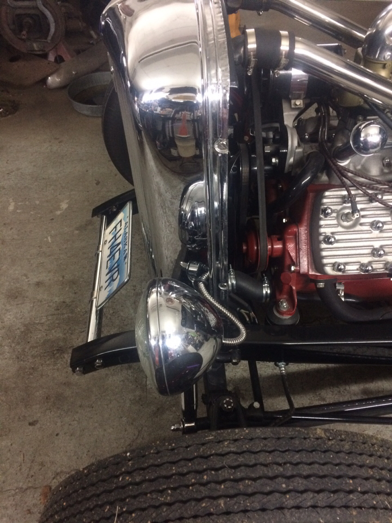

    [​IMG][​IMG][​IMG]
    Hard to see in DS photo, but same as p*** side, no rubbing issues.
