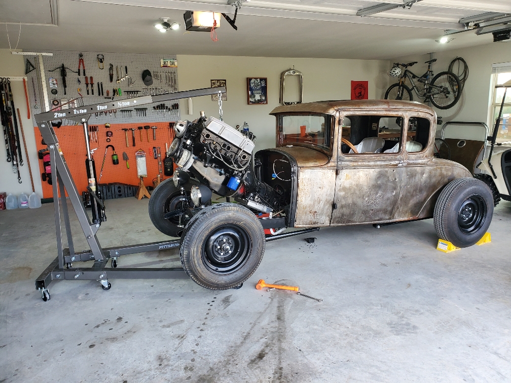

    Tim Helzer
    I pulled the engine and ******. The ****** was pretty much shot, so I will drop a new one in later. I tore the motor all the way down to inspect everything.
    There were a ton of issues with the body mounting and the channel, so the body has to come off also. [​IMG][​IMG]

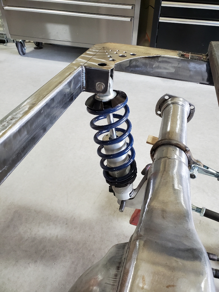

    Tim Helzer
    I got the rear axle mocked up with the Pete & Jakes ladder bar kit. I used a 34' kit to get the dropped crossmember. I had to have my machine shop cut me out some new axle brackets to fit the diameter of the 9" housing.
    I was then able to put together a rear crossmember/upper shock mount. I am pretty happy with how it came out.
    Now I just need to get a panhard bar done.[​IMG][​IMG][​IMG]
    Sent from my SM-G970U using Tapatalk

  20. 30tudor
    Joined: May 9, 2002
    Posts: 1,694
    30tudor
    Good stuff. How did you arrive at that rear shock angle?
  21. Tim Helzer
    Joined: Jan 14, 2021
    Posts: 17
    Tim Helzer
    It's just where they fit the best with the axle brackets that I already had, they were planned for a different set up but worked here also. I really didn't do any figuring...haha. I also wanted to keep everything mounted below frame height. If it drives weird when I am done it's easy to change.
    chryslerfan55 and 30tudor like this.

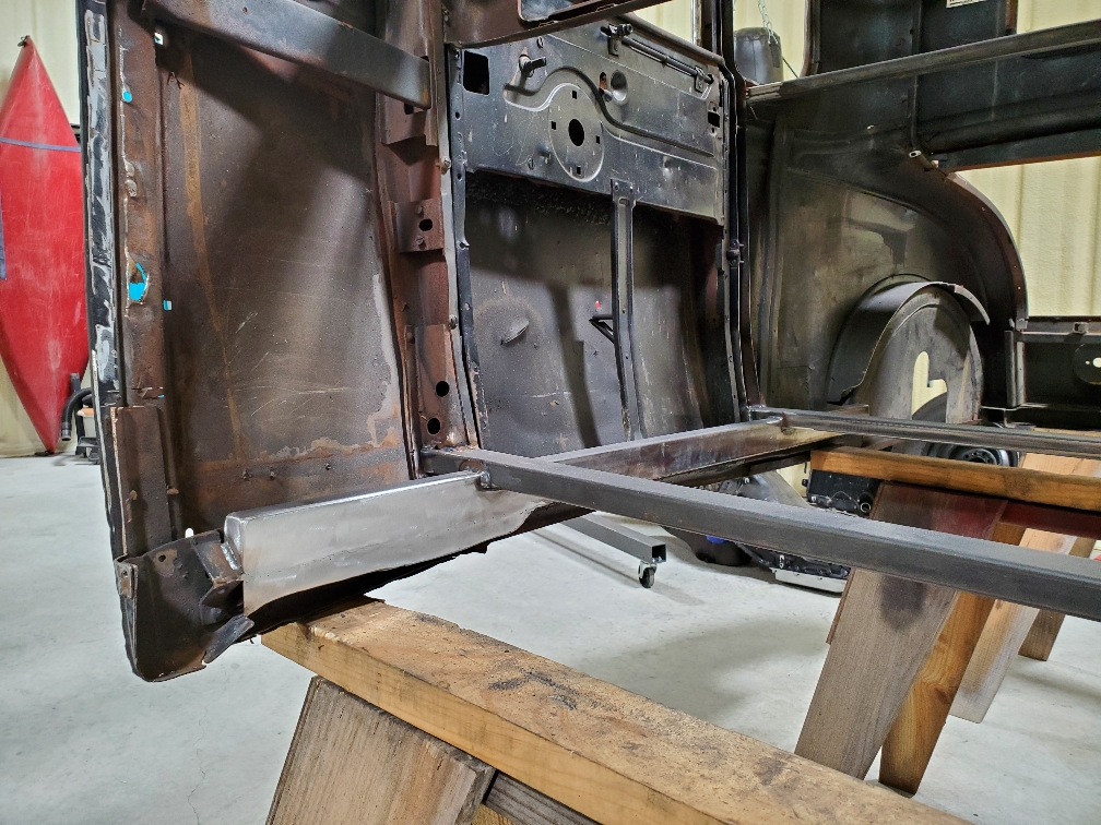

  25. Tim Helzer
    Posts: 17
    Tim Helzer
    I placed some 1 x 2 box vertically on top of where the floor was cut. I welded it to the cut section of the floor and the door sill. The floor dips in the front so I boxed it in with sheetmetal to appease my OCD even though it wont be seen once done. The crossbraces notch over the lateral supports and attach to the pillars to tie it all in. Once the engine is mocked up I will cut the center out and build a ****** tunnel. It's actually a pretty mild channel because I am 6'4" tall and I dont want to lose too much space.[​IMG][​IMG]
