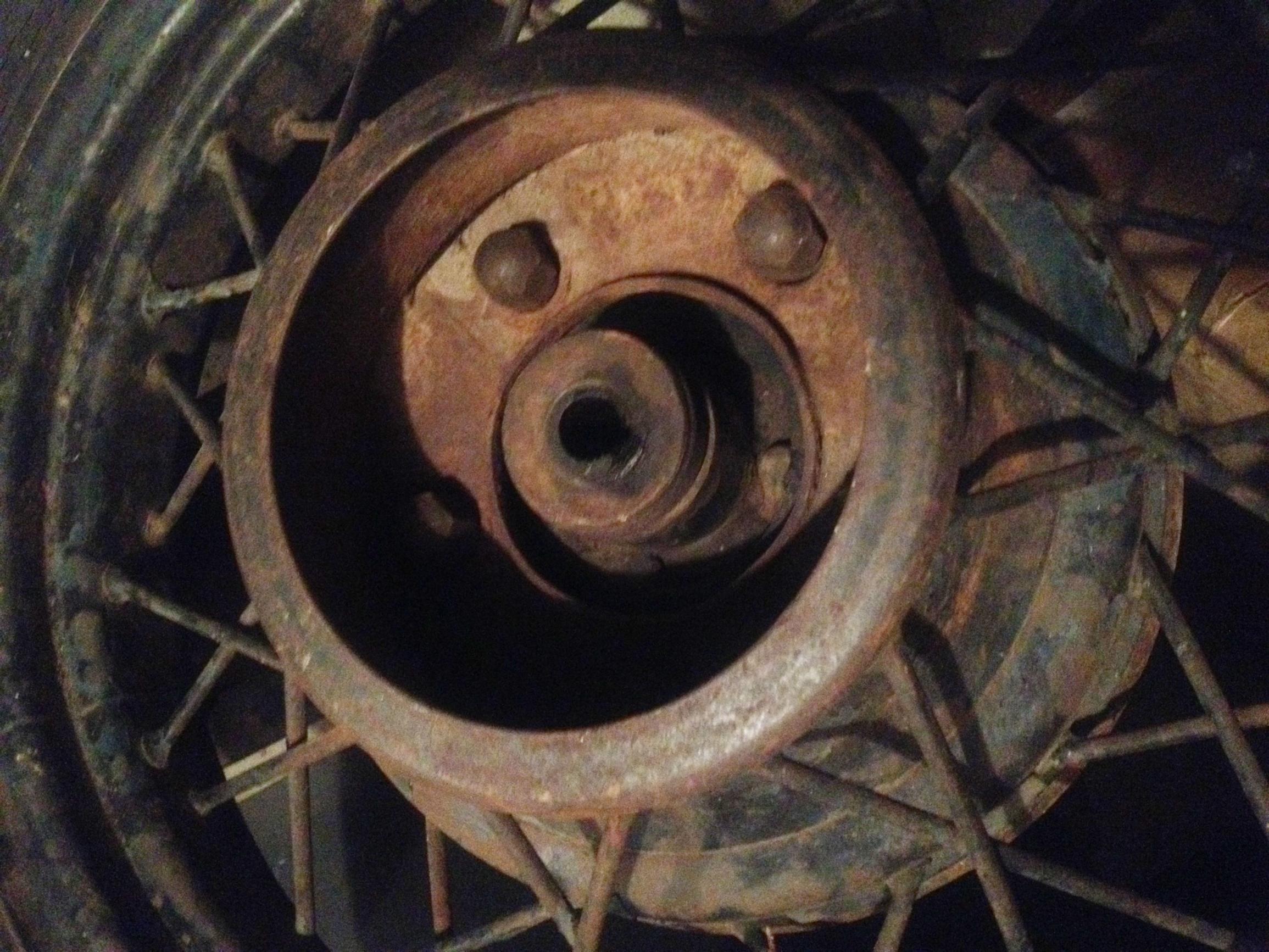

    These are the photos of the rear wheels that came off the Aldrich car when I picked it up at Bakersfield. The tire size is 525-550x17. I think they are the same same tires that are in the above photo. Notice that the Model T wood wheel hubs have been welded and redrilled to fit these wire wheels.

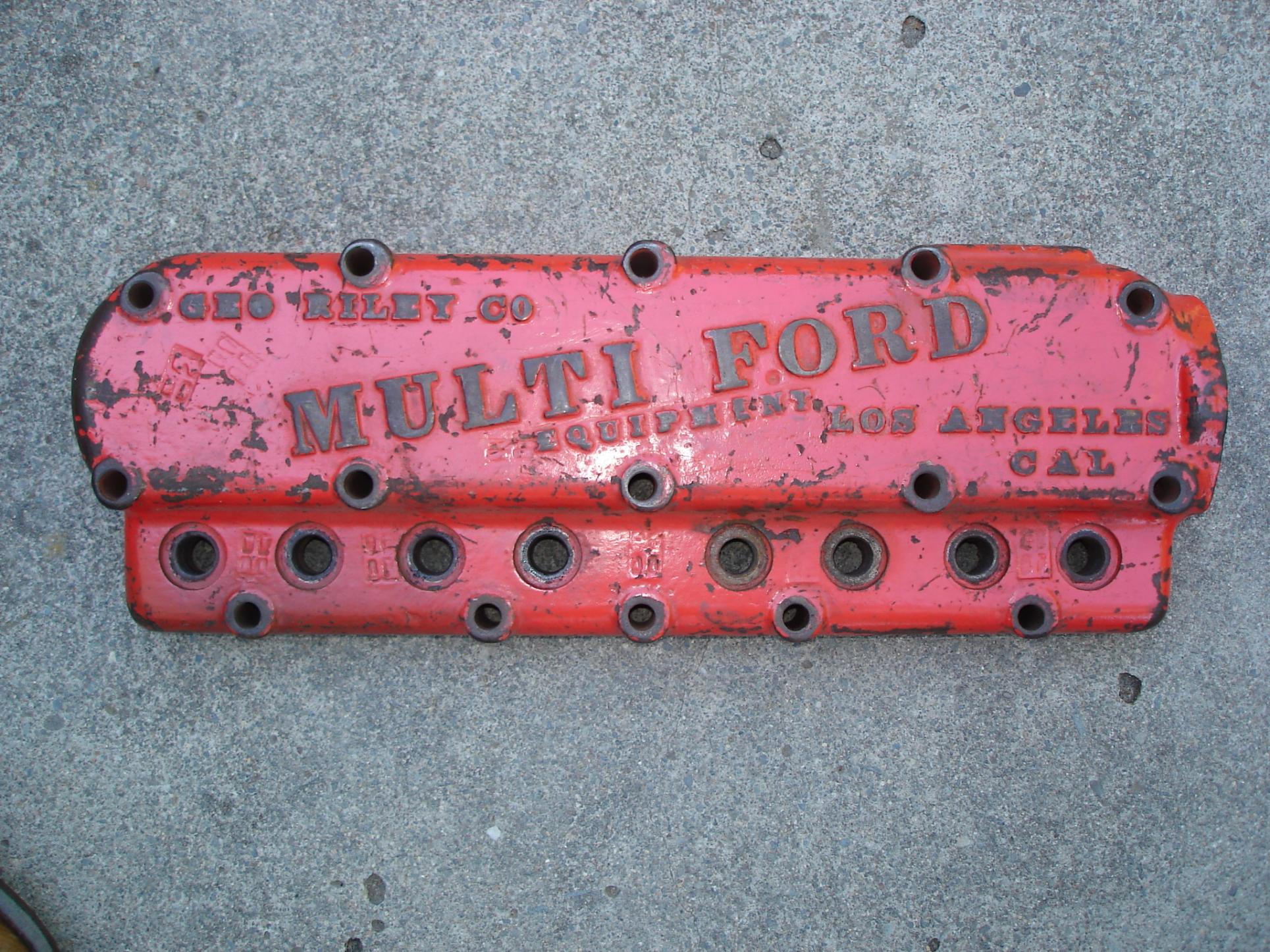

    George Riley made special dual ignition T flatheads for his Multi Lifts.

    Just read this thing, and I was wondering if you noticed the balanced volume changes in the head.
    I think it was done for that purpose, as no one going to sink the valve seats, install the big valves, and then mill so many different combustion chambers.
    I think it must have been to equalize compression ratios in the cylinders.
