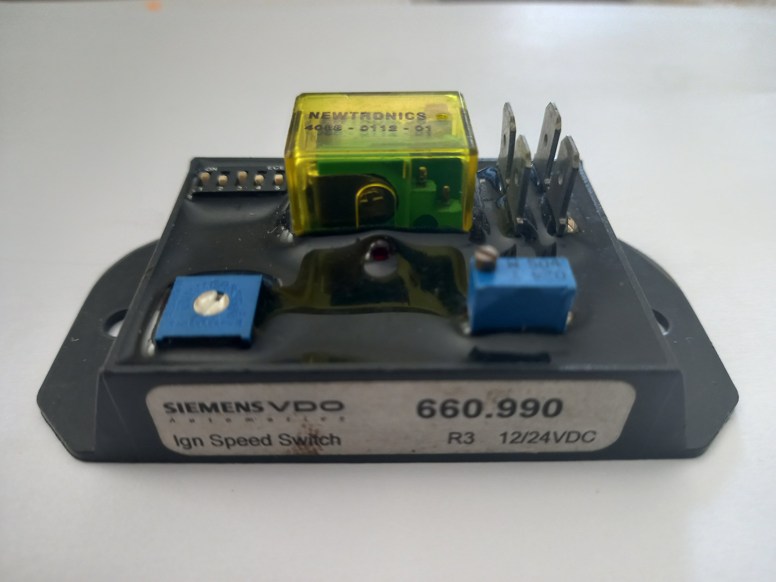

    Here is the little magic box I use.:) upload_2024-11-12_11-9-48.jpeg

    ^^Above^^ Seems like an rpm on/off switch by the operation/adjusting manual? I used MSD rpm switches to shift the auto trans I built for my pulling tractor, worked great.
