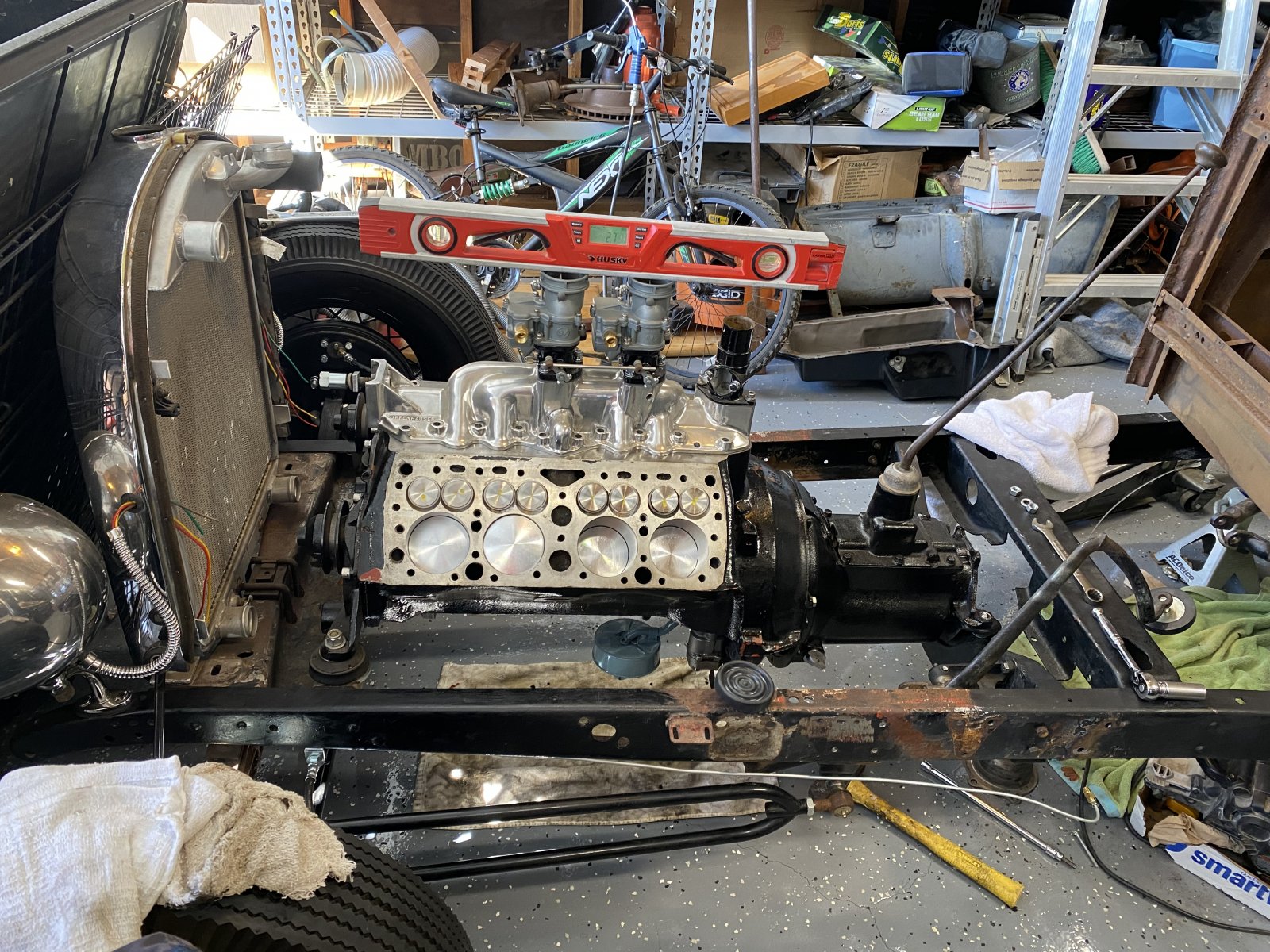

    Hi all,
    I’m finally getting my RPU project under control. I have a question about the engine angle. I’m currently at 2.7 degrees. From the motor to the pinion. Is this the proper way or should the engine be level and the torque tube be at an angle to the pinion. Any advise will help.
  2. alchemy
    Joined: Sep 27, 2002
    Posts: 22,777
    alchemy
    If you are using a closed torque tube you don’t need to worry about the angle. Most guys would mount the engine parallel to the frame rails. I would if I was building that car.

    With the carb off the manifold put a level on the manifold and set it level. That how I do it anyway

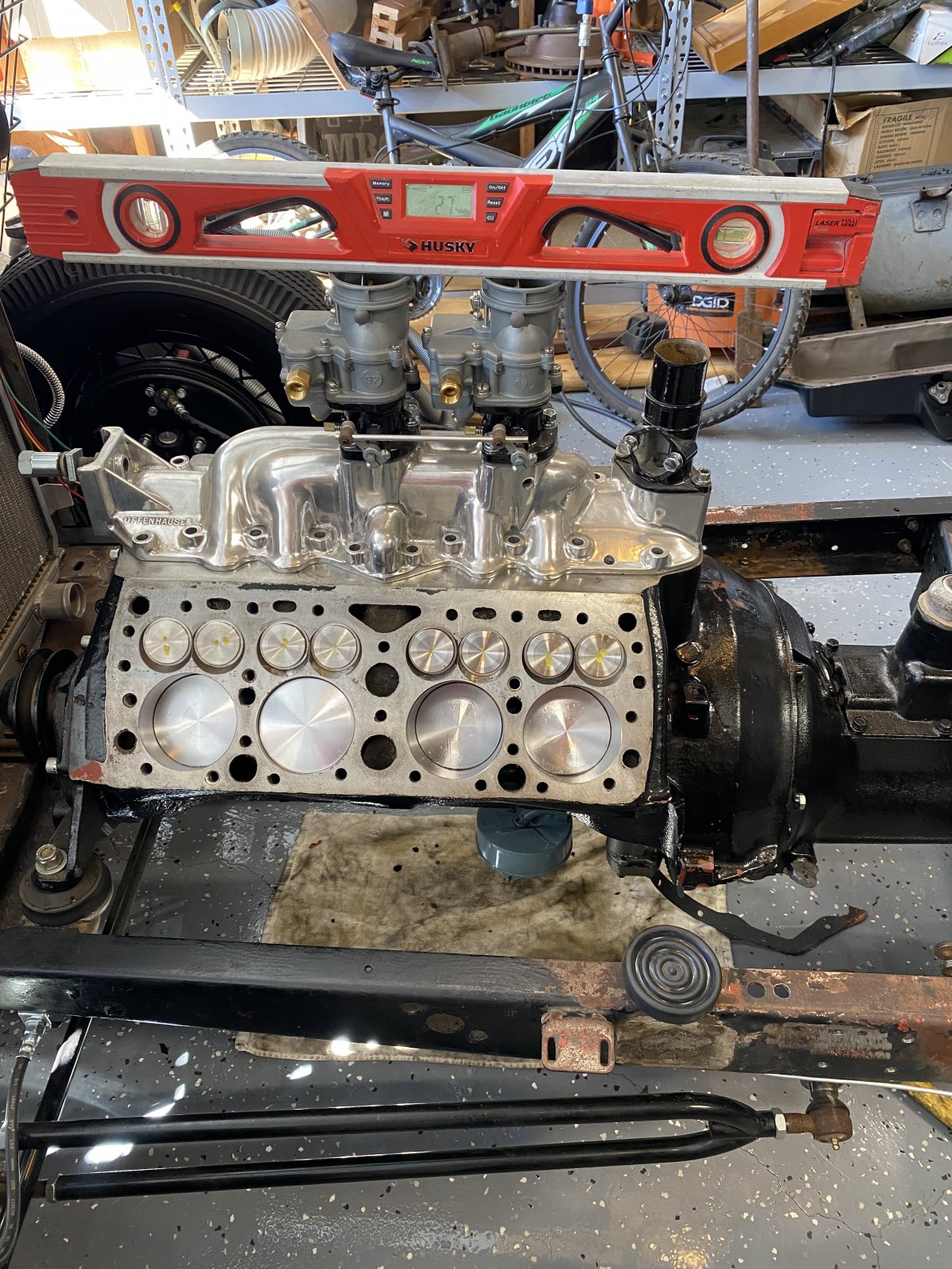

    Set the level on the block at the top edge where the head bolts on…. What’s it say now

    Still that same. 2.7 degrees

    What "Alchemy" said .^^^

    If your using torque tube , there is only one u joint so pinion angle is not a issue, with in reason

    IN REASON !!:D
