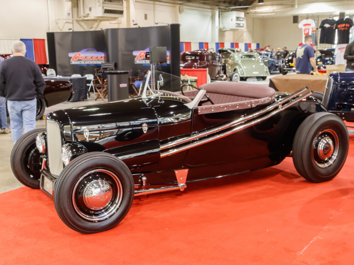

  6. think about an emergency brake handle for an old granny gear four speed......most have the slot on one side of the handle......open the slot up a little like a glass size width....you will need three......the bottom of the handle usually as a two hole flange that bolts to the trannie....this would be what you would attach to the cowl for removal later if racing? it.........same car at the show and on the dry lakes.......the two glass pieces just slid down into the slots and the three arms could be removed..... the # 5 entry full pic.jpg on the lakes.jpg

    Make a V- windshield out of aluminum or stainless steel.
