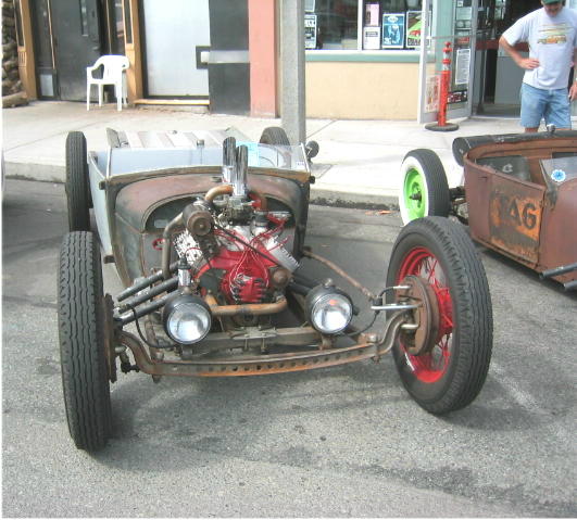

    I saw this one at CHRR last year. Could this be it? I only see one water pump.

    That's it. One pump, no plumbing leading away from the motor that I can see, somehow I'm not buying "Radiators' in the bed" anymore. Do you know if it was driven to CHRR? Was it driven to Bonneville? At Bonneville?

    Looks like the louvers in the bed cover face forward,which would suggest a rad in the bed.
    There was a very similar truck at Paso a couple years ago,with the rad in the back.
    But it had a 6 cyl.
    Any chance it's the same ride?

    Grim, I have seen this car a couple of times,last year at the hotel bash at night after hrr. Then again this last Saturday during the day at Fomosa.This car has the look. It is so low it would be like riding on a roller skate.The car does have a radiator in the bed, I talked to the owner says he dosen't drive the thing very far.I like the look, but I would have put some sort of chopped shell in front for looks.But you gotta hand it to the builder,it looks cool even if not to practical.--TV [​IMG]

    TV - I agree. The truck looks well thought out even if it is limited to short trips. Nothing there that makes me want to change how I'm building my current car but I always like filing this stuff away for possible use in future projects. Lot's of neat ideas there. You didn't happen to see how the radiator plumbing was routed did you? I still can't figure it out.

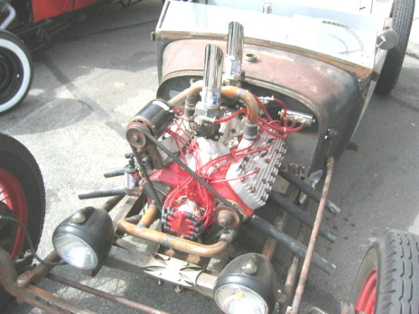

    Here are a few of the plumbing from last year.

  17. Now I see it. Both banks tied together and one line leading back to the Rad. One line forward, simple and probably doable. Perhaps an electric pump back by the radiator wouldn't hurt a thing, and the obvious eletric fan.
    At least now I know what the thing I saw in between the lights is.
    Thanks for the info,
    The PknBner [​IMG]
    BTW I've seen a bunch with thw rad in the bed or even the turtledeck over the years, with a little planning they can be more than drivable.

    Well guys, what he did was,tie the heads togeather and stub off of that to the rad.in the back.Then he used one pump on the drivers side, blocked off pasg side, but stubbed a pipe out of it and tied into the pump pipe and went back to the other side of the radiator.I don't know how it works cause the block doeen't tie togeather from side to side in stock configuration.Who knows whats going on inside???--TV [​IMG]

    The plumbing makes sense now. I still don't understand why there's only one pump, but the rest makes sense. Thanks for the pictures.

    If he were to run an electric pump, wouldn't he still need that one mechanical pump to use as an idler pulley to have the generator belt go around (for clearance) the front mount dizzy???
  21. How the hell does that werk, don't you need a return line ? Or am I missing something.

    I think that the return line is the one headed down toward the frame behind the left headlight....

    I'm still missing something here.
    I only see one line running to the back.

    OK,just found it.[​IMG]

    The head pipes come down by the header, and the pump runs through the channel of the frame,you just can't see it. This systom must have an electric in bed, or the pasg side won't cool, I guess????--TV [​IMG]

    Kilroy, I love your thoughts,FORM OR FUNCTION which is it? And the sun will still come up anyway.---TV [​IMG] Did anyone notice the belt riding on the cross over pipe?
