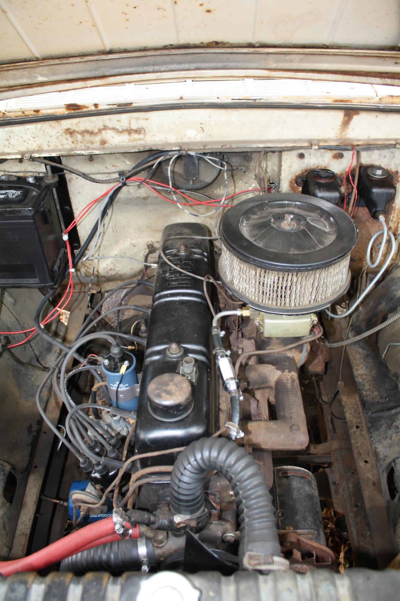

    There is a fellow on the 57-60 F100 facebook page who is having both the clutch and brake lines made in small batches. Look him up or pm me for info. I made my own but hate them and will get a set from him at some point.
    Rob68
    Hard to see but there it is.
