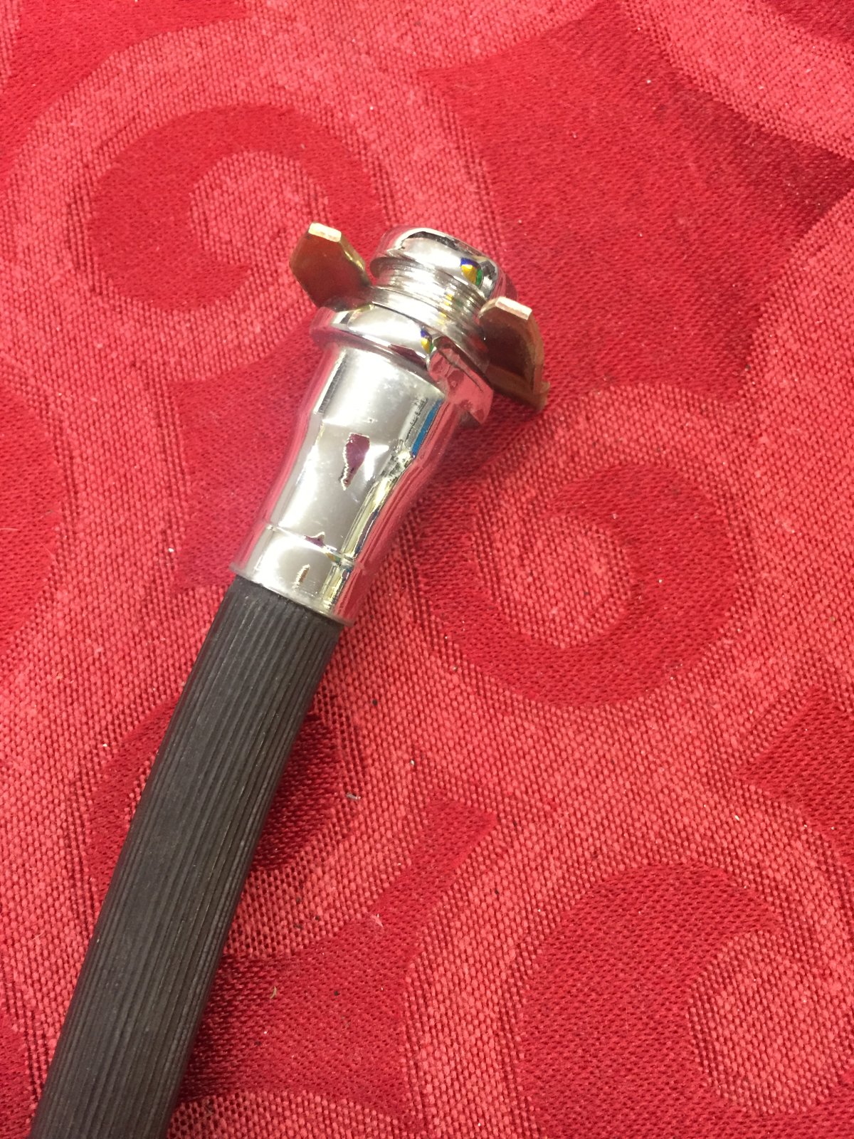

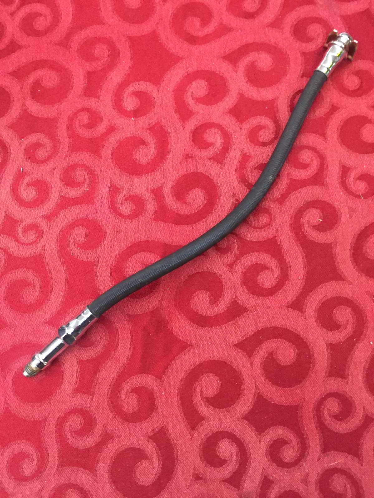

    I have had brake hoses chromed before, the chrome does not hurt the rubber.... 837BB540-F3CD-434A-B7D5-7E94E430AADF.jpeg E8646699-25B6-4B45-969A-A8D0C8D212E0.jpeg

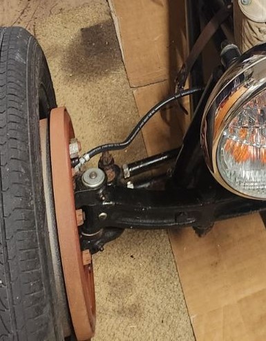

    You should break the connection at the frame, and release the twist in that rubber brake line.
    Budget36 and Speccie like this.
  8. lostone
    Joined: Oct 13, 2013
    Posts: 3,533
    lostone
    from kansas
    I bet he's using that twist to move the brake line out of the way when he turns right.
    Ford used/uses that trick alot...
