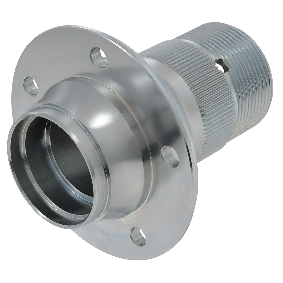

    I'd been aware for a while that there was a lot of similarity in ID between early Ford and MGB wheel bearings. The outer bearings have identical IDs, and the Ford inner's ID is about 1½mm (.060") bigger than the MGB inner's, which is theoretically sleevable. This seemed fortuitous as there are lots of MGBs around; and they have a strong following, meaning that parts like wheel bearings and hubs are available new and not all that expensive. That could open up all kinds of possibilities given the recent interest in speedster/special-style builds.
    I didn't get around to researching spindle lengths and such for a long time, though. Bearing specs are easy to find; detailed spindle dimensions are the sort of thing which is infuriatingly scarce on the internet. I happened upon a fairly good blueprint of a '37-'41 Ford spindle in the course of looking for something else, and that led me to dig deeper for the rest of the info on this. I eventually had to deduce or estimate a lot of it.
    Unfortunately it turns out that it isn't a simple swap. The distance between the inner and outer bearings is about half an inch longer on the Ford than on the MG. The outer bearing on the Ford spindle moreover seats against a step, making it impossible to move the outer bearing further inwards. Moving the inner bearing outwards takes it off the cylindrical part of the spindle and onto the taper. Turning a sleeve with a tapering bore and then securing it to the spindle seemed a bit dodgy to me.
    Though OEM early Ford spindles are common enough, they aren't an actual renewable resource, so I wouldn't want to modify them irreversably. Cutting the step in the spindle back would weaken it quite a lot, but cutting 0.7mm (.028") off the largest part of the spindle would be relatively trivial, and yield a new cylindrical portion about half an inch long:
    If you do the math, that still weakens the spindle by about 13%. I'd expect that you'd be putting more than that back due to the way the MGB bearing detail puts both inner races and two spacers in compression against the spindle. The diameter of ±28.8mm would be finished to take a short length of Ø32x1.6mm steel tubing, a standard size where I am, in a light press fit, allowing the OD to be reduced in situ to the requisite 31.75mm (1¼").
    The stock MGB detail has the inner wheel bearing seating against a spacer which receives the grease seal. It should be simple enough to make up a longer spacer with a slightly smaller ID to suit the Ford spindle. The ***embly should end up something like this:
    I haven't done any of this physically. I merely thought to share the fruits of my researches. And I'm sure there are a number of other ways this can be done: I'd certainly like to hear how other people have?

    Here's a slightly different way, which moves the hub about ¾" inwards:
    You could shorten the spindle, but using a distance piece i.l.o. a washer saves the trouble of cutting new threads etc. at the cost of a bit of weight.

    Not power so much as weight, which is moot when you compare an early Ford to something like a Jaguar Mk10. Interestingly, Aston Martins used the 42mm hubs.
    New Jaguar hubs are around the same price as new MGB ones. I was a bit concerned about all the other Jaguar wheel stuff being rarer and more expensive than the very common MGB stuff. There are nevertheless two very good reasons for considering Jaguar E-type/MkI/MkII hubs: they take the same bearings as the MGB hubs, and they space the inner and outer bearings about half an inch further apart. That means that they'll go onto early Ford spindles without any need for cutting, and only a ±.030"-thick sleeve inside the inner bearing. I've added a collar to receive the Jaguar grease seal, which allows the Jaguar thrower ring to be used:

    It looks to me as if the aim was to compress the inner races of the bearings, that spacer, and another spacer at the root of the spindle together against the spindle, turning the whole into a post-tensioned beam, while at the same time keeping compression out of the hub. I can't really see the hubs failing under compression, but for the spacer. It might be a MG legacy thing, developed to solve a problem that subsequently went away. A lot of MGs were like that: MGA, MGB, and Spridget at least. (Interesting mix of imperial and metric speccing, though: The MGA/MGB spacer works out to 50mm on the nose, though technical sources give the length in inches. Likewise the Spridget spacer is 40mm long.)
    The Jaguar hubs take the same bearings as the MGB, but don't use a spacer.

    You could, of course, dispense with Jaguar's belt-and-braces approach and match up a grease seal to suit the Jaguar hub's 2½" ID and the Ford spindle's 1⅝"(?) seal journal OD:
