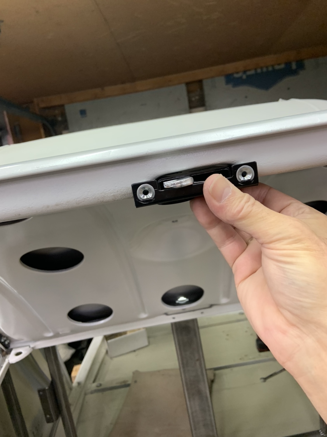

    I’m a little confused about doing this. I got rid of the little plates covering the hinge holes and I’m trying to figure out where the hinge attaches to the lid. Few questions
    Do I need to drill new holes in the lid to mount the hinge?
    Do I need the mounts for the rubber bumpers at the top of the drip rails after the conversion?
    What are the threaded holes in the side the lid for ?
    What is the hole on the inside of the drip rail for ?
    A few pix to show what I’m babbling about
    [​IMG][​IMG][​IMG][​IMG]

    Shouldn't take too much to do. As I remember, all holes are already there for either. All you should need is the hinge kit, latch striker and the "prop" ***embly. (Of course, you need to move the handle.)
    https://www.brattons.com/trunk-lid-hinges.html
    The triangular bracket for the bumper stay there.

    the threaded holes on the sides of the deck lid were for the rumble hinges, you wont use any of those. yes, you still use the rubber bumpers in the top two corners, and the new deck lid hinges for a trunk style lid attach in the top corners where you have paint missing. the hole on the quarter panel left side is for the brace that holds the lid open and rattles all the time to drive you nuts. i put a bunge cord on it.

    Check out the Bratton's catalog for what you need, www.brattons.com. PN 29840, Trunk Lid Hinges. You also need PN 29830, Deck Lid Aligning Wedges, these mount on the very bottom of the trunk channel and center the lid when it is closed. The holes on the side of the lid are for PN 29860 Trunk Lid Support arm, and PN 29861 Trunk Lid Support Bolt Set. These hold the trunk open. The rubber bumpers only go on the bottom when a trunk is used, top for rumble. I can see by your pictures that you are not using the stock inner panels as you would also need to change them as they are different for rumble and trunk.

    In picture number three, those little plates that you got rid of were part of the hinge. They were threaded and the hinge bolt is cut down smooth with a few threads left, basically a shoulder bolt. These screw in from the space between the quarter panel and trunk channel leaving the cut down part to go into the lid as the pivot. Pretty simple and basic. Picture four is where the Trunk Lid Support bolt attaches to.

    Dino, let me try to help you. Look at your third picture, the one with the spot that's not painted, with three holes. The part that you removed is threaded in the center hole, the two outside holes attach it to the spot that it was removed from. The bolt screws in from the back and the only thing that is protruding is the turned part of the bolt PN 29841. This acts as the pivot point for the deck lid. The bolts go in when you have the trunk lid in place and you have to play with the lid to get the bolts in.

    4B904D14-E866-4245-A9CD-FA296C27CBB6.jpeg 88889A41-0F01-4BBB-B3D4-7FF60ABD0476.jpeg C7241D10-D23A-420D-A643-F3F154E255B2.jpeg 5120B84B-F3B3-4CFD-8637-2EFD8BB29553.jpeg @woodywagon46, thanks for trying to help, maybe my car is a late 31 production model.
    See pix, no thread in center hole, the part I removed, and the top of the trunk lid has no holes for it to pivot. I guess I’m dumber than I thought :(

    It looks like you will need to purchase the Brattons kit and drill a hole 5/8" down from the top edge of the trunk lid for the bolt to go into. I have never seen that piece you have in your hand before. Don't get down on yourself, remember your car has been around for about 88 years, a lot can happen in that amount of time. You'll get it done.

    Here’s a picture of a set of hinges I removed from my coupe as I’m going to trunk lid as mine originally was. My hinges had a backer which is tapped for the screws. It uses the existing holes in the bottom and sides of the lid. I’m ***uming my hinges were repro’s IMG_0626.JPG IMG_0625.JPG

    Spoke to Brattons today, great folks. The tech person explained everything to me. The bumpers at the top are optional. The lid does need to be drilled to mount the lid. The alignment wedges go on the inside of the drip rail at the bottom to guide the lid down to the latch and stay centered.
    Just wanted to post the info if anyone else is doing this conversion. Posting a link to the diagram on Brattons web sit. A picture is worth blah blah...
    https://www.brattons.com/files/index/download/id/1497469997/

    Bringing this back up cause I‘be run into another problem in this conversion. Firstly, thanks to everyone who helped to this point, the hinges are installed and work fine. The latch is now the problem. I have a new trunk lid latch and handle from Brattons. They said this is the correct part. [​IMG][​IMG][​IMG][​IMG] I can’t figure out how to install it tho. Any of you that have done this, do I need to cut the into the back of the lid to accommodate the latch ? Here are a few pix of the confusion...
