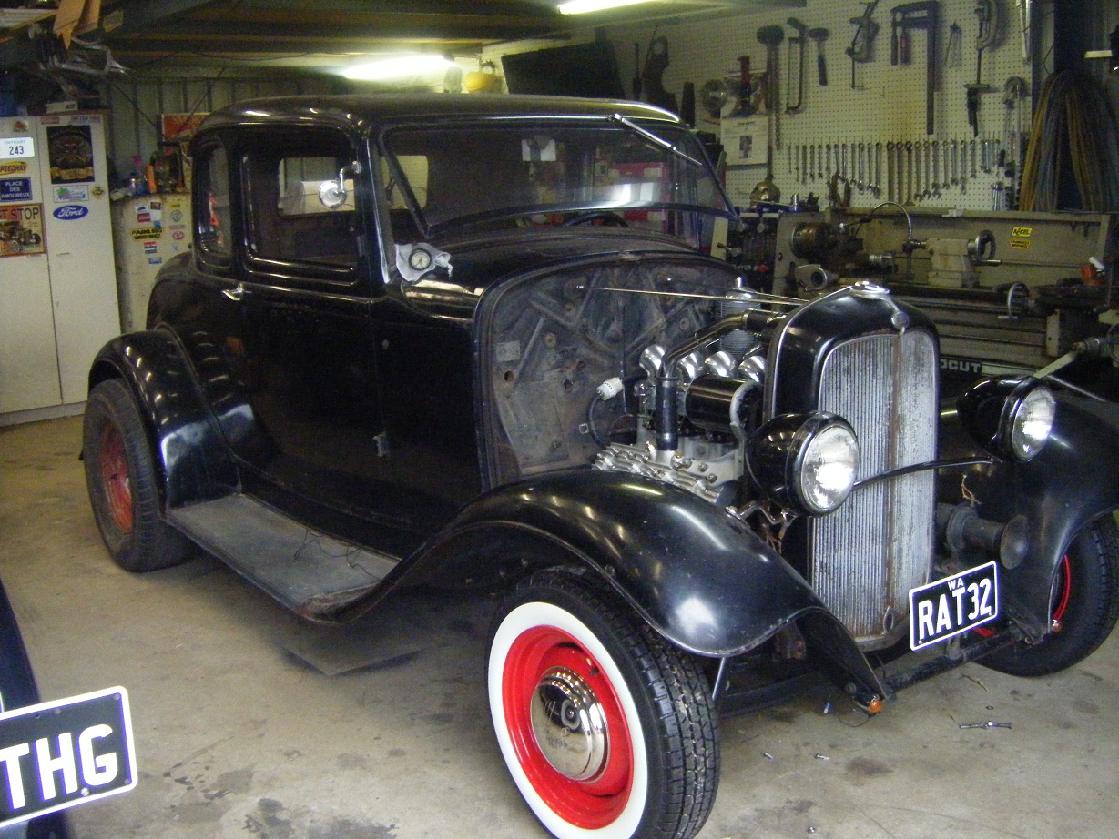

    Hi Guys, just about finished my 32 coupe project and are seeking info on jet and power valve sizing when running 4 x 2 97 carbs on a 276 flathead, I know you are all going to say I need to get it running sync my carbs take it for a run and read my plugs first, but if some hamer has allready been there and done that it will save me buying a lot off different size jets and power valve that will not be used. Engine specs 59A flathead running 4" stroke crank with 0.125 overbore 276 cubes, Isky 400 cam, Harmon & Collins mag, Edelbrock 4 x 2 manifold and 4 x brand new Stromberg 97 carbs. With jets sizes running from 33 to 50 and power valves 60 to 71, new carbs are fitted with 45 jets and 65 power valves. Thanks in advance for and info given.

    Hi guys for all who have been reading this post, I can now report that I have the 32 up and running, at first I started the engine with the factory fitted 45 jets and 65 PV and to my surprise started ok. But I took uncle Max's advise and fitted 42 jets to all 4 carbs 67 PV to centre carbs and 69 PV to end 2 carbs, engine started ok, I set the timing at 5 deg advance, sync all 4 carbs air flow pulling 18 on all 4 carbs with my carb sync gauge, engine running ok no splutter when the ****erflys were opened, but was running a little rough at idle and puffing a bit too much black smoke out the exhaust, I checked the idle mixture screws which were all set about 2 1/2 turns out from factory, I screwed all the idle mixture scews in fully and backed them out 1/2 a turn, engine started ok but kept wanting to stall, I turned the idle mixture screws out 1/2 a turn more. Now the engine starts and idles like a dream no more puffing black smoke, and when you dive it and put you foot into it there is no hesitation pulls like a train, I am very happy with it so if any of you are thinking of running a 4 x 2 set up I highly recomend it, many thanks again to uncle Max for the advise, now I just have to work out why I am getting front wheel shakes up under speed and braking better do so research on the Hamb.
