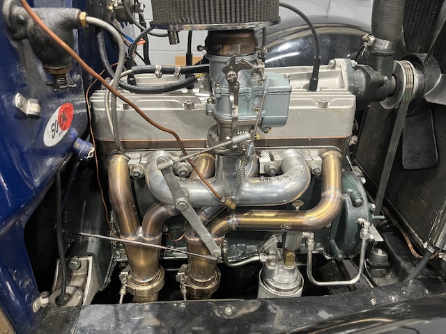

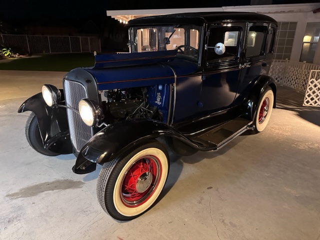

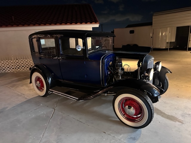

    IMG_1358.jpeg I have this roadster straight pipe to just in front of the p***enger rear wheel. It’s not that loud and doesn’t sound too terrible. It’ll get something a little more permanent in the future.
