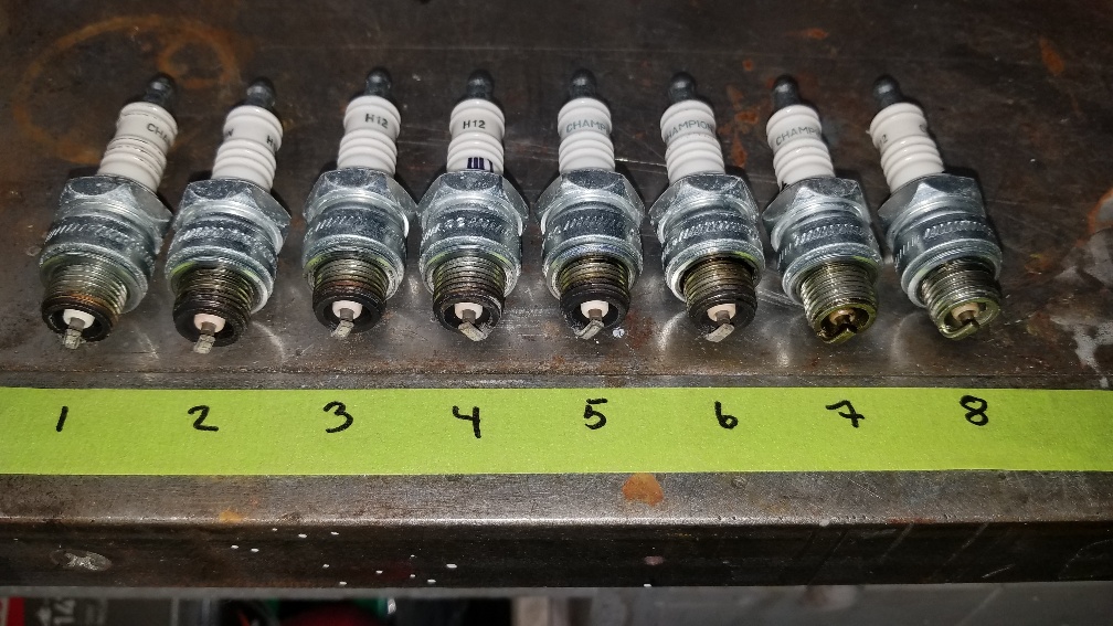

    looked at the plugs and they look mostly good nice tan color except the drivers side # 8 # 6 look lean really white. thats all the more i did and now will be gone for a week so any more ideas? to look for when i get back i will check.

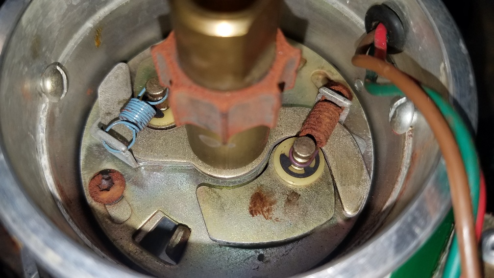

    OK well did a little checking on the motor.... as you can see the plugs seem to be running a little lean and #7 #8 not at all. so valves seem to be OK set OK plug wires not so good but look at the distributor the spring it is rust and has no effect there is rust all over and they tell me NO PARTS Available. so what kind of unit would you guys recommend as for an electronic one.??? or anyone have parts for this unit mod# 5072101

    Springs are easily obtainable , wire brush will clean that reluctor wheel...

    ok well where can i get the springs and one side of the advance is working. do the plugs look to lean? brakes not dragging. the timing is at 4 btdc initial. and stay with this unit?

    Carefully dis***emble the advance mechanism , clean it , google mech advance spring kit , most are sets of 3 pair , by combing pairs you'll be able to find time your advance...
    I saw springs on the bay for $6....

    ok so then what would be the best advance be to set if the timing is at 4 degrees should the advance be somewhere at 22 hundred to 24 hundred total ? i can see it has a blue spring but what is the other? light silver? and still the plugs look to lean to me?

    took the distributor apart cleaned all parts added a new spring ordered new wires touching up the valves, still asking about the plugs any input on them? may need to richen up carbs? or something more, Idea's ???? talked to Jim @ bubas and likes this unit.

    well got new plug wires, and cleaned up the distributor, and reset air gap in distributor new springs. started right up and took it for a little ride WHAT A DIFERANCE in drivability. now if someone has some pics of the wires and how they routed them I could get that little mess cleaned up........just looking for a neat way to run the plug wires on a 41 3bolt distributor, any tricks you want to share??
