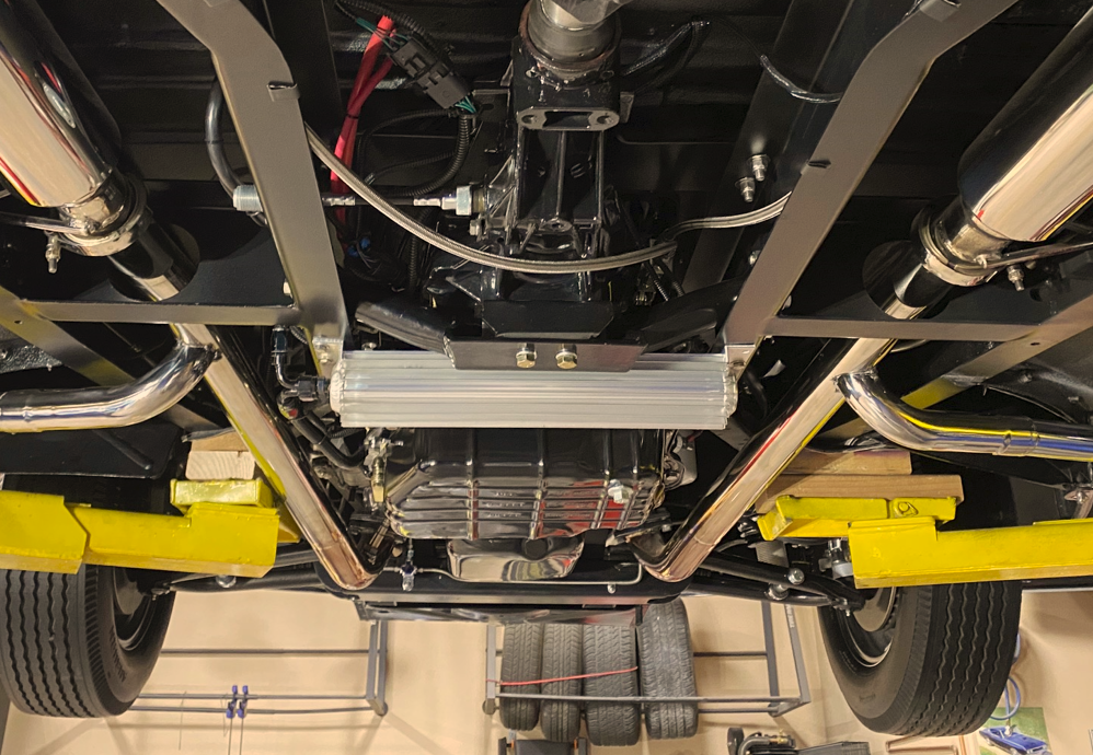

    I did the little 10" fan/10" radiator mounted under my ''53 Chevy pickup. Don't know if it worked; finished the truck but never started it for 5 years then sold it. I hate starting new engines! I put the fluid bypass valves in my builds to a0 heat up the******* quickly to operating temp then cool it as necessary.
    The******* that always amazed me is the grand old GM cast iron Hydramatic 4spd. It runs a fluid coupling, not as efficient as a torque converter and has zero provisions for cooling of any kind!
    Built but never started!
    This is the home made******* cooler I put in the truck.
    I like the idea of these bypass/temp regulator valves.
    Unit mounted to frame next to*******.
    jimmy six likes this.
