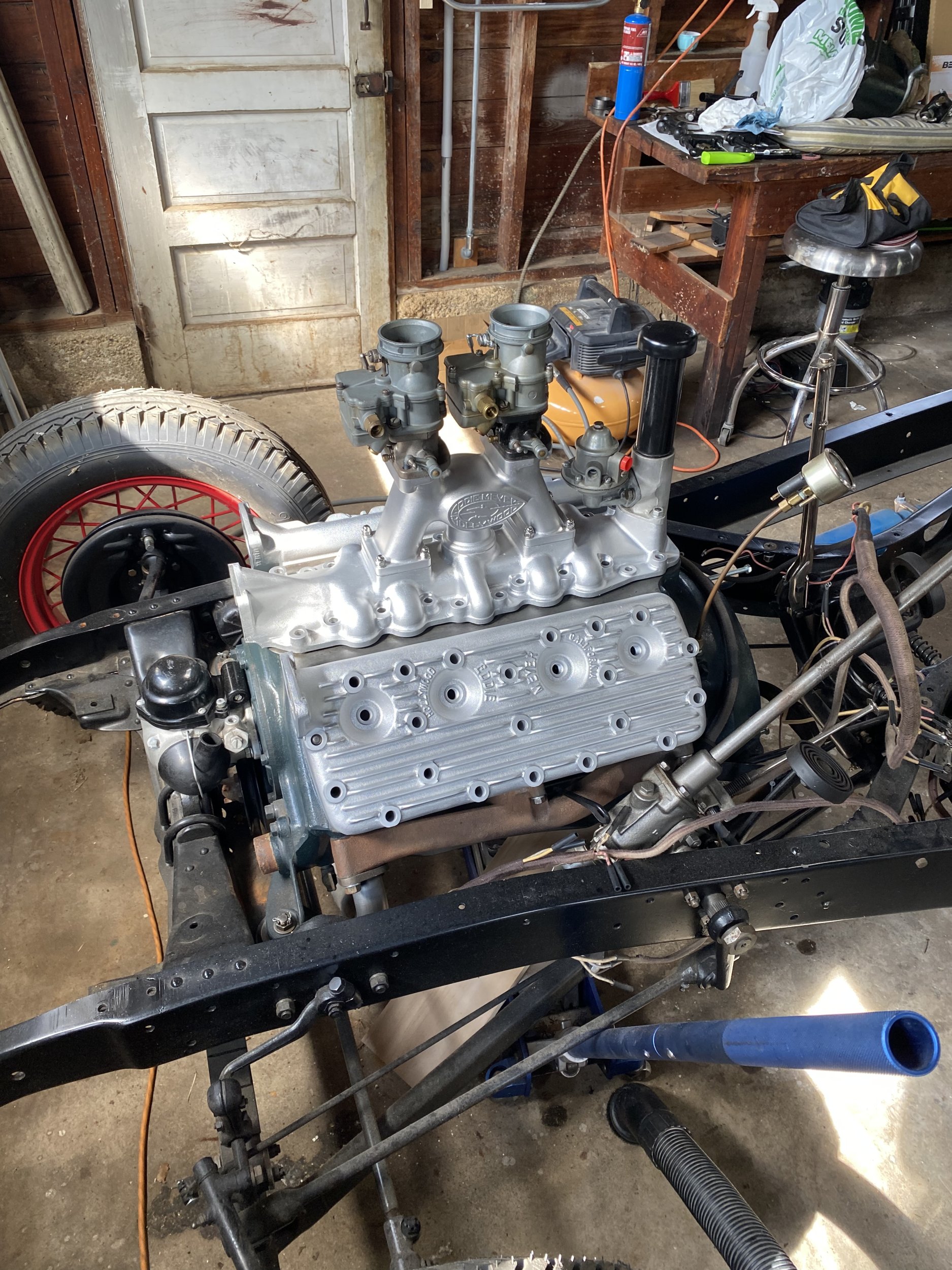

    Hello friends!
    I was hoping I could get some opinions and/or ideas on the pros and cons of running an Eddie Meyer (Orosco) dual carb highrise intake manifold on my otherwise stock early 21 stud flathead (‘33-‘34 block), in my ‘33 Roadster. It’s bored .40 over with Babbitt mains, has about 2 hours of run time, stock cam. Ignition is stock with ‘37-‘48 points upgrade. Coil is rebuilt by Skip. 6V charging system. ‘39 gears and clutch. Ill also run EM heads and Reds headers. I would like to have a hotter cam like a Max-1 or Snyders 3/4 regrind but I’d rather not tuck into the valves and lifters since they are just broke in. As far as carbs go I have a set of 48’s I’d like to use, but thinking it might over carb it so could go with 97’s with 43 jets and 69 PV.
    Any opinions or ideas would be greatly appreciated.

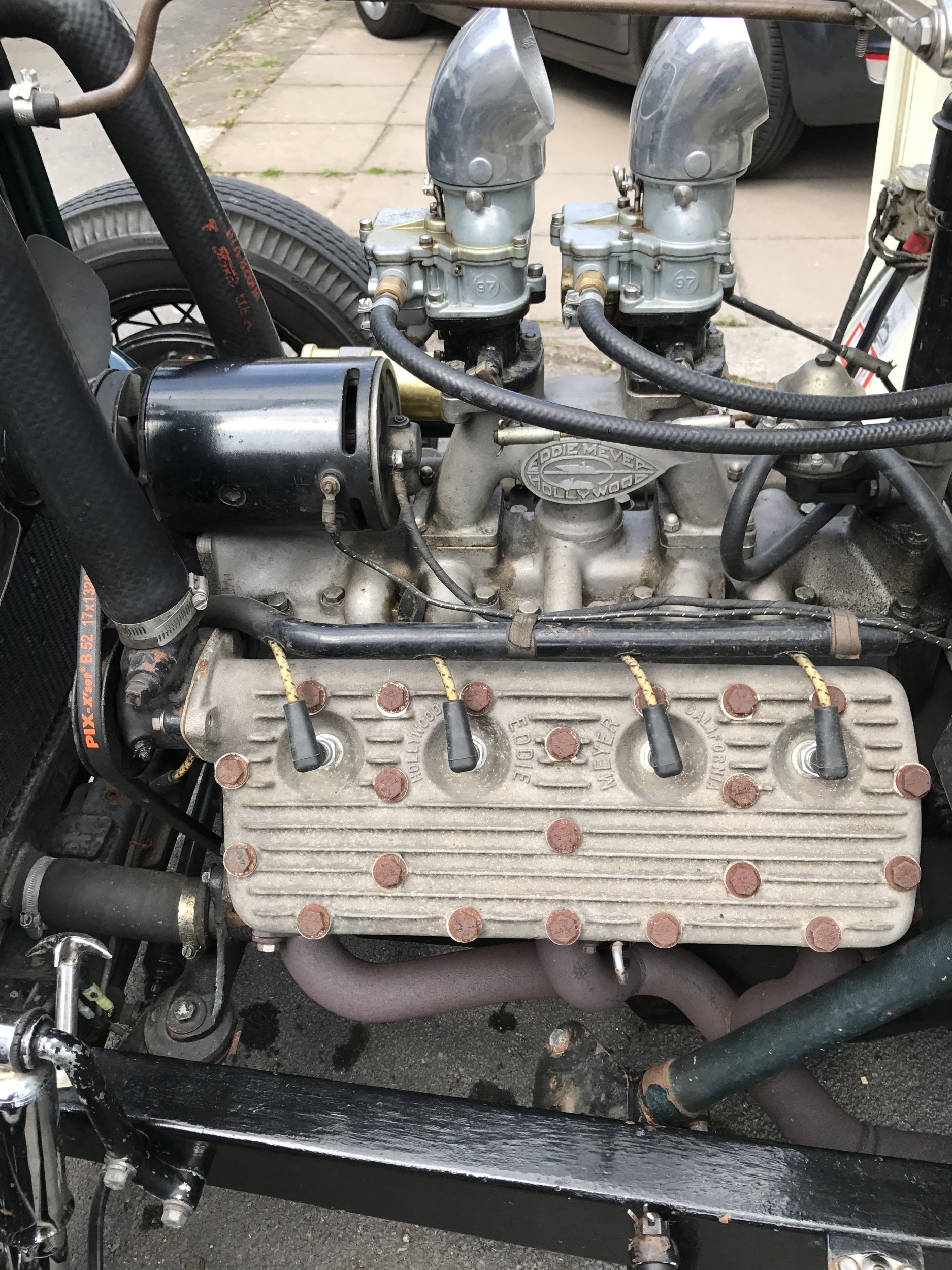

    No con's from my experience. I loved them on my old motor.
    My 21 stud was 80 over, babbitt mains, isky 77b cam, stock heads and twin 97's on a Tardel Y adapter. Ran great.
    Fitted the Orosco repro Meyer heads and matching inlet and it really woke it up. I also switched from the diver's helmet to crab style dizzy. Quarter mile time's came down by 2 seconds. I mistakenly bought heads for domed pistons when mine were flat tops but when i spoke to Don he said it would run fine but wouldn't have quite the compression increase stated.
    I spent some time tuning the carbs and ended up around where you are thinking. 43 on the jets and 67 on the PV's.
    I abused that little engine for years and it's still going strong in Germany now.

  9. 59AB + .080", Isky Max-1 cam, Harmon-Collins dual point dual coil, a pair of '94's plus the original Eddie Meyer intake and heads...ran pretty strong in my roadster. I see no reason that it shouldn't work for you. ;)

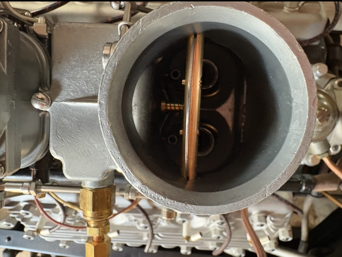

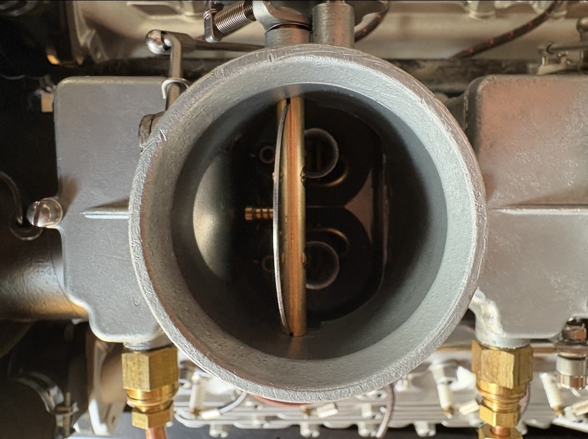

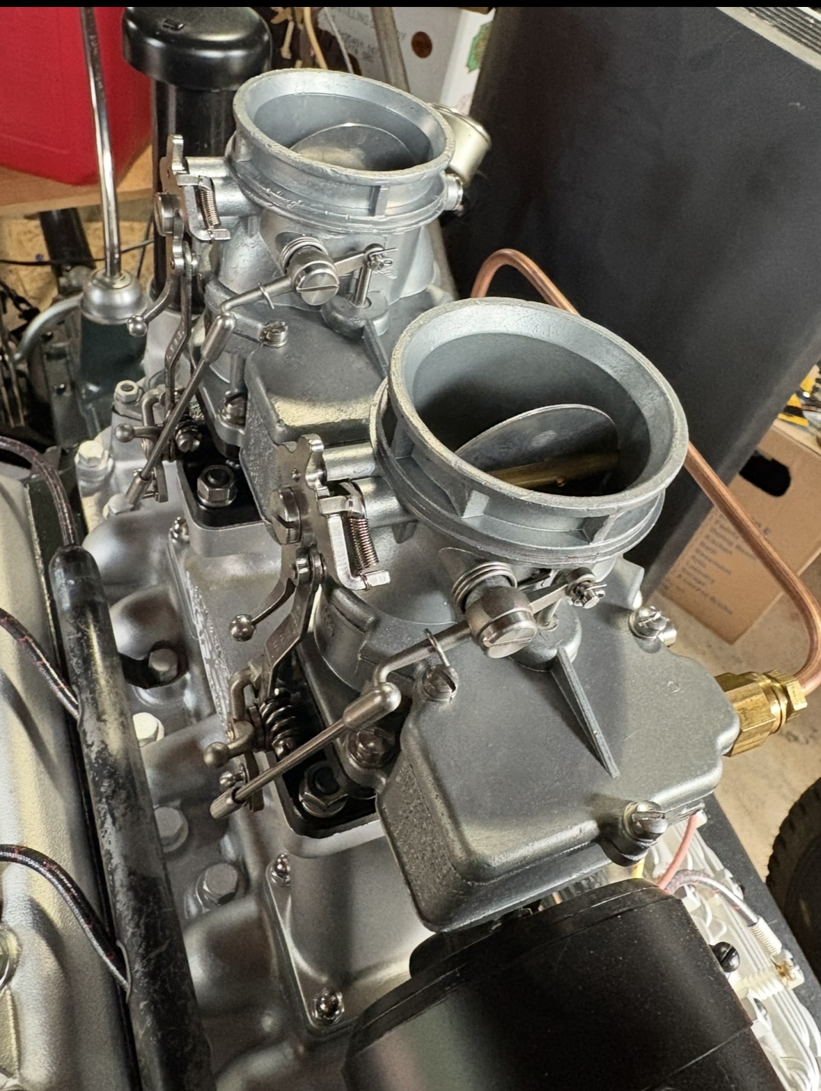

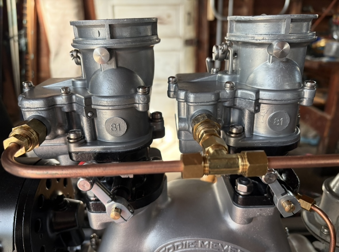

    I got the Stromberg 81’s all done. Completely stripped the bodies, ultrasonic cleaned, vapor honed, and 100% all new Stromberg parts. Fun fact: The price of all new Stromberg parts for one carb cost nearly as much as a whole new carb

    Those look great! Keep up the good work (except the e-Fire).

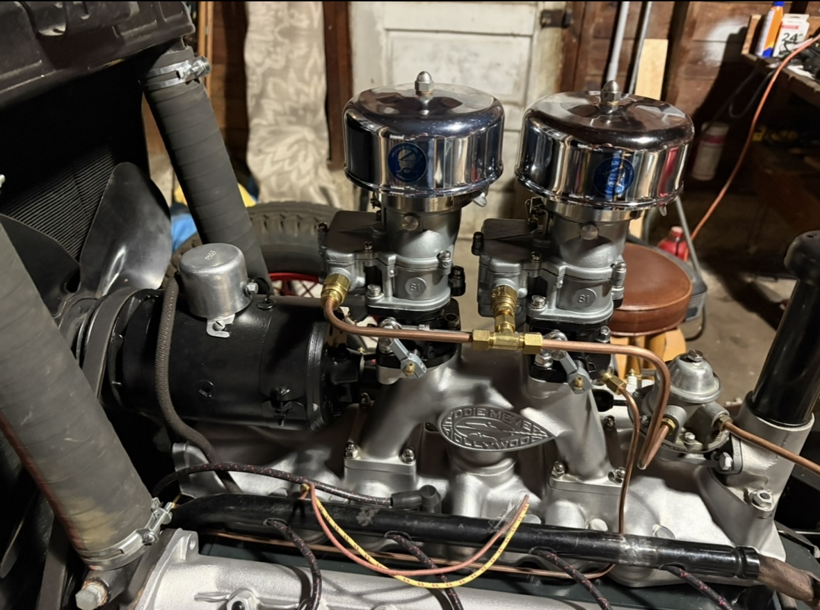

    lol! No e-Fire. It’s got a crab on it now. The conduits are ‘42 style to take the plug wires from the crab nicely, but as you see in the pics I cut the back ends off and welded on ‘33 style conduit tips to accept the wire loom on the driver side, and cap off the p***enger side nicely rather than have an open end. They just need a little body work now. I’m also making a custom coil bracket so I can use the ‘42 style coil. It will look very similar to the ‘42 style bracket and mount to the same place but it will sweep rearward rather than forward so the coil will fit without hitting the water pump.

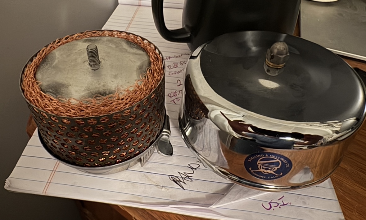

    Fresh roll of copper mesh showed up today to so got the Stelling & Hellings wrapped up and ready.
