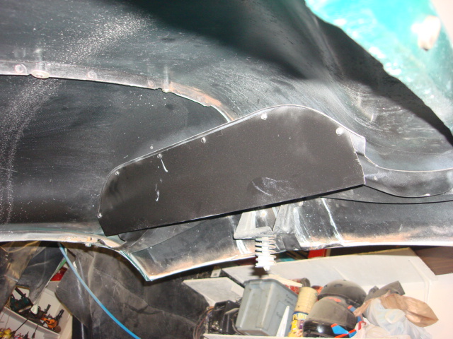

    I added a filler piece to the hood brace to try and keep air from flowing over the top of the radiator.

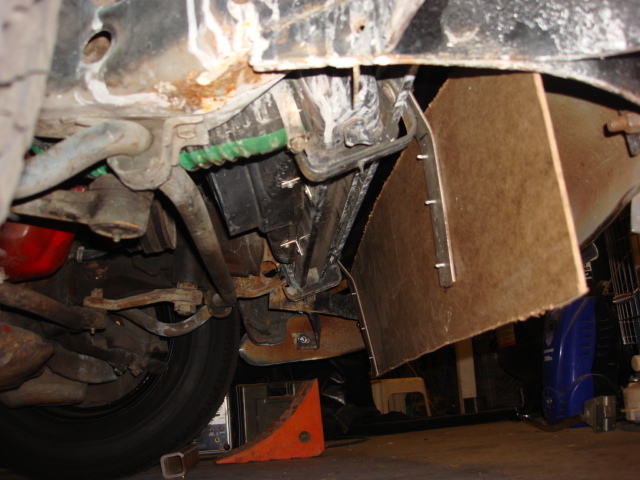

    Friday night I whipped up an air dam under the radiator that hangs 3" below the bumper. This helped a little bit.
    I'm working on filling up the 2" gap on the sides of the radiator.

    Here are several pictures to show you what I'm up against.
    1st is the hood brace filler, then the lower hardboard air dam LOL, the lack of clearance then my next test is to really try and seal up the top of the radiator

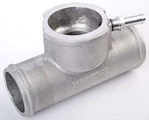

  18. Here's a link to save me from trying to detail pictures and post them.
    http://www.wallaceracing.com/water-pump-mods.php
    The way his radiator is slanted makes a natural slide for the air to hit and flow off the top and not through. Also he is running a 180 stat and the temp gets only to 185 and the fan doesn't turn off. It's actually not overheating.

    One of those in hose fillers is on order. That way I can burp and fill it better.
