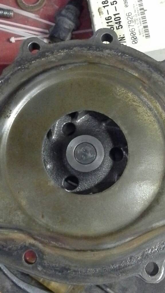

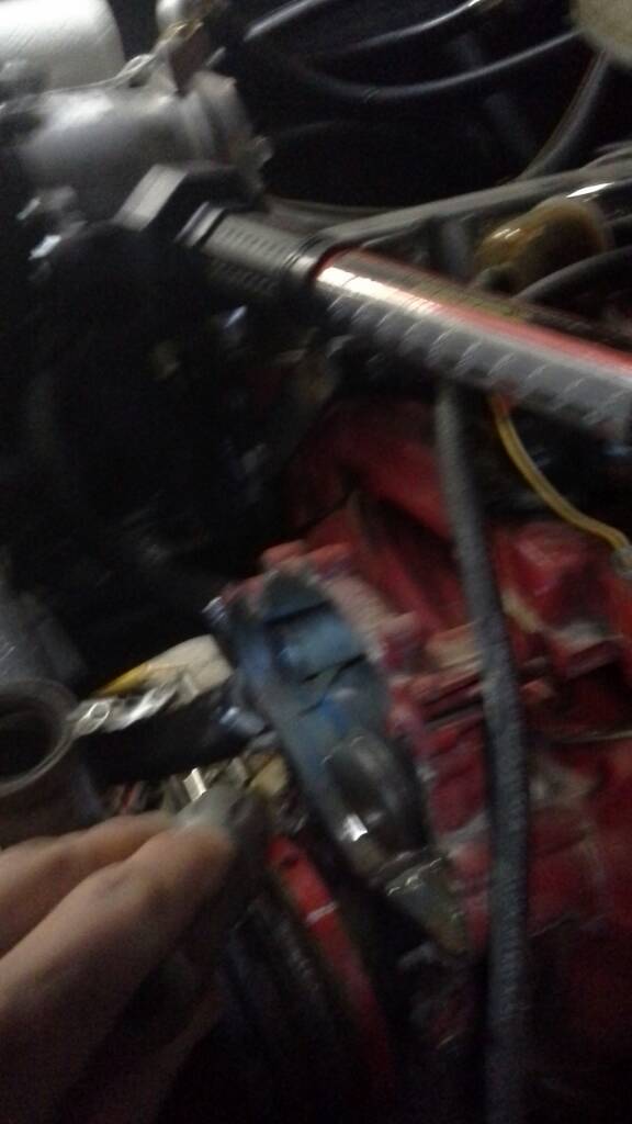

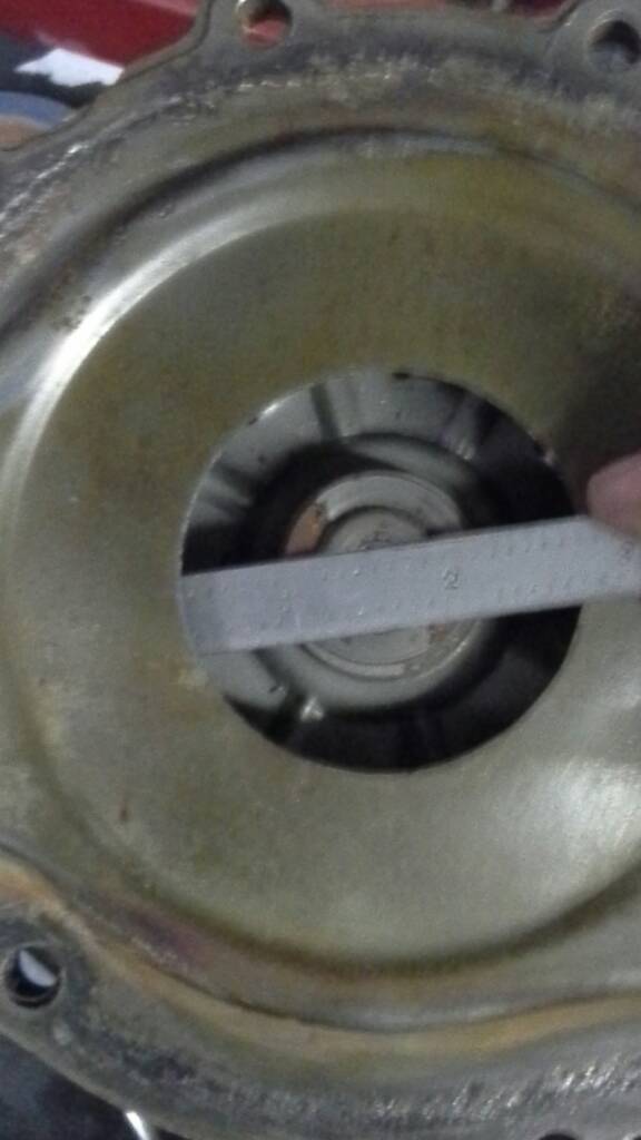

    I want to try my new tablet with a camera, lets see how they turn out. :cool:
    I decided to pull the water pump to check the divider plate and tubes.
    Both are present and in good shape. The clearance to the stamped impeller is a bit big at 3/16" which I can fix.
    Beond this, the only thing I can think of is to try a flush, the block and pump are a bit corroded

    Had problems in the past with pontiac 400 running hot, but not over heating. I wound up switching to a pump with a cast iron impeller, which lowered the clearance to the plate, and made it run much cooler.

    Found a cast impeller. Brand new no core from napa for $38
    P/n 43102
    I think I see why the cast impeller may be better. The fins actually reach the center hole, while the stamped one is 0.4" away at the tip.
    Im working the plate a bit to get 1/16" clearance
